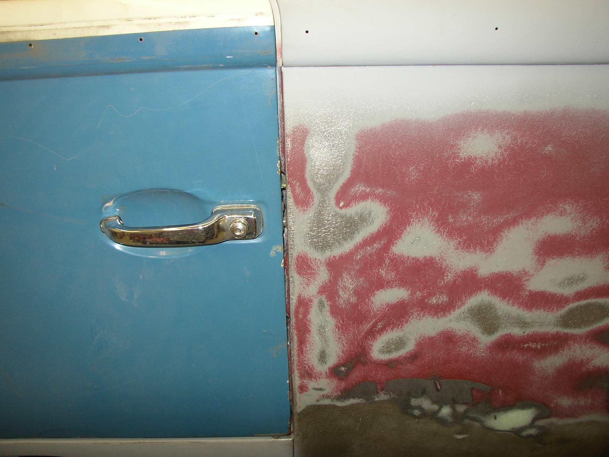

Well, my new door came in Greyhound and it's "pretty good" but not perfect. It has virtually no rust- some surface rust on the lower inside lip but not much, a wire wheel took it right off. It was hit in the lower center and has a spot of mud about 8” around in it, you can barely see the lines I drew with a pencil where the magnet showed mud. I wanted a 50 year old virgin, but I guess there's not many to be found. :cry: It came with nice deluxe trim and a hacked up window frame, but I didn't take pics before I removed them. The prior butcher bent the lower edge of the window frame out so he could pop the glass and hang his arm out the window. Brother.
It doesn't fit very good, not because of the door but because when this bus was tapped in the old driver's door it evidently pulled the A post rearward about 1/4", which is just enough to screw up the door gaps. Evidently it had a "custom one off" driver's door on it before, because it fit and worked perfect.
I did get it hung and after heating and bending the hinges it fits OK, but not perfect.
Right now it looks like it's too far forward, but in reality it's centered. The problem is the lower front gap is 1/32" and the rear lower gap is 1/8", when combined they should be much more than that, like 3/8" or something.
I'll sleep on this and decide whether to break out the PortoPower to fix the door gap. Hmmmmmmm....
