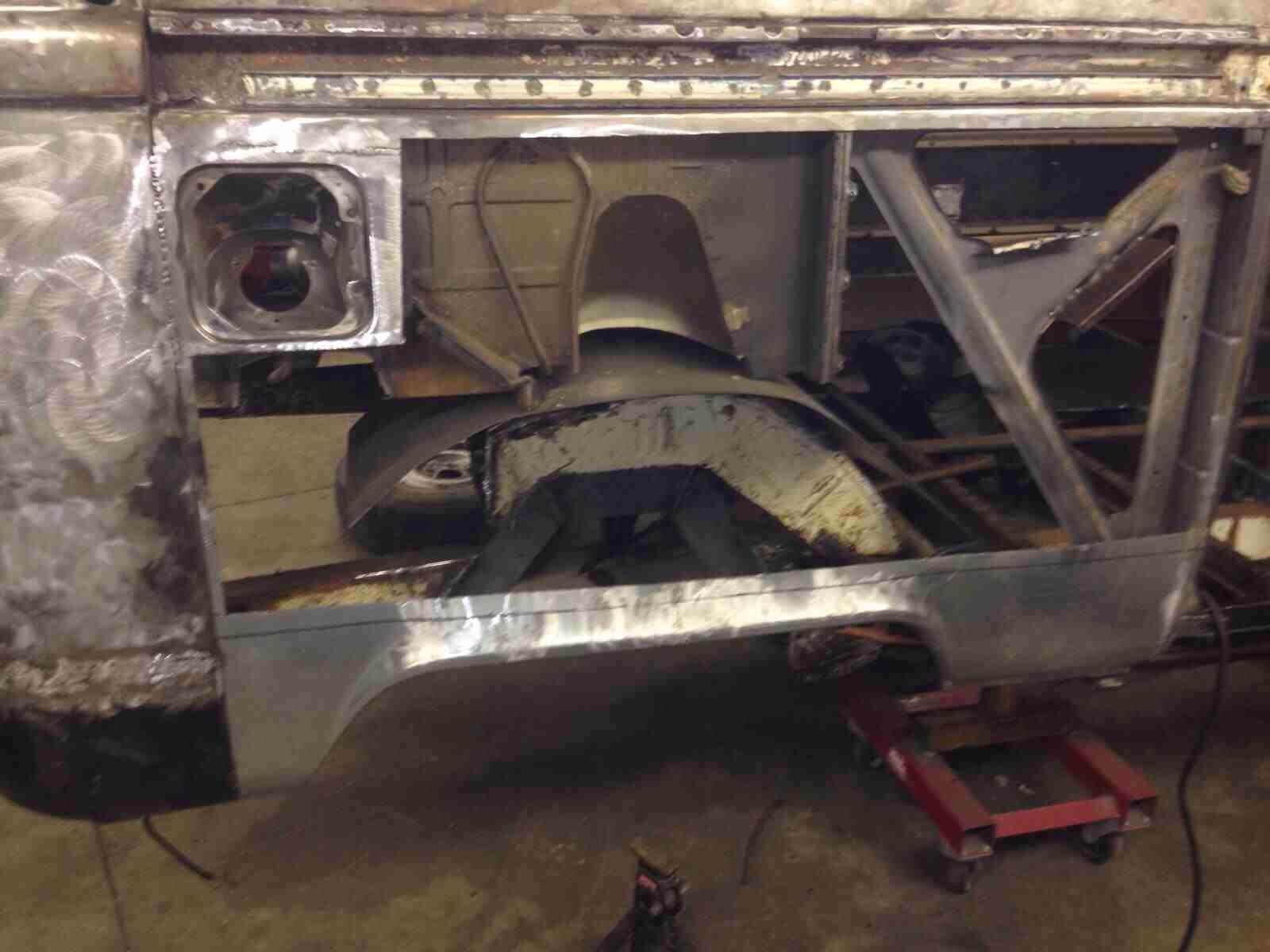

To much welding work had been done to that wall so i cut it out.
Re: 1971 Early Bay Panel
Replaced it with a fresh sheet of 18 gauge steel. Thats my new ride height too. It'll actually be a little lower. Originally i was going to run some euro style 18" wheels, but some things had been brought to my attention and i decided to step down to 16" wheels in order to get alittle lower. Actually im hoping to be sitting on the ground when im parked.
I cut a section of my frame out and fab'd these "C" notches out of channel iron. This will allow my trailing arms and cv's to travel much further up.
Then i cut the ends of my rear torsion's off and narrowed them 1.5" on both sides.
1.5" narrow
New rear tubs :-)
