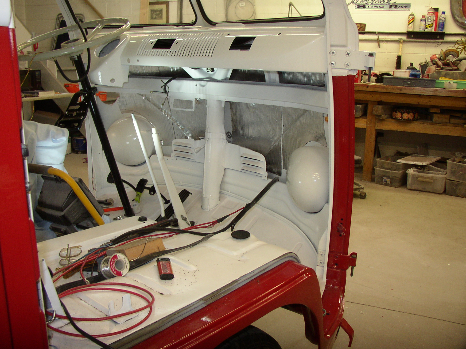

The stupid wiring harness doesn't come with a dome light harness. WTF is up with that?
The whole dome light harness is encased in tubing to protect it from sharp edges, just like the rest of the harness.
Oh, well, make up a harness with polyloom and fight it through the holes in the roof supports.
