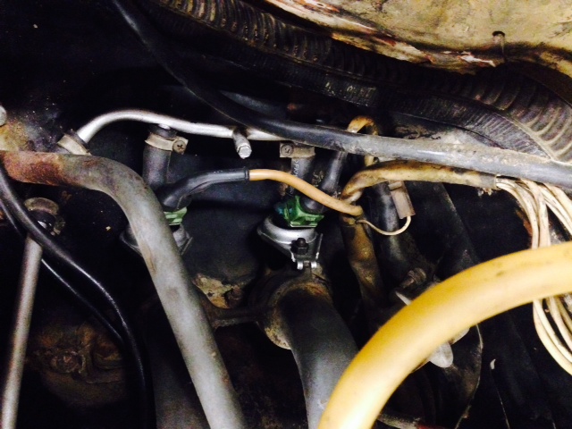

Fired up, ran like hell and knocking. Traced down one injector wire in harness was pushed back
causing one injector not making contact. Fixed - engine smoothed out but still knocked
