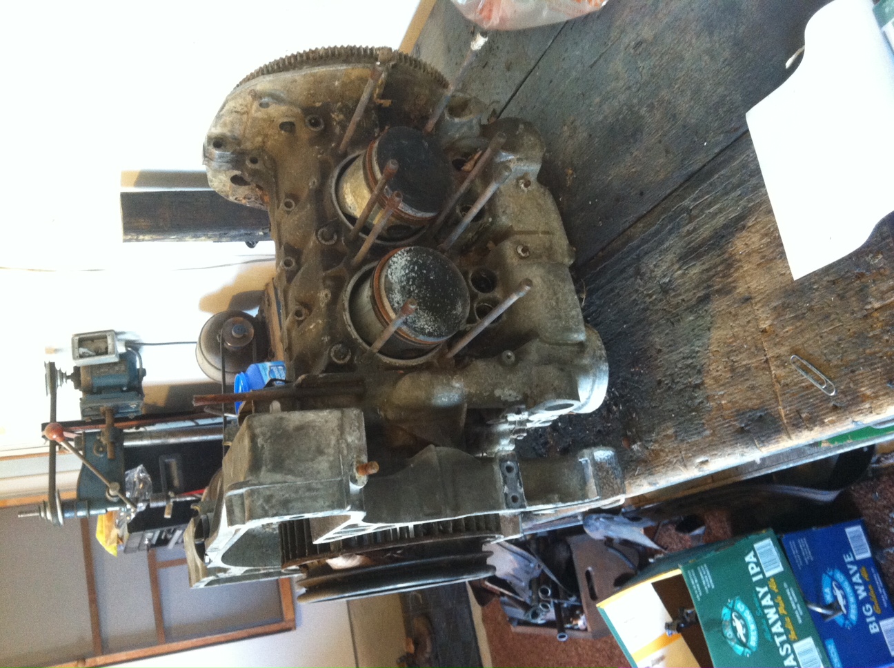

I am posting new pictures of another engine case that I have now.
No holes in the case. Cam shaft is in one piece with no visible sign of wear when peaking through the lifter holes.
Rods and crank appear to be tight.
Pistons have some light scratching as do the jugs.
Got this engine from a teenager who was going to put it in a 914 he got from his dad.
Serial number has been polished off the engine.
Keeping in mind I am on a tight budget on this project I am thinking a bore or hone job, pistons and rings to match & possibly a valve job.
Your comments are welcomed.

That is a 914 engine and depending what parts are on/in it it will not be a good match for a bus.
