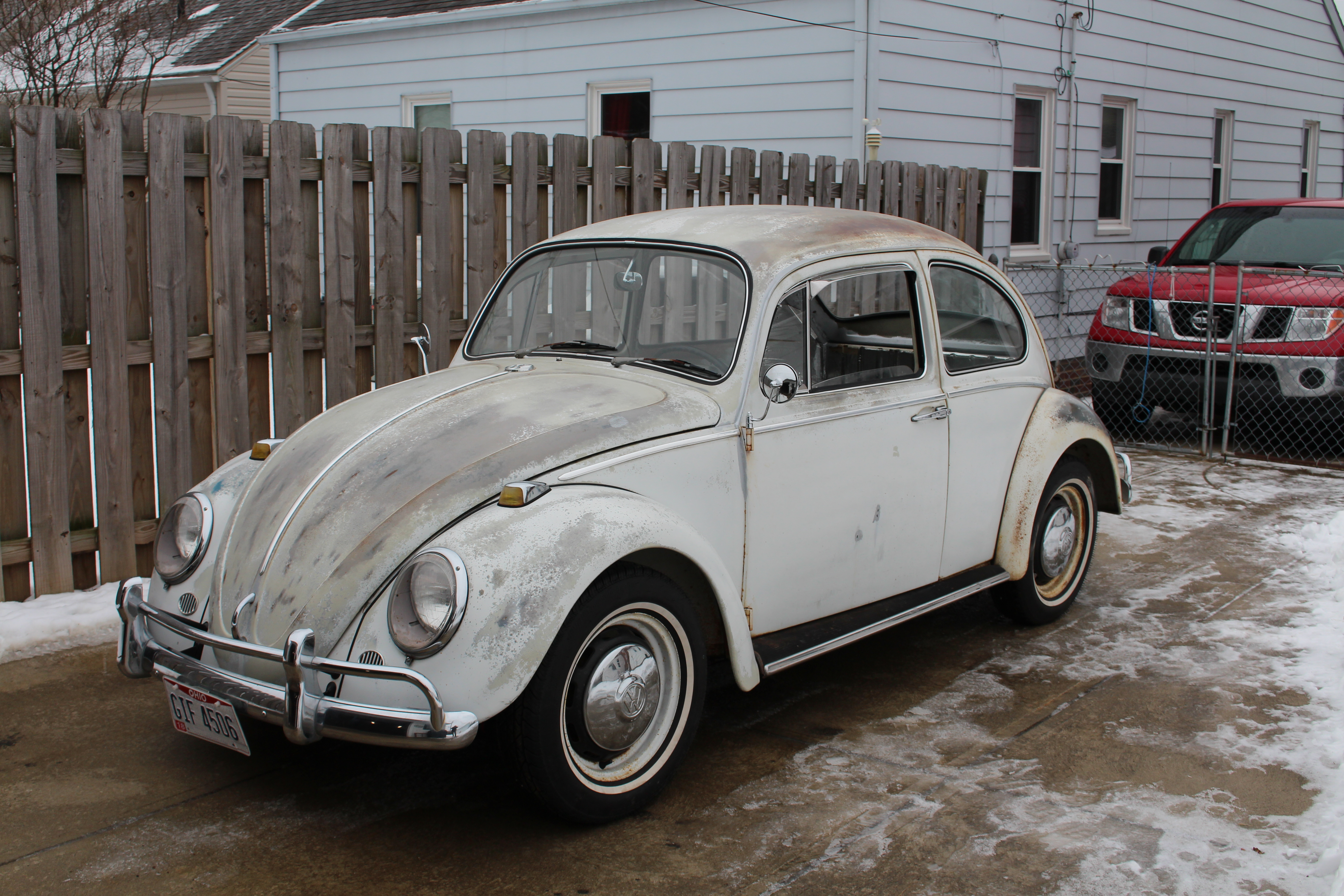

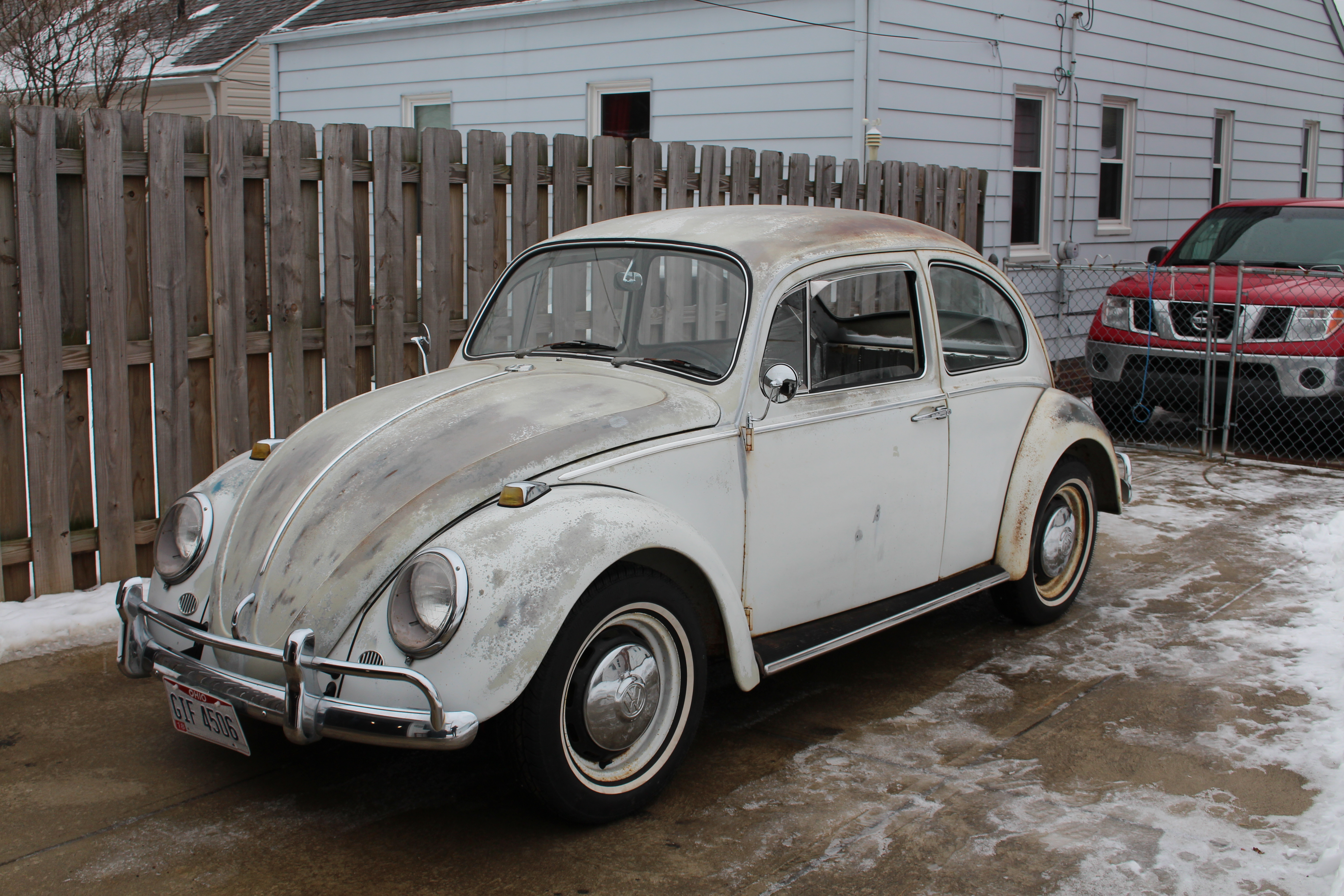

Some pics of the beetle in the garage and some progress. I'm not good at documenting like some of you. Love to see the progress pics.
After the drop in the front. Garage is super small and you can only step back so far....

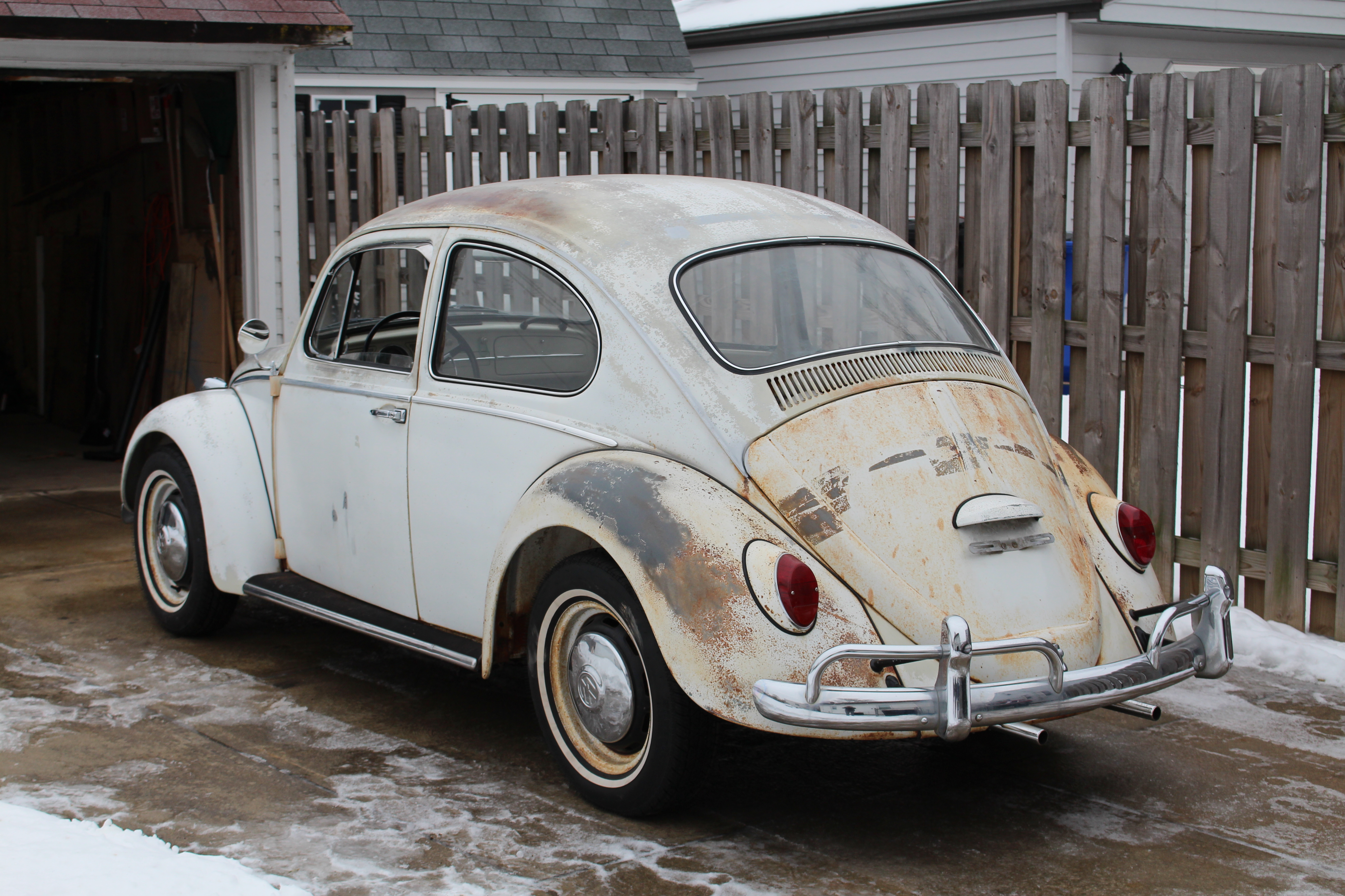

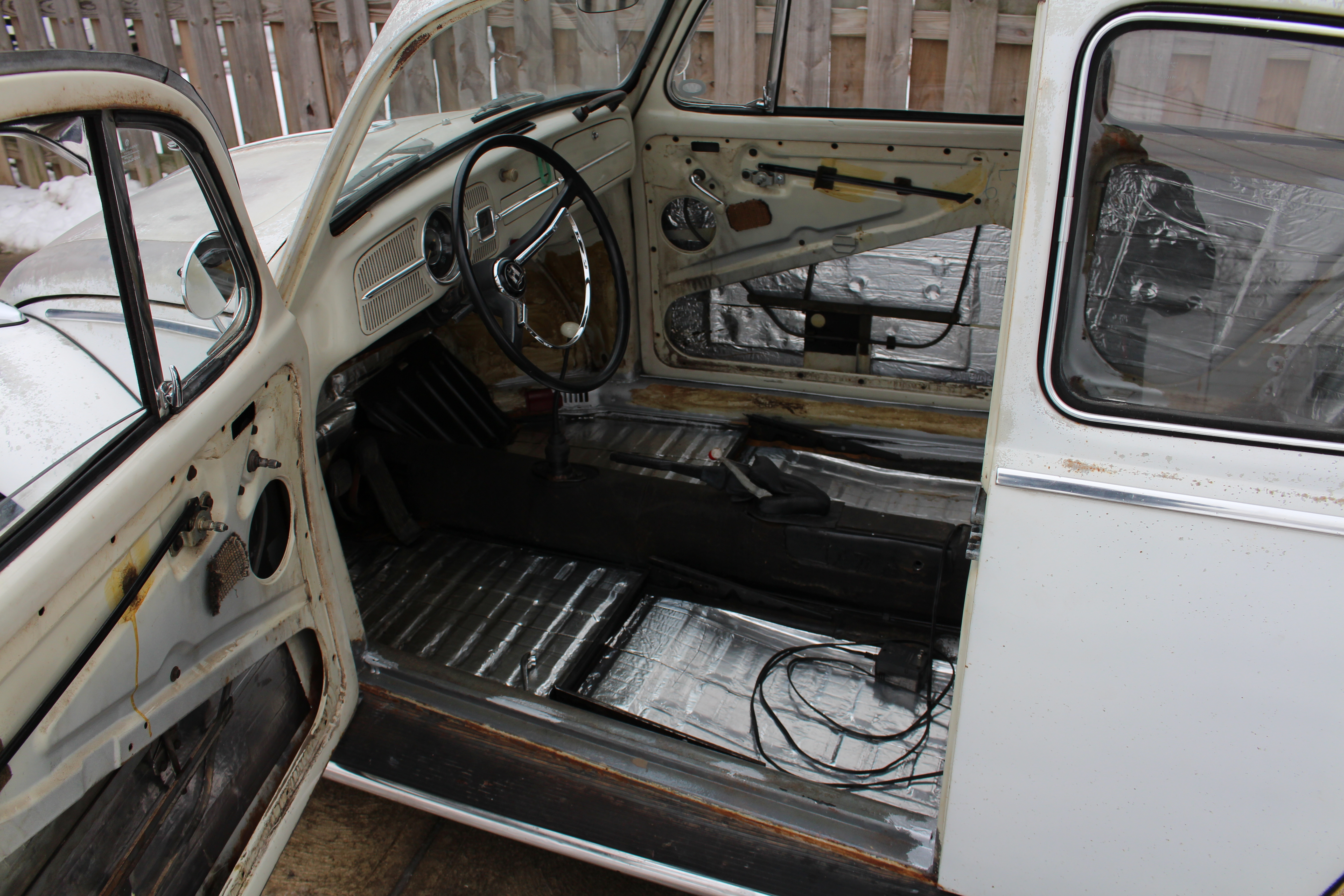

The interior is coming along with no end in sight. The priority list is becoming a jumbled mess. Oh well, at least I'm making progress.

Bought new window regulators with the door rubber kits. I have been working on the passenger door for a while now. What a learning experience. I completely ruined the brand new regulator last night trying to get the window to crank up and down. What I'm finding out is that the new felt and scrapers really make a tight fit. The window has a hard time going up and down. The felt in the wing window won't stay in place so I had to use some adhesive to get it to stay in place and not move with the window.
Luckily I kept the original regulator. Degreased the snake and lubed it up. It seems to be working much better than the new one and I think I might have the door almost finished.
I should be real good at doors once this is done.
One more door to go, and after learning how the process works, the drivers door will be much easier.

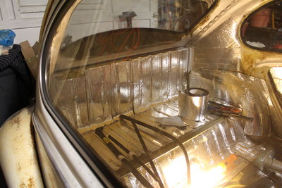

Another note. The Speed Roof product that I've been using to sound deaden the interior seems to be working great! I thought for sure that it would fall off after being so cold in the garage but there is no sign of the product coming off. The rubber backing is not as sticky as you would think it should be when you remove the backing. I hang the cut piece of material in front of the heater to activate the material and it really gets sticky.

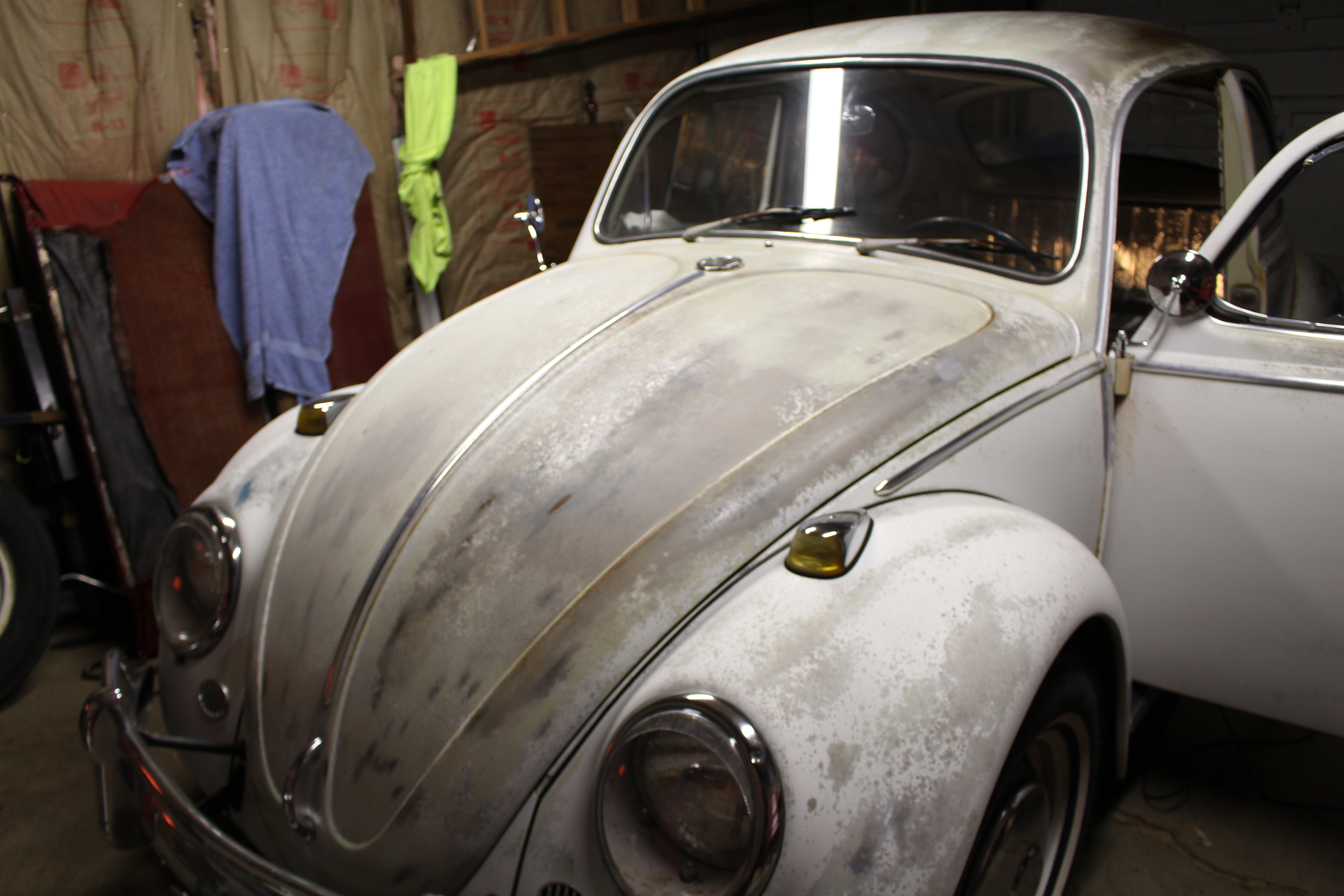

Rolled the car out of the garage this morning to get a good look at how it sits after the drop spindles. I can already tell that an alignment is necessary even though I thought I had it dialed in. I used a product on the exterior called Patina Preserver from Eastwood. Not sure if I'm using it right so I will read the directions again. I think I am ready for the interior to be put back in. I'm sure something is missing. Really excited to get it back on the road.
How many days until spring????

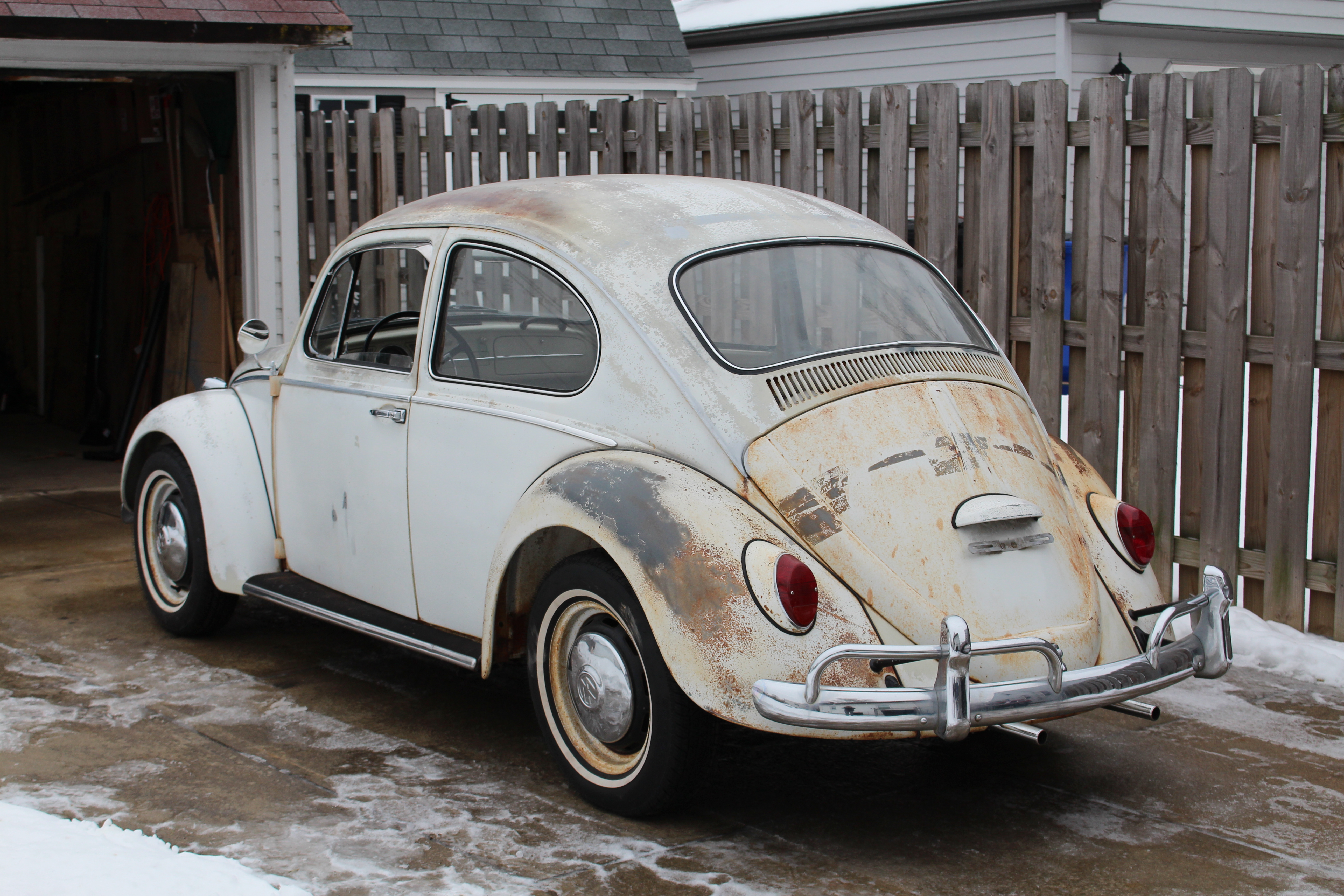

Another view from the other side.
