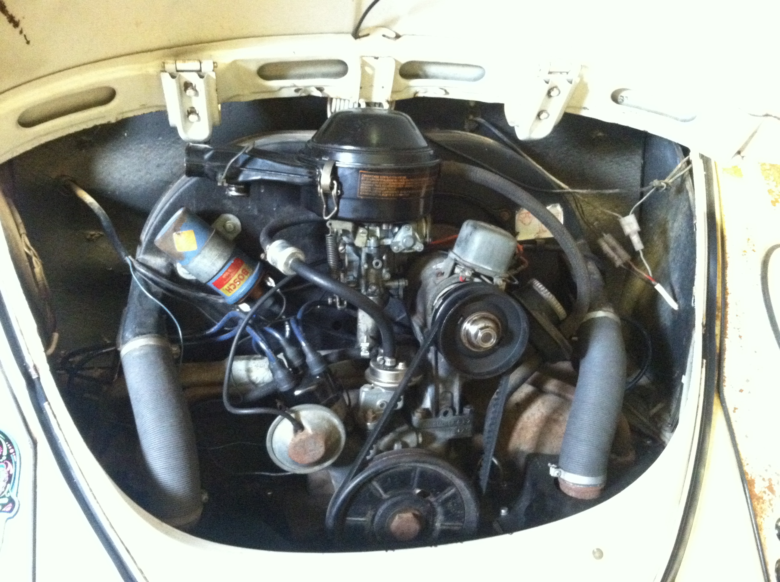

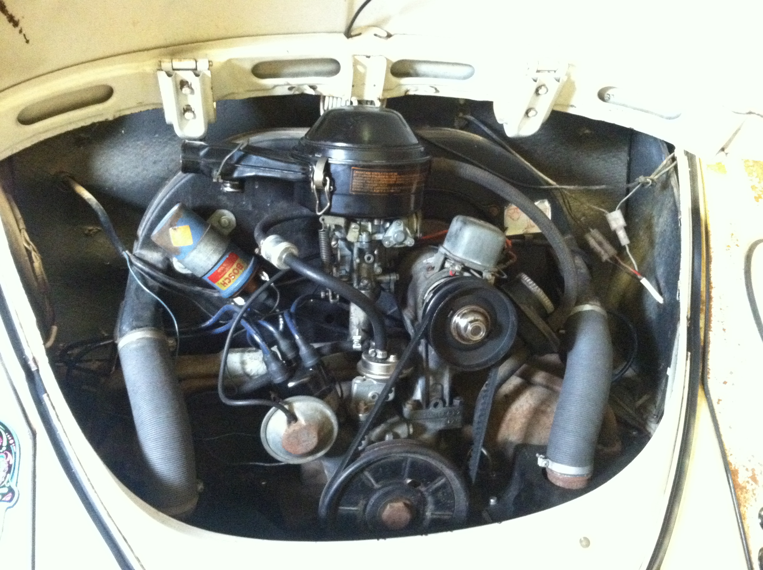

An update on the beetle. I've been cleaning everything I can get my hands on. I've replaced the rubber seals that don't involve taking the body or its parts off. Waiting on the rest of the interior to be made to button that up. Carpet is being installed on the back seat back and then door cards. Headliner and a 12V conversion is still on the list. At least I can drive it with the seats installed. Hope to make a trip to Berea to meet Bruce and see if we can hook it up. Can't wait to get on the road.....I can feel spring in the air, not really, it's still super cold out today.
12 volt conversion coming soon. Until then, tightened the belt and what a difference it made. Also went around and snugged up every bolt I could reach. The back carb bolt was loose, I could swear it runs better now its tight.

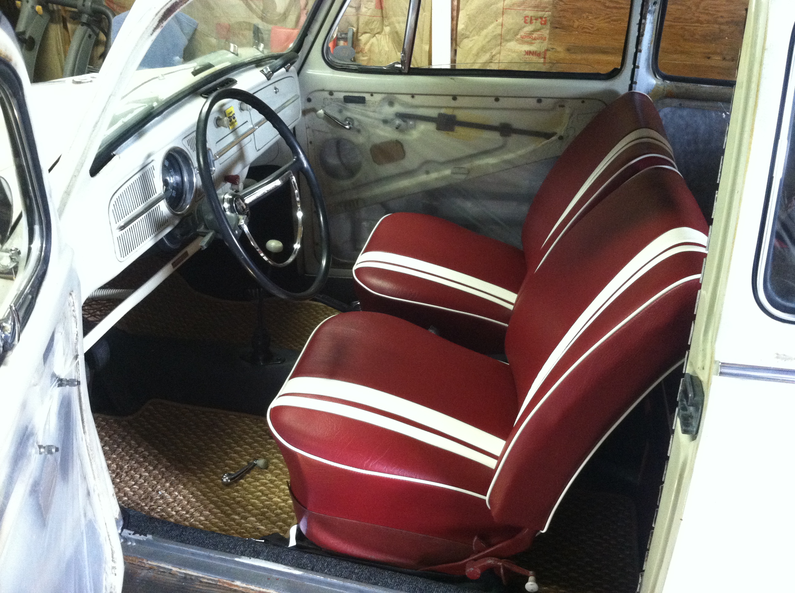

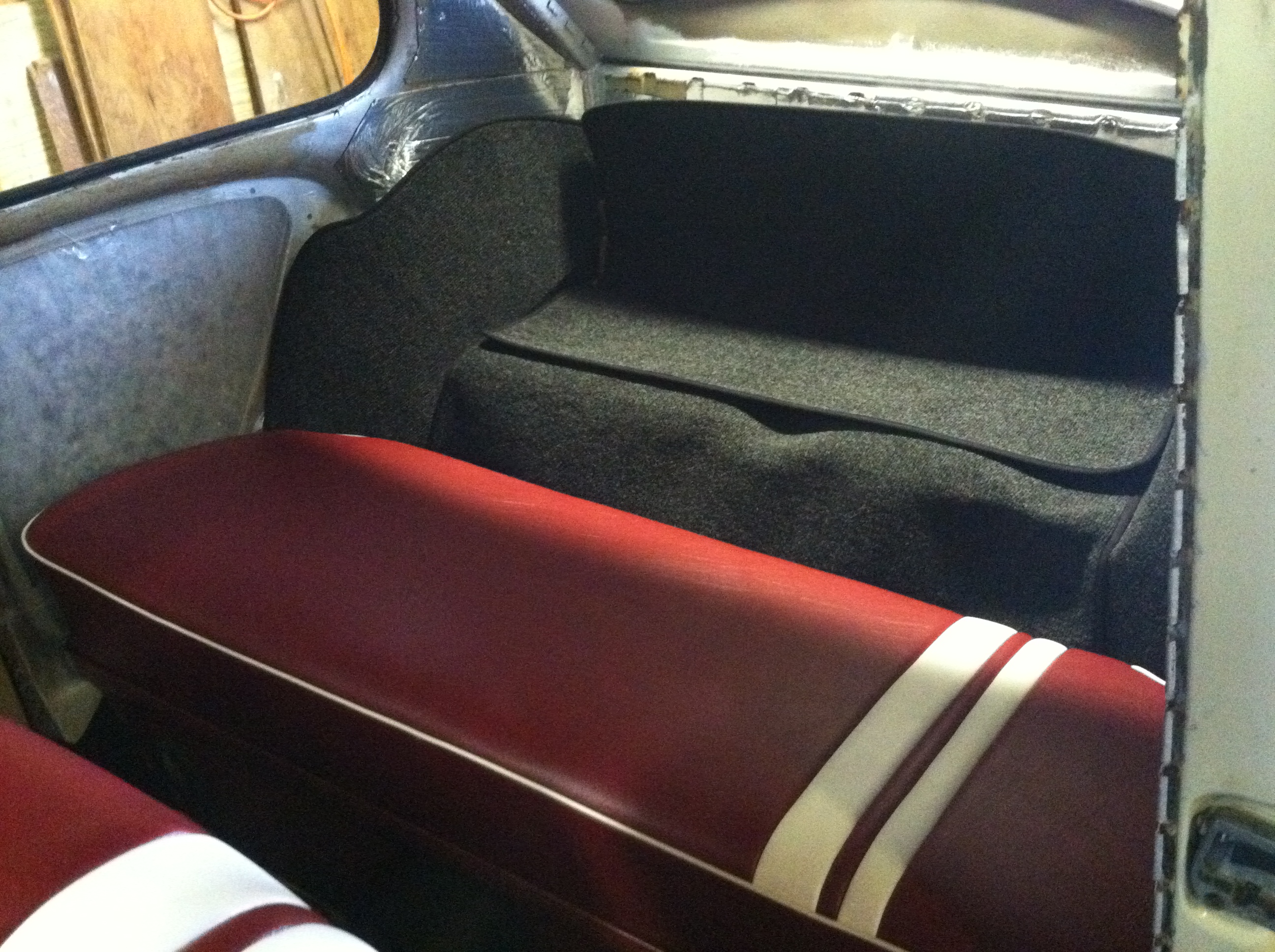

The seat back is being fitted with the carpet and new strap. Door cards still need to be made. Next is the headliner...not looking forward to that but getting some help from Russ Upholstery.
New seal around the hood and new carpet to replace the hard cardboard.
Newly upholstered seats from Russ Upholstery. Super sweet job.

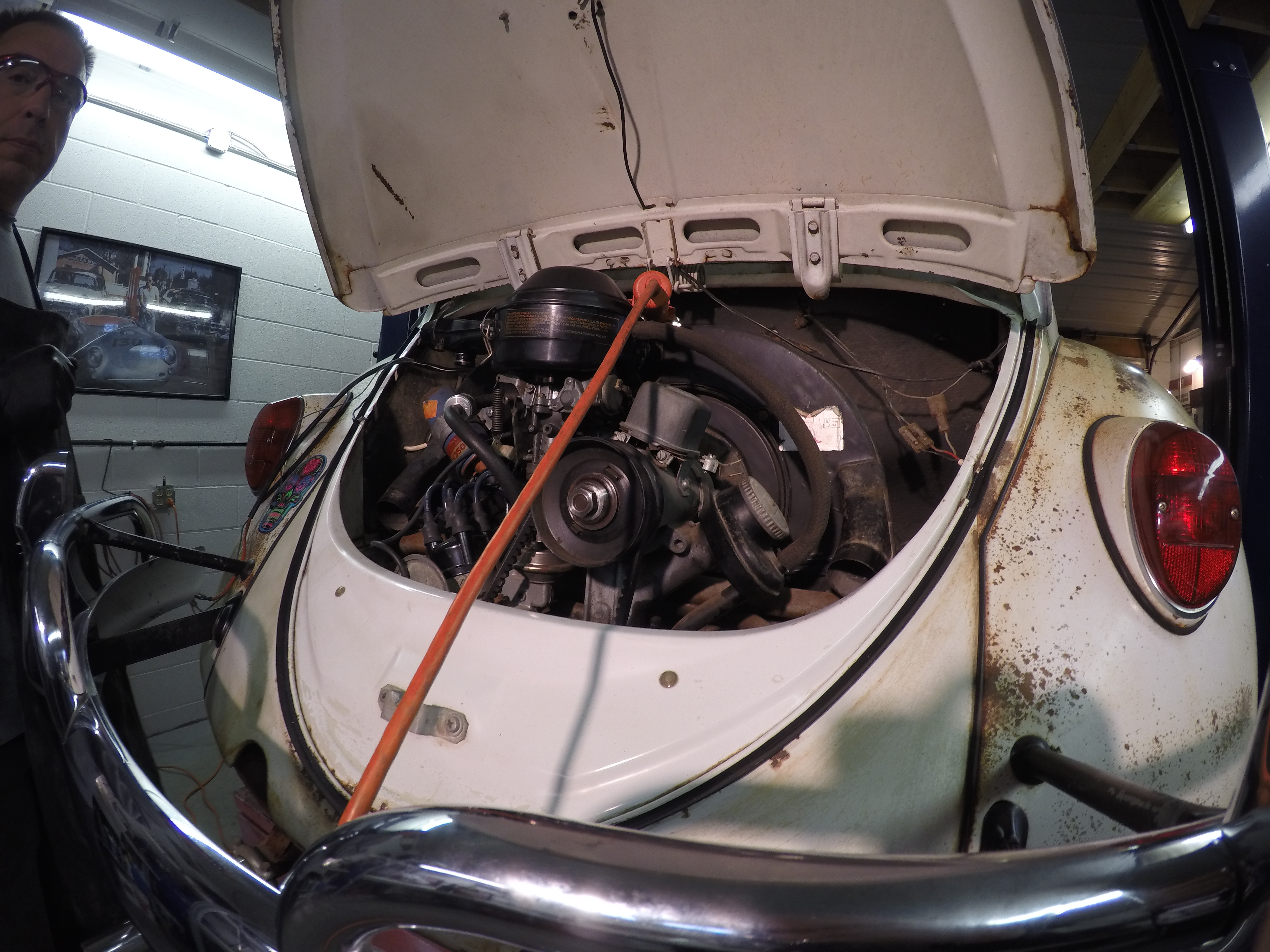

Anyway, let's rack it and get the engine out. I'm putting on a 12v gen and regulator under the seat like a '67-72 would have.
Like before, the engine comes out on the cart. It's an H case single relief.
Surprise, surprise! It has a 200mm clutch in it already, and I didn't recognize the flywheel has the 6v setup right away- it's a 6v tooth pattern and 200mm clutch. Isn't that a one year only '66 bus flywheel? It should have a 180mm clutch if it was OE.

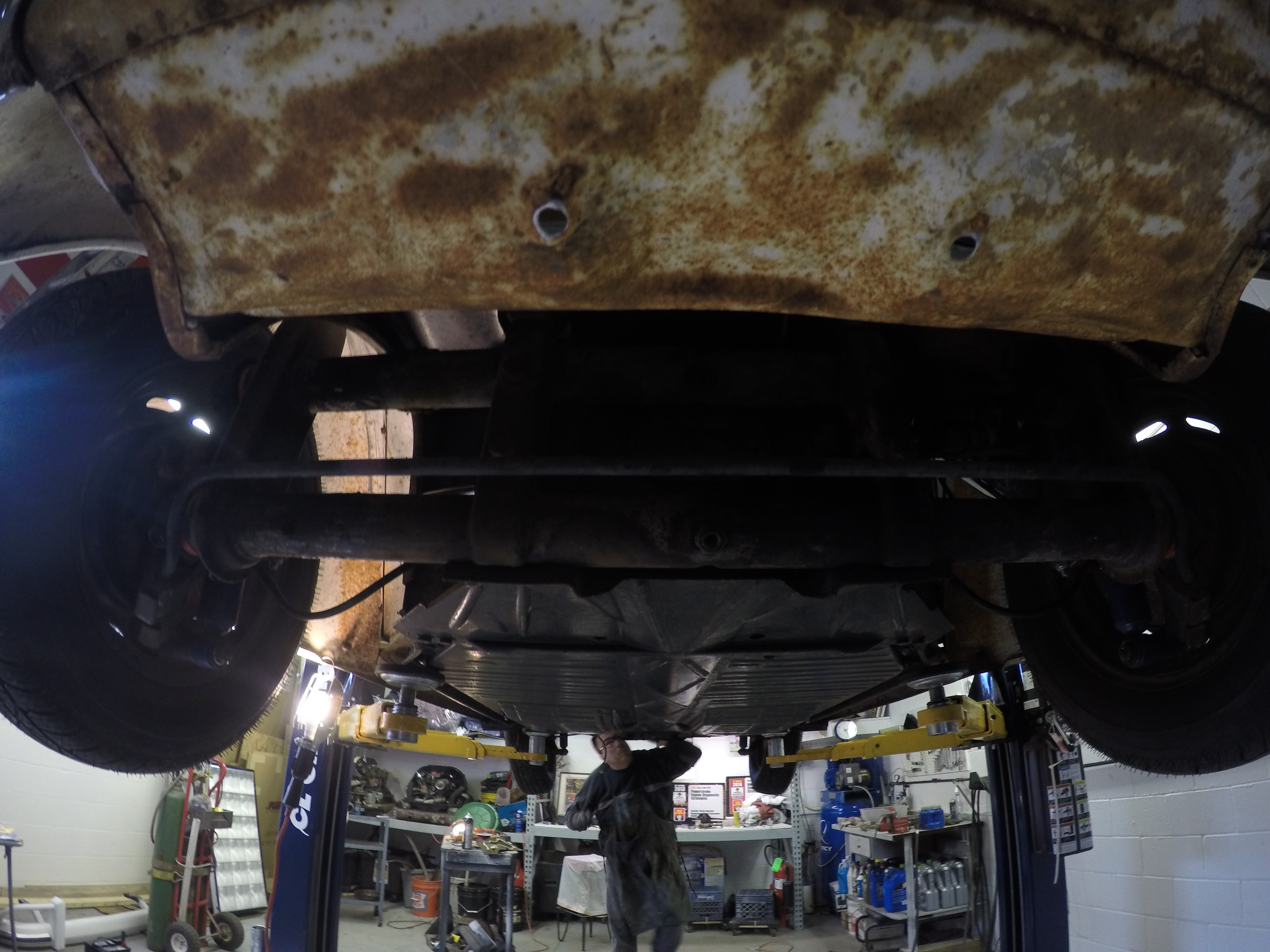

While it's up we'll do some other maintenance like change the gear oil Good thing, as it was as thick as mud and there was less than a quart in it. Luckily the magnets look good.
The axle boots are on wrong and leaking, so those will go away. We pushed it outside and pressure washed the trans/frame horn area while the motor was out.

Of course the last moron used 1/4" hose and a wrongly mounted fuel filter, I just touched the carb inlet and it fell out! This would have been an inferno very soon. Phucking idiots. :evil: The whole car was plumbed with 1/4" hose and overtightened hose clamps, the instant I touched the clamp by the tranny it started leaking fuel. :roll:
I took the carb apart, blew it out, and put a new lid assy on from a spare carb I had that happened to have a 12v choke coil in it already. It's getting all new German fuel hoses, of course.
