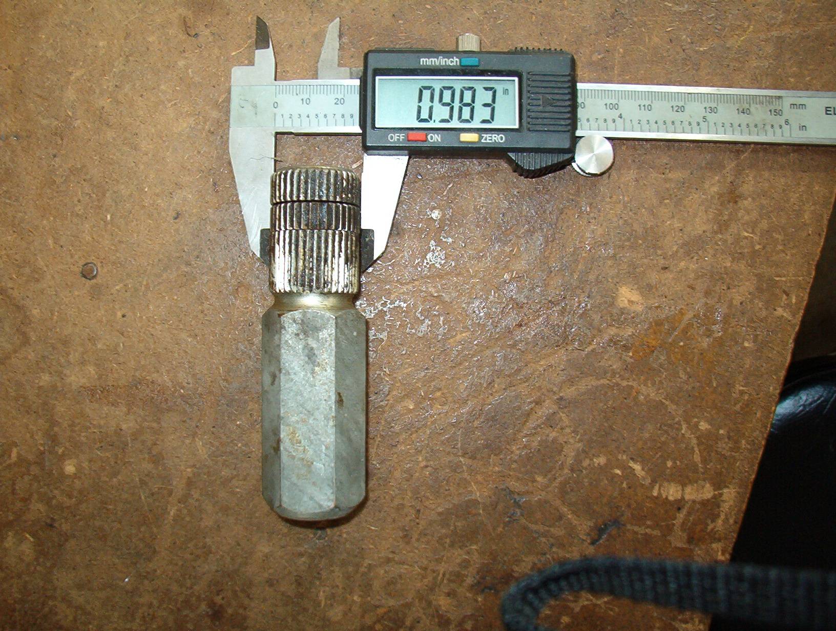

blue71 wrote:Getting the slotted nut out of the generator stand to swap over the filler section to the alternator stand can be a bit of a PITA.
Internal pipe wrench
Re: Trailmix Beetle
toolbox wrote: Internal pipe wrench
That would make life a LOT easier, especially if he doesn't have easy access to the factory tool or the slot is buggered up.

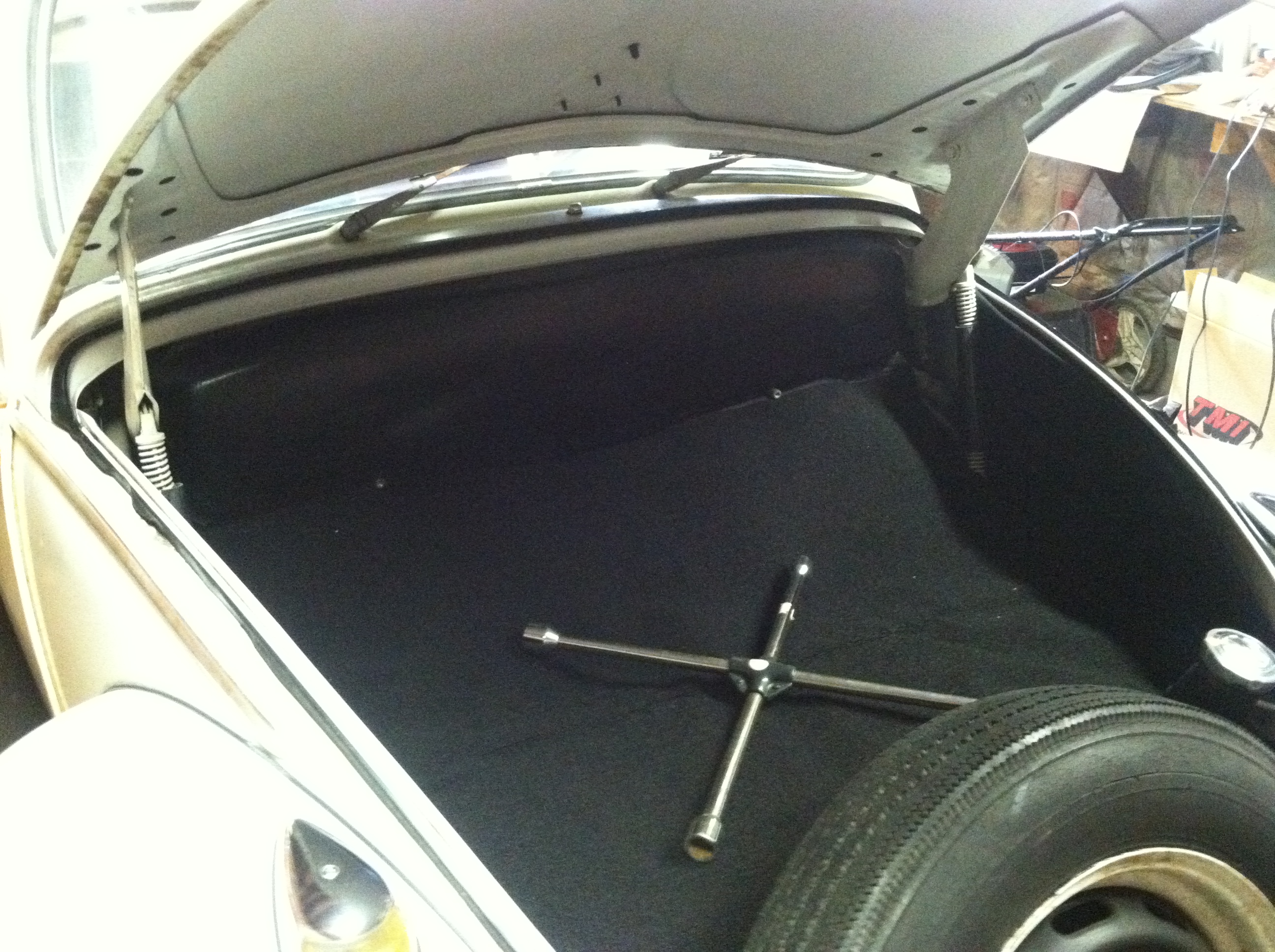

New seal around the hood and new carpet to replace the hard cardboard.

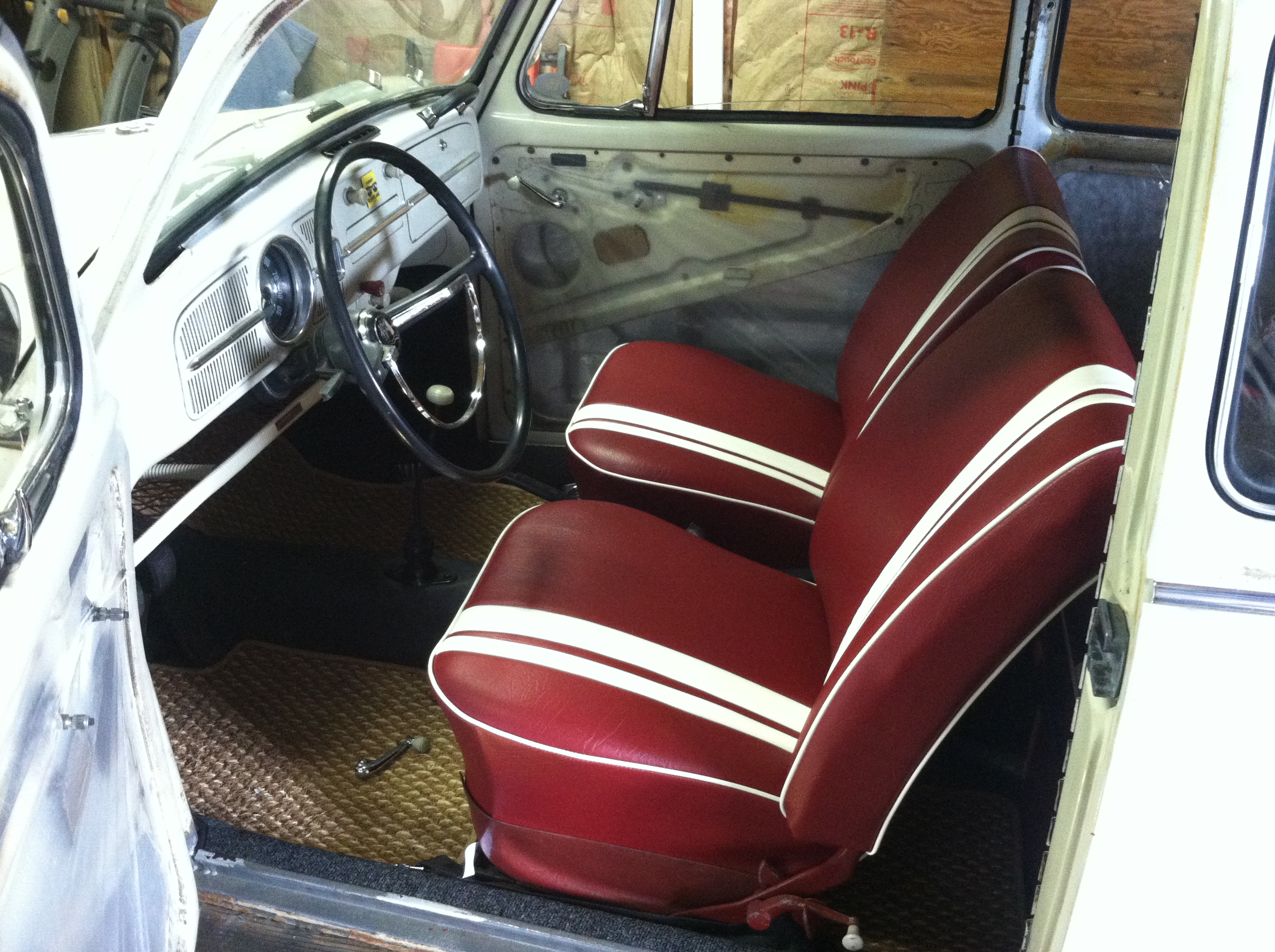

Newly upholstered seats from Russ Upholstery. Super sweet job.

The after market slotted tool is a POS. The internal pipe wrench is the tool to use. You need the one that is 1in diam.
Re: Trailmix Beetle
wwebner wrote:The after market slotted tool is a POS.
I just used mine a couple of weeks ago on my SP and didn't have any problem using it with a long extension and a ratchet or breaker. I don't use it often but have used it several times in the past, it's important the "nut" isn't buggered up from some guy with a chisel.
OTOH, I've had an internal pipe wrench bit break and leave me in a bind (GM heater hose outlet years back).

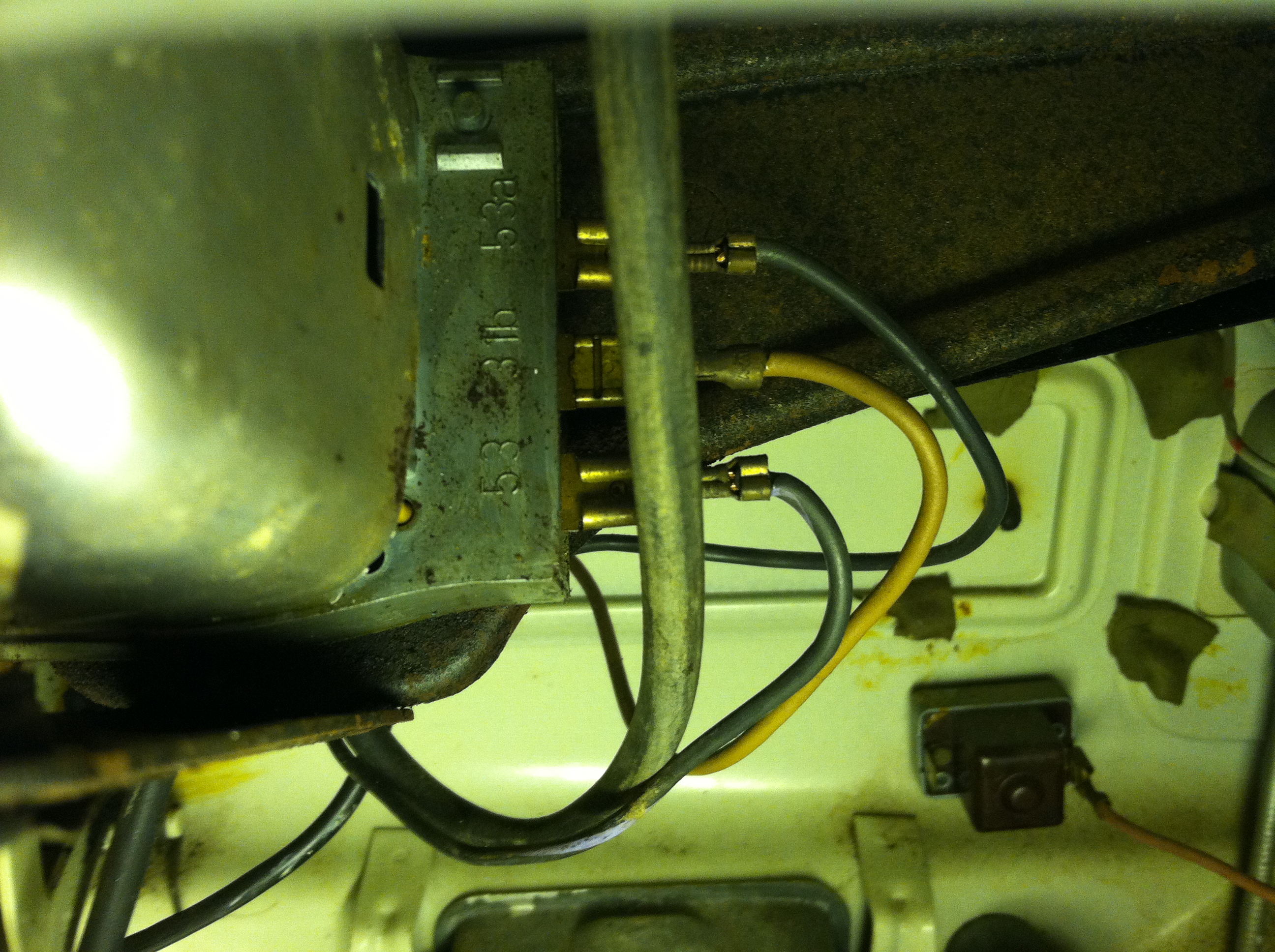

I am trying to finish up the 12V conversion behind the dashboard. I ordered a new 12V flasher box from WW and it works great, even have 4-ways again.
I also ordered a new 12V armature for the wiper motor. "It just drops in they said, like five minutes they said". I looked all over for video or just a thread that explained how to replace it and couldn't find the exact motor that I had. The way it was sitting in the magnets and brushes, there was no easy way to get it out so I had to force it. Fortunately, it went back together nicely.
So now, when I turn on the key, the wipers turn on. Even with the switch off. It seems like its on a fast delay setting. Then when I pull the knob out (one speed switch) they are in fast mode.
So after researching some schematics (which I don't understand but I was trying) and watching some videos, I decided to pull the "parking" wire from the motor. Now they work fine except that they don't "park" at the bottom of the windshield. You have to be right on time with the switch to get them to stop so their not in your face.
I did notice on the old armature that there were countersunk drill marks on the magnets in random places. Is the WW replacement armature just a "fix all" and not specific to my switch?
I didn't take a bunch of photos but I did take a few to make sure I had the wires right when I went to hook everything back up.
