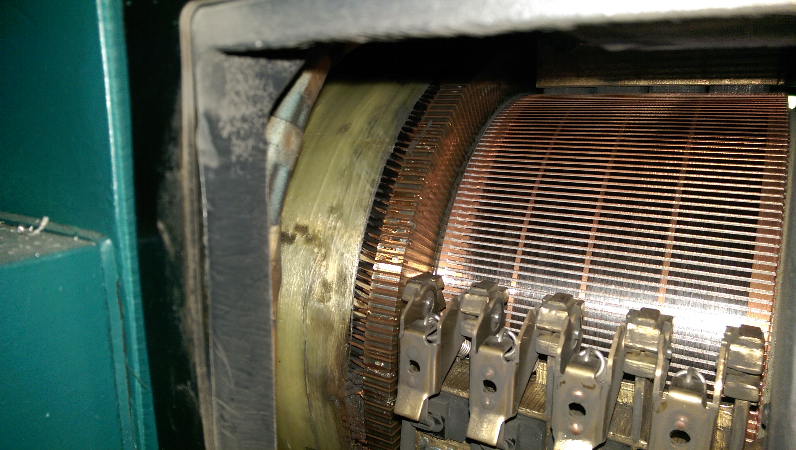

If it is the bottom brush giving the problem remove the neg battery cable, the backing plate fasteners, the wires from the gen, loosen the strap and rotate the gen to get the bottom brush.
Hopefully your comm does not look like this!!
That was a $35K repair.
