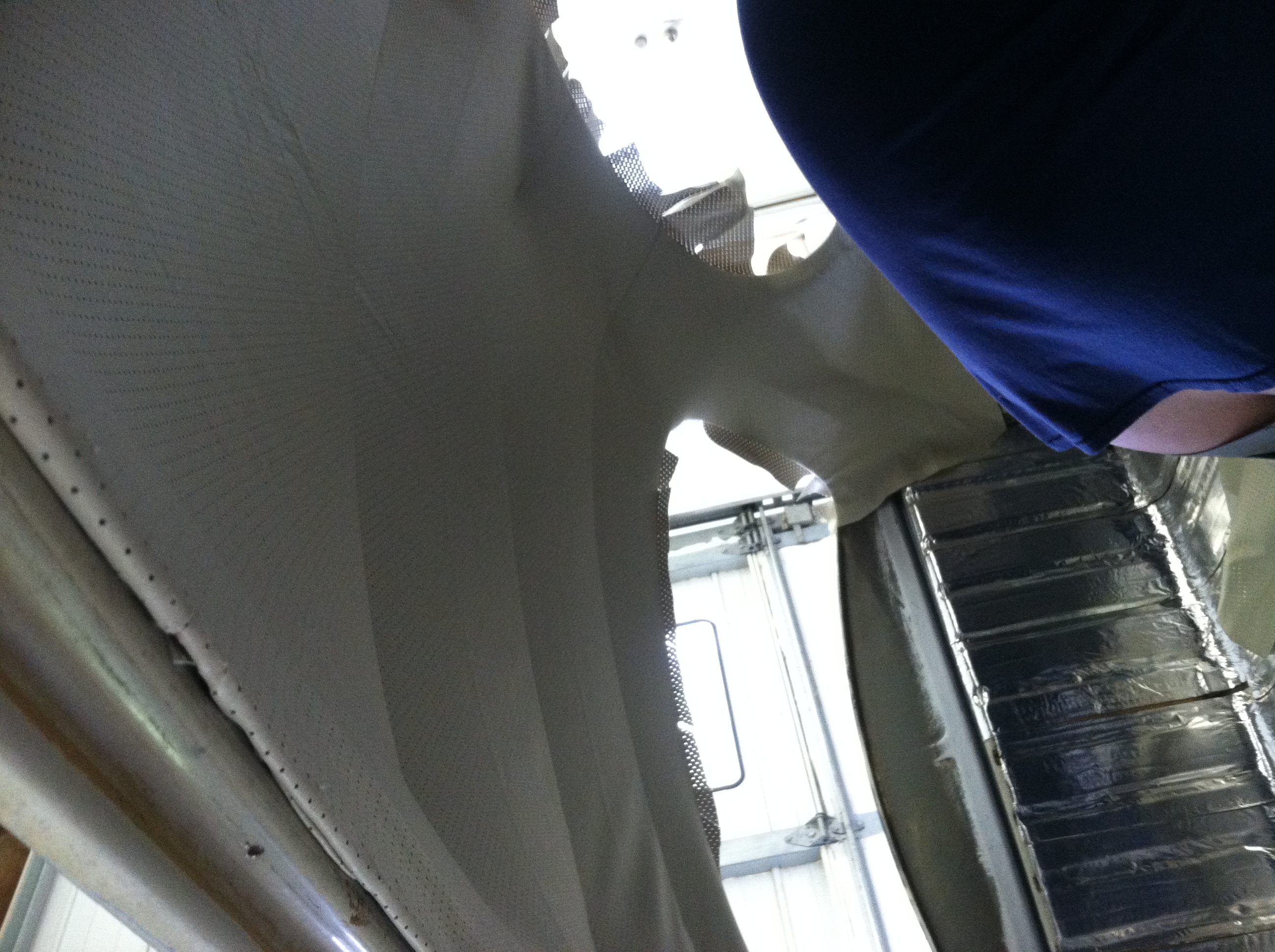

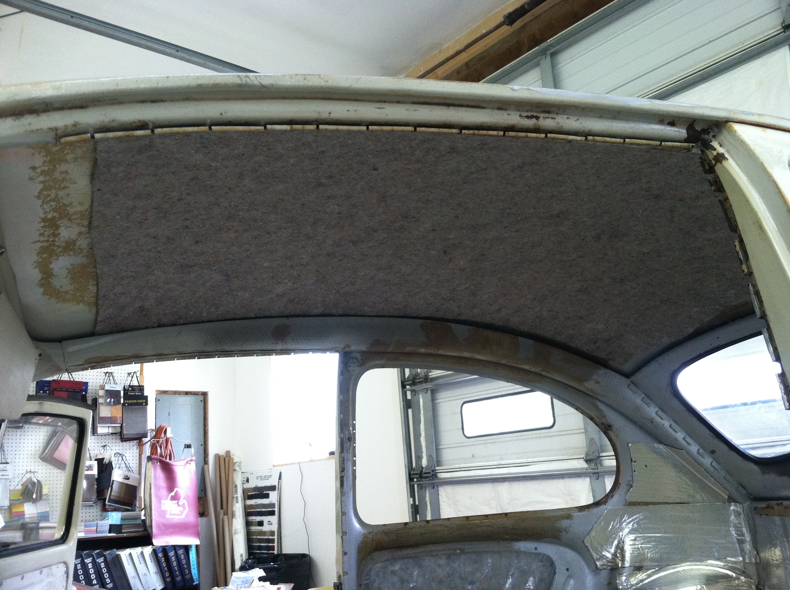

Drove down to Clinton OH to visit a long time friend Mike Johnson (Russ Upholstery) to install the headliner. Although he builds custom interior for all kinds of cars, motorcycle, boat and commercial business, headliners are not on his priority but I talked him into helping me with it. We had some problems with the back window install (wrong seal) and the chrome molding on the quarter windows so that will have to be done again. I will have to take the car to a window pro to get it done right. Not having the chrome molding seems to make a big difference in the look.
I also picked up the rest of the interior while I was there. It really looks awesome!!! I can't wait to get everything installed and clean.
I only got a few pics of the process because we literally didn't stop moving until it was done. I did have to make one call to JBugs for some info on the pieces that were included in the headliner kit.

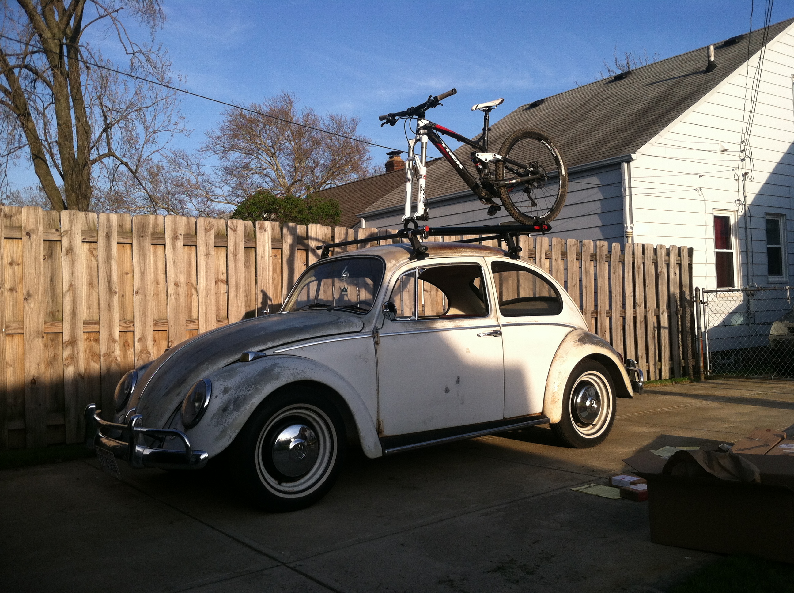

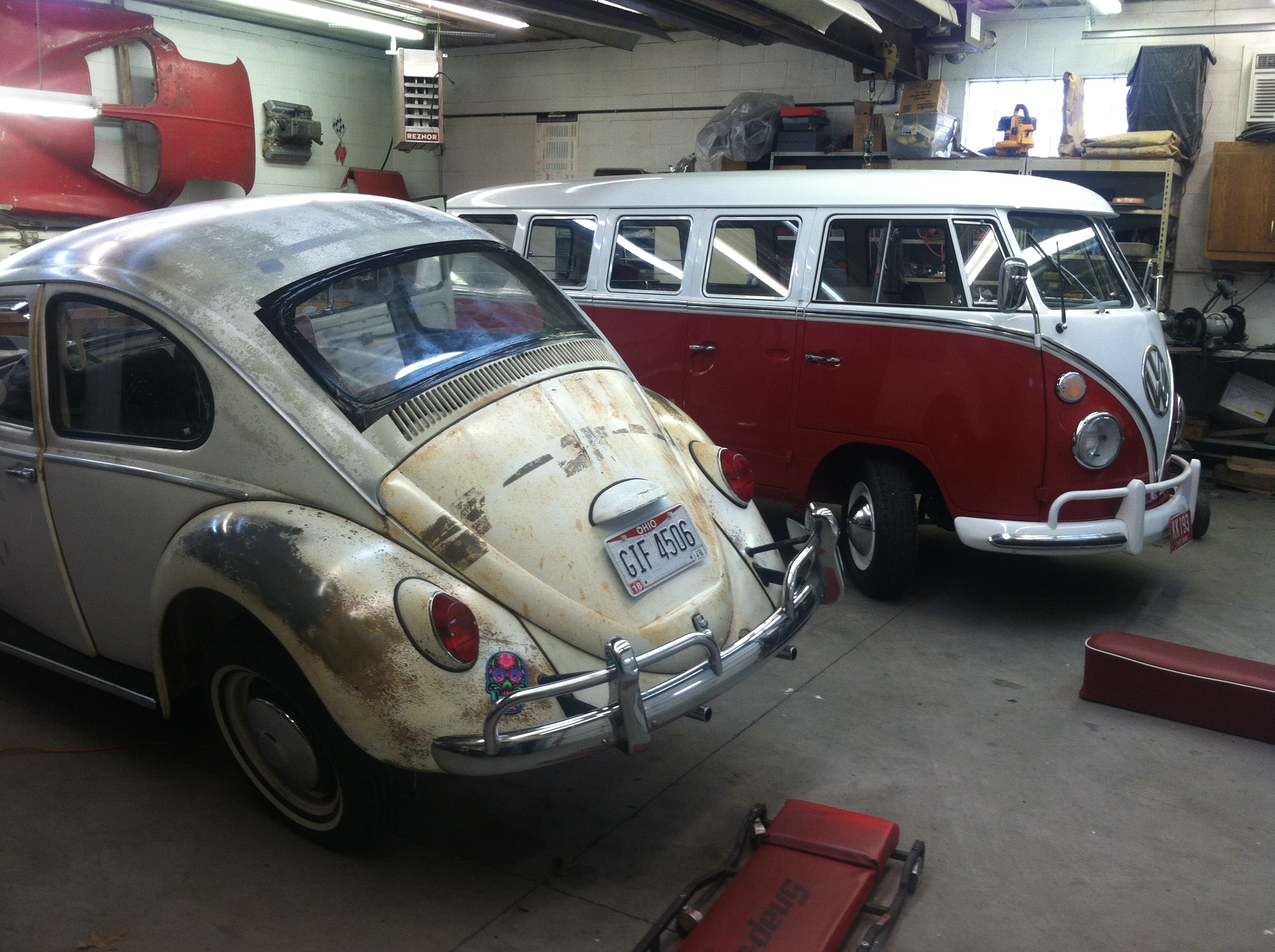

I just came across this photo that I took of Dual Port's secret den of VW sins. The level of detail that Bruce put into his bus is amazing. The level of detail that I took in the paint on my beetle is disgraceful.....anyway, been putting some good miles on the car and even took a good ride down the interstate yesterday. It was actually pretty smooth and fairly quiet now that most of the interior is in. I will be strapping the mountain bike to the top today and going for a rip in Strongsville. Thanks to Yakima Racks for the hook up.

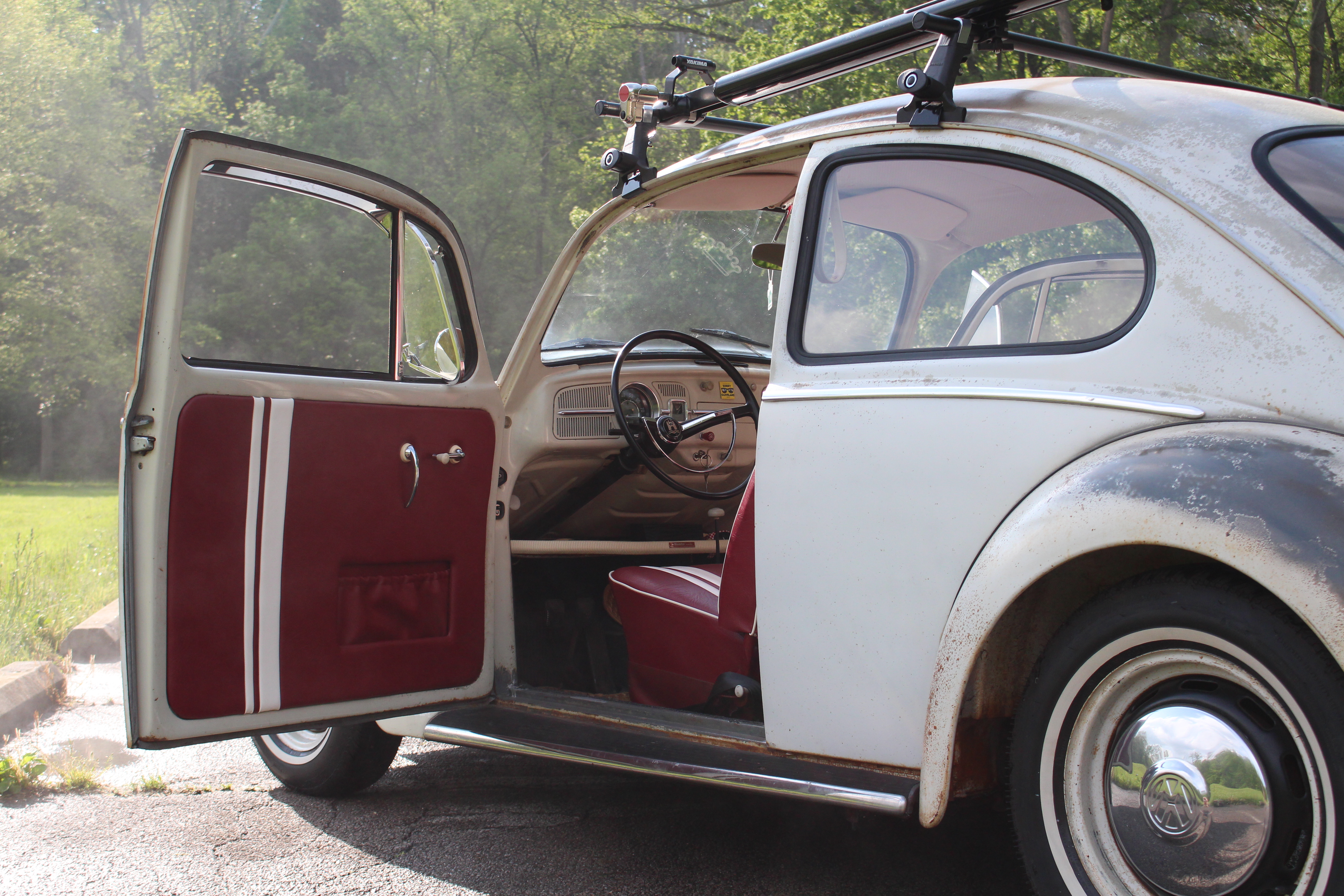

We took Rusty out for a spin after the rains. We had a plan to get the car to the point of driving it this summer. We are so glad that the plan is working out so far. We decided to get some photos of the car on a nice sunny day. The interior is all done but the total project is still undecided. Thanks to my wife for the photos.
