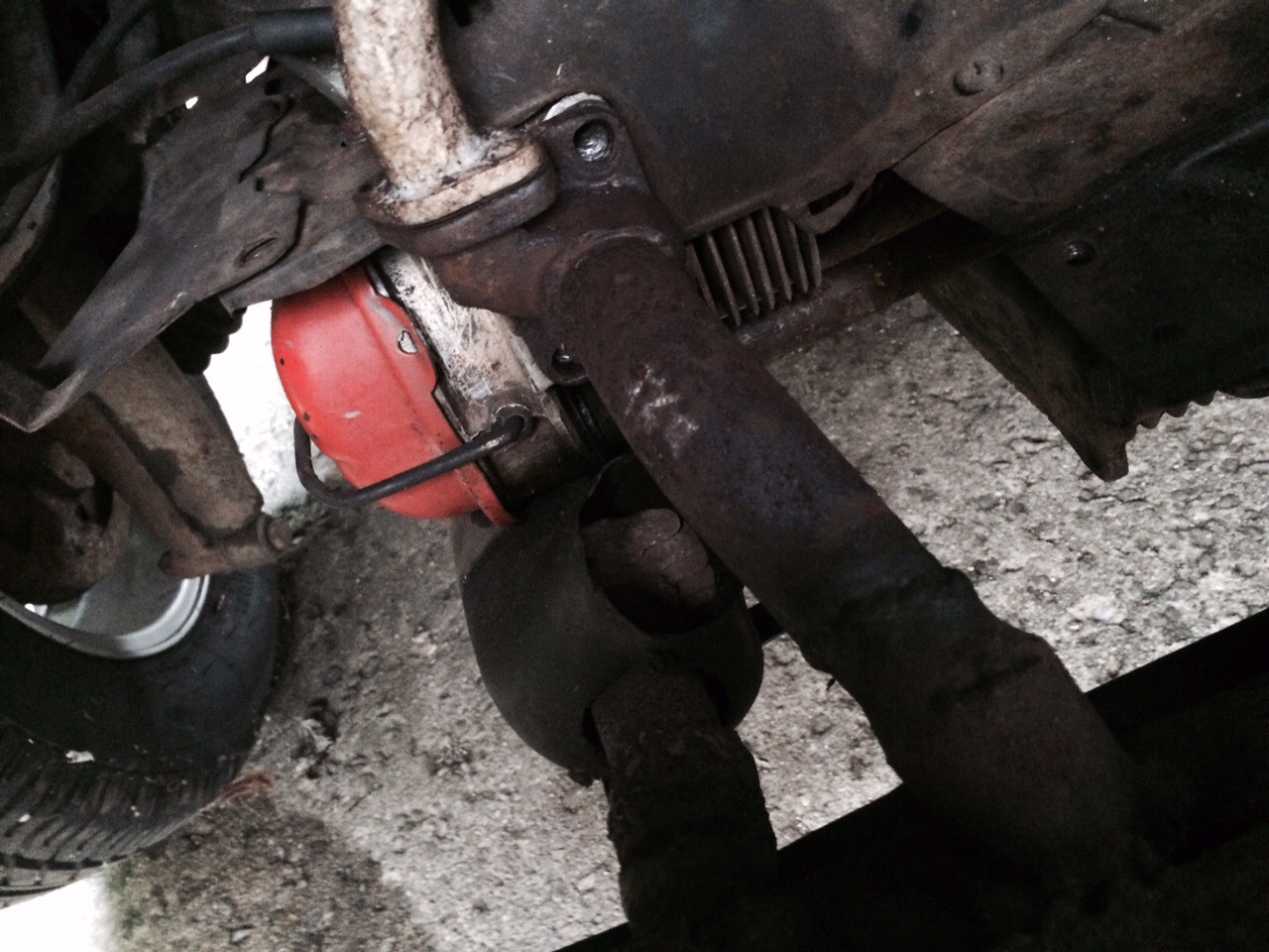

Not sure those heater boxes will be salvageable, see the pics.
Exhaust nuts came out okay on the front for the most part, studs came out on the left hand side. They were not standard either. Rear nuts are proving more difficult. Soaked them a bit more with penetrating oil and will try them later. Looks like I will need to cut the muffler where it is welded to the heater box to get it off the studs.
