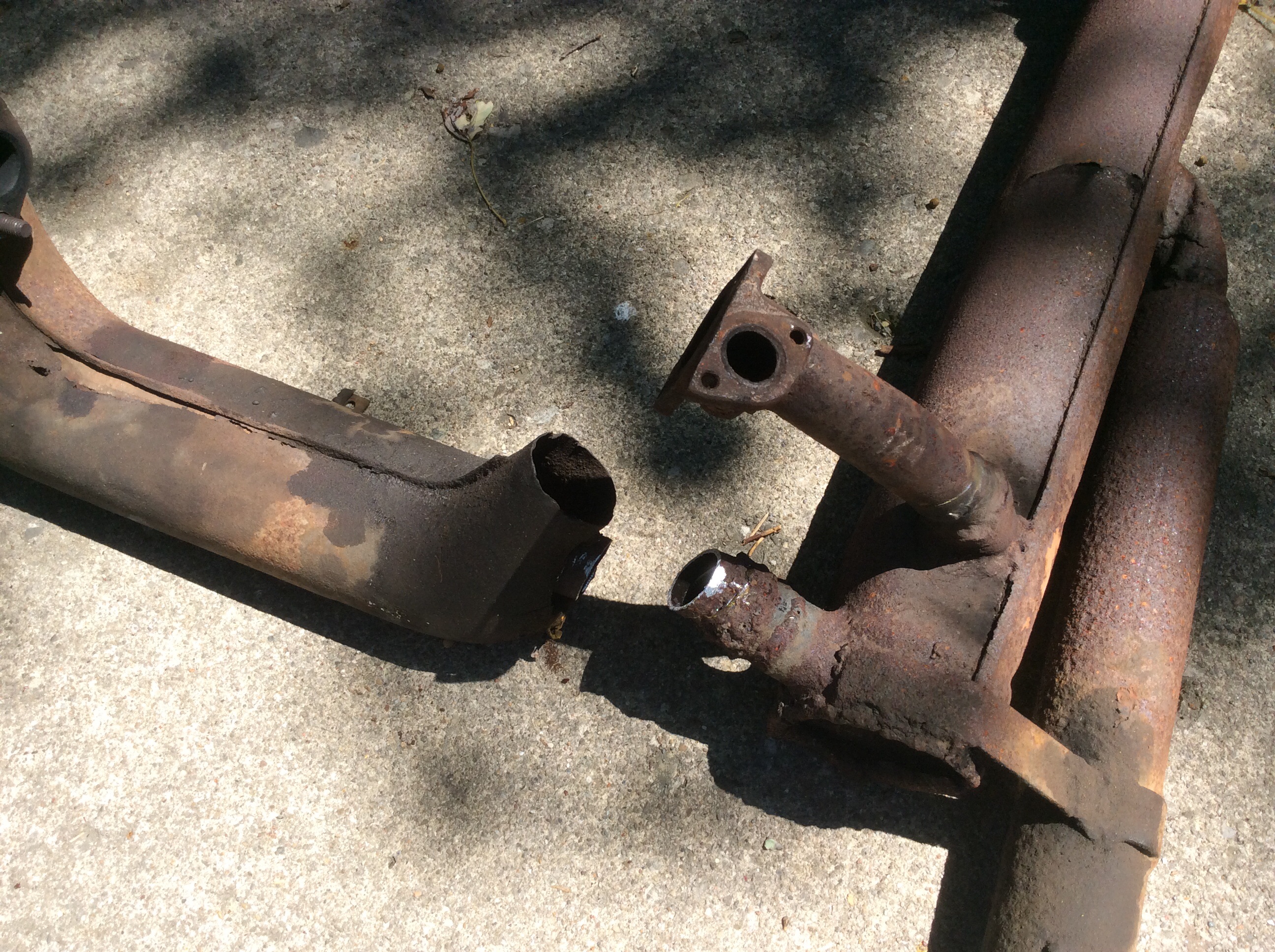

Re: 1974 Double Cab Project
Success! I had to cut it out but I was able to get the exhaust off! Small victories. Nothing much salvageable from this though, the left side heater box was completely rusted out. Each side was welded as the exhaust pipe. Crafty Panamanians! But hey what would you do if you''re in the middle of Panama got no "dinero" but have a welder, some sheet metal and the remnants of a few random mufflers?
Will keep the right side as it is mostly intact, to sell at a swap meet, someone may need it and be able to weld on a repair pipe.

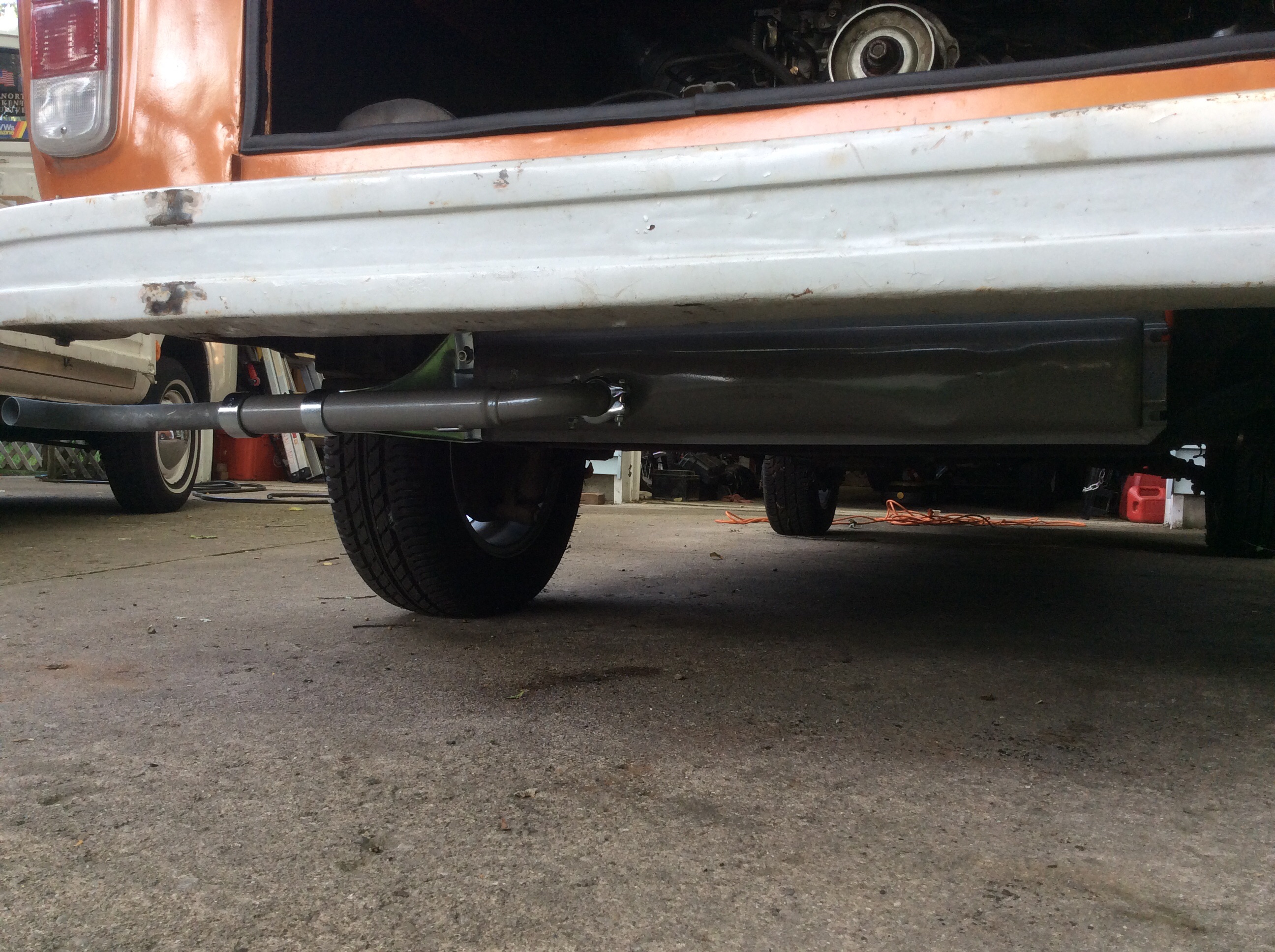

Test fit of the new muffler looked good. I was not 100% sure it would fit because none of the part catalogs listed this for a 74 Bus. Looks like everything will clear just fine.
Bill, thanks for the tip on the reducer stud. The bolt that had been used in place of the stud turned out to be a 10m X 1.50. My local hardware store had a reducing stud from 10m to 8m with a 1.50 thread. Ran a tap to clean it up a bit and put them in. They are slightly longer than the stock studs but worked just fine. Exhaust is in.
Just a top photo of the exhaust.

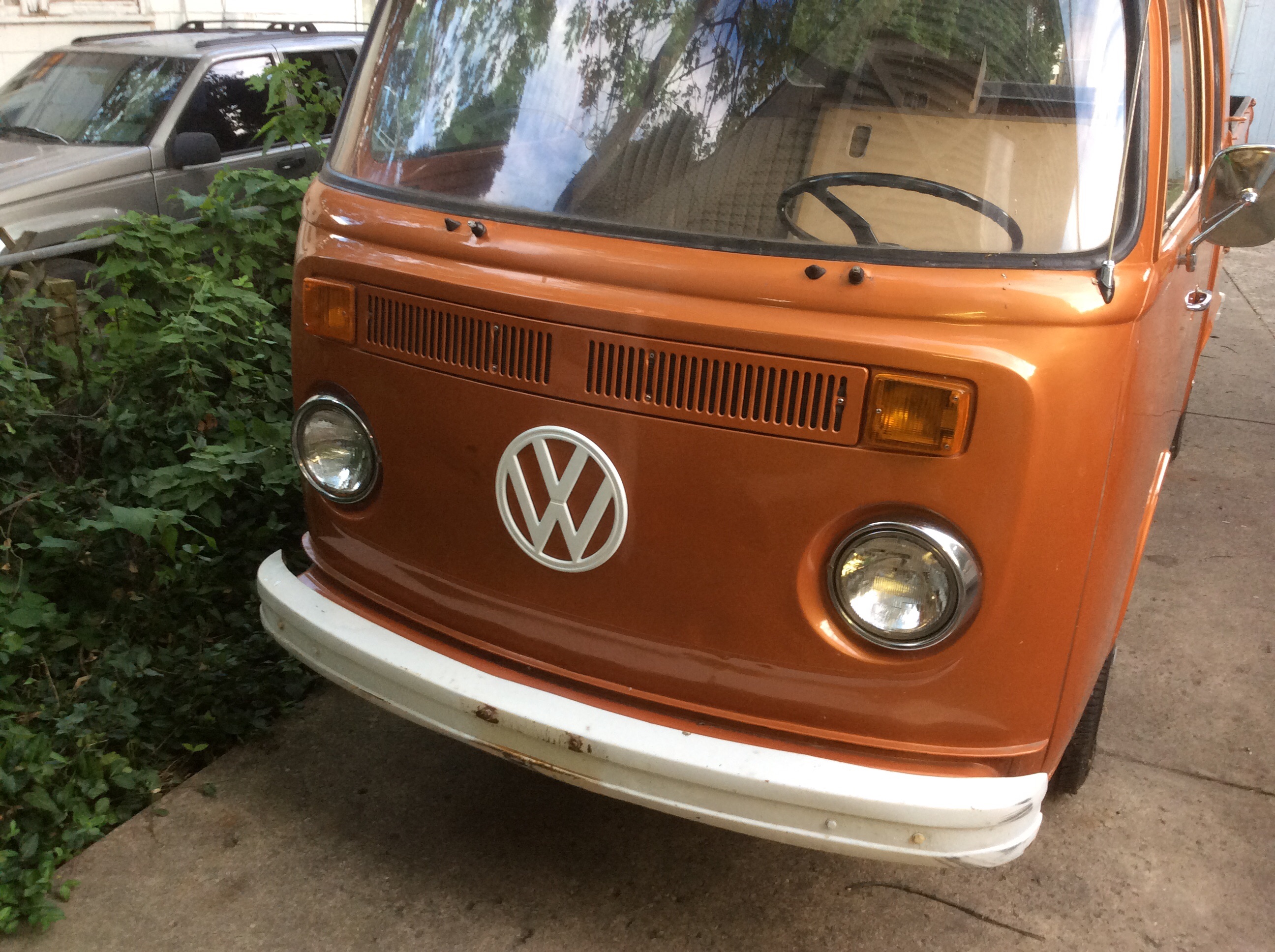

Painted and mounted a new front emblem. I know it is not stock for this year but I think it looks pretty good.
