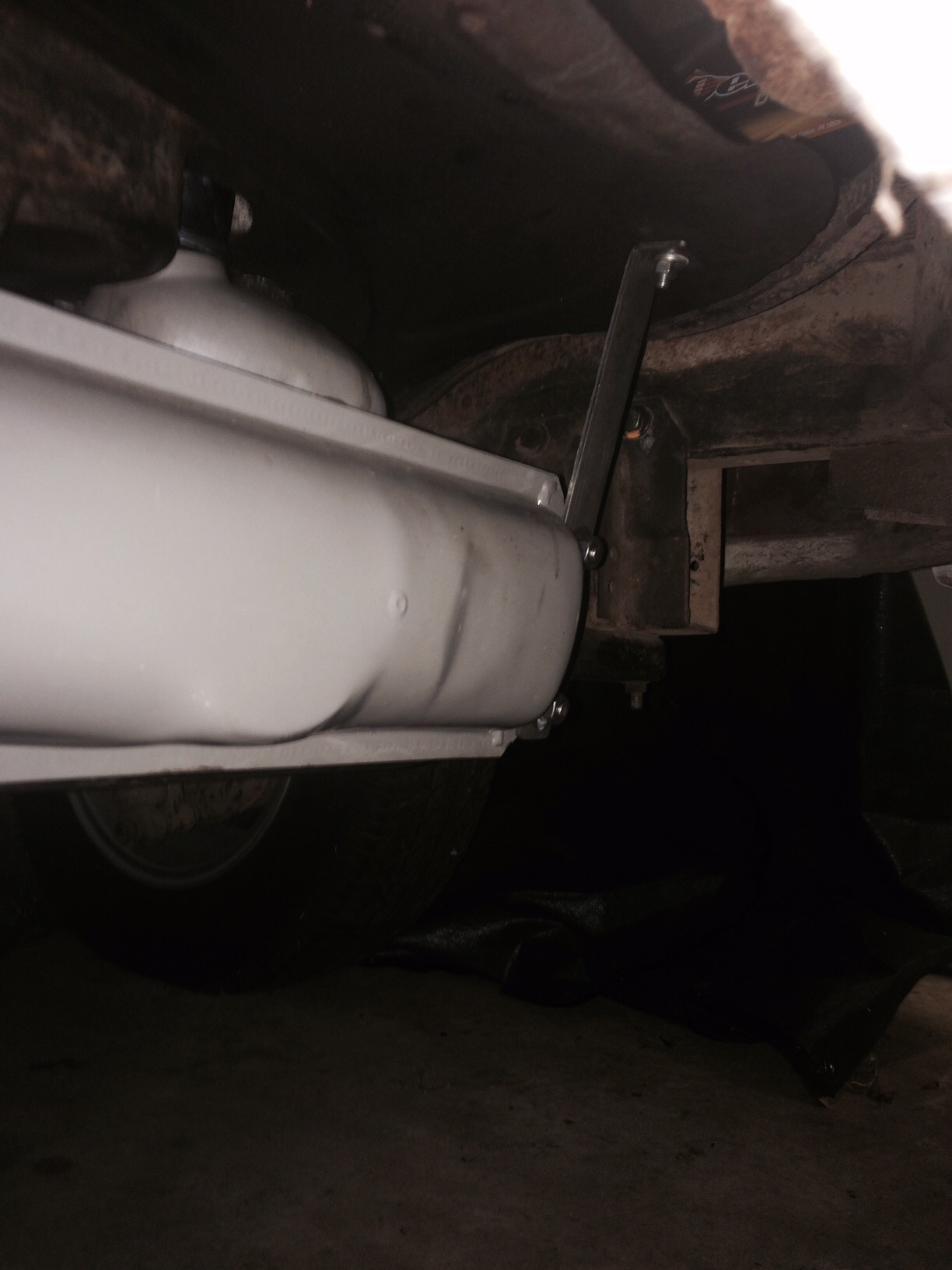

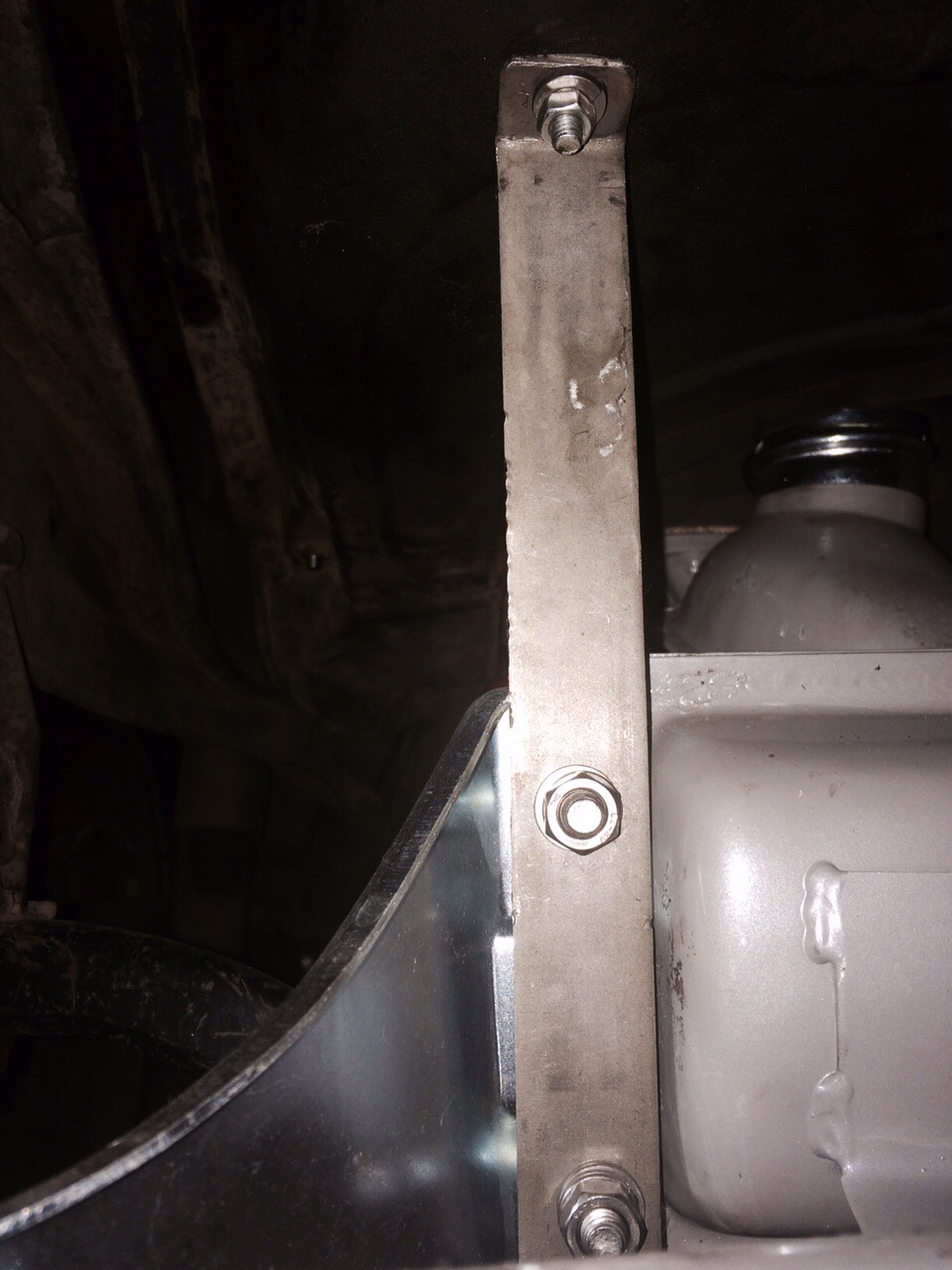

At Kelleys Island I got a chance to check out Chuck Spence's Late Model Bay Window Double Cab. Unfortunately I did not get to meet Chuck too but I hear he is on the mend and wish him a speedy recovery.
I was really interested to see the engine tin. The tin in my DC had been beat up over the years and required a bit of TLC. Looking at Chucks confirmed that I was not missing any tin, which is good because I understand it can be difficult to find. ( in metal at least). A lot of the screws were missing on mine so I replaced those and added some washers to provide a little added stability. I had hoped this would tighten up the tin, especially the rear piece, as it sagged well below the lip that supports the other side of the foam seal. Stress fractures and metal fatigue appear to have taken their toll over the years. I noticed two holes in the rear piece directly above the ends of the stock muffler. The stock muffler has a bracket on either side to attach the tail pipe to. This seemed to be a logical place to attach a support to lift the rear of the tin and keep it level with the foam seal lip. I know it is not stock but it does not look to bad and ended up working very well. I made the brackets out of steel and used stainless hardware to attach it to the muffler. Best of all I did not have to alter the muffler in anyway and was able to use holes already existing in the tin.
