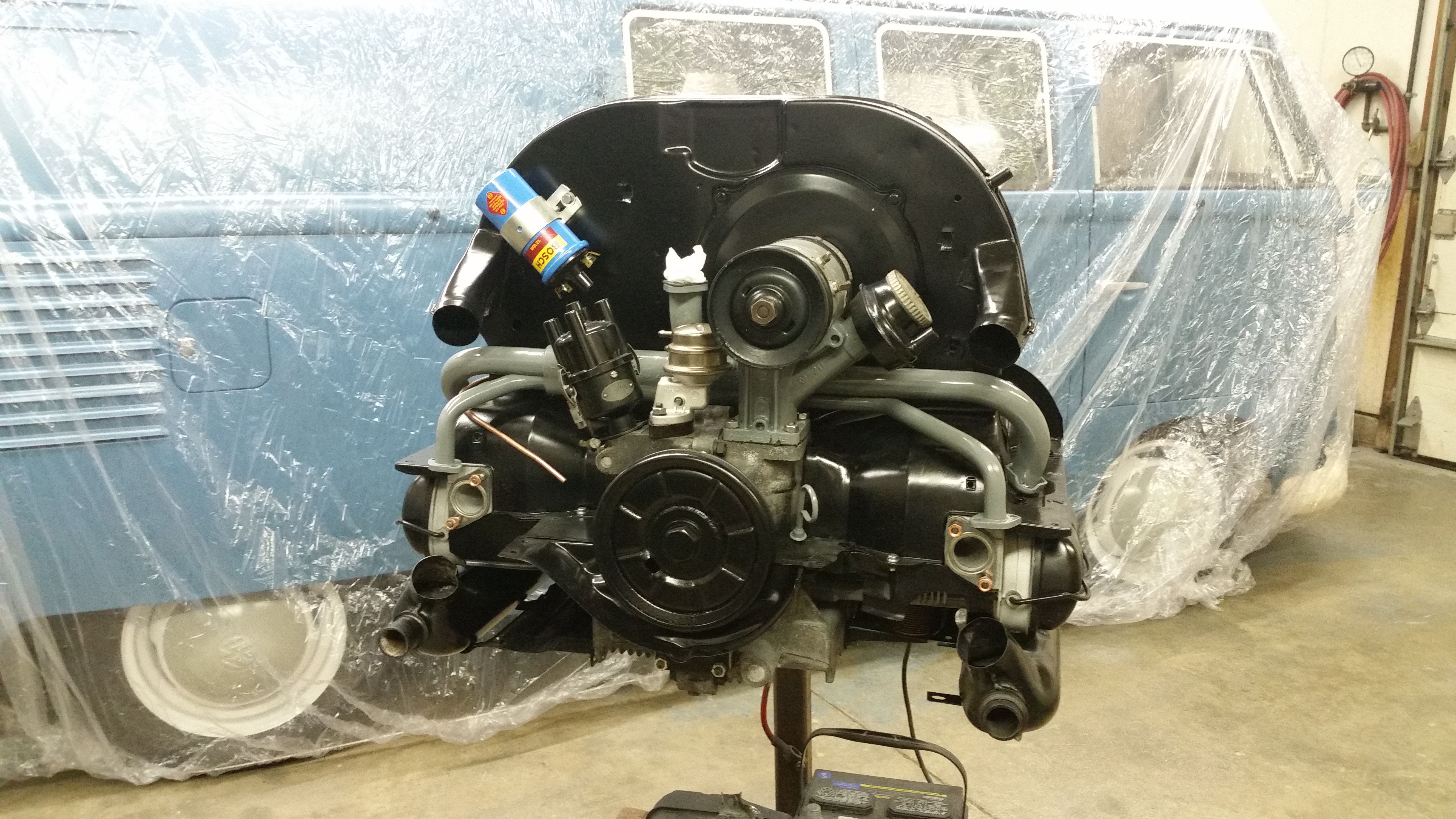

The new engine has been test run and almost ready....
Posts: 1778
I was planning on having to use the adapter to get the heat to work.
Thanks for all of the help on the engine Kirk. I will be scheduling a pick up soon!

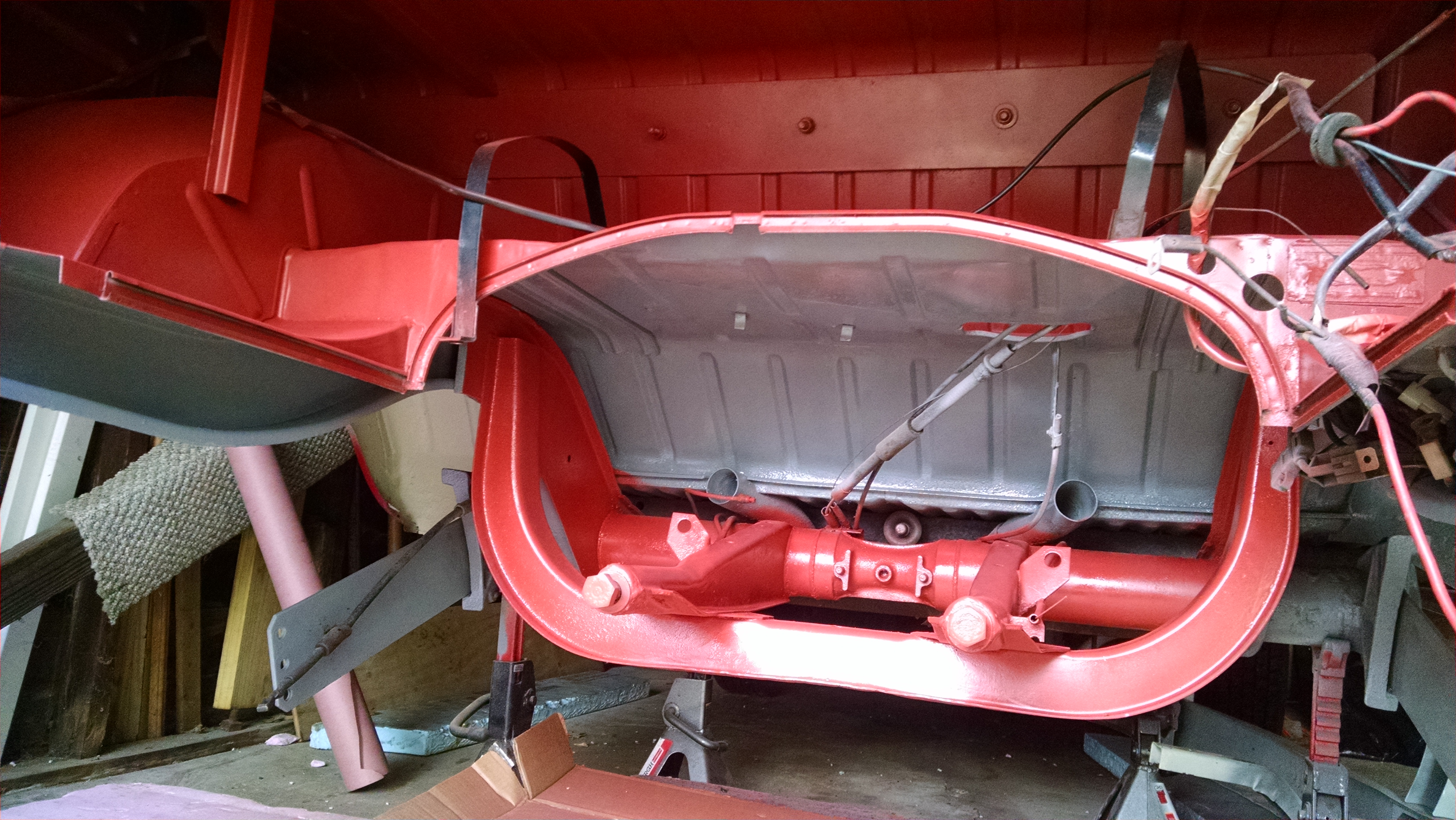

Almost done with cleaning and painting the underside of the rear and the engine compartment. Still need to put the finish on the wheel wells and hit some areas that are light. I have been collecting and buying parts as well. I think I have almost everything.
One step closer to reinstallation. :D
Nice work Marla looks great!
Posts: 462
Very Nice!
What's that metal plate on the firewall? something Westfalia related?
Posts: 1778
A previous owner put that in to install seat belts. I took out the seat belts but left the plate and bolts. I didn't want holes.
