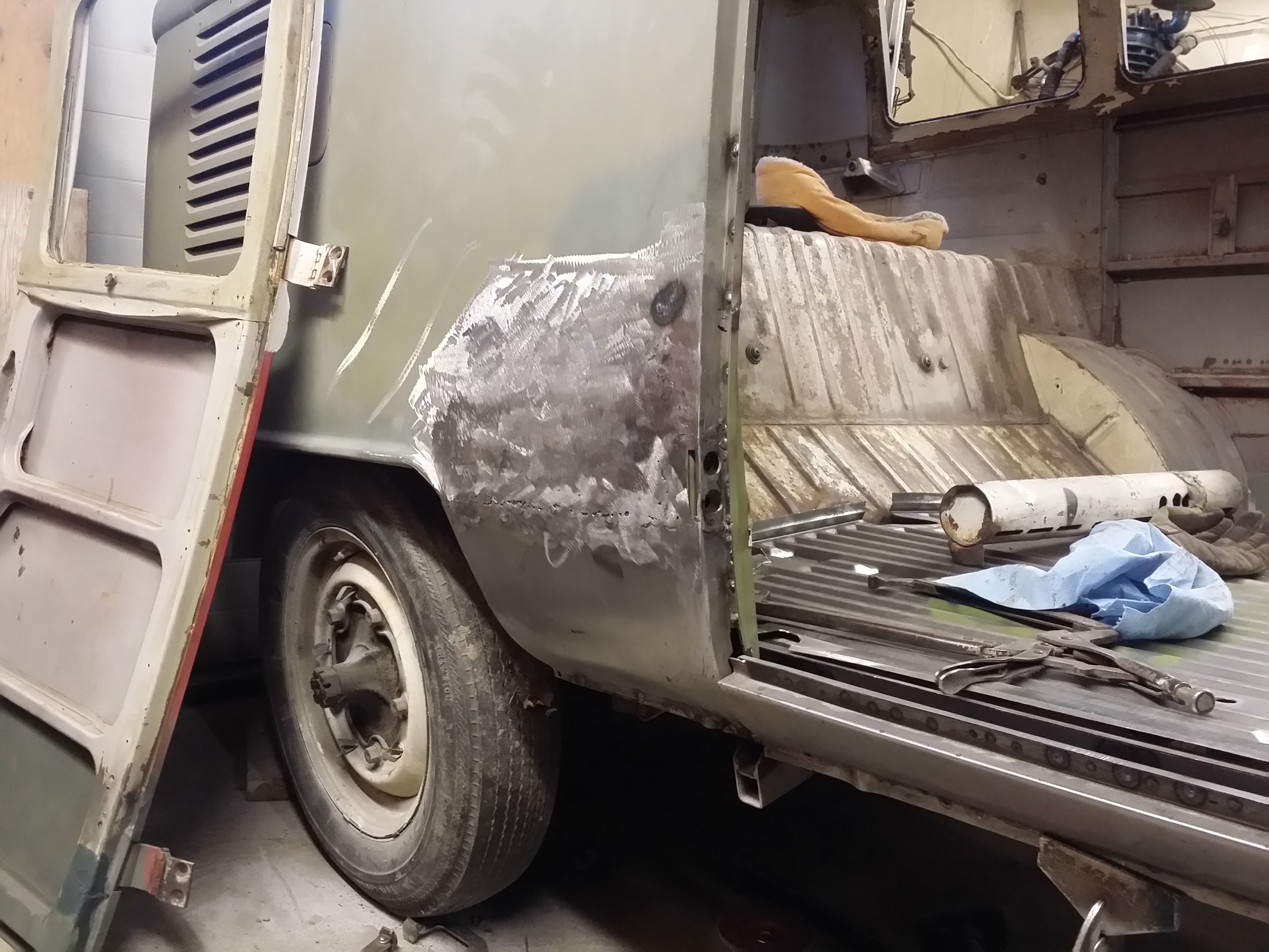

Had a few good days out in the shop over the last couple of weeks I finished welding all the outriggers and Jack Points in solid. I got the inner rockers in and started looking things over to see how I was going to tackle lining up he cargo doors and cab doors. I knew it was going to be a lot of on and off with doors. I began by fixing the C pillar
I am a big fan of using trammels verses just taking measurements..Luckily there are enough extra holes all over this bus that I found a couple that I could use
I figured I might as well fix this first
I dup through some scrap and figured I could separate the outer skin and stitch this in
Once that was done I finished off the C pillar. The trammel made exact location easy enough
I moved over and took a look at the B pillar..well where the B pillar should have been I ended up having to add an extension onto the inner B pillar I was just about an inch or so short. I bent up a piece and tacked it together
I lost count of how many times I have had the doors on and off All of this end is just tacked as I am beginning to fit the cab doors and dog legs. I finished the short rocker I am pretty confident on the C pillar position.
I did a little test fitting of the cargo floors ...they are still half an inch short so I straightened out the end and rebent it
More dogleg and cab door alignment this week
