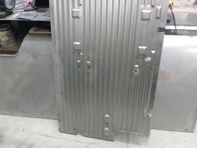

Can anyone tell me what these holes in the cargo floor are for. I assume for seat bolts?

Seat belt anchors?

Correct. 66 and 67 had them and possibly 65 and 64.Ken wrote:Seat belt anchors?

The holes end up right on top of the I beams....is there a bolt with some kind of special backing plate that you weld to the I beam?
Could someone take a pic if they have this setup in og form?

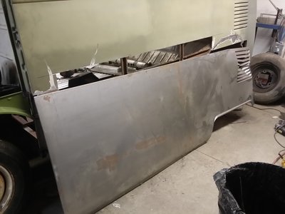

Well with the warm weather ahead it feels like spring. That
means this old pile is going to the back burner. I made a lot more progress on it
than I thought I would. I am pretty happy with getting the cargo doors done, cargo rocker, small rocker, doglegs both sides, long panel, and most of all the nose back on with windshield frame.
