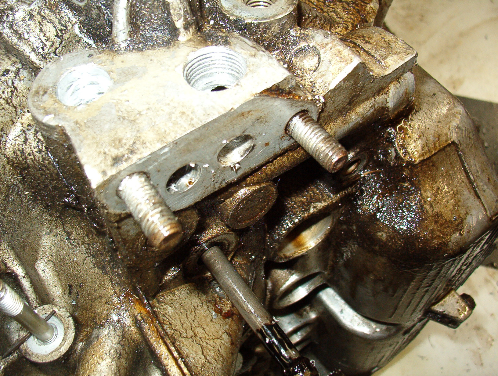

Still waiting for the crank to come back from DPR. In the mean time,the heads came back from Delzani's,as mentioned above.The heads looked good upon teardown. my only concern was that the valves seemed to be sitting a little deep in the seats. I did not get a pic prior to sending them off. Turns out that the Chinese valves used in the AMC heads have very thin heads. Most likley the reason for their pre mature failure associated with these heads. However,the castings are very good. Most reputable T4 engine builders routinely throw them away and replace them with GOOD valves. The new TRW/Kolbeschmit valves sit up nicely on the seats.
We can't do much more until we get the crank. We did pull all the oil galley plugs and tapped them for plugs. This will insure that when the case goes for cleaning,any remnants of that nasty red silicon that the last guy used,along with any other foreign matter in the oil passages will be cleared out.
