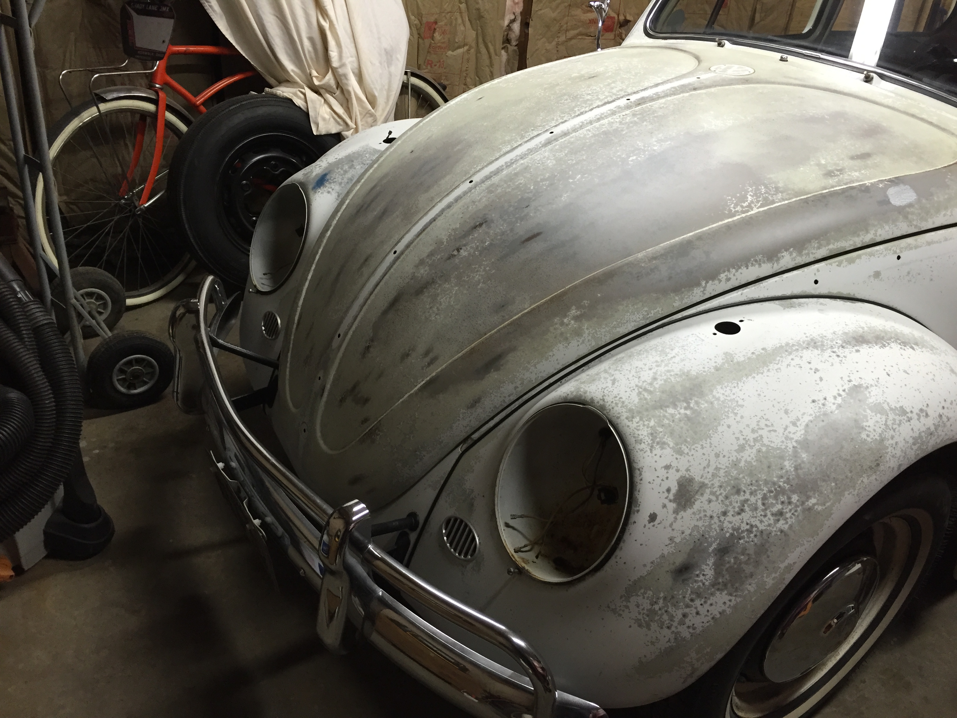

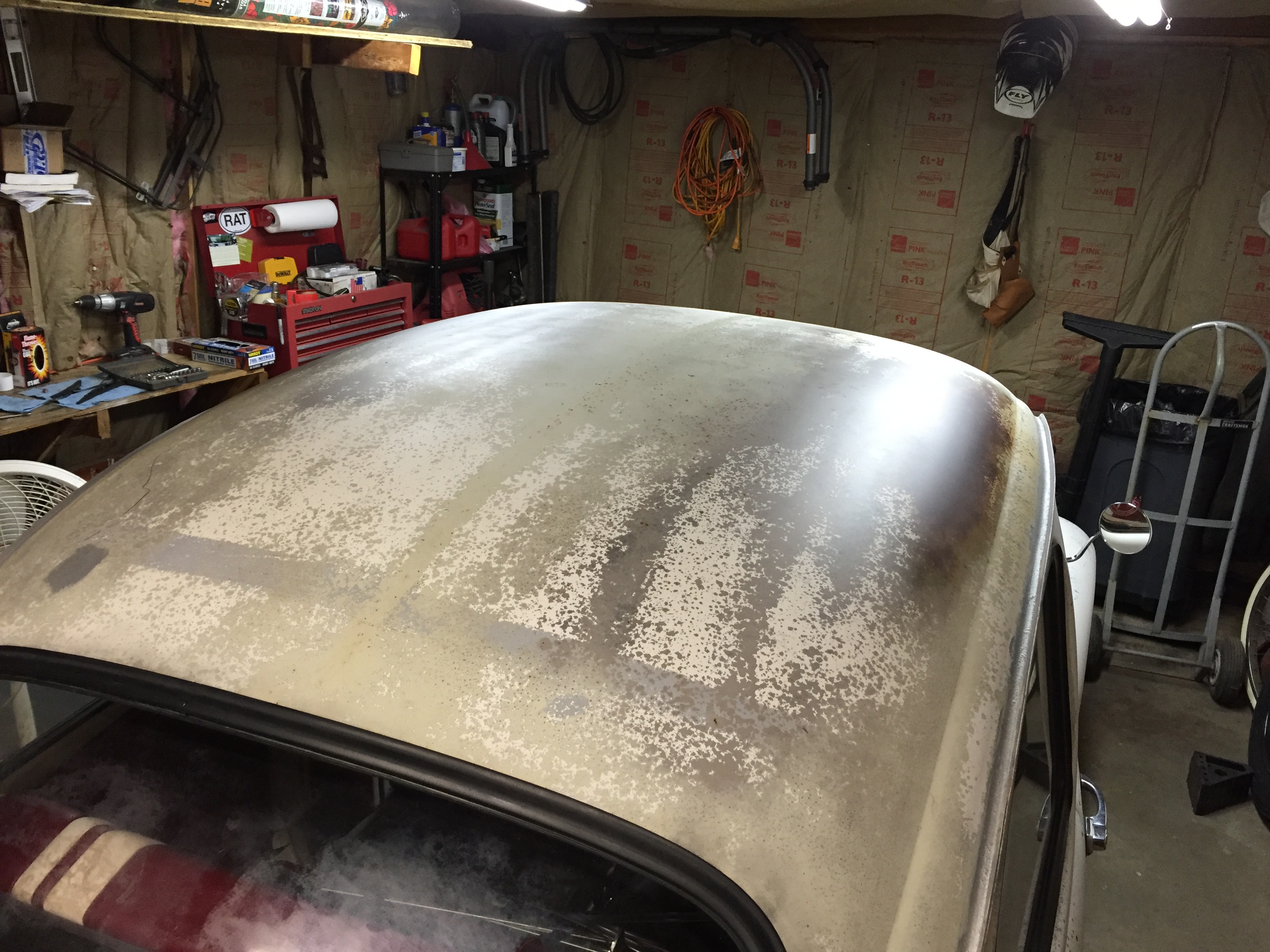

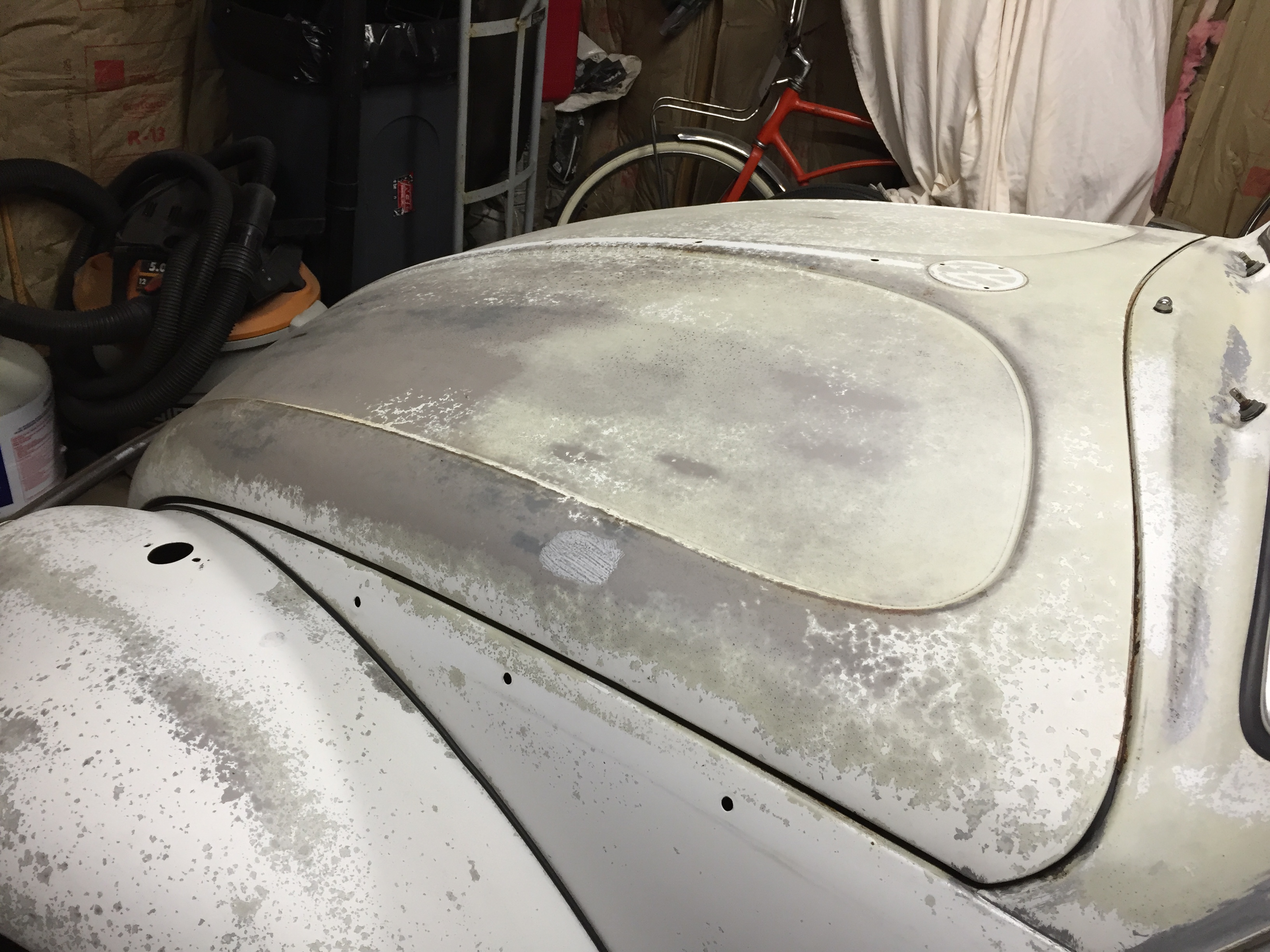

Pics after the matte clear coat.
Also the re-painted steering wheel and turn signal assembly. I will probably have to take the assembly apart again to fix some problems.

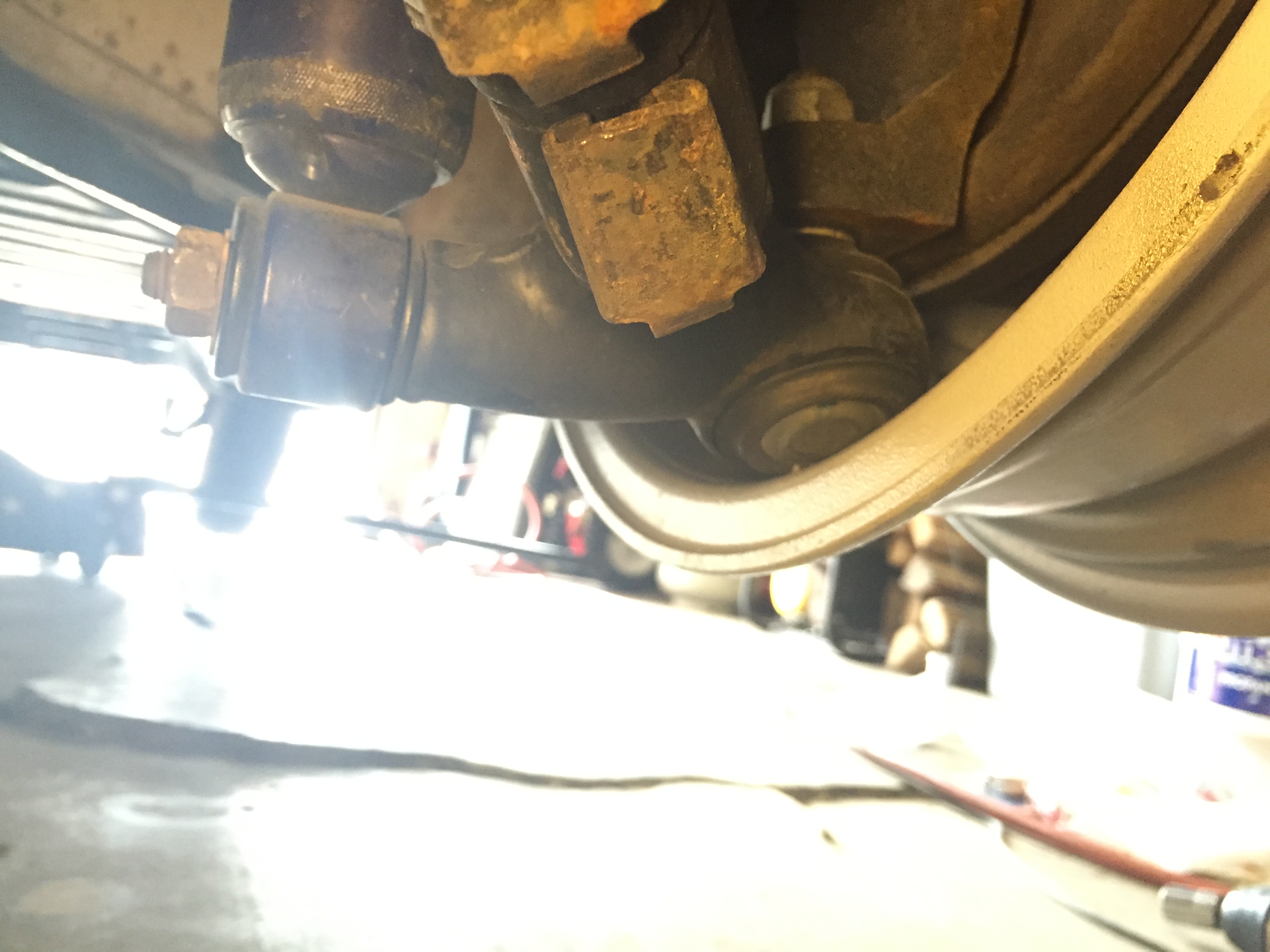

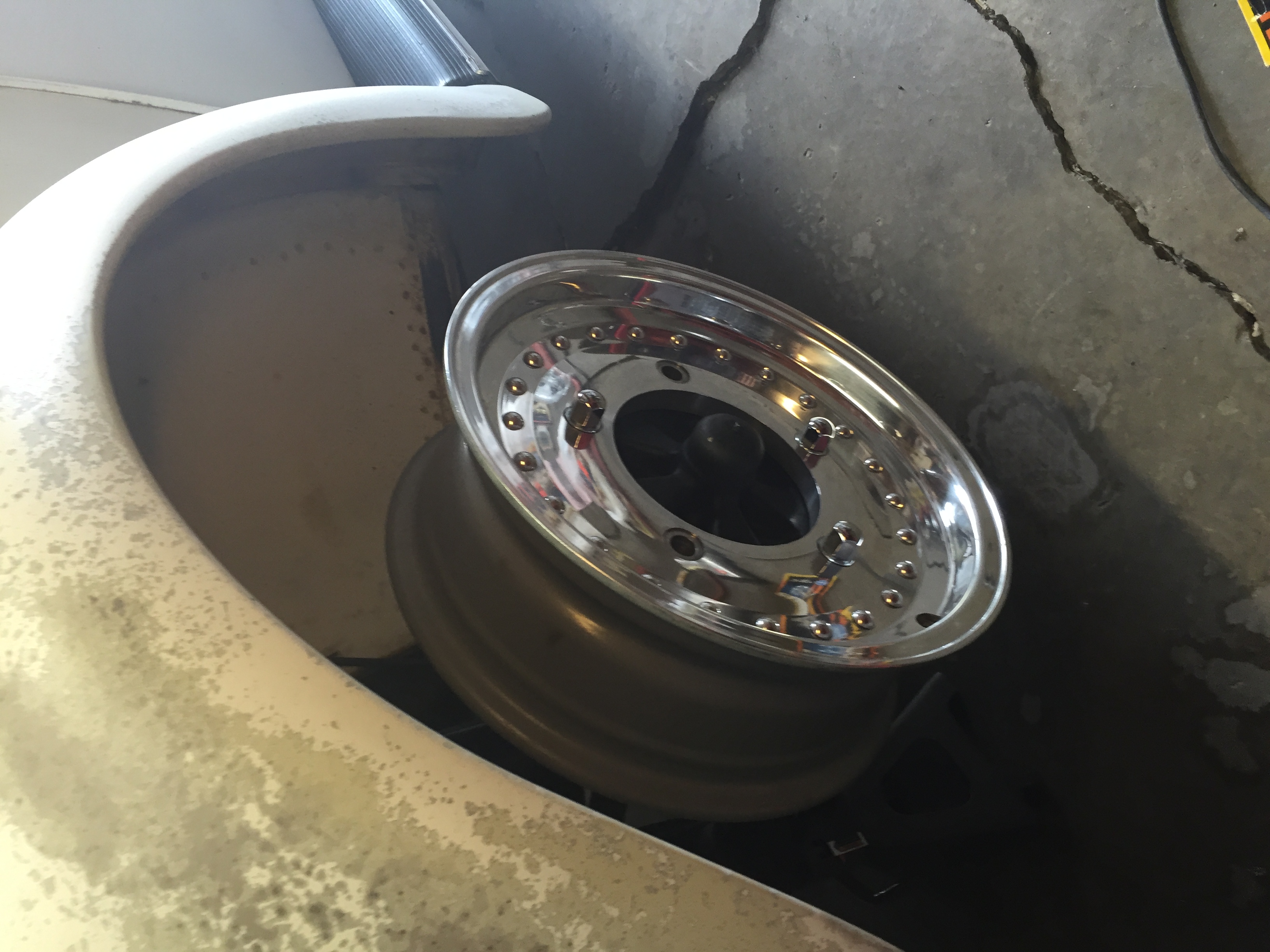

Update: I bought some aluminum AEW wheels that I've wanted for a while. I just like the look. Unfortunately, the front wheels will not clear the bottom ball joints. As of right now, they are not usable. I would have to narrow the beam, install disc brakes and use a wheel spacer to make them work. Right now, it's just not something I want to do or have the budget to do it right now. So they sit on the shelf until I can use them one day. Maybe I will take them to a meet and see if there is any interest.
I need to pay more attention to back spacing when I find another set of wheels. I've looked at a lot of diagrams and instructions to find the correct wheel for my application. It's not that confusing but when buying used, some sellers are not sure what the backspacing is on the wheels they are selling. Not only that, with the clearance issues being very small the measurement has to be correct. If the seller does not measure right, your stuck with wheels that don't fit.
