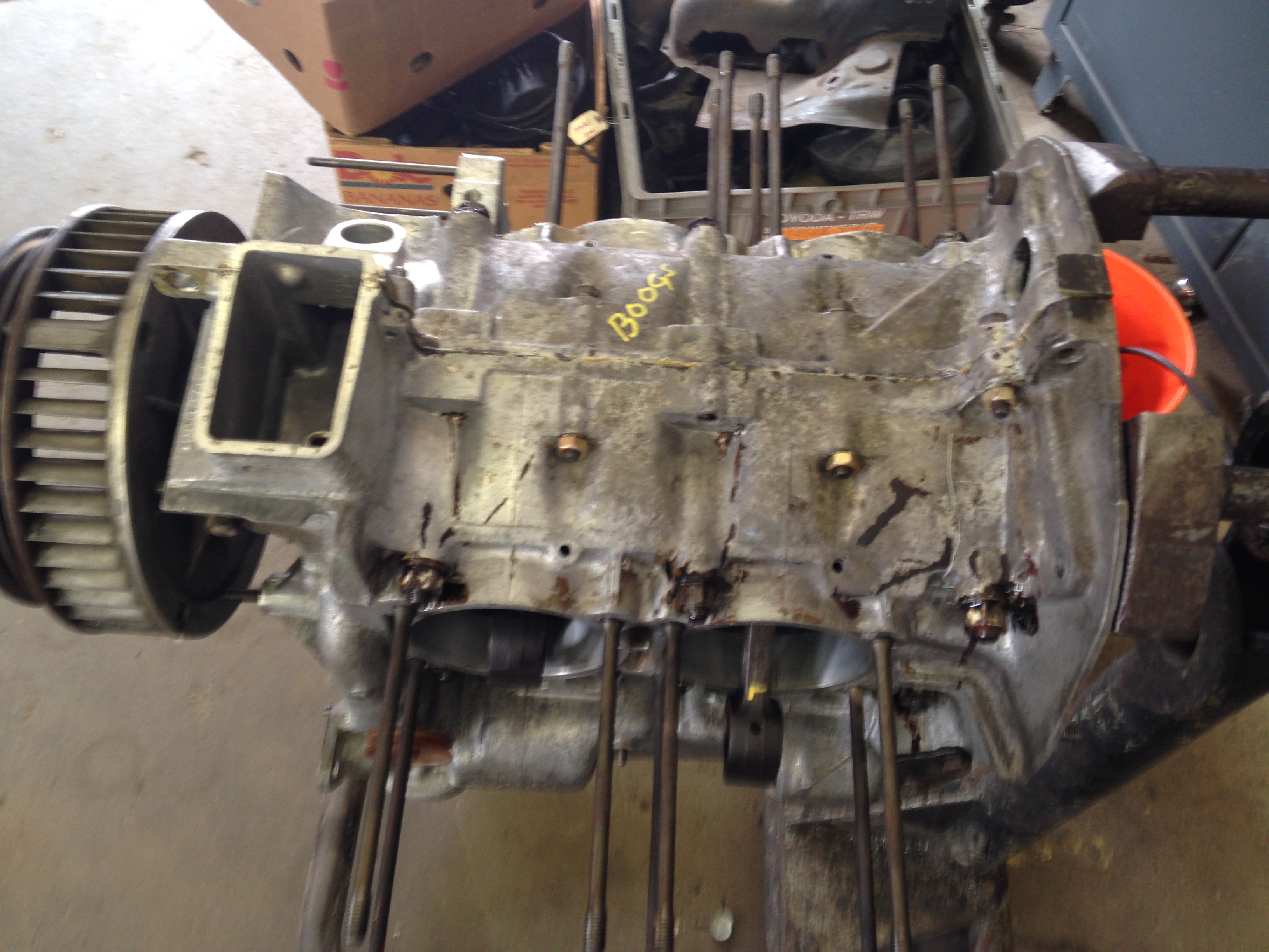

So it started the night of VWs in the vineyard. On the highway the bus started losing power, down to 50, then 30, then down couldn't even keep it at rpm in 2nd. Pull off to shoulder, and it stalls.
Give it a minute and it starts back up, get back up to speed, travel on down the hiway. About 5 miles later, same symptoms. Decide not to push it. Turn around. On way home. Same thing. Try to limp it home on shoulder doing 20. Kaput. Dies. Cannot get it to start. Thinking timing, try to do a little roadside diagnosis. It's hot out. Dog is in bus. Decide I need to get dog taken care of before bus. Call wife to pick up dog, no answer, and AAA to pick up bus.
While waiting a westlake cop shows up, sees dog, gets water for dog, and offers us a ride home. Just as we get in cruiser, Kristen shows up. Ride home with her. Thank cop for offering to take us home. Blue Lives Matter. Not all cops are bad.
Next day I go out try to start it. Nothing. Swap distributors. Fires up. Needs to be timed and full tune up. Still 90 degrees out, too hot (for me) to work on it. 90 degree temps just won't go away, and Oktoberfest is coming up fast. Decide to take it to Uncle Chucky's Shop of Sorrows. On the way there I hear this "POP" and the next thing I know it sounds like an imdustrial sewing machine coming from the back end. TICK TICK TICK TICK. loud. Bad. Uh oh.
Limp it to the Shop of Sorrow. Do a full inspection. Everything is looking good, valves adjusted correctly, remove lifter, they look fine. Go to the other side, valves on the #4 piston are a little loose in the guides and the adjusters have this serious groove down the center of them, like the valve may have been stuck, and ground a groove in adjuster. Cool. Figured out problem right? Replace head.
Drop engine, after trying to remove head in Van. Don't do that. It's just dumb. Props to Mark for getting it done, but for the 45 minutes it takes to drop the engine, just do it out of the vehicle.
Engines out, but cannot put it on stand because we are still in the middle of the 3 month type 1 engine rebuild. Won't mention any names, but he has a nice oil priming video on the YouTubes. Go to option B. Put the motor on a pallet and pick it up on forklift to work on it at a comfortable height. Spend and hour looking for some kind of Nikki yakamura (or some such) 1.8 liter head. Finally find it.
Pull head off. Oops. It's a 1.7. WTH, who refreshes the top end and doesn't mic the piston? This Guy. Off to the Art Brow pile, hopefully there is a 1.7 head in there. Jackpot. A nice looking head with tight guides. Don't have a spring compressor for type 4 heads to verify seat condition. Will have to go with blind faith.
Get the head back on, and engine back in. Start it up. 0 improvement. Sounds exactly the same. Gutted. Set timing.
It's like 8pm Friday night of Oktoberfest. Chuck, Brandon, Matty, Riccardo et al. all gave up their free time to help me get the bus ready for Oktoberfest. I will not have be all for naught. If the engine blows up I have 90% of the parts for my 2.0 liter rebuild.
Chuck spray paints 1.7 on the back of my van, lest I forget.
Leave Chuck's shop. This thing has no power. Can't even get out of its own way. Spin the distributor, "dial it in" to where I like it, and head on home to pack.
Obviously the bus is in no shape to make it to KI this year. Chuck wants to build the 2.0 liter before KI, but I still have NASA wind tunnel testing, balancing and a few other things Dr. Chuckyl Mr. Hyde deems to be pointless. I don't acquiesce. I decide to rebuild what I have. Chuck disagrees, and vocalizes his discontent. I push on.
Now I have a very special "Jean Burg" [sic] high performance 1.7 type 4 engine. Aside from the center mount carb that I removed, the first go around, this bad boy is equipped with a high flow oil pump, hydraulic lifters and high performance (?) push rods, just to list a few of the stellar upgrades.
Decide to debastardize my engine, and go back to the way VW designed it in 72. Order new solid lifters and matching cam from Bill. Order new seals, bearings and gaskets from Mick at Euclid Foreign. For future reference do not buy a 1.7 liter gasket rebuild kit, get the 2.0 liter kit. The 1.7 kit is missing some vital pieces.
Get everything tore down. Do not find anything glaringly wrong. Lifters are fine, cam looks brand new, pistons, jugs, rod and crank all check out. I do not know what was causing noise, and that is worrisome. Hopefully going fully stock will resolve mystery noise. As long as it works I don't care if I ever know.
Some things we did find, a little piece of plastic in oil strainer, a flange on heater box had come loose, a small hole in J tube in heater box, and a loose valve adjusting screw. Nothing that screams Eureka!
Time for reassembly. Chucky knows I want this thing running for the Brews Cruise on Saturday, and I think he is doing everything he can to secretly sabotage me, so it won't happen. Spend the next few days sweeping up SoS, moving pallets, machines, cars and whatever else he has. Get kicked off of raw properties with my cohorts. Get placed on double secret probation. Riccardo assumes favorite minion position.
Finally get to start engine assembly on Thursday, will be close to making Saturday deadline, but achievable. Start assembling crank. Chuck shows up, in keeping with sabotage theme, informs me we are having "engine build party". These words should never be used in conjunction. There goes any hope of this thing being done on Saturday.
Cam bearings don't fit. This is like the 5th time this has happened lately. Kobleschmidt. Get silver lines. Get the bottom end all together and crank won't spin. Ufck. Call it a night. Most likely cause...thread sealant on through bolts.
Come in next day and crack case. Front (front is front) main bearing got spun somehow. Index mark is still on it, just not lined up on case have. Dowel pin is recessed so far in hole it is as if the pin and case are one. Chuck to the rescue. Applying some 3rd grade science, some 8th grade machine shop tech, and some man sized hammer blows, the pin is successfully extricated from case, without damage to the case. Get everything cleaned back up, and reprep everything. Install new bearings from my stash at home, and get bottom end assembled
Since I won't make Saturday goal, and Chuck has a cruise to navigate, we decide some quality alone time is needed, and I take the weekend off.
Monday brings with it the start of a new week, and the promise of possibly getting my engine in this week. Taking it a little slower since I missed first goal, but I still need it in and tested before KI. Start off by getting the jugs prepped. Decided against using cylinder gaskets at bottom, and head shims at top. Should see a slight increase in compression, and there are no interference issues. We shall see. The Pistons and cylinders looked fine, were Kobleschmidts, and were reused as is. No reringing, or honing. Just a thourough cleaning, thanks Will, and some assembly lube. Got the top end done, and called it a night.
Started the next day, by adjusting valves. I'm going to miss my hydraulic lifters. After valves it was on to all the little bits and pieces. They always take up so much time. Fan is on (I painted shroud as that is the sign of a quality rebuild) as well as the majority of tin. Next up is manifolds, exhaust, air cleaner stand offs, main seal and end play. Then this bone stock puppy will be ready to go back in, after I do some prep work in engine bay.
