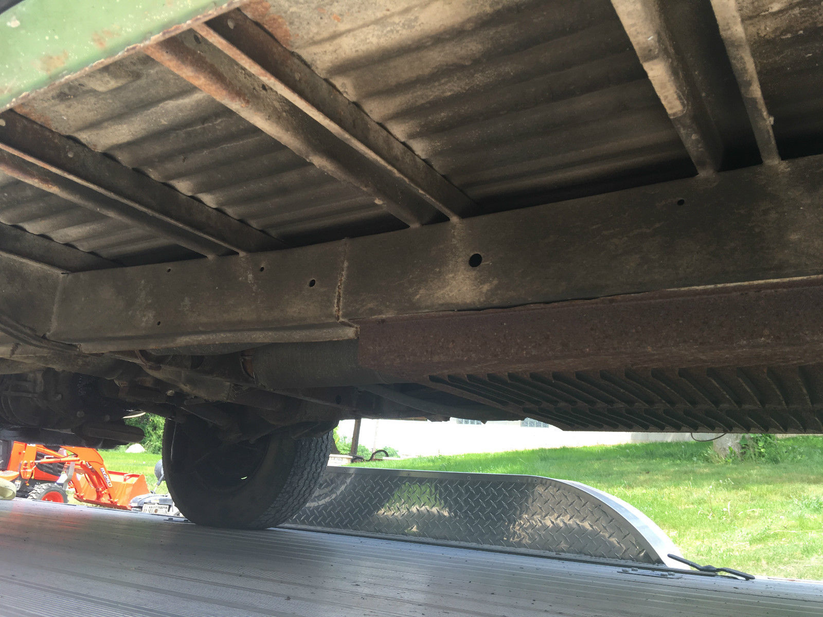

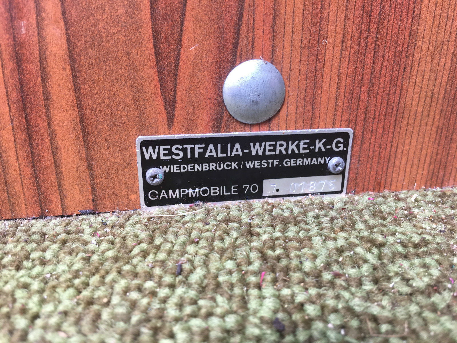

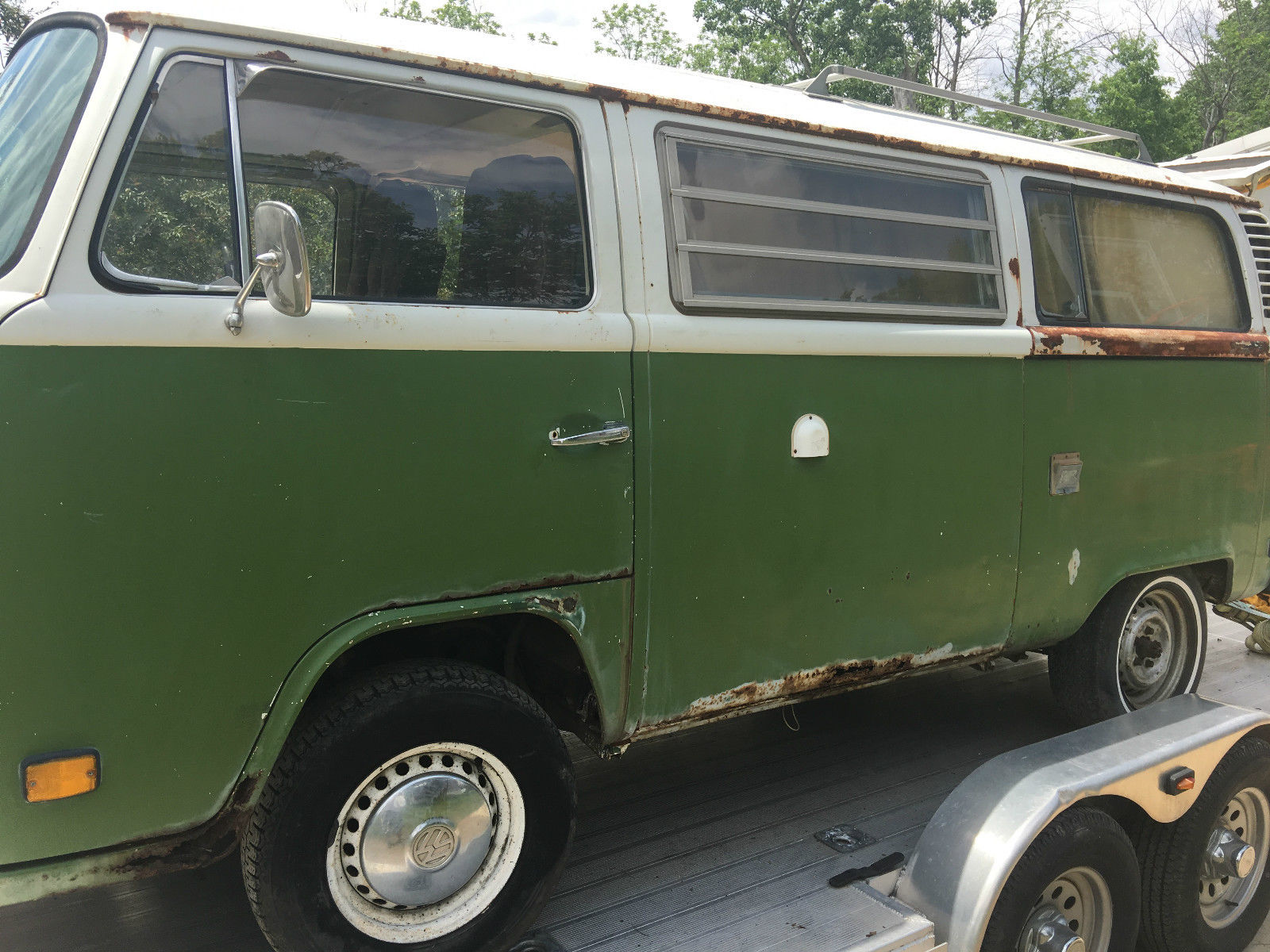

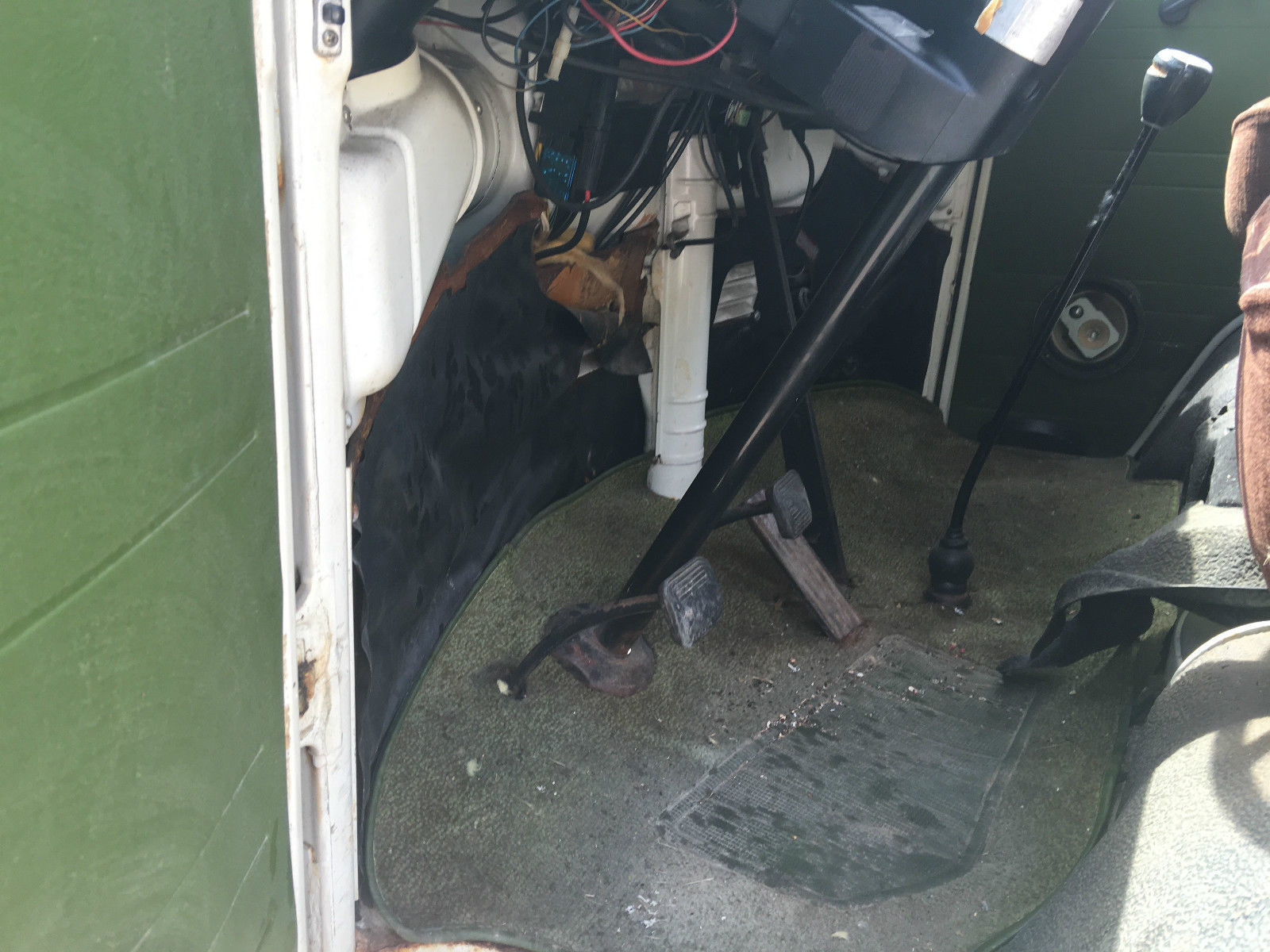

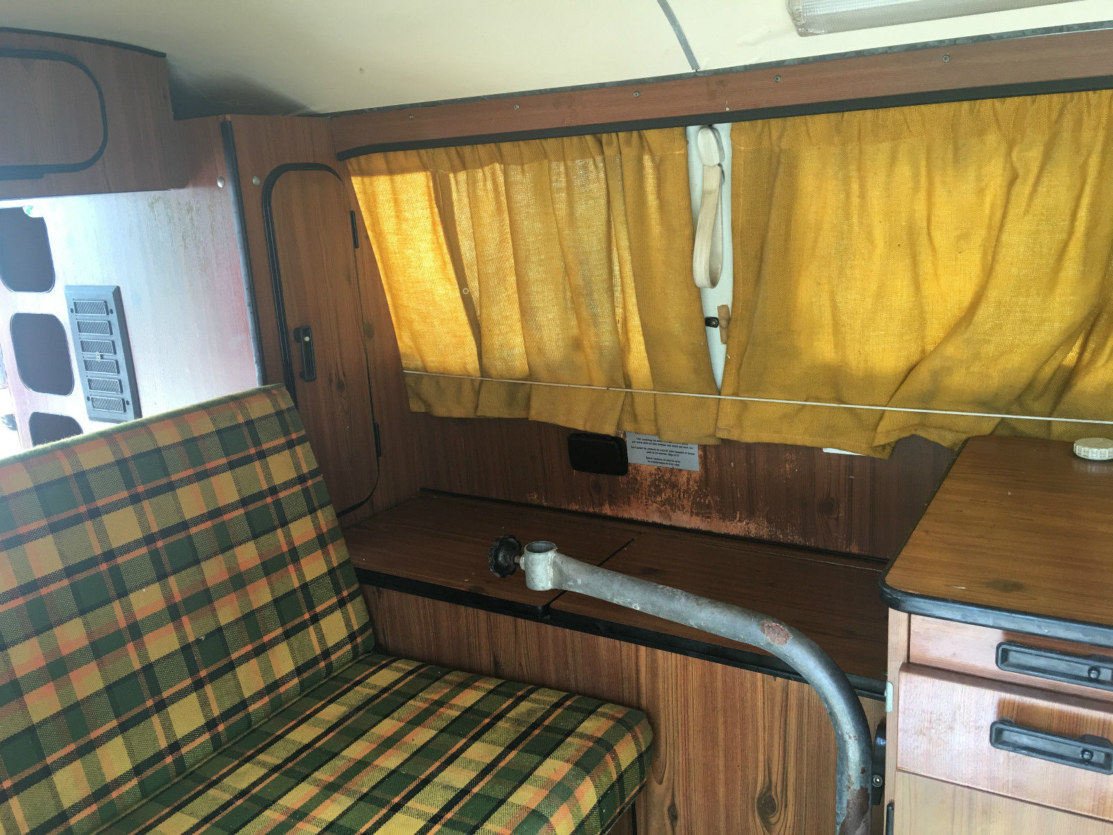

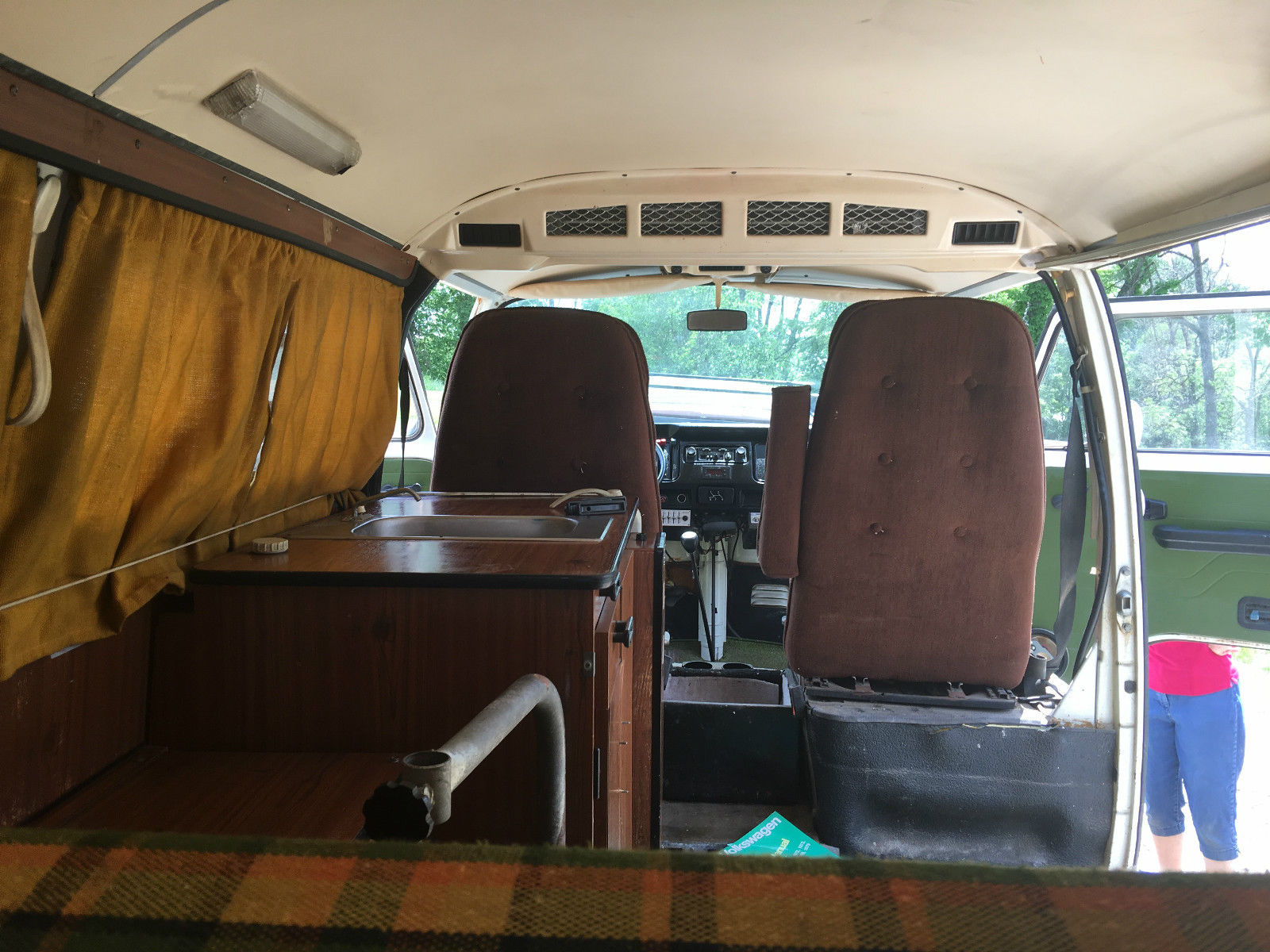

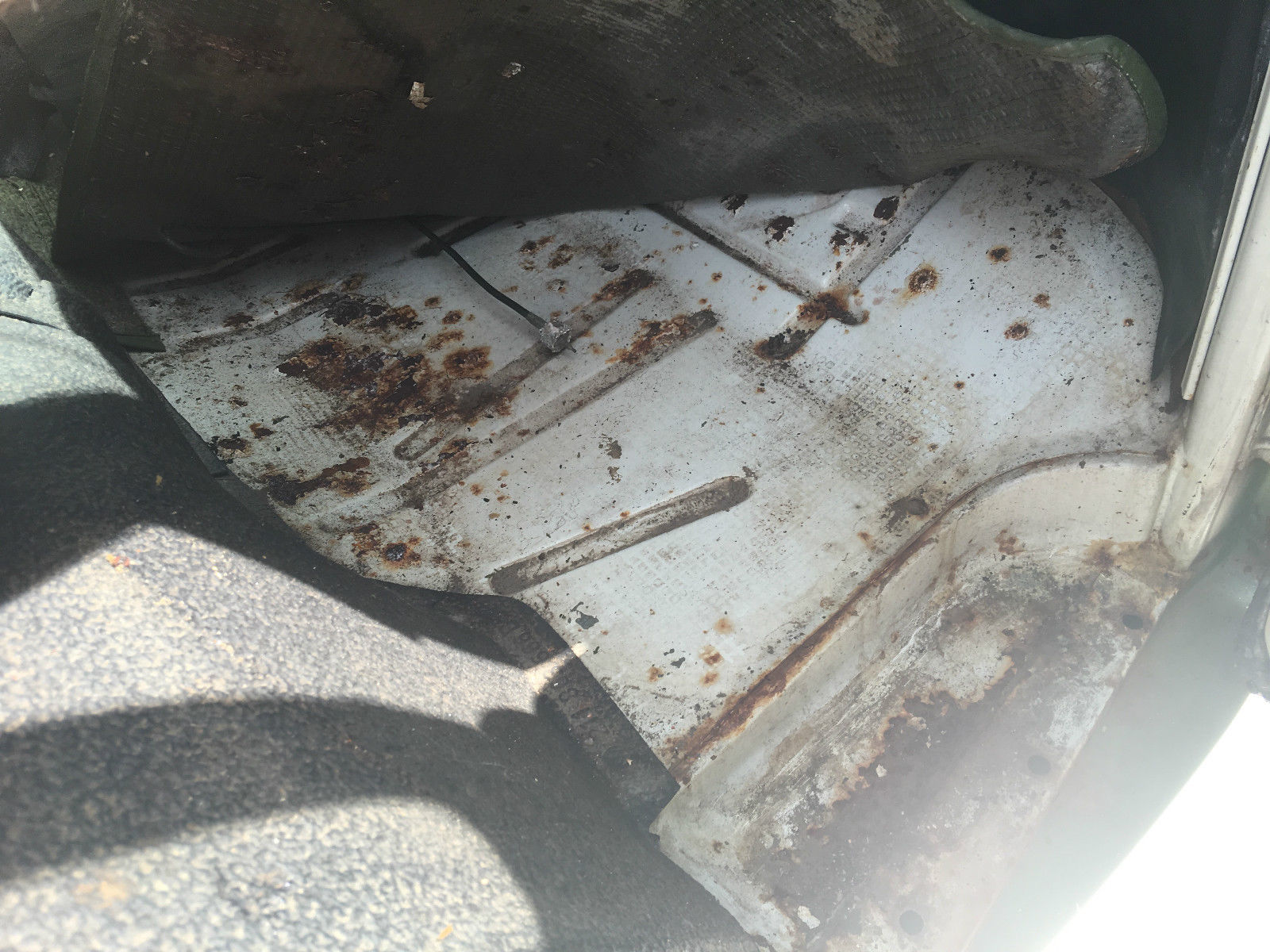

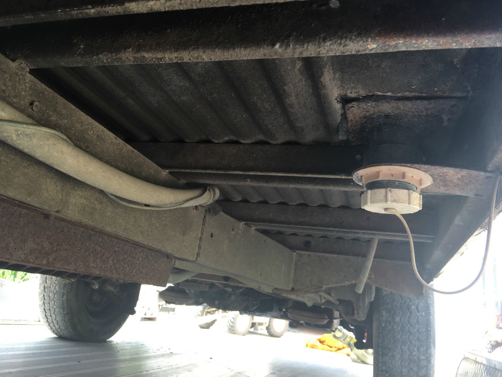

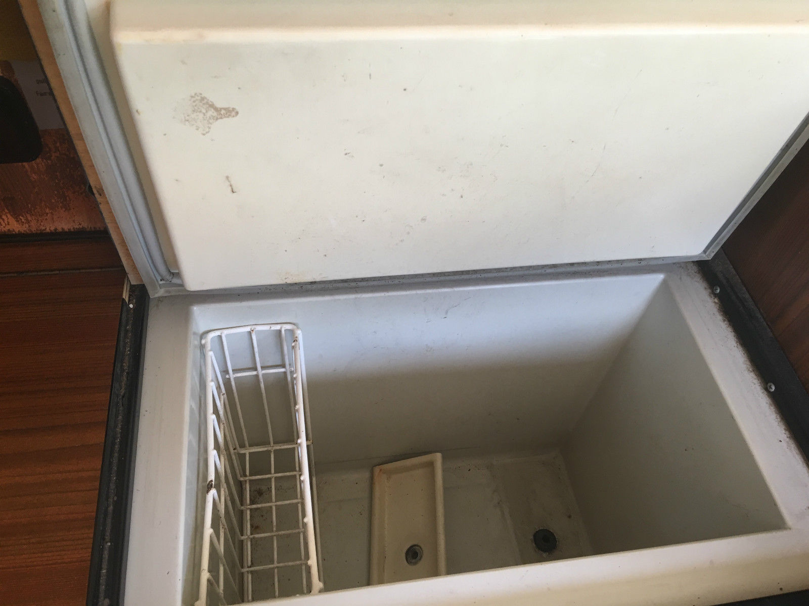

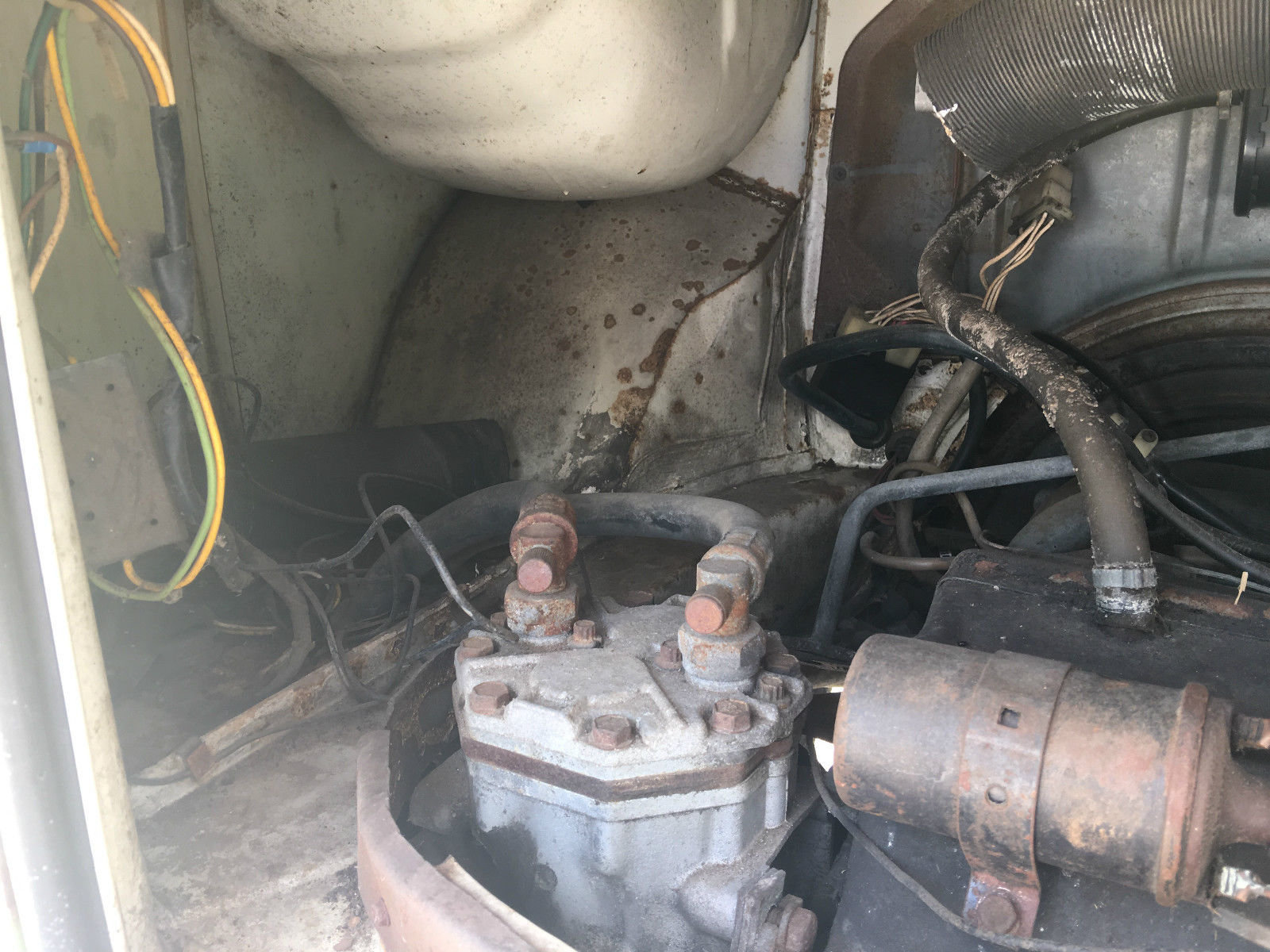

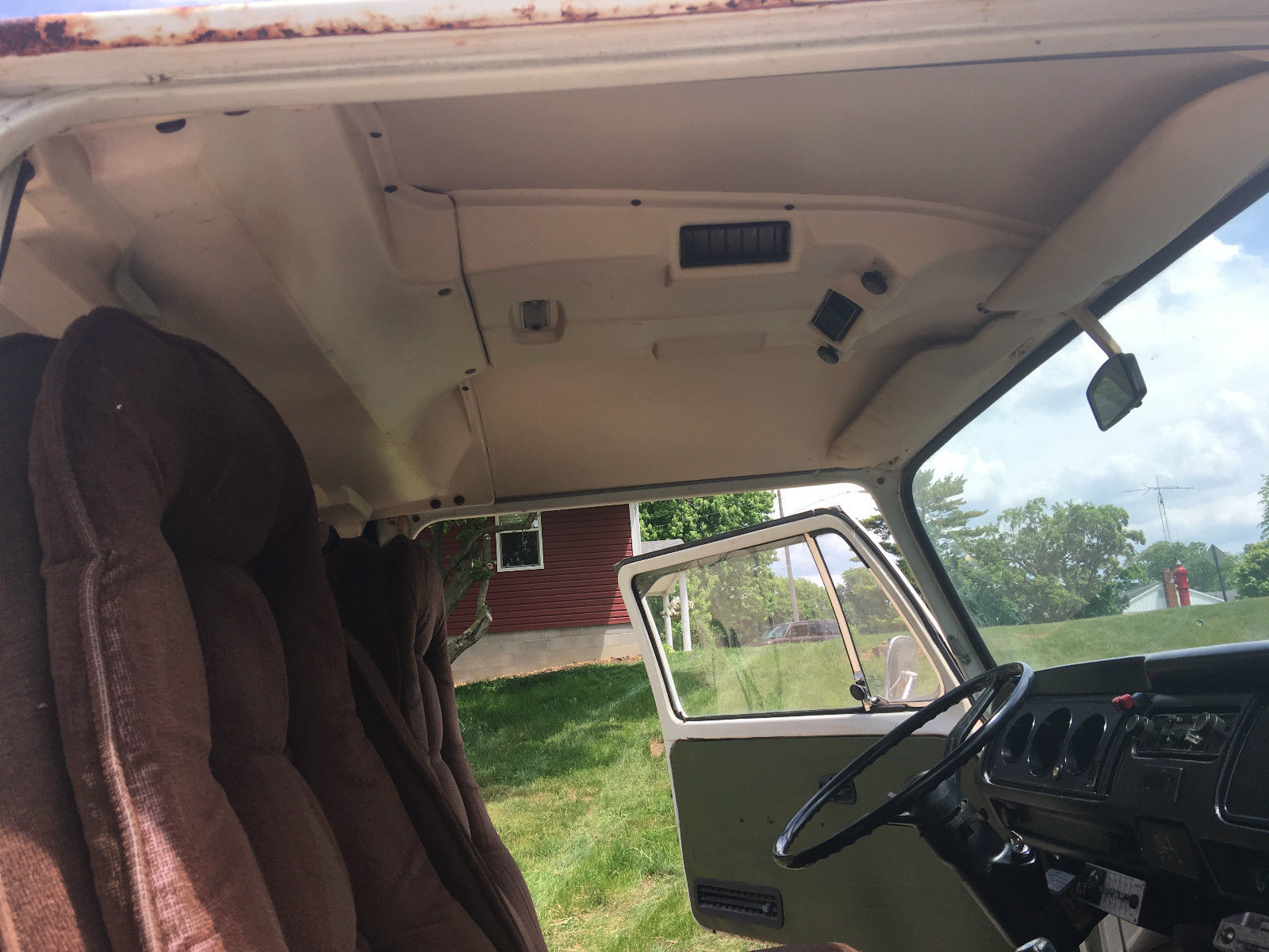

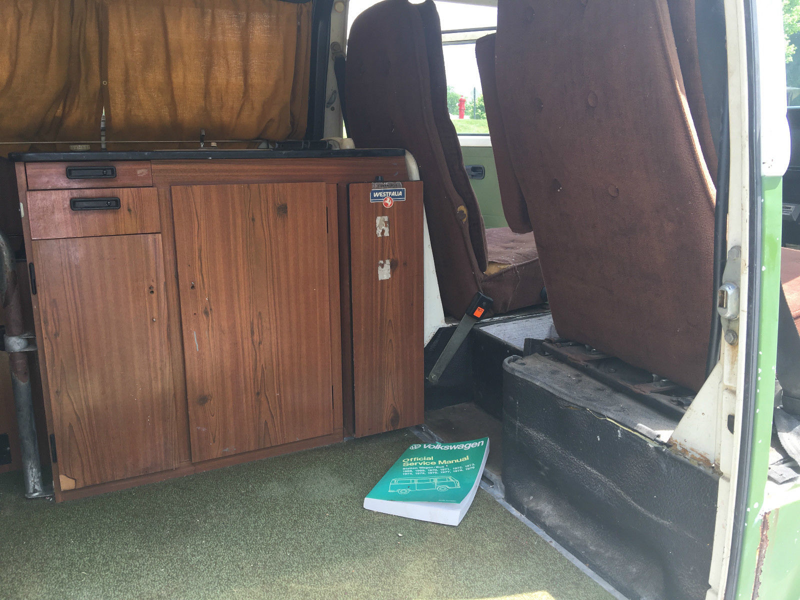

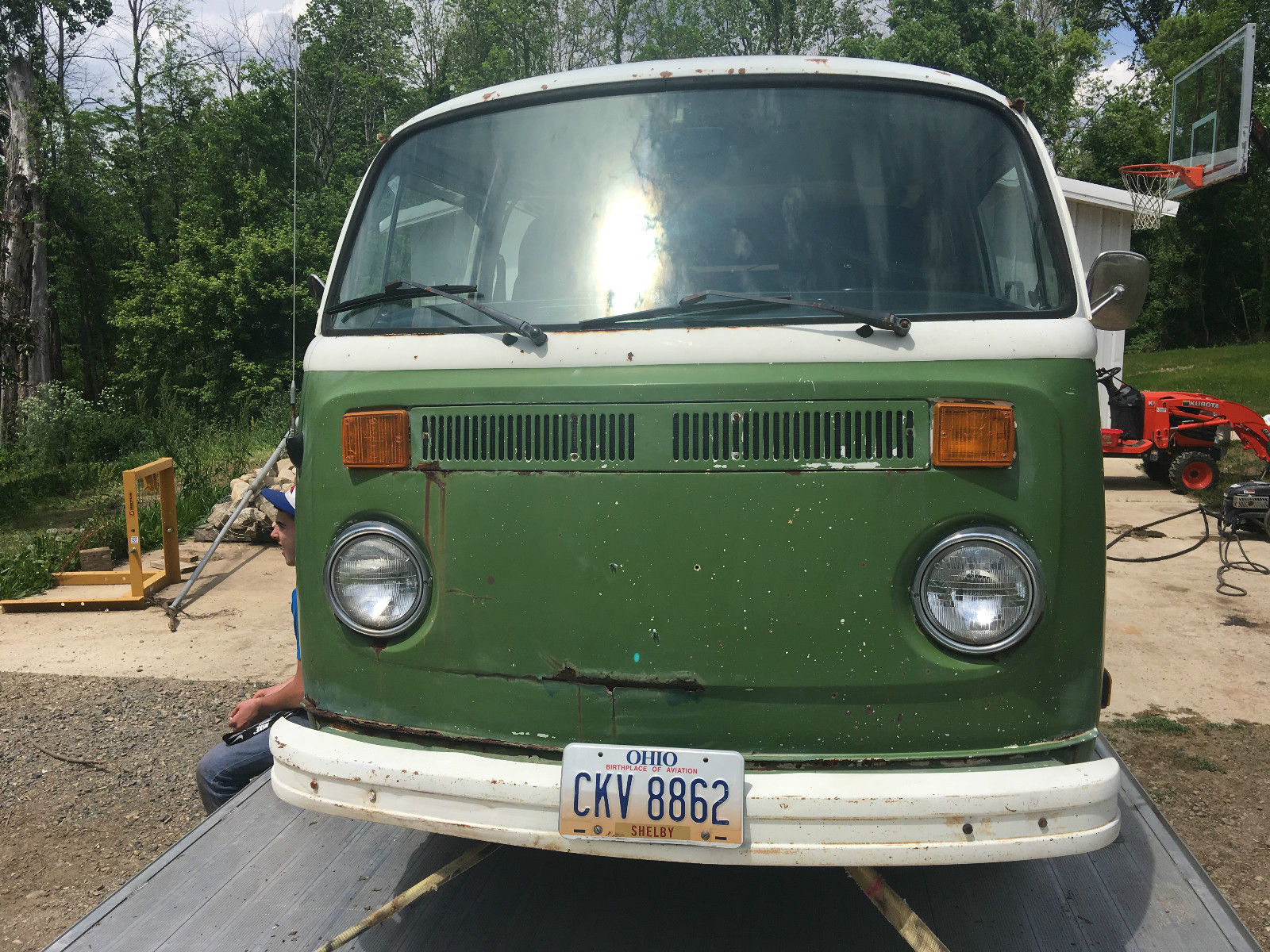

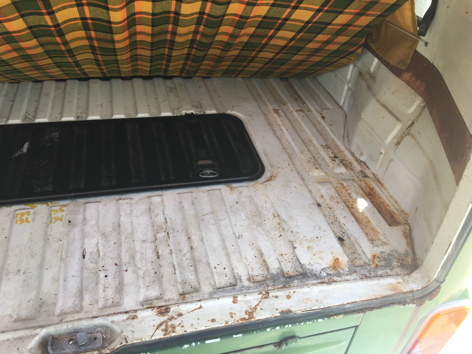

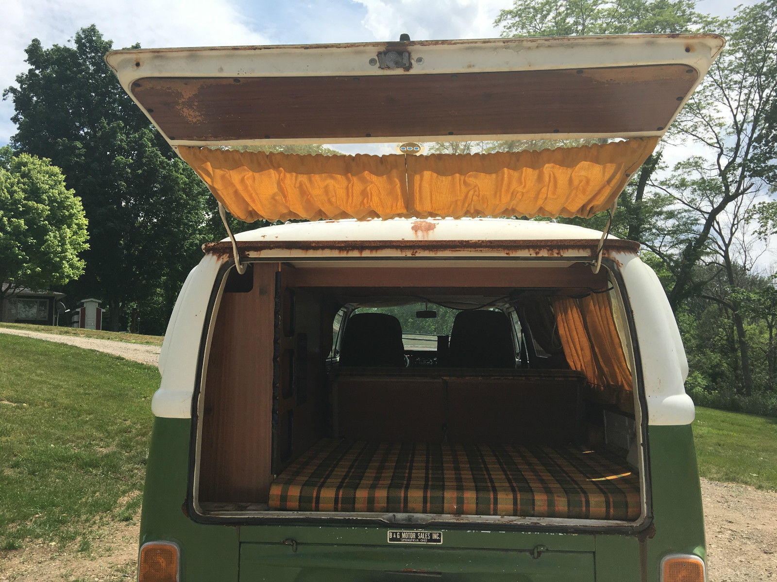

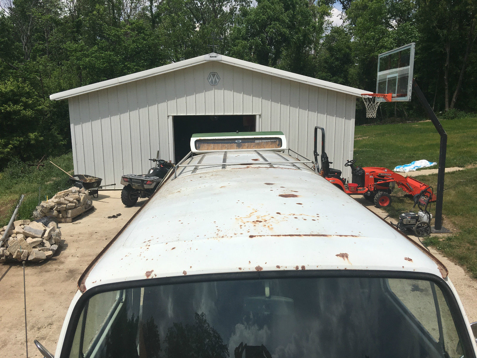

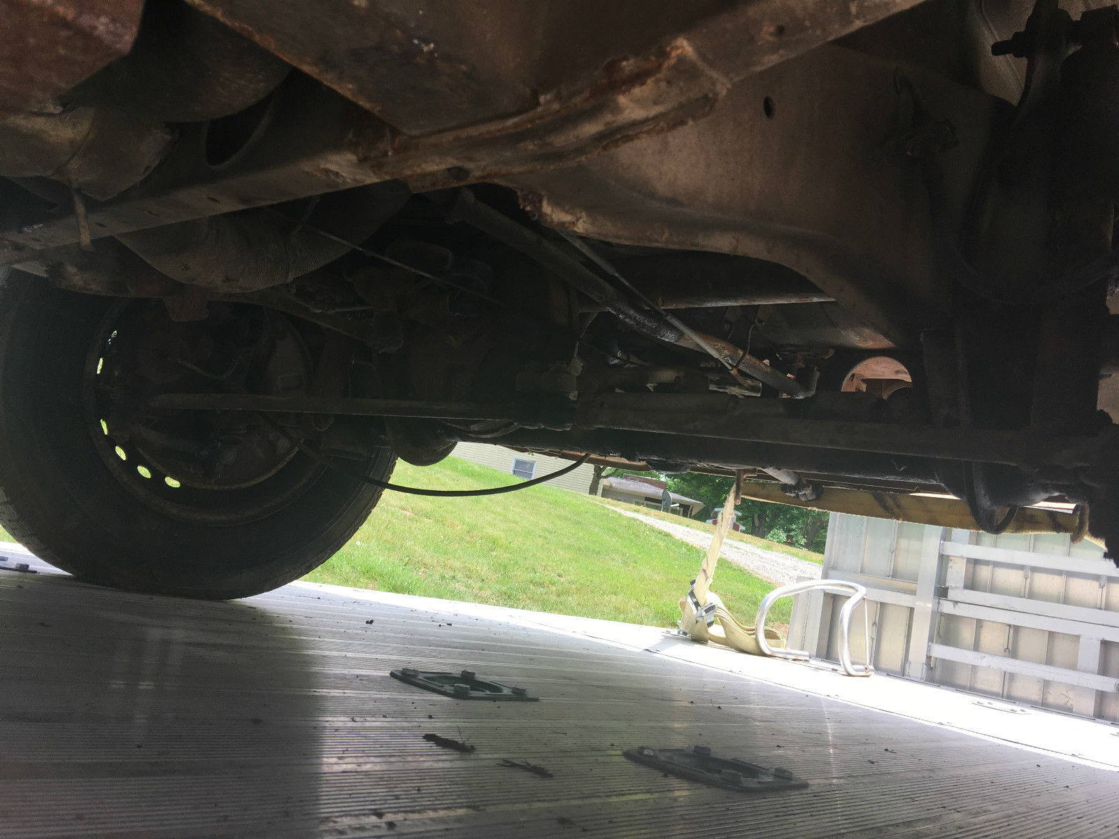

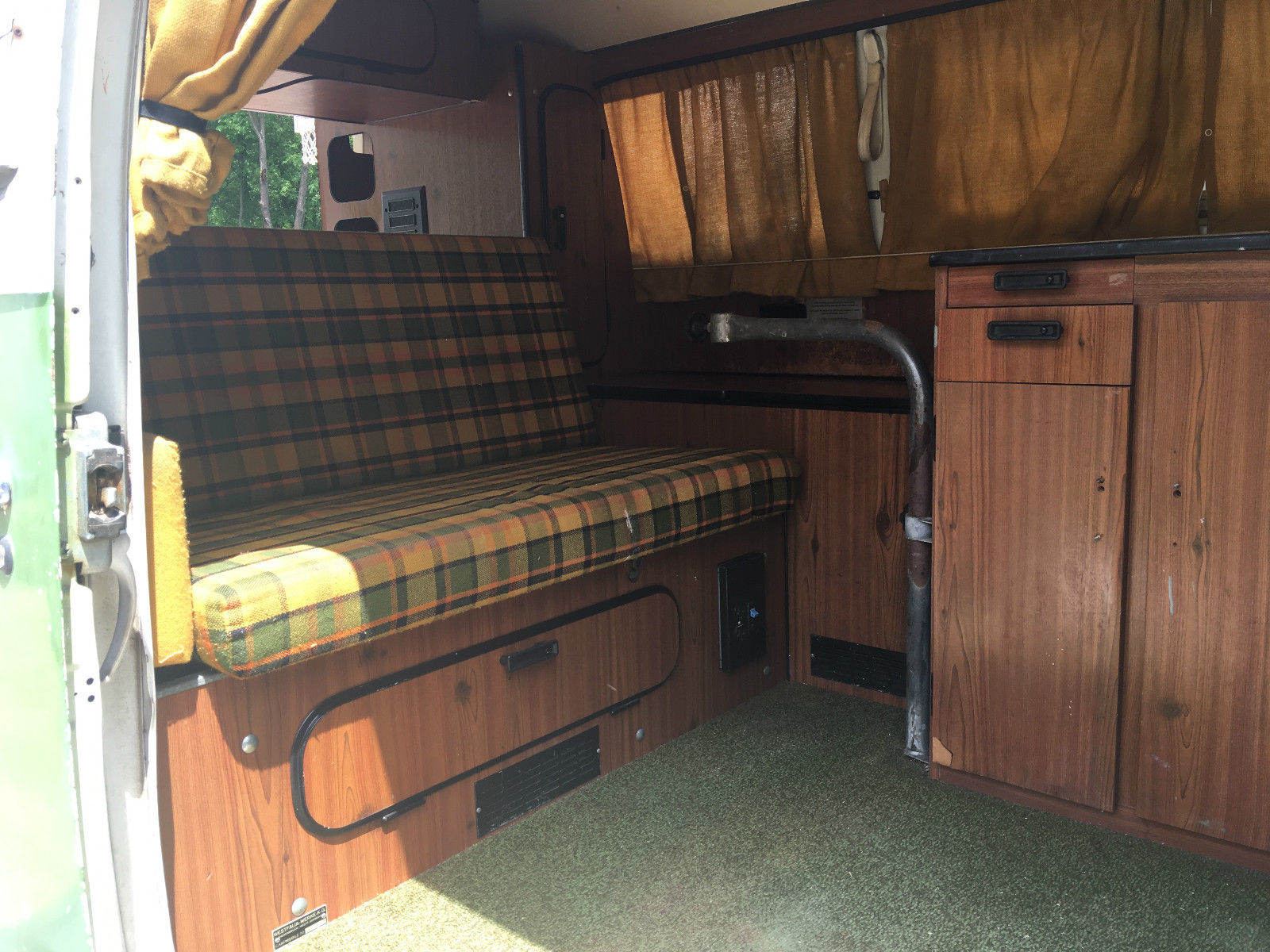

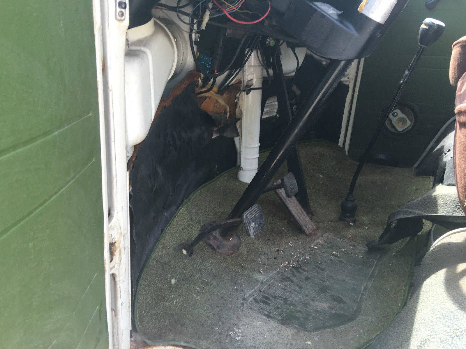

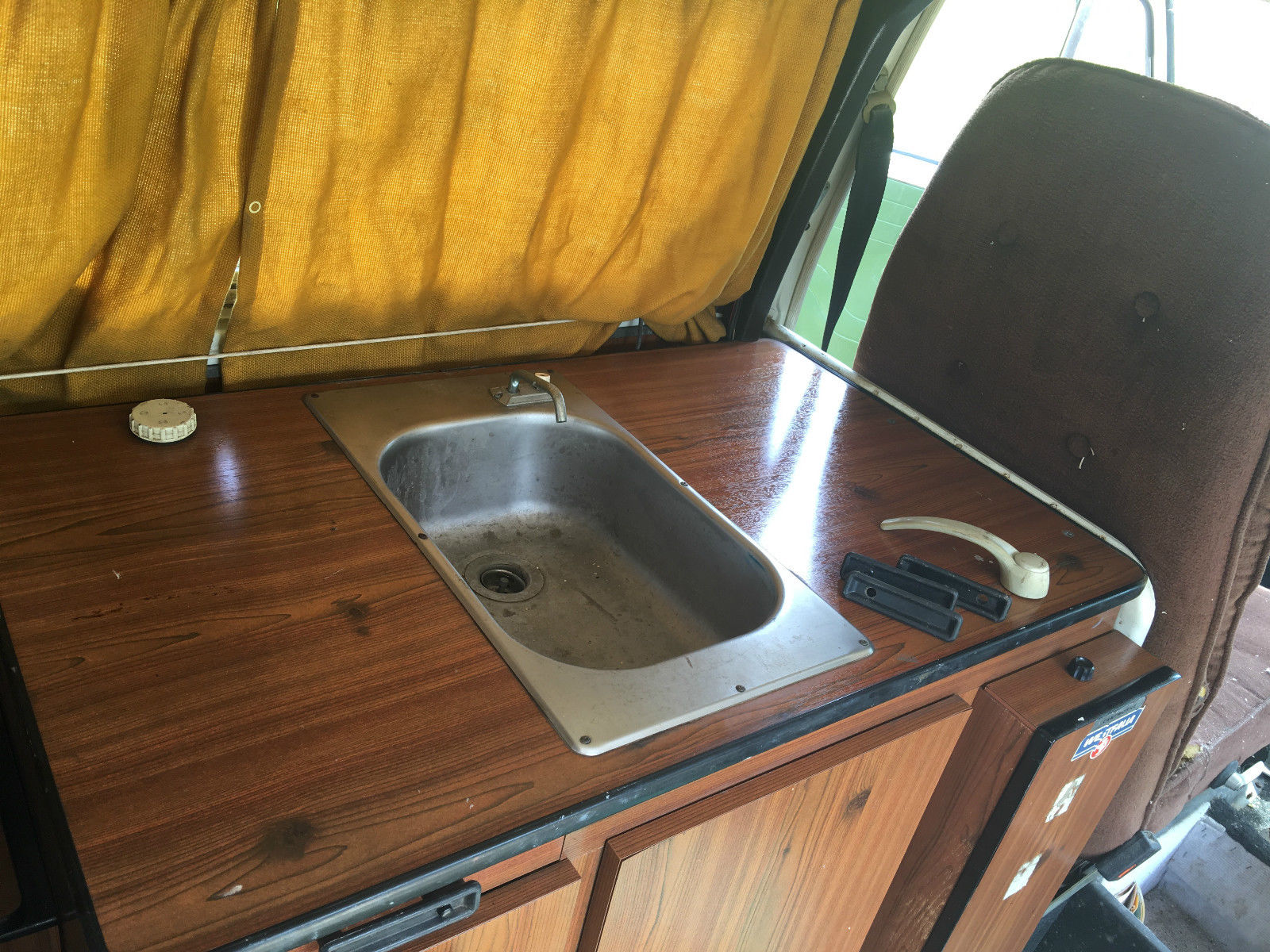

Hi all! My girlfriend and I purchased a 1977 Camper a couple of weeks ago. Boy, there is a lot of work to be done.
Pictures:
