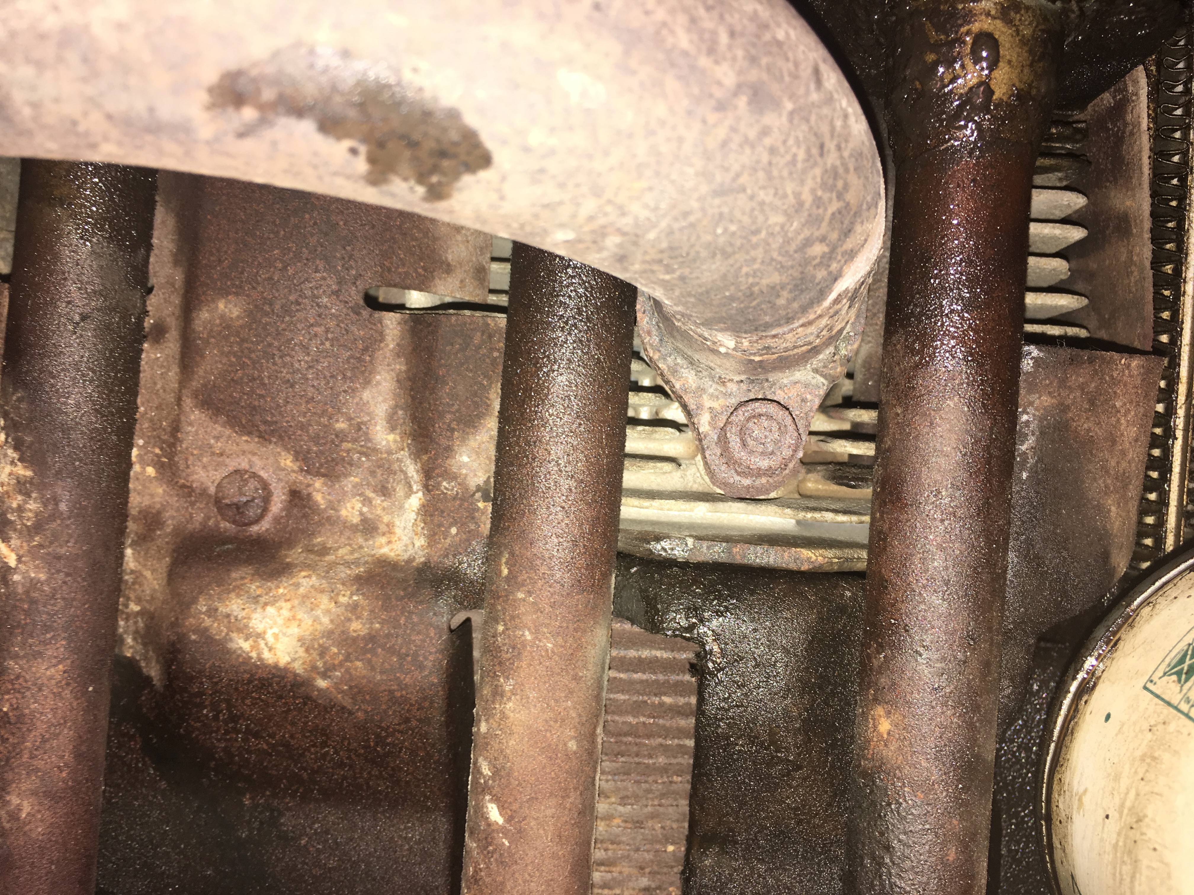

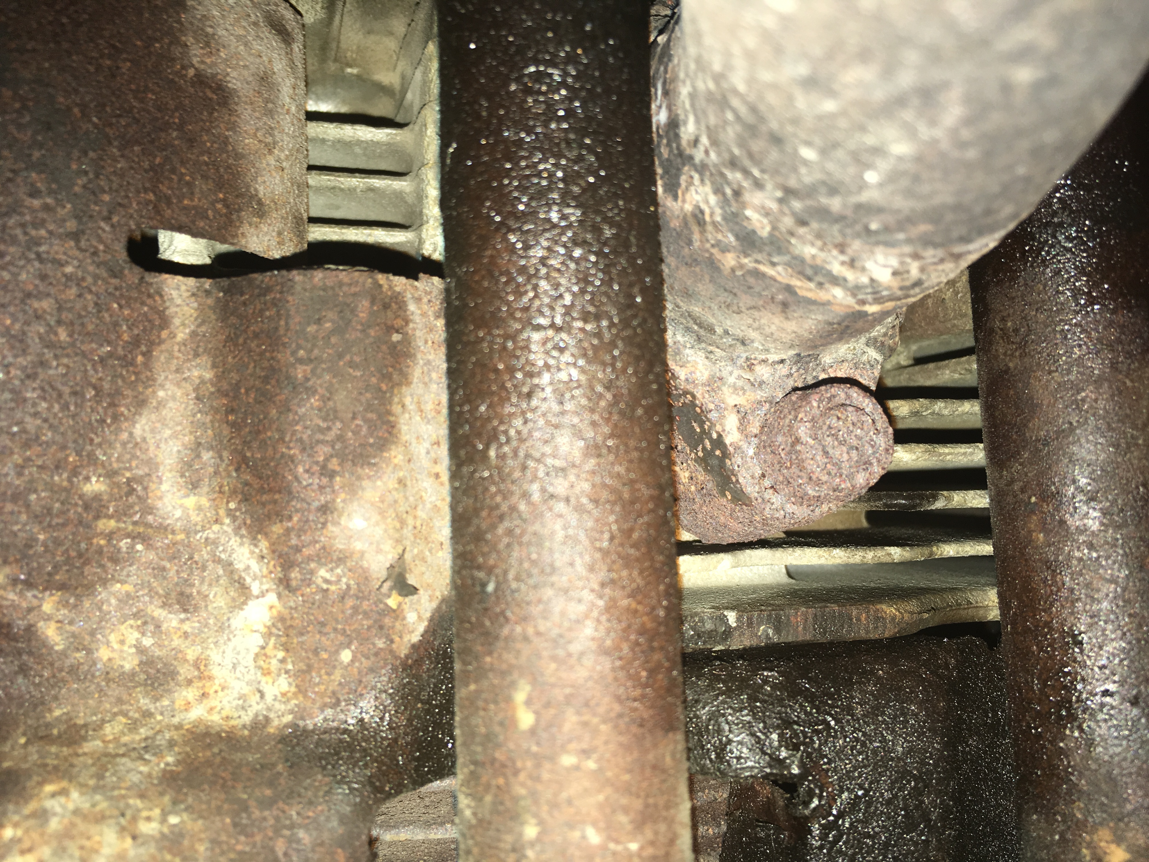

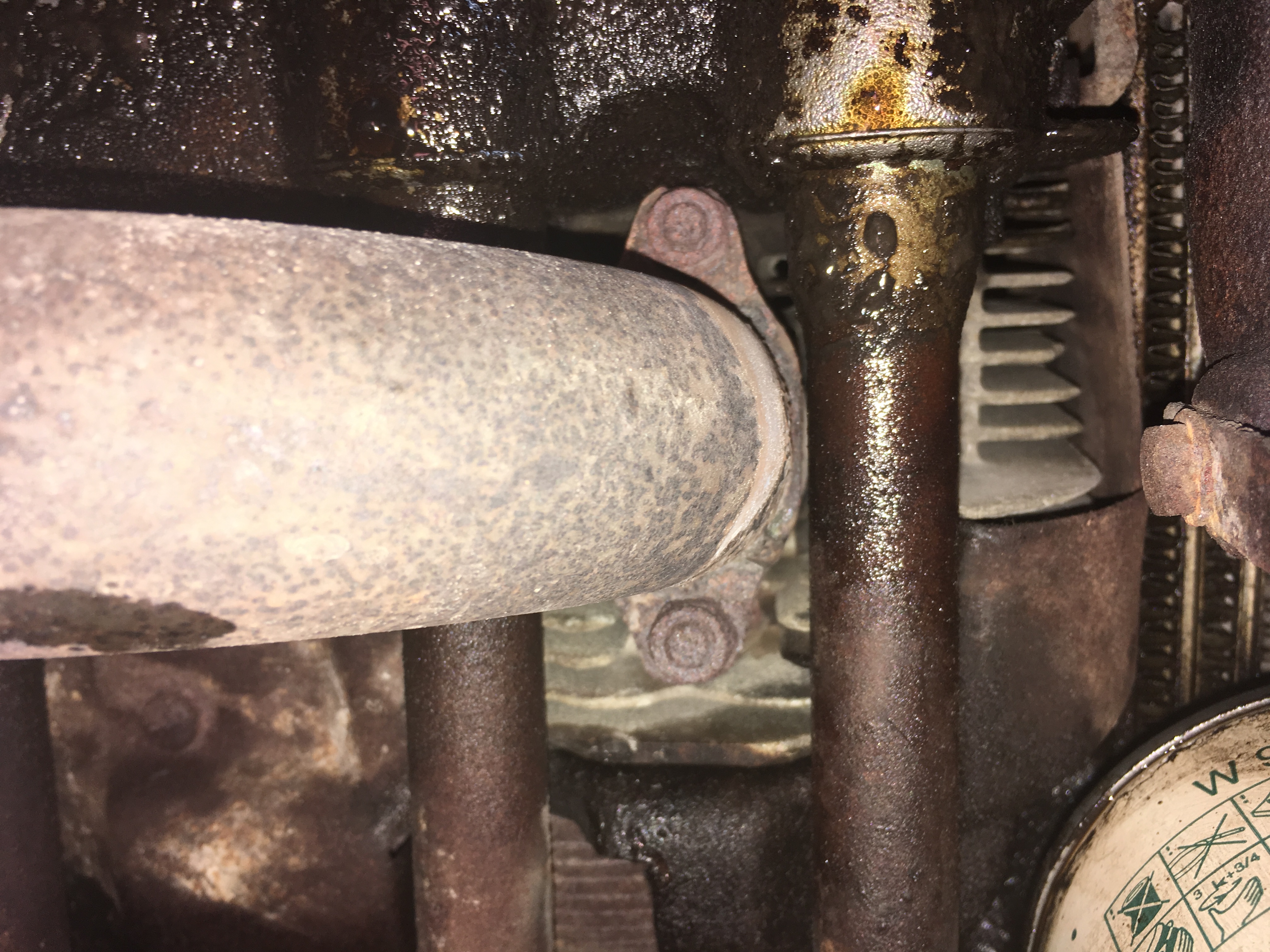

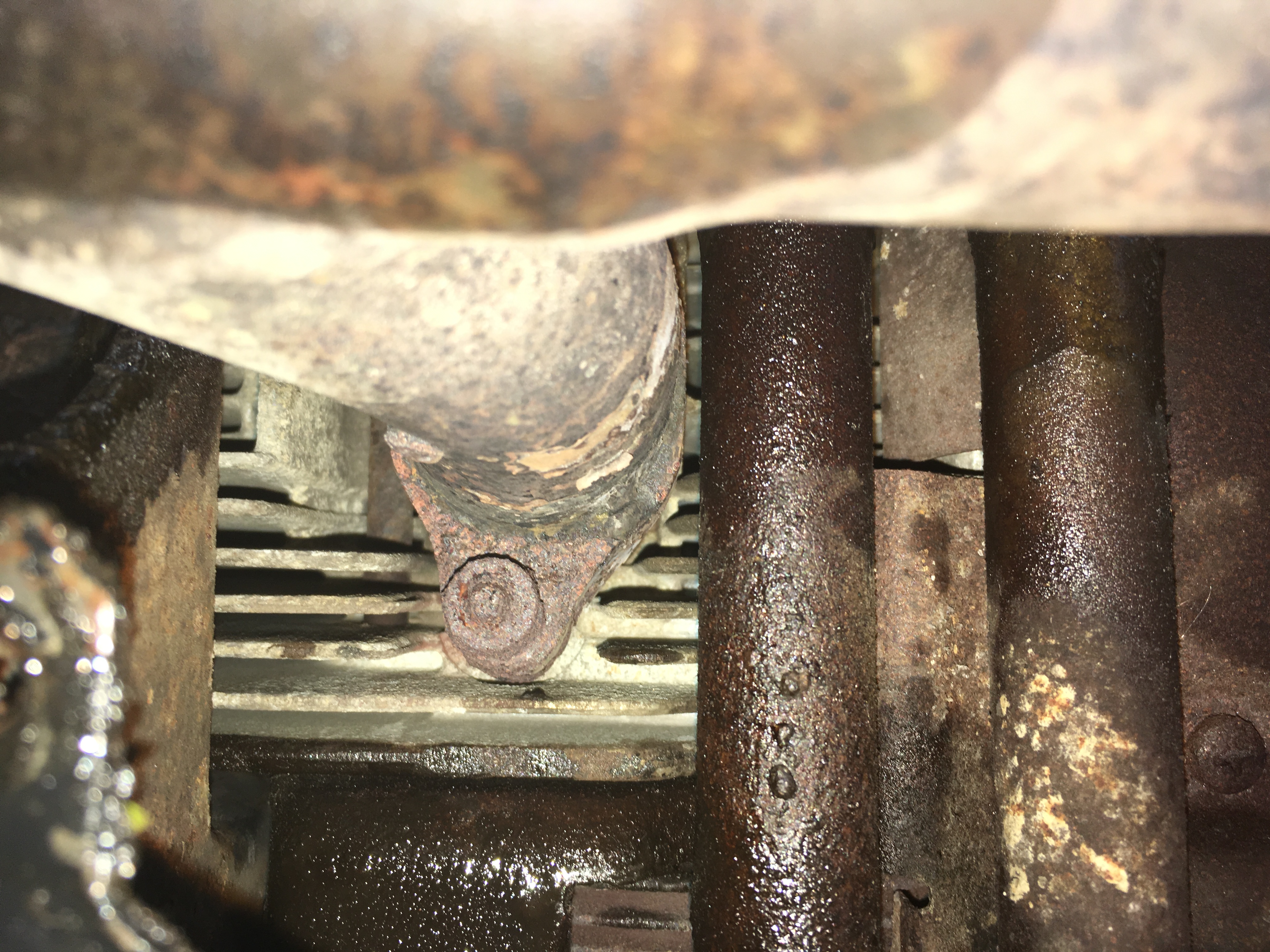

Can anyone tell me if these are square or round ports.
Re: 78 Westy Exhaust
Difficult to tell from those pics. Look like round (oval). I will get some pics up tomorrow that may help.
I would start soaking those studs down with PB Blaster or something similar, Seafoam makes a penetrant as does Krol. Keep soaking them. If the studs come out when you remove the manifold
that's much easier to deal with than if they break.
Highly unlikely that they are square port,as that would be a one year only (79) heater box.
In fact after looking at your pics some more, I'm sure they are not square port.

wwebner wrote:Difficult to tell from those pics. Look like round (oval). I will get some pics up tomorrow that may help.
Thanks for all your help. I was thinking they were the oval but I could not tell. We just recently picked this bus up on a trade. Trying to put the the motor back in order. It runs great. Just needs some love. Have new push rod tubes and looking to do the exhaust just so I won't have to mess with it for a while.
Those nuts are pretty rotted. Don't even bother with penetrating oil and don't touch them unless they're glowing red. If you are not familiar with heating rusted nuts with an acetylene torch pay someone who is. If you want to do the work yourself drive it to a repair shop or muffler shop and have them loosen the nuts for you, then drive it home with loose noisy exhaust. There's a good chance they will come loose but there's no guarantees.
