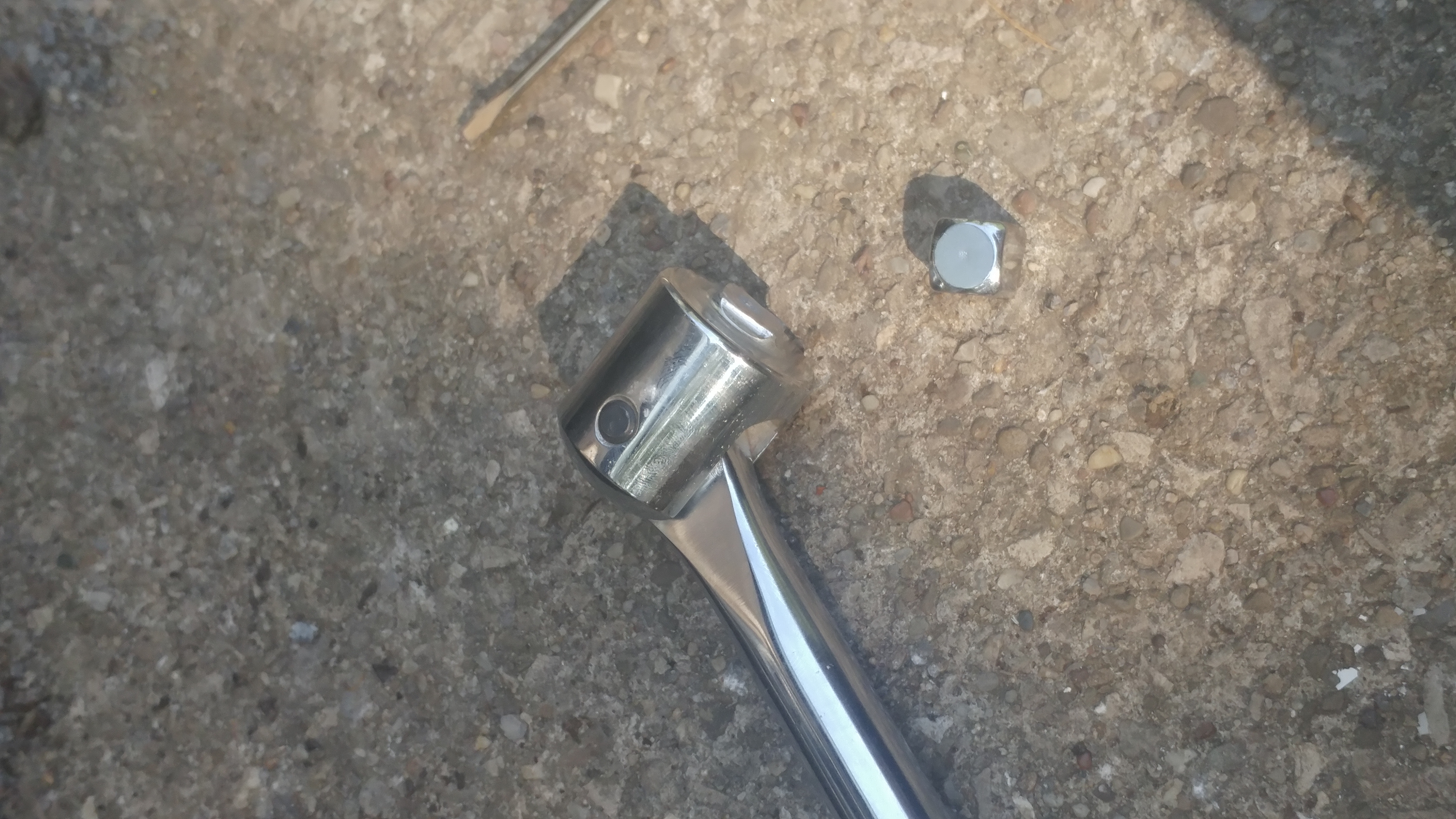

6 hours of hitting my rear axle nut with everything I've got and this happens :lol:
Posts: 3969
Been there ;) I have a 6ft extension for my 3/4 in breaker bar. Have had instances where that was not enough. Had to use torch.carefully. If you have access to a shop with a 3/4 or 1 in impact,you may want to take it there to break it loose. This is not uncommon. You may be the first person to try to get at the rear brakes since 1977. not :o

That tool was my next step. However I got a sliding breaker bar and a 6 foot cheater and that did the trick.
