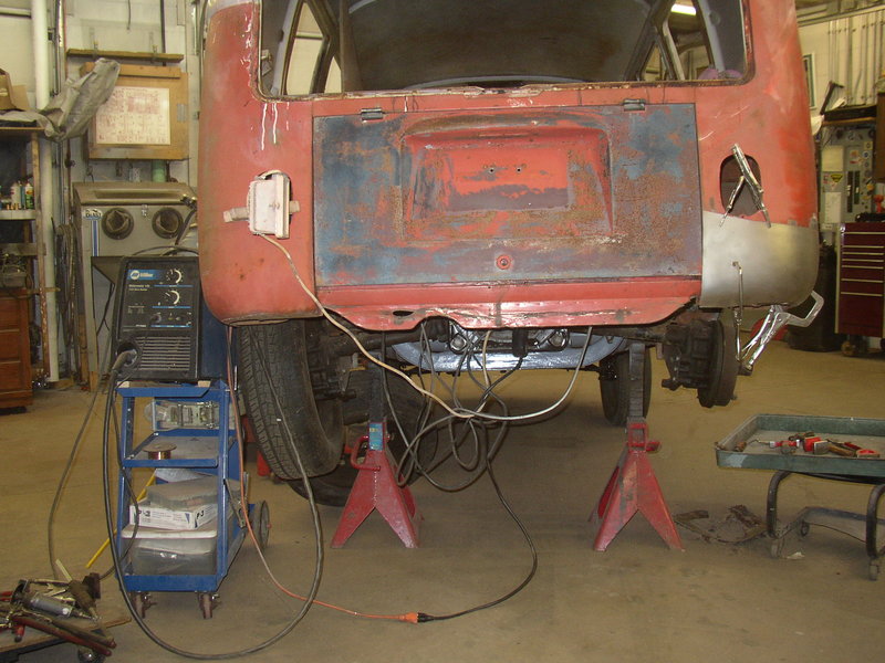

On another note, I must be a horrible witness as I have no recollection of the welder you're using. Is it a Lincoln or a Miller or something else? Also, if you can share, what settings do you generally use for cargo floor welds/rockers? Do you just "play it by ear", or do you have specific settings you use for specific welds? Can you share how you set up welding? I'd like to get better at welding (hell, I'd like to get better at everything) and this kind of project intimidates amateurs. And as you know, I'm an amateur!
I started the last bus with a small Lincoln but it wasn’t getting the job done. Miller is one of the best names in the welding field so I got lucky and stumbled on a MillerMatic 135 110v mig welder and have loved it ever since. I use a standard 75/25 mix of argon and CO2 and .024” wire.
On the inside lid there is a factory “cheat sheet” on what settings to use with the size of wire and material which I’ve found to be pretty good so I just stick with these. You can see I have the heat on 3 and the wire speed on 45 for 20 ga sheetmetal.

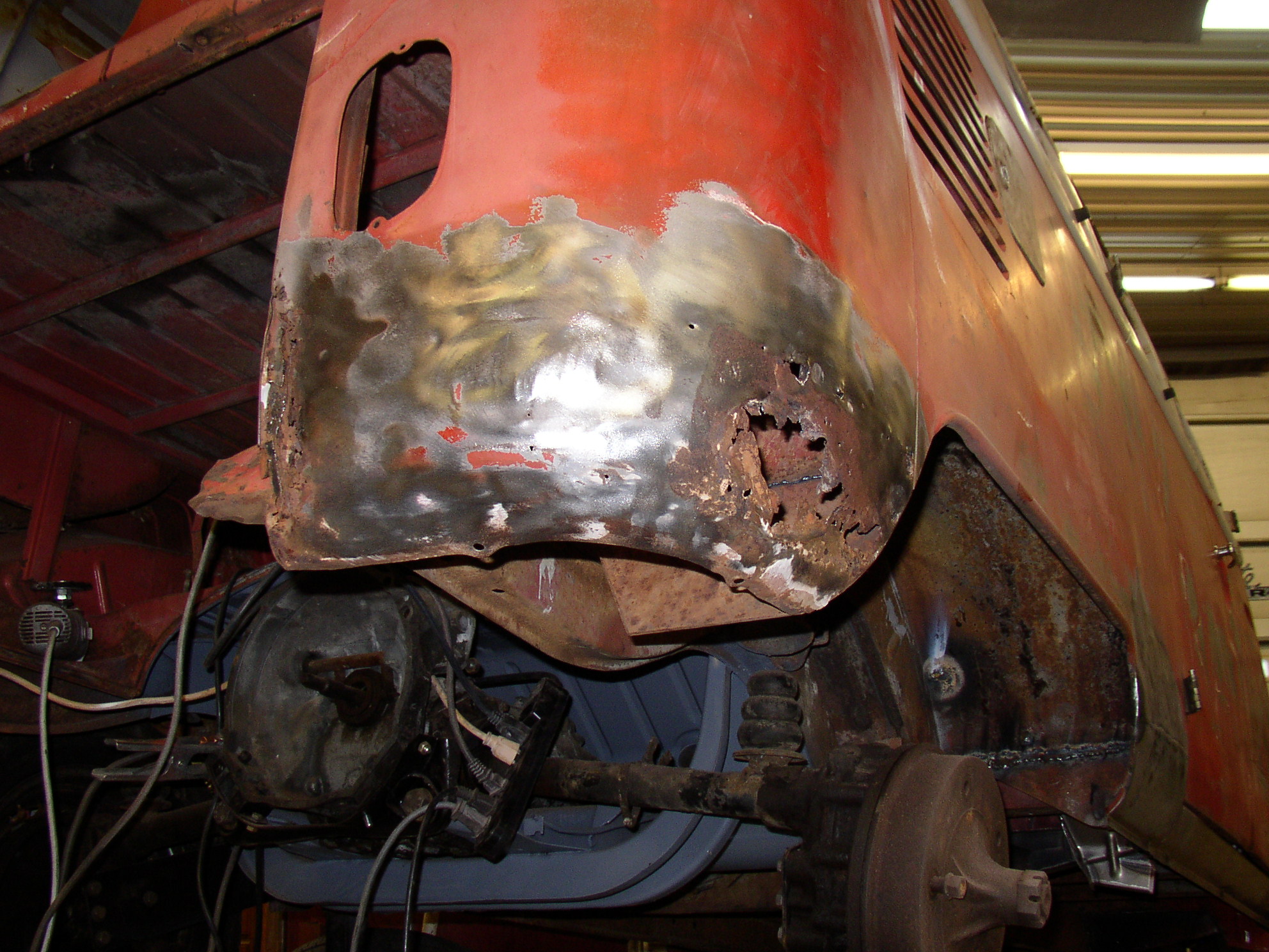

Anyway, back to the bus. The RR corner was next and it was crumpled up from a light hit. My gut instinct is to not cut the crumpled metal off, I generally straighten it back to near-correct before cutting so I don’t get too much going on at one time. So I took my monster wire wheel/bondo/flesh remover and took off all of the bondo, which takes about 30 seconds. Then I hammer and dollied out the crumpled metal until it resembled the correct profile.
I then cut the wasted portion of the metal away and started eyeballing the new panel, which was the curved section and not the flange next to the engine lid.

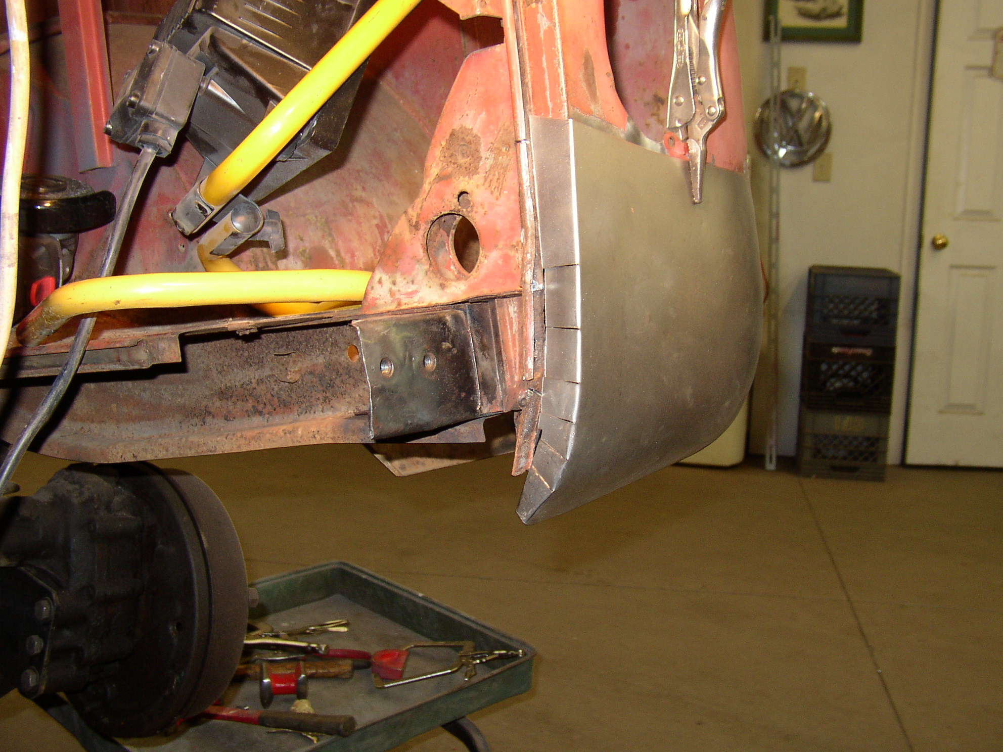

Here I’m test fitting the piece, the big flange in the foreground was also mangled pretty good so I glowed it, straightened it, and welded it back where it belonged.
Here the corner is tacked in with the lid and valance showing the gaps are good. No overlaps here, those panels are butted with zero clearance.

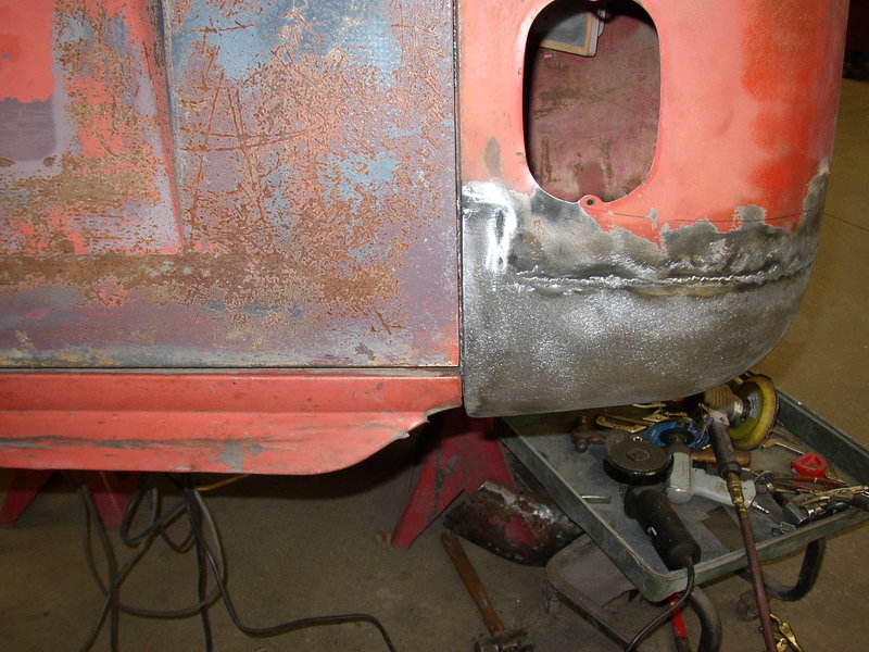

Fully welded and rough ground, nice gaps.
Here you can see the relief cuts welded together. A bit more finish work and this won’t be visible at all.
