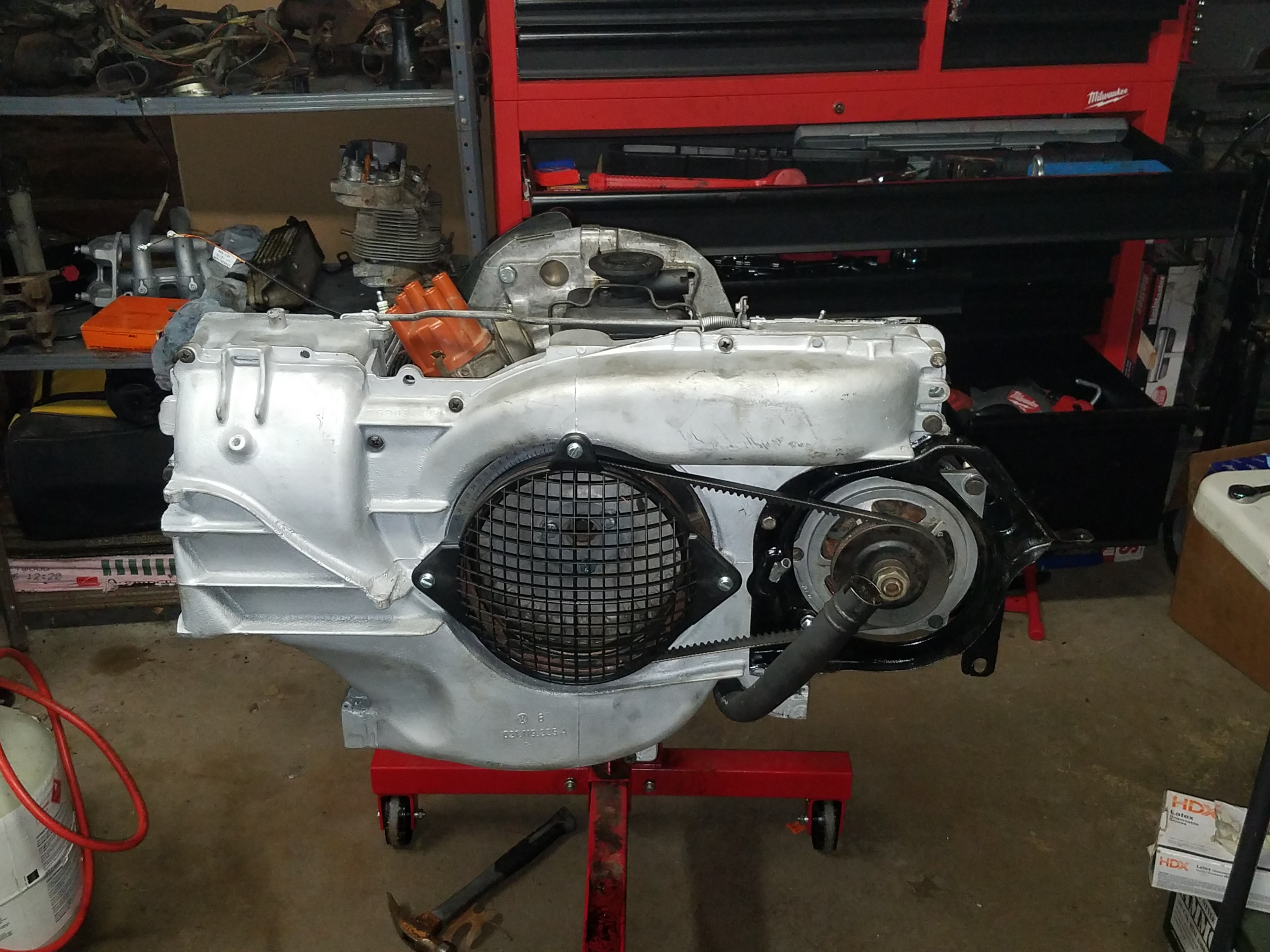

Shroud is on, valves are adjusted, etc. Need to pull the flywheel to install the felt seal over the needle bearing (if anyone needs one, I have a lot of extras).

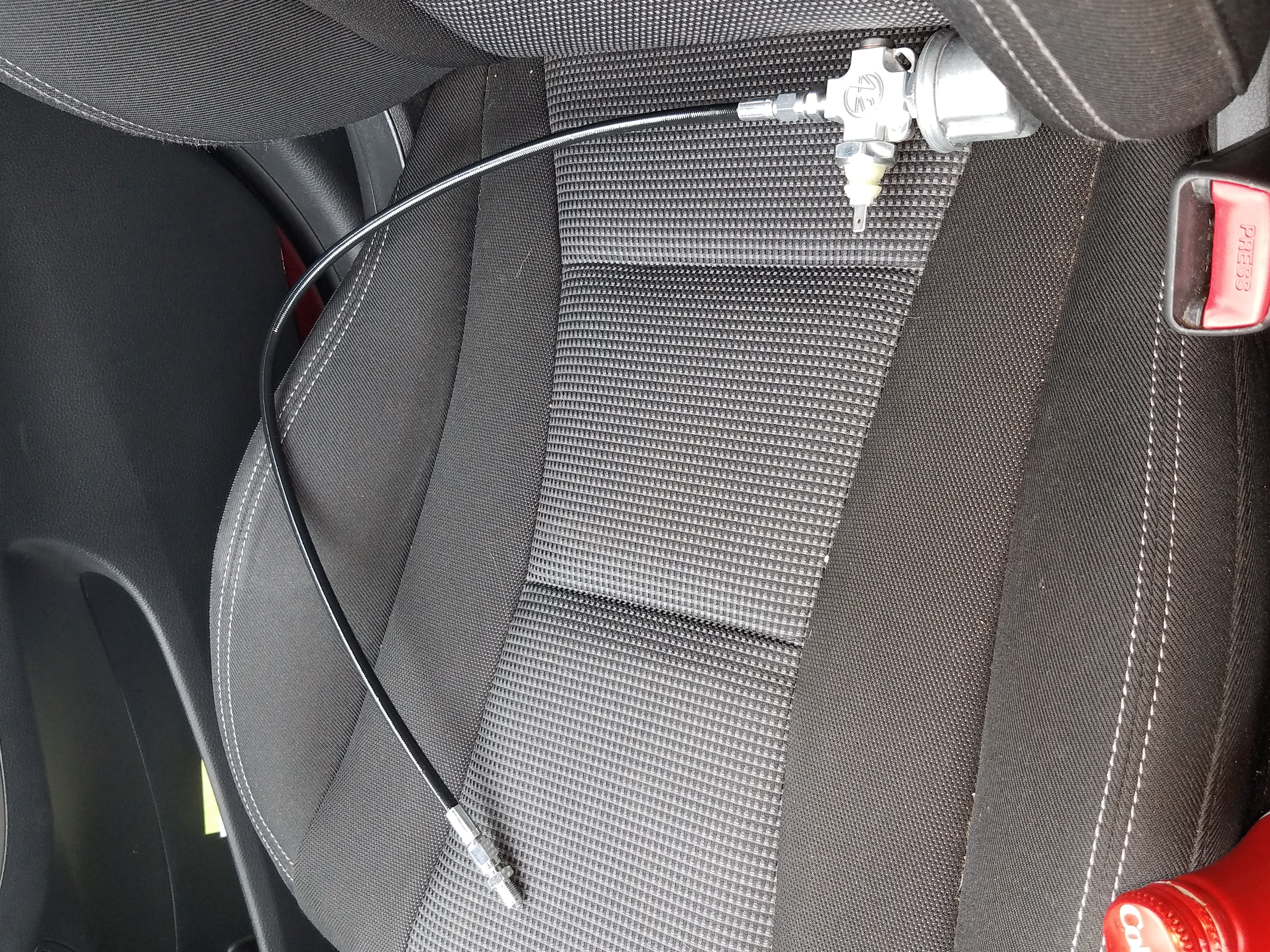

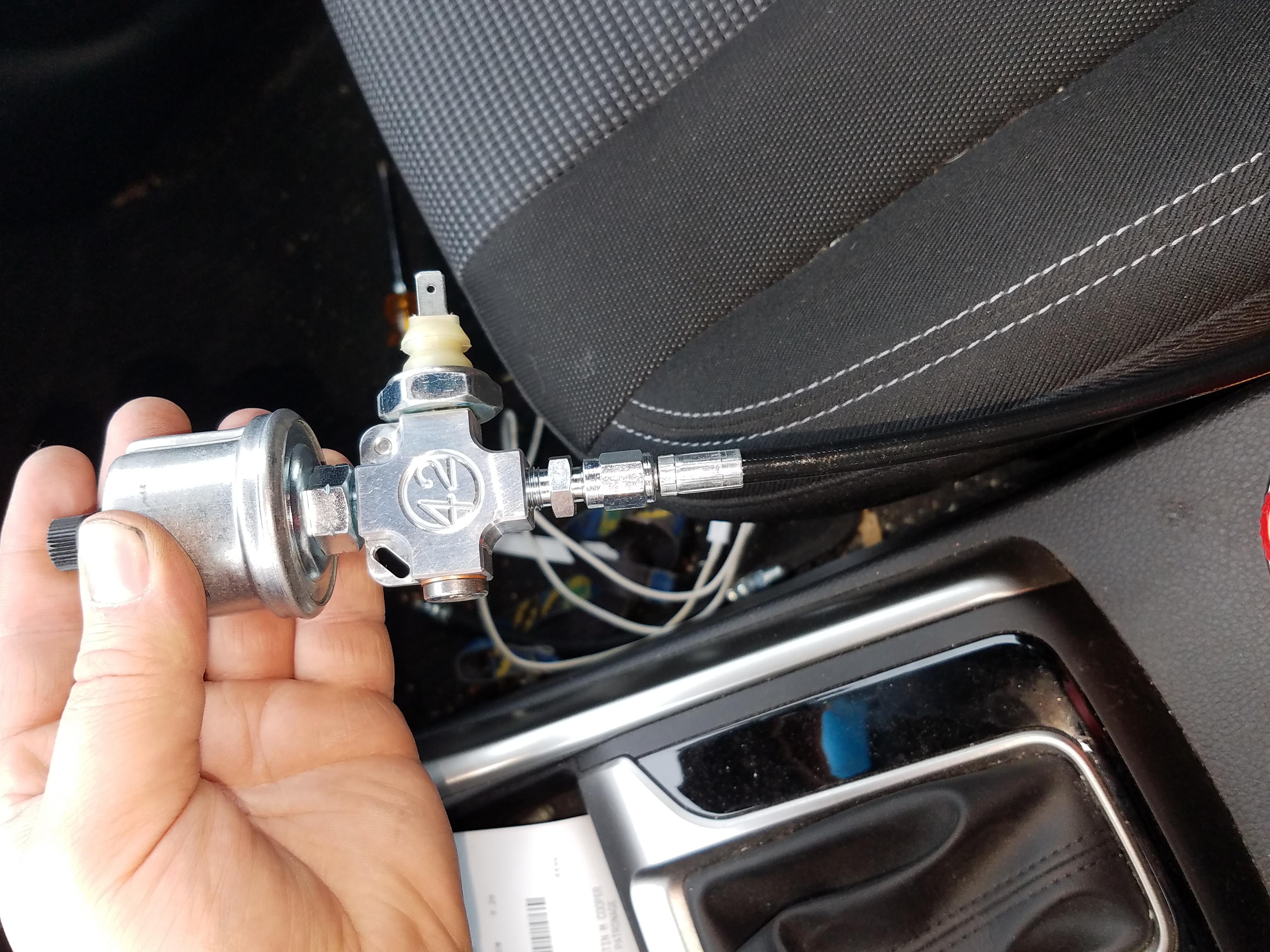

I want an oil pressure gauge. A tee screwed directly into the case could snap off, so I bought and put together an oil pressure sensor relocation system from 42 Draft Designs. The stock sensor is there to keep the light off, and I bought the VDO sender for my gauge from Dakota Digital.
The line that came with the kit from 42 Draft Designs was too short, so I went to Summit and got a 24" long black braided brake line.

I had to mess with the 1/2 tin all evening - it doesn't seem to want to line up at all

Kooper271 wrote: Tue Apr 25, 2017 11:10 am 20170425_102130.jpg
You might have an issue installing that M dash 3 to M dash 3 union into your oil pressure sending port. You need a male 10x1.0 to male dash 3. in the future if you call 42 Draft and order this kit just ask for a longer line and they can supply it.

Good to know about calling 42 draft in the future, thank you. I did get m10-1.0 adapters for the hose and everything threads together nicely
