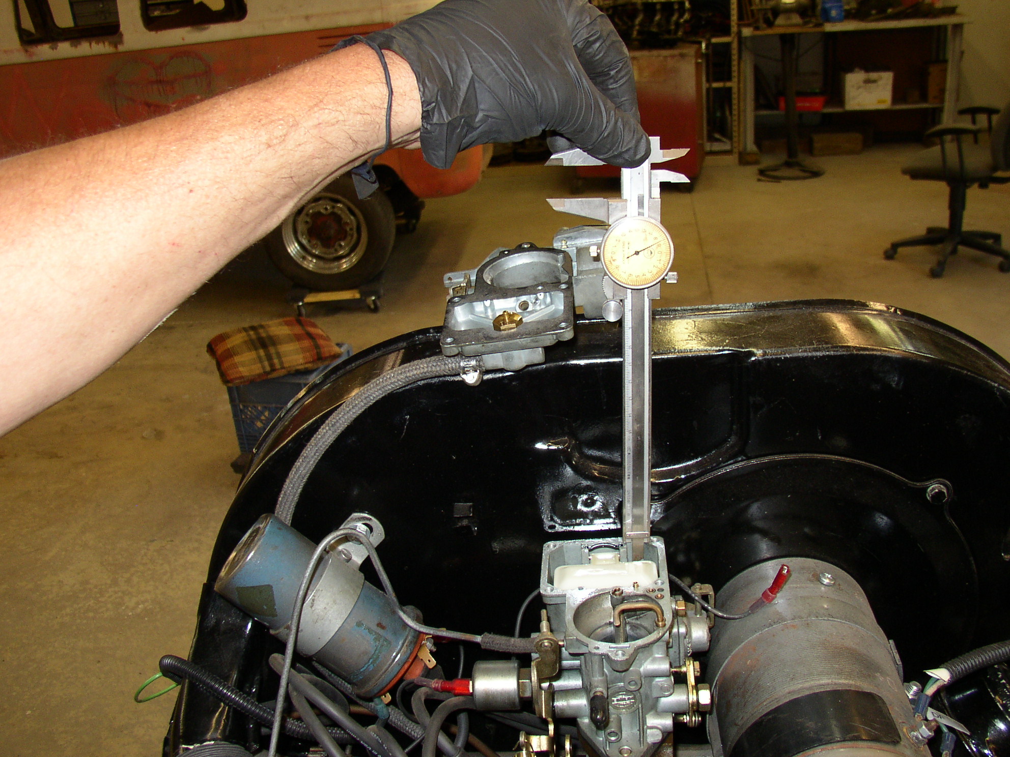

The carb seemed too rich and the float level was a bit high.
A thicker gasket under the needle/seat fixed that.
