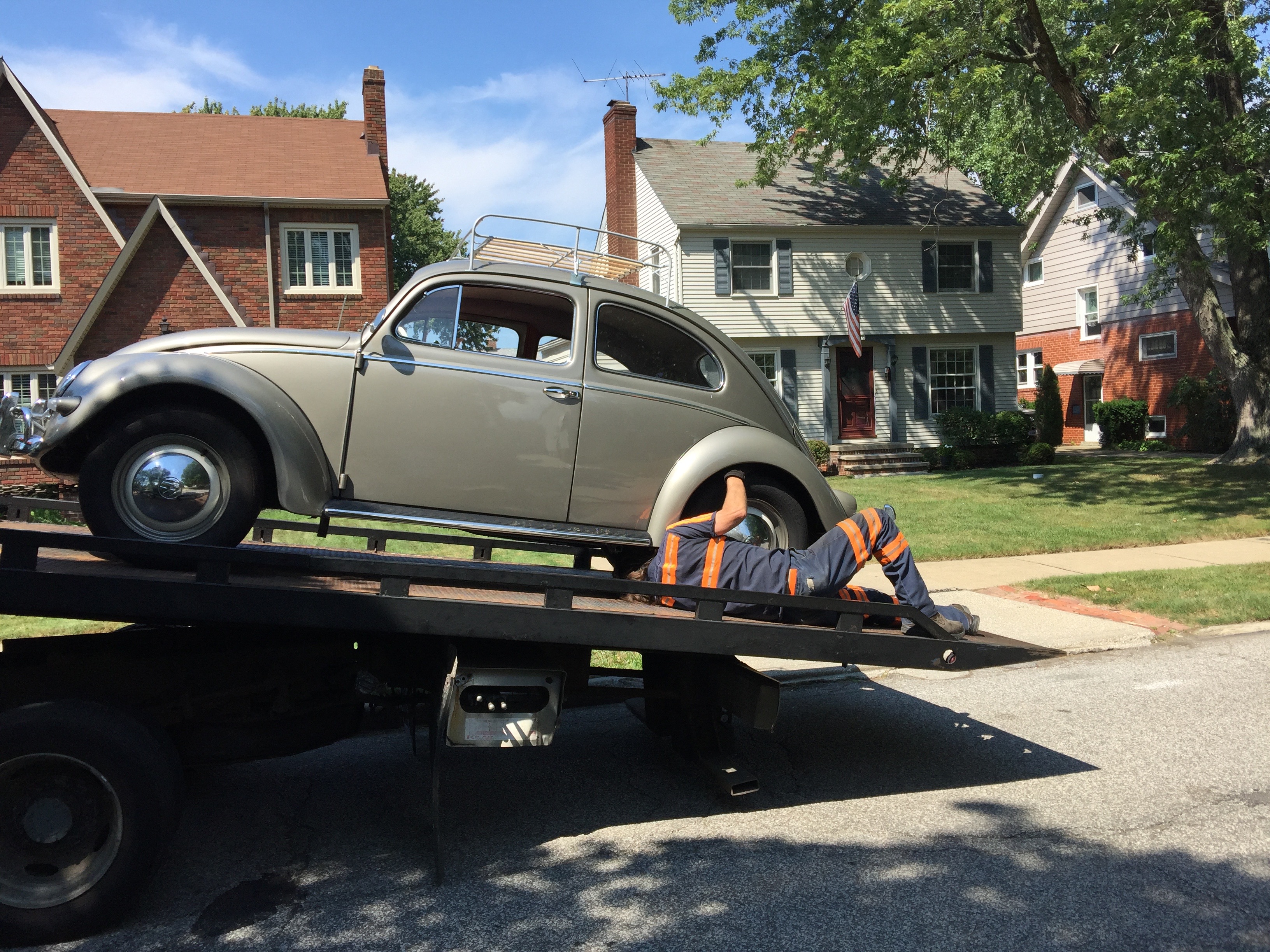

Photobucket has ruined the first 14 and 1/2 pages of this thread, but that's no excuse for me not having this thing on the road. Josh came over and lent a hand one day. (Much appreciated.) I did the best I could with the motor. Got everything back together and of course it wouldn't start. Clearly, not getting fuel. So I called Bruce. Thankfully, he told me to bring it over. Bruce will update his findings and efforts in the near future.

Yes, the Oval has returned. Actually it looks pretty good and Sean (and friends) got a lot accomplished on it since I last saw it.

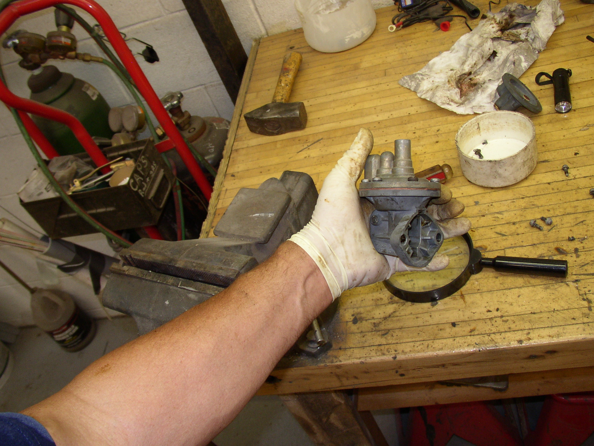

So off comes the pump for the first of what would come to pass as multiple rebuilds. :shock:
Let's put the spring back on the correct side of the diaphragm for starters, and assemble the check valves correctly. :roll:

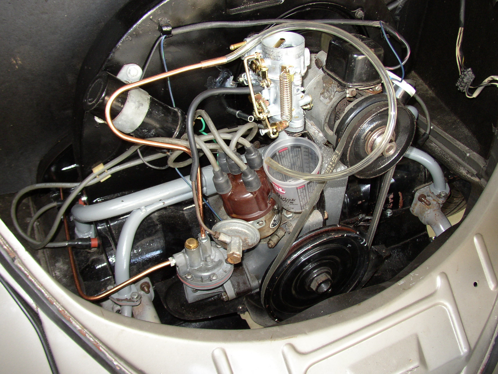

The throttle cable was mucked up, too. I see this frequently, especially after the engine weatherstrip has been replaced. You have to take a die grinder and make clearance for the throttle cable and Bowden tube, which this car didn't have from the factory.
It does now.

While I'm messing with that, let's put a clamp on the cable tube to keep the SOB from sliding into the shroud.
Big day yesterday, it went for a road test under it's own power for the first time in decades! That's one happy Irishman there......

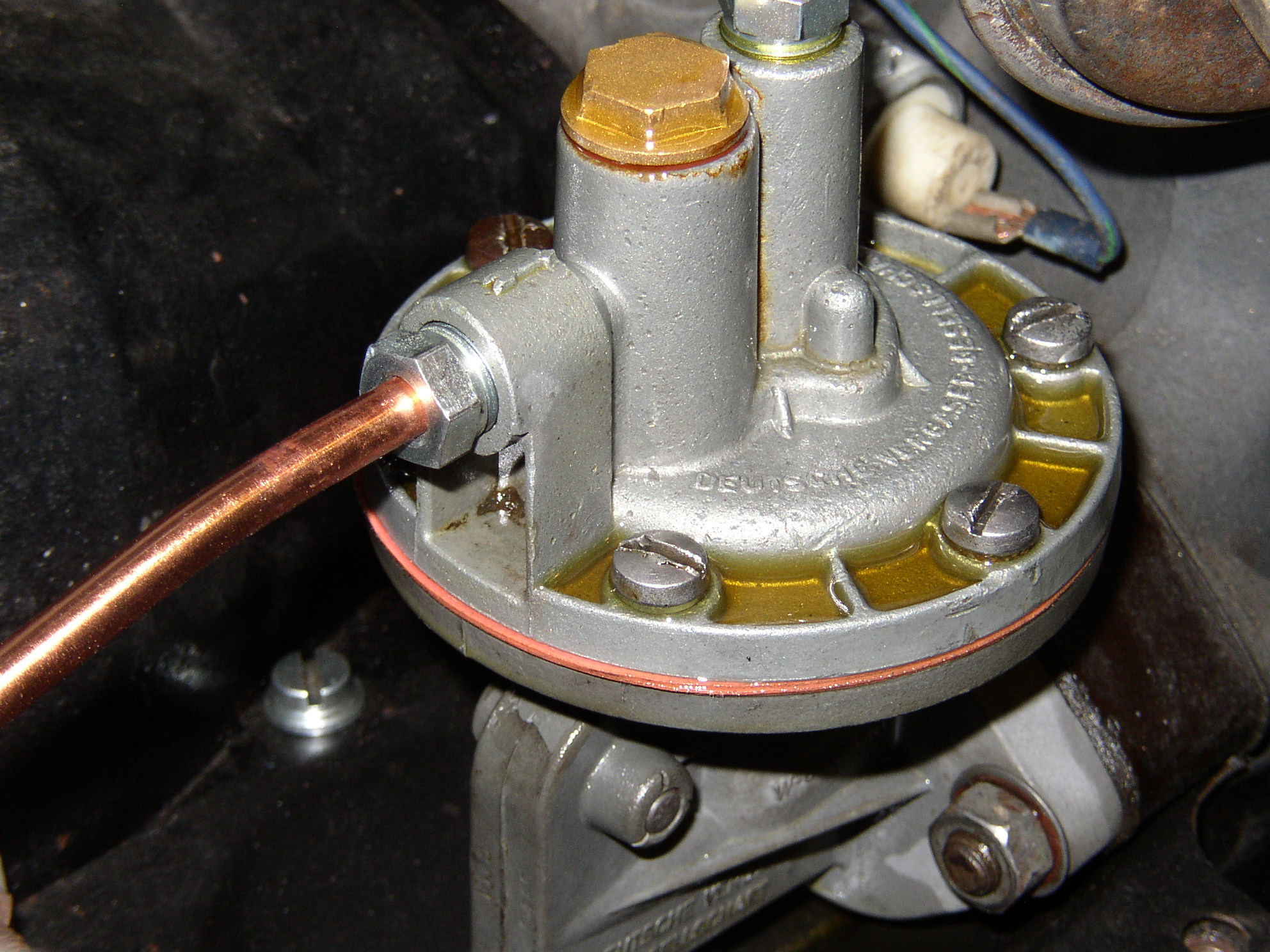

But, the MFFP is leaking again after it sets. What is this now, four times?

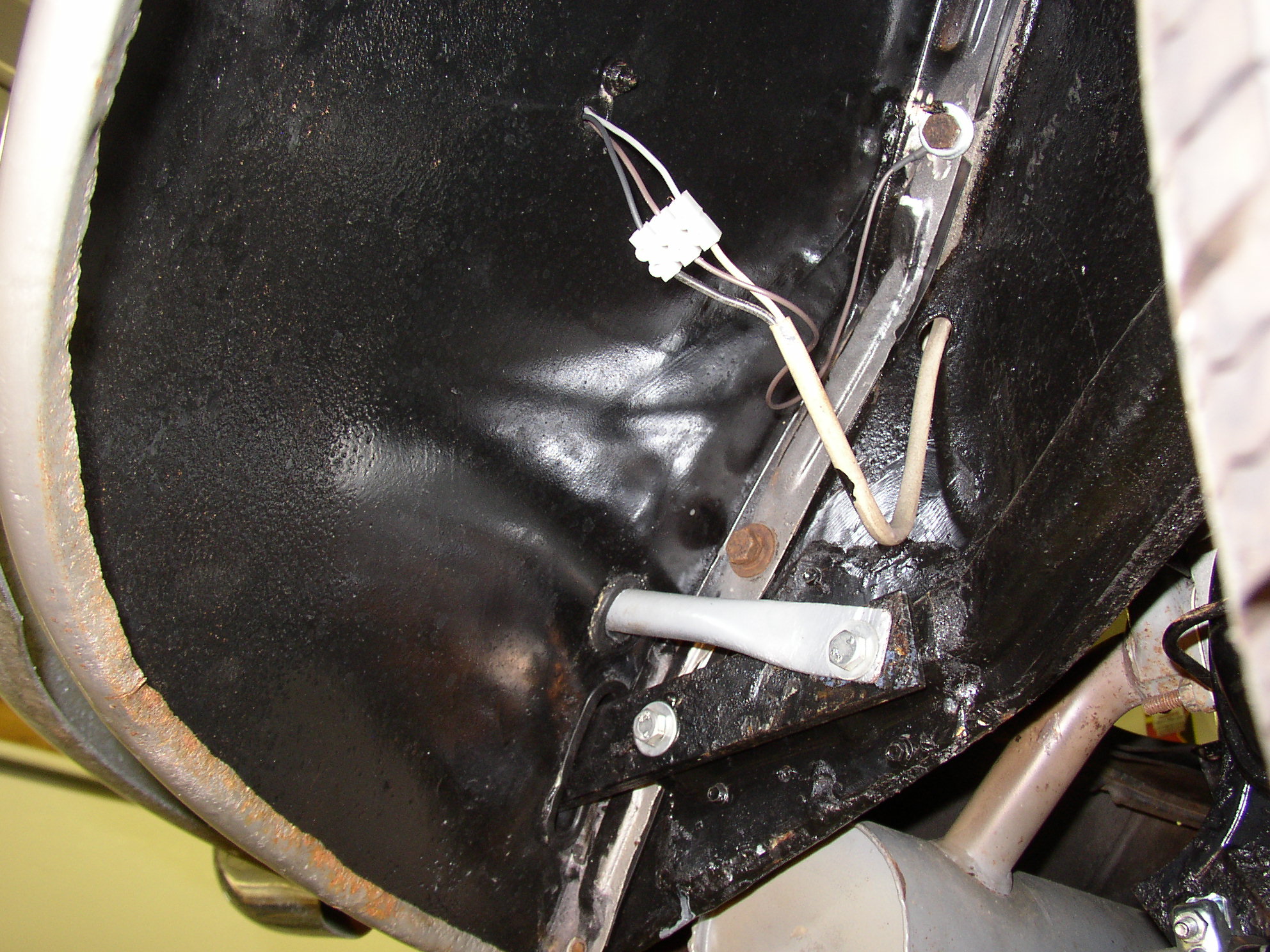

Lets straighten out some wiring. A previous technician installed LED taillights but the wiring could be cleaner.
Let's gut that and start over. Remove the assemblies, bead blast the bracket because it will be the ground now, grind the paint from the inner fender so it makes good contact, and
Solder the wires with shrink tube.
And now it looks nice and is protected. A bit of grease will go on the screws to stop rust.

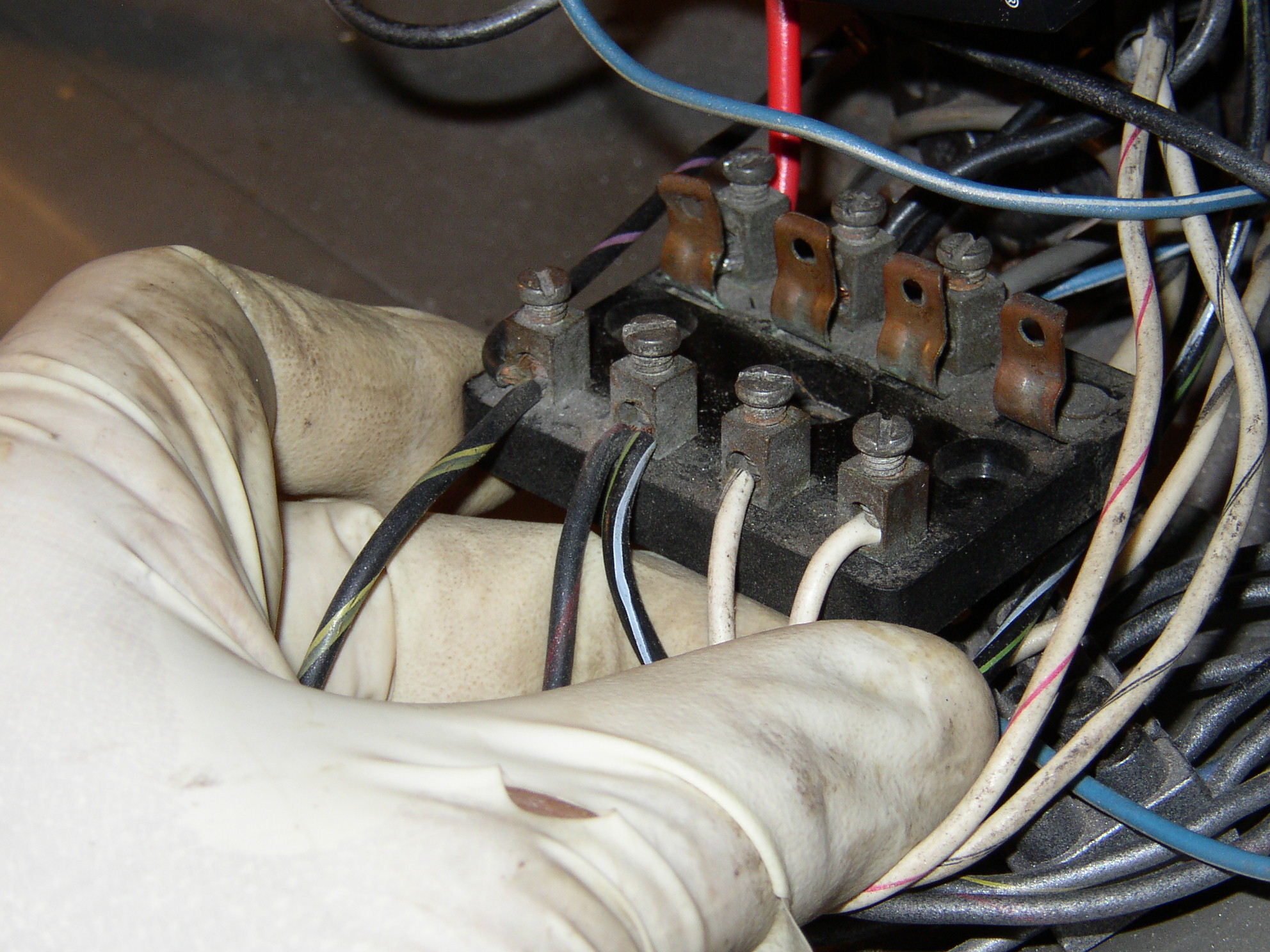

Lots of electrical doesn't work so one of the first things I do is remove all of the fuses and wire wheel the contacts with a Dremel. Shazam! The wipers "worked" as soon as I did this.

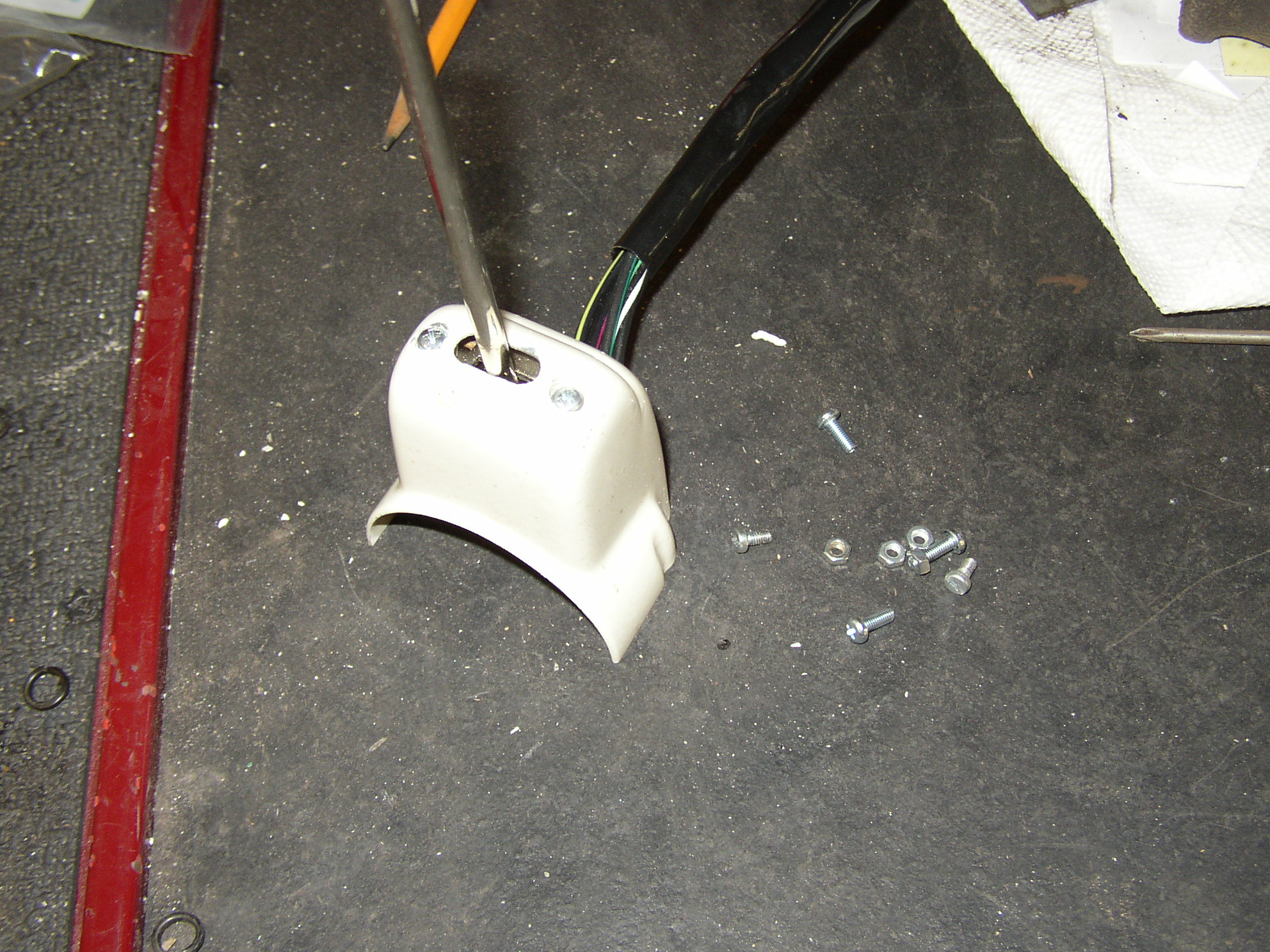

Messing with the TS switch right now, and of course the screws were too short and my bolt bin only goes down to 4mm. :x A quick stop at the hardware store got me some 3mmx7mm screws.

Don't know what's up wth the fuel pump outlet leaking. Bruce tried a couple combinations of tops. Even after cleaning and refitting,they leaked. We replaced the outlet lines with aftermarket ones from WW. Maybe they're the problem? If so, I found an old one that I cleaned up that I'll take out to Bruce to see if it's the answer.

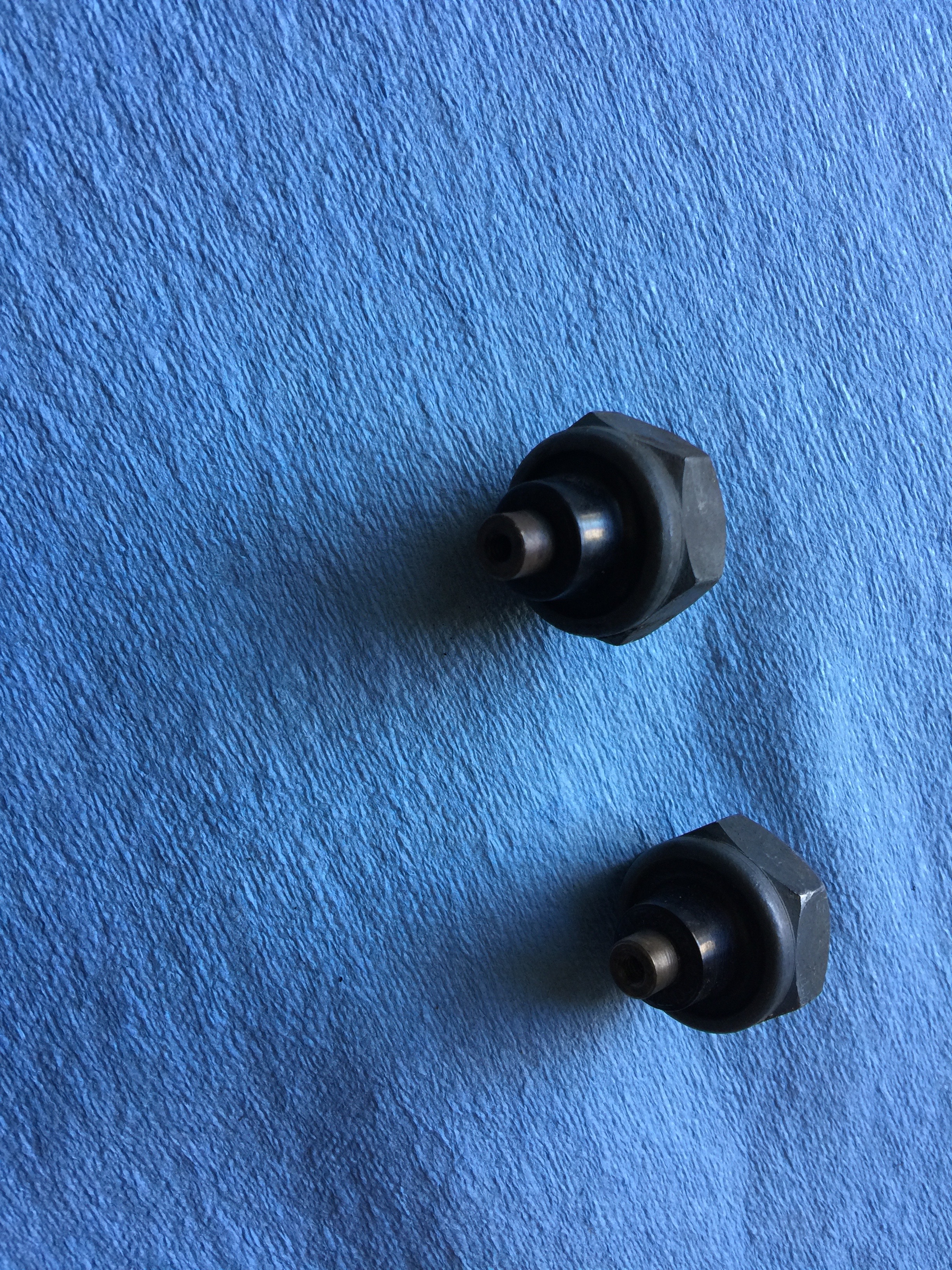

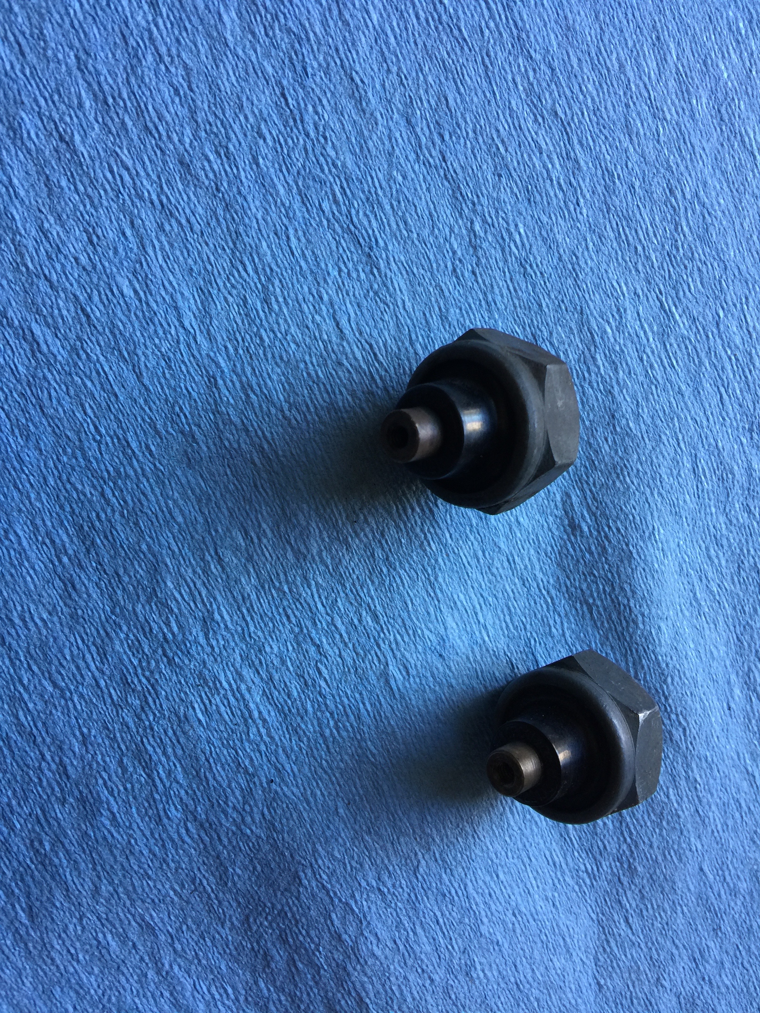

The oil pressure sensor tested bad. It was a spade model that I had from another old 36HP. I found two really early versions. Both cleaned up nicely, but they are missing the screw that I assume the wire connects to. Since Bruce knows metric screws, I'll bring these out and see if we can get one to work. It seems oil pressure sensors for 36HP engines are hard to find or NLA. Here's a thread on the early oil pressure sensors and a picture of the two I found. https://www.thesamba.com/vw/forum/viewt ... ure+switch
