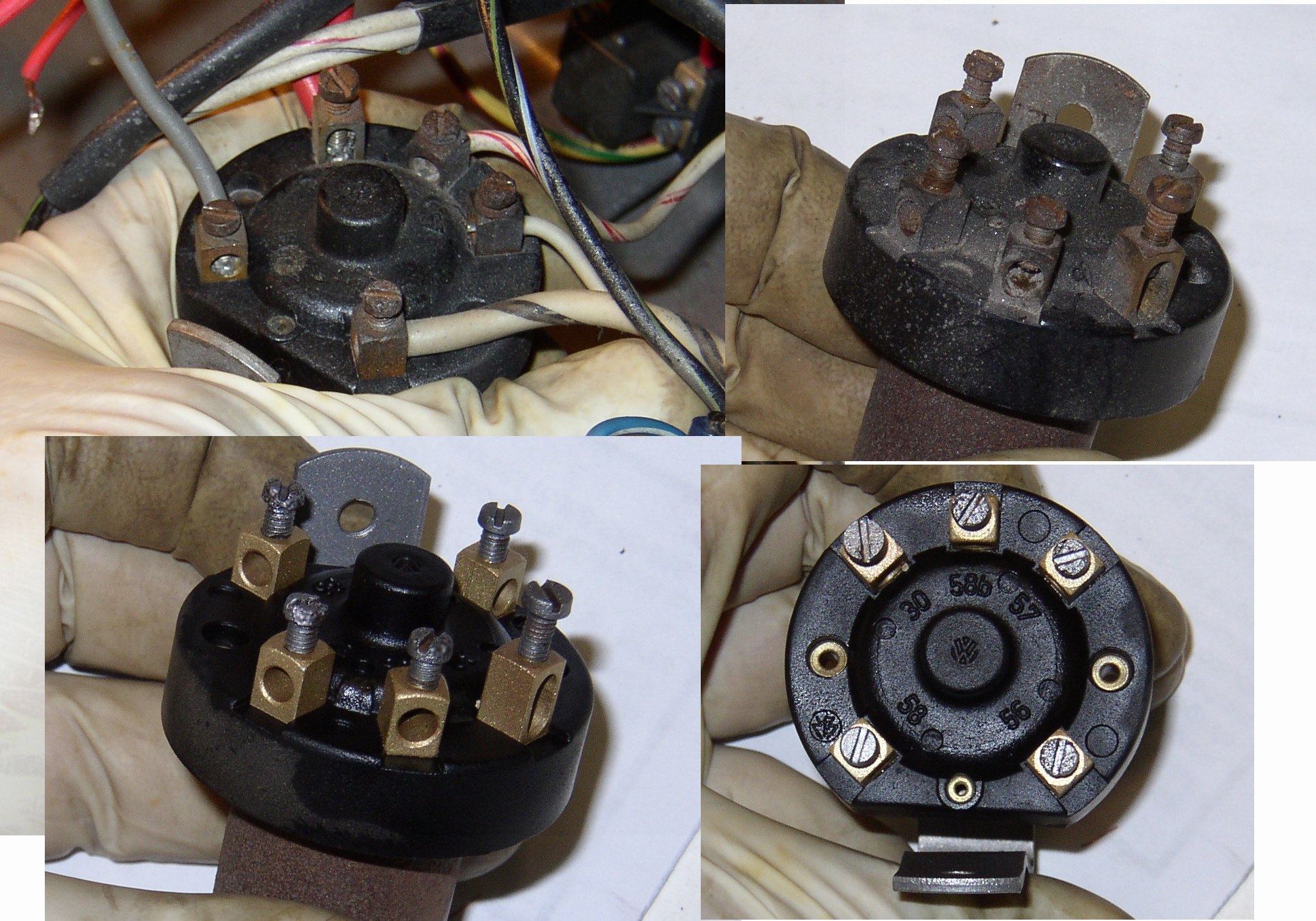

On to the headlight switch. The same power feed comes here before going to the fuseblock, but it's important to remove and clean the HL switch before installing the new harness. Here are before and after pictures of the HLS when it goes for a ride in the blast cabinet. I also spray it with penetrating oil and blow it off thoroughly, you can see the remnants of the oil on the terminals. This helps prevent surface corrosion in the future.

All of these corroded surfaces would have stacked up to create considerable voltage drop in every circuit on the car and when you have only 6v to start with you're already at a big disadvantage. :)
