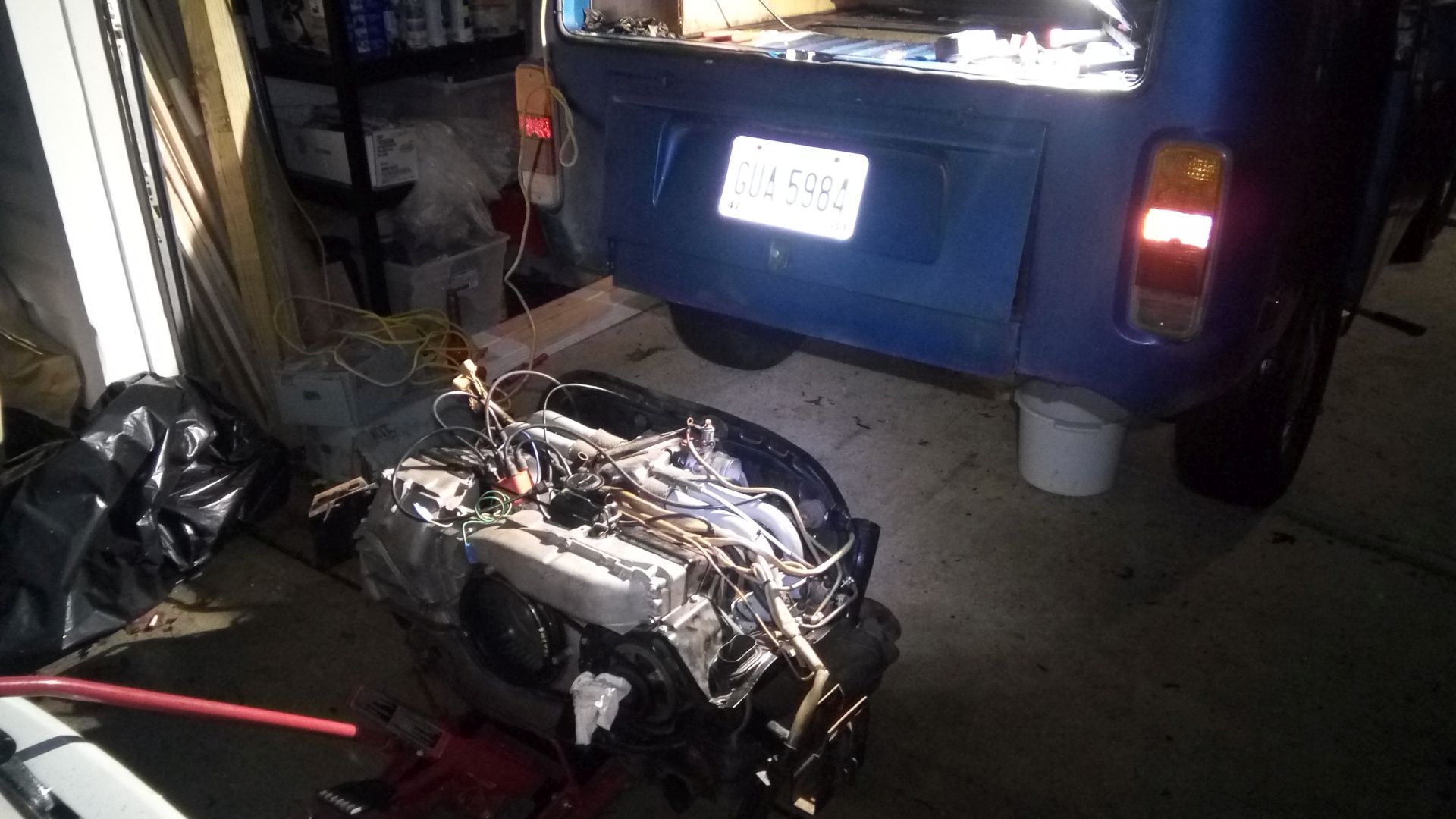

First thing first: engine removal. First time doing it, it took me a whole 6 hours but I'm proud of it :) I also froze all my body extremities in 17 degree weather. Special thanks to Bill, Chuck and Mike for advice during removal. In order to avoid bugging them with too many questions, I just rotated calls and messages. I pulled the engine all the way back and the spline shaft was not clearing. I was ready to remove the bottom part of the oil filler neck to create the extra inch of clearance needed, but in a stroke of genius, or "I'm so cold I don't care if I screw up", I tilted and wiggled the engine until it detached completely, and was able to drop it. My happiness was short lived as I realized that my jack stands are too short and the engine is stuck under the bus. I ended up stacking some 2x6's under my 2 ton HF jack and lifted the bus enough for the engine to clear. VICTORY!

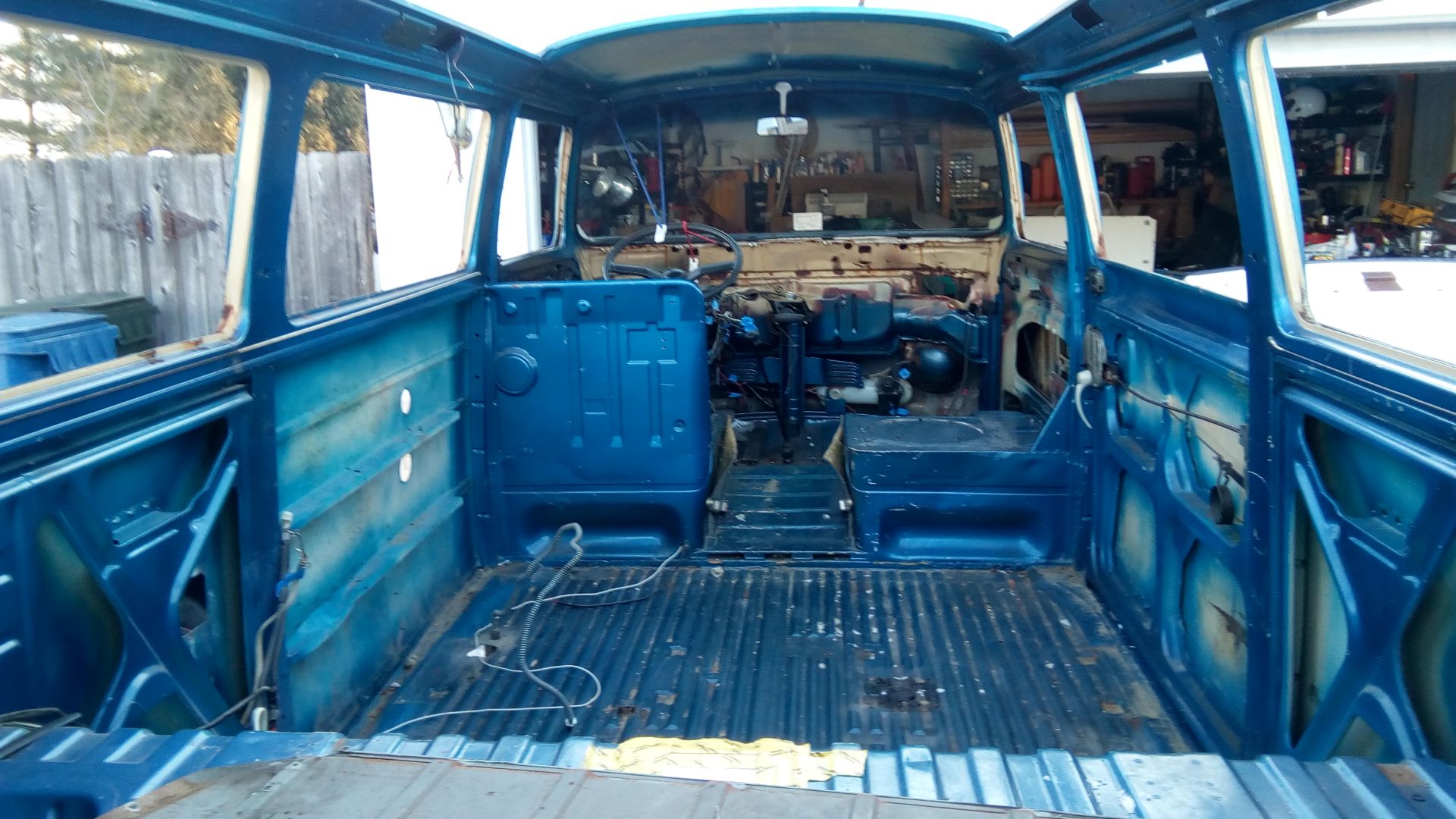

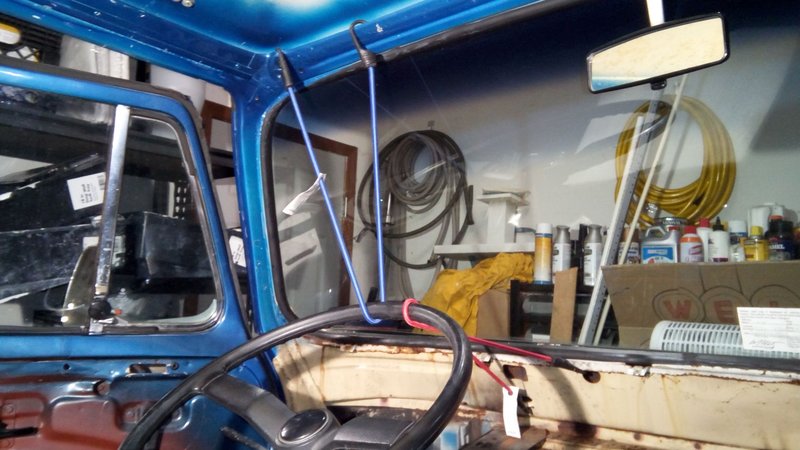

Over the next few days I gutted the bus. I have a big stash of labeled ziploc bags with all the hardware. Removing the dash took a while. bungees came in handy for supporting the steering column

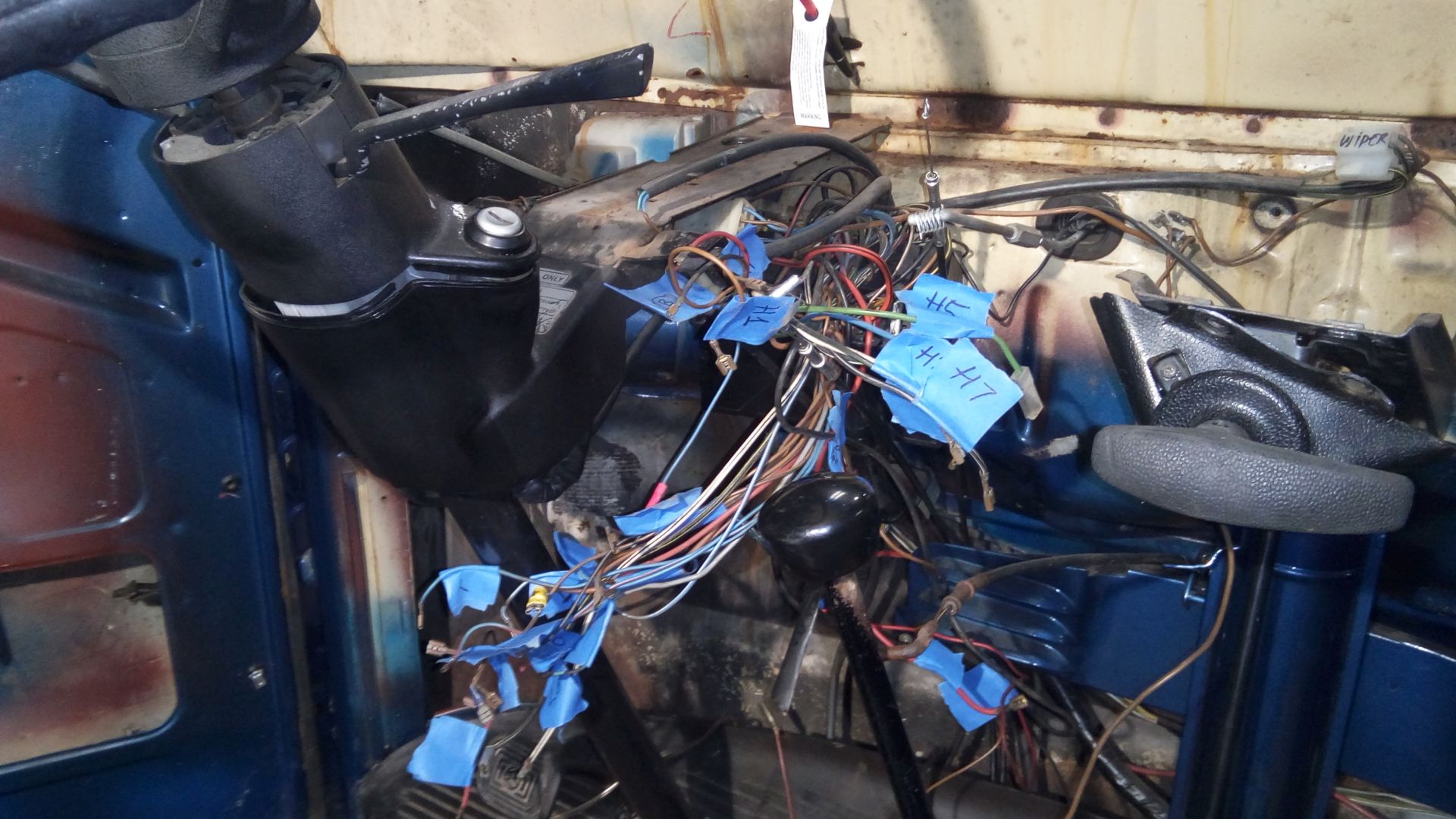

for some reason I can't post more than one picture in a reply so here they are individually. All wires labeled

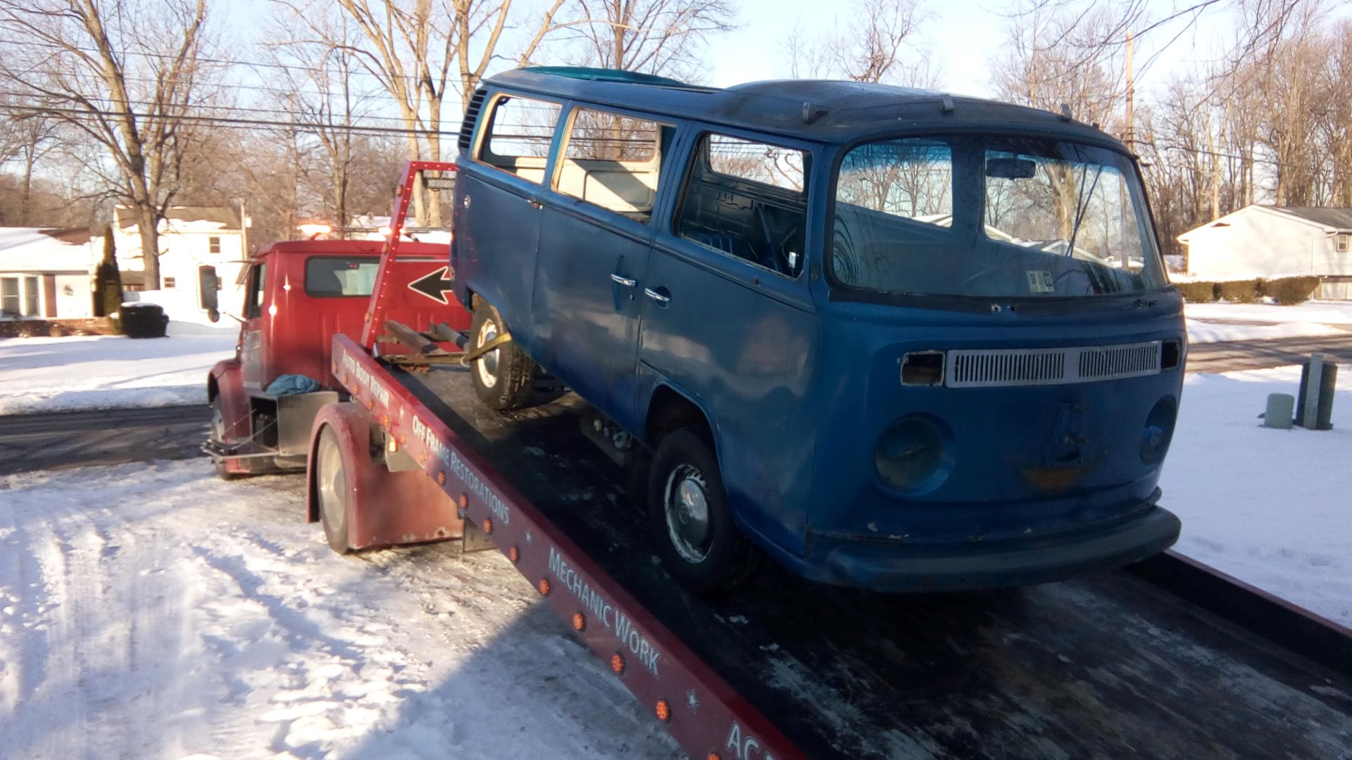

in the morning I had just enough time to remove some tidbits before the tow truck showed up. This is the final result
ohiowesty
Posts: 261
Re: 78 westy
Post by ohiowesty »
Sayonara bus! Also, engine dropped at Chuck's!
