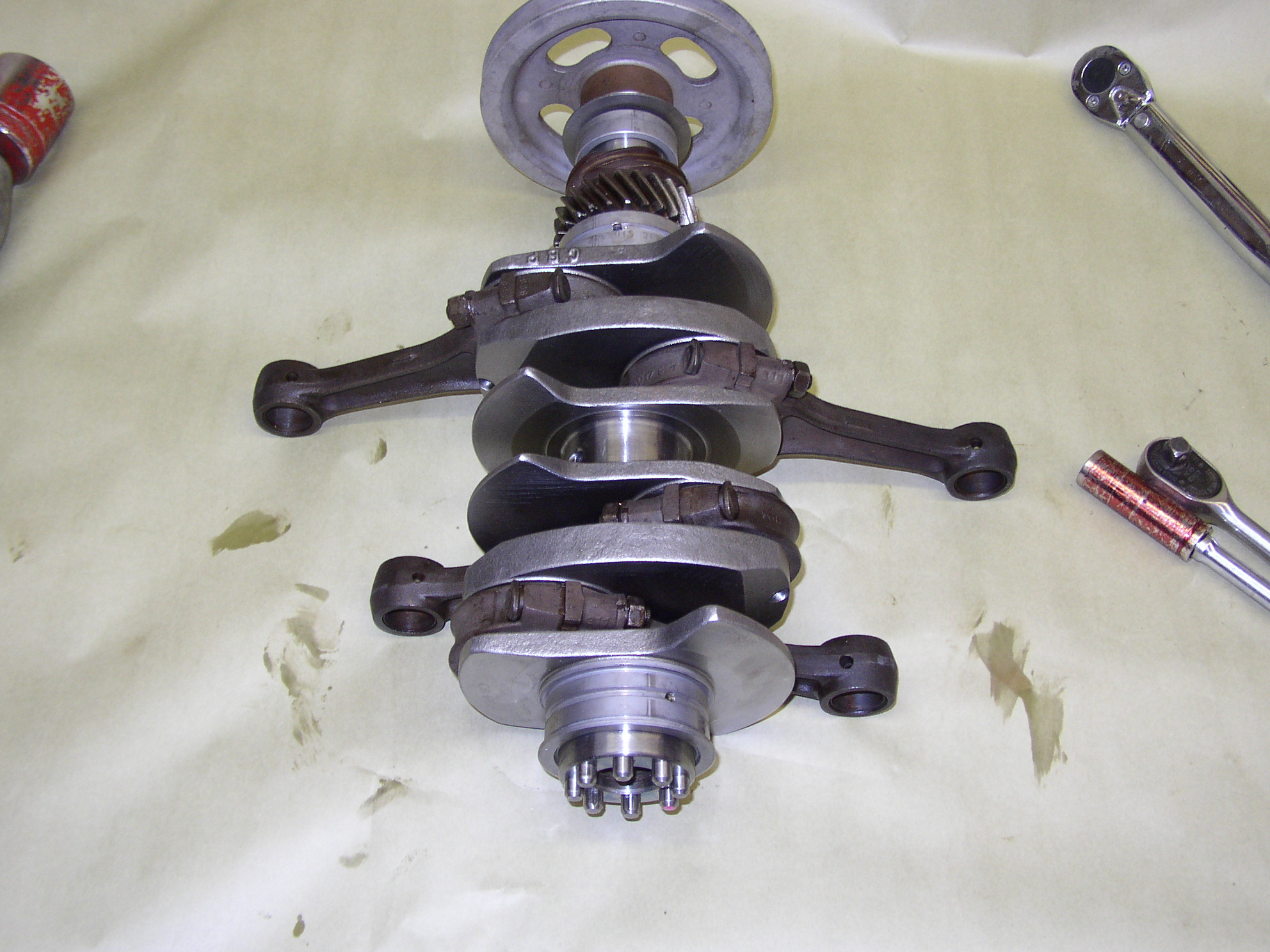

Yea, no matter how good Jim's drills the FW, you still have to open it with a rat tail file to fit. :roll:
Make sure it seats all of the way with a .0015" feeler gauge.
Put a little Prussian Blue on the flange to be sure it spreads out from contact.
Mock it up again.
Now's a good time to start fitting end play shims.
The cam was binding only after installing everything, I had to take a few thou from the flanges with 600 grit to get some endplay.
Clean and check the con rods, then assemble them.
One more last dry fit and torque to make sure everything is really free.
Goop it with Curil T sealer.
And here's where we are- short block done. Hooray!

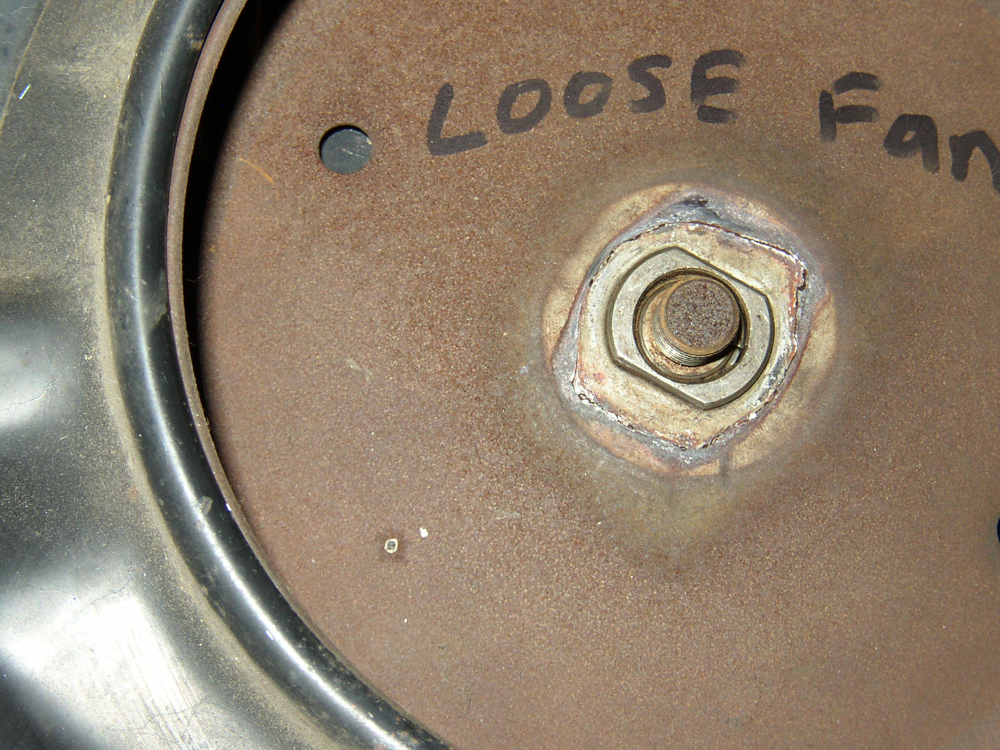

Fan hub was broken, no big deal.

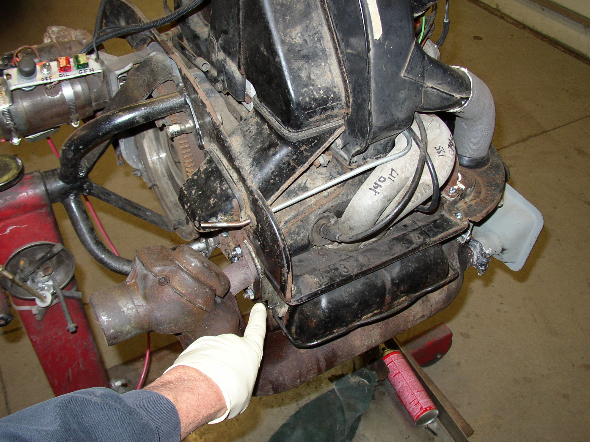

Here's something bizarre when it was on the run stand- the bellhousing adapter is bolted tight but not grounded! Ted would call this a voltage drop of 12v when it should be under .1v :mrgreen:

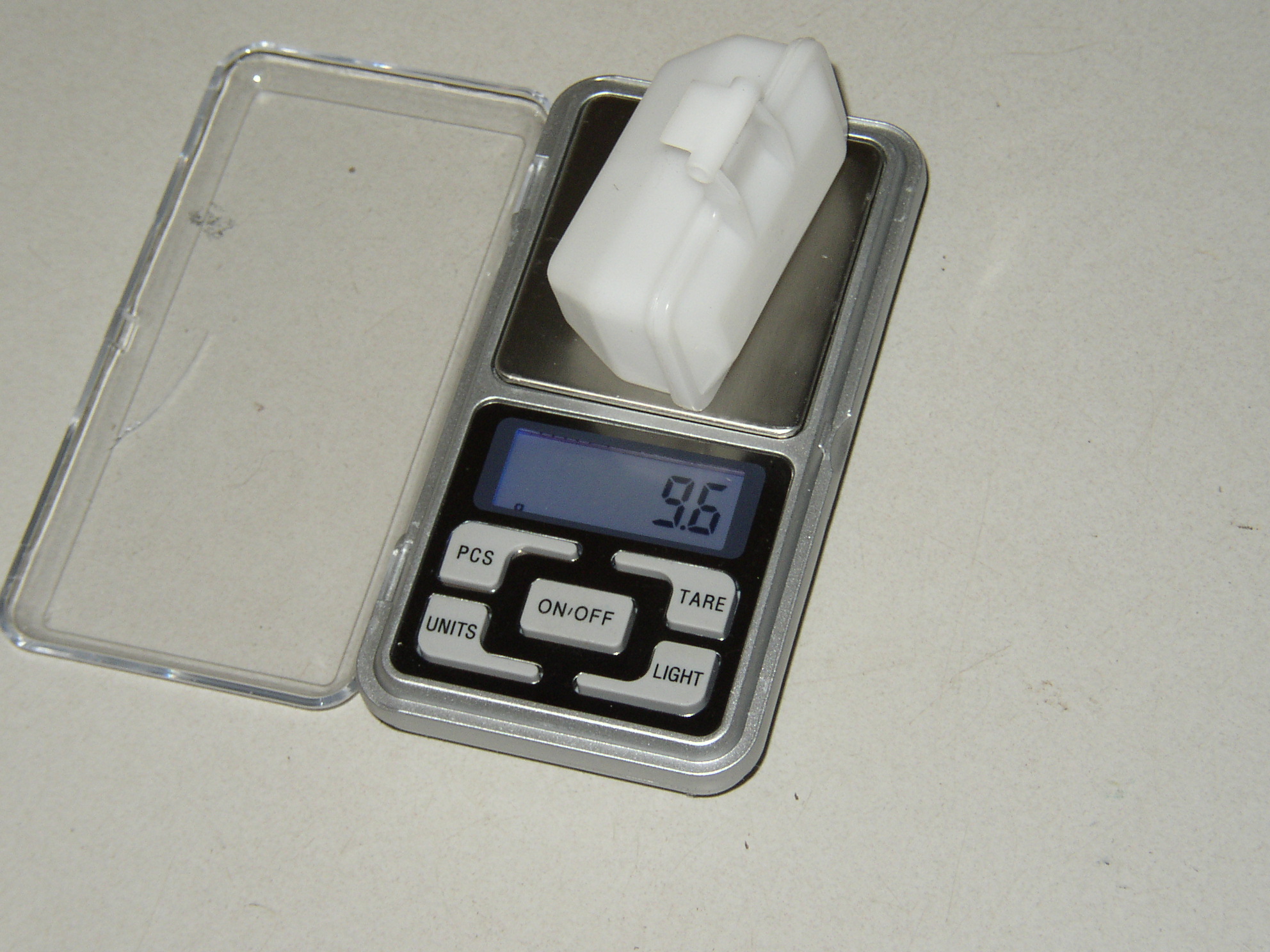

The float's a bit heavy according to specs. Don't ask why I have a gram scale. :mrgreen:
Even a new one is a gram over, but better.

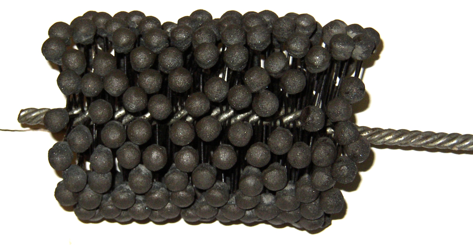

I left off with the short block assembled on the 1600 CW engine. I had some nice jugs with low mileage on them so I ball-honed them for re-use.
For those who don't know what a ball or bottle brush hone, this is it, they work great.
It's hard to get a 30° crosshatch but I try. I use a mixture of oil and K1 in a coffee can for lube, do it outside as it makes a mess.

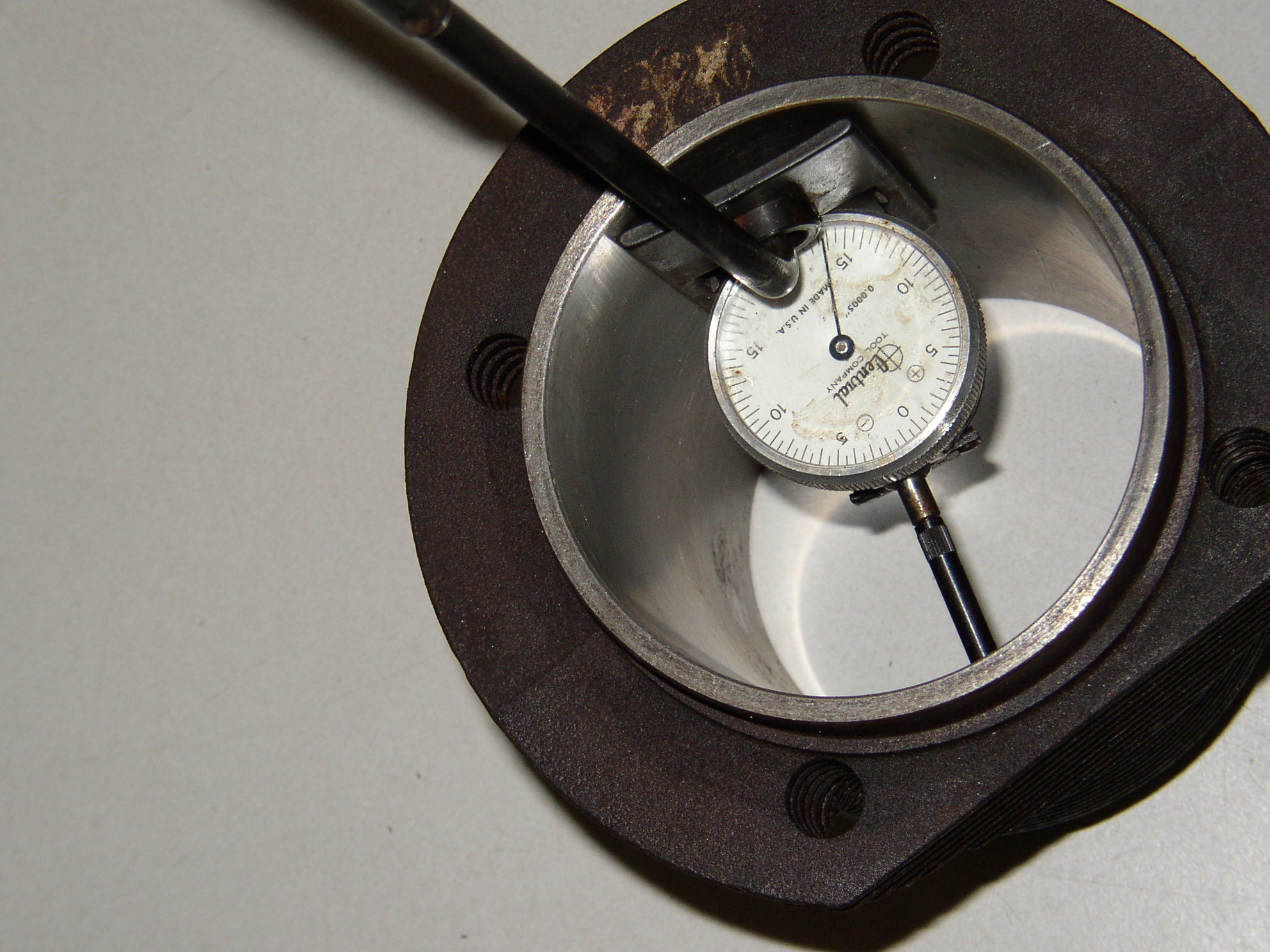

Once they're honed and look nice, check for wear, taper, and egg-shape, amazingly these check out like brand new- zero" of those.

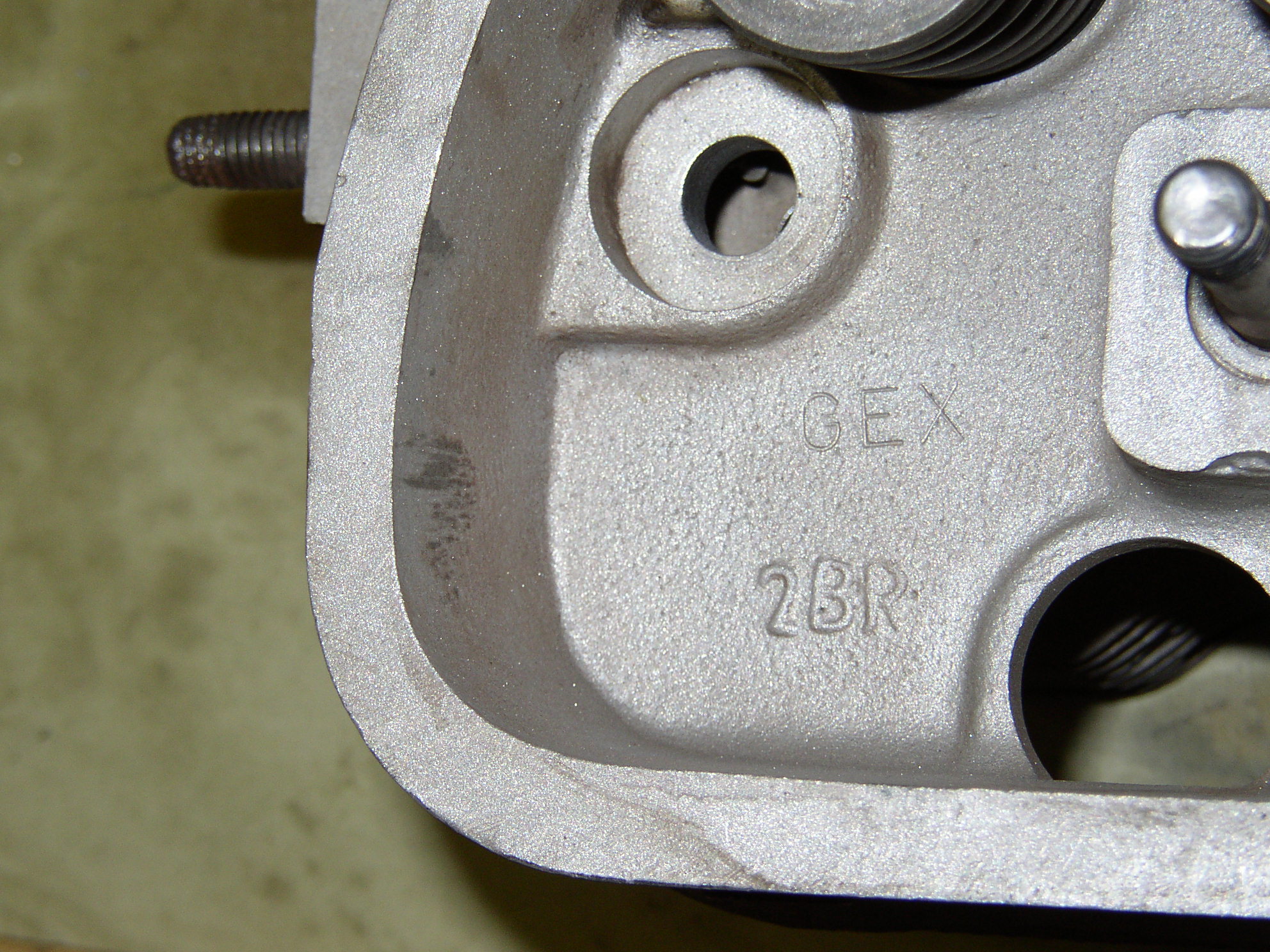

I bet this tube of dye is older than some LeakOilers. Check for leakage and an intake leaks, so off to the machine shop they go. :|
It wasn't until later I saw the "kiss of death"- a GEX stamp. :shock:

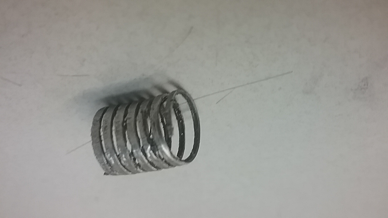

Check the ring gap after squaring the ring in the jug using a piston, they're tight- right at the minimum of .012" :)

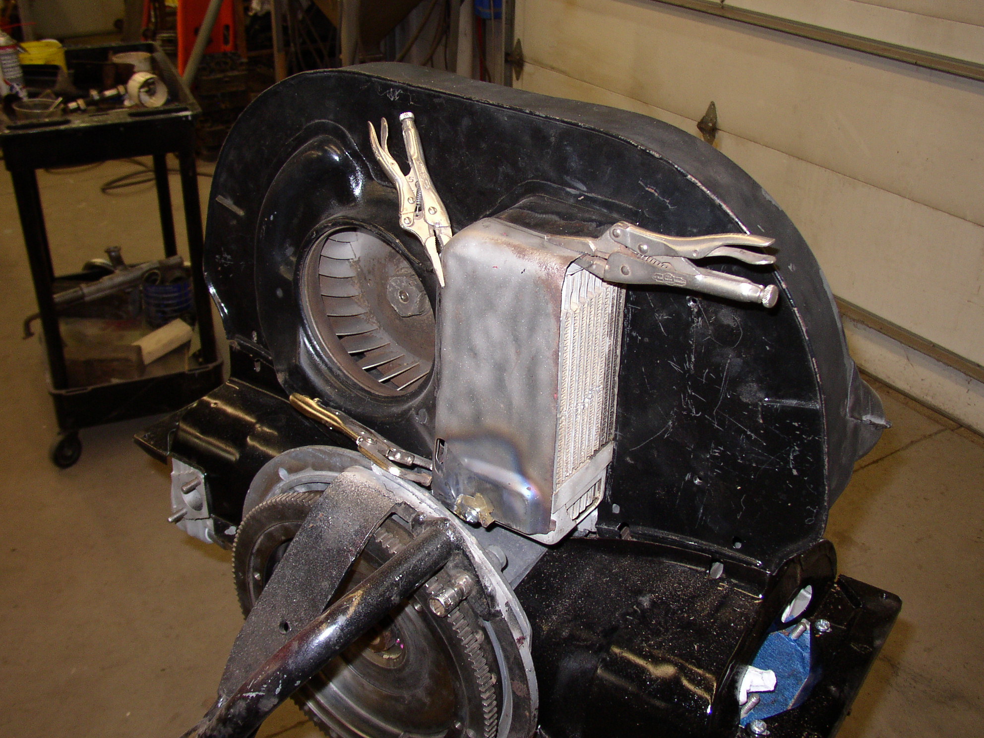

Bolt on the T4 oil cooler and modify the shroud. T4s have 40% more surface area.
It's easier if you use an old shroud to donate a piece, I'll put this ugly pink MF out of it's misery and cut it up.
Cut the piece, blast the Pepto Bismol off of it.
Cut the good shroud to clear the cooler.
Beat it up a little and fit the new piece in.
Burn it.
Cut a little triangle.
Burn it.
Yea, it's ugly inside too.
Don't forget to lengthen the Hoover Bit.
