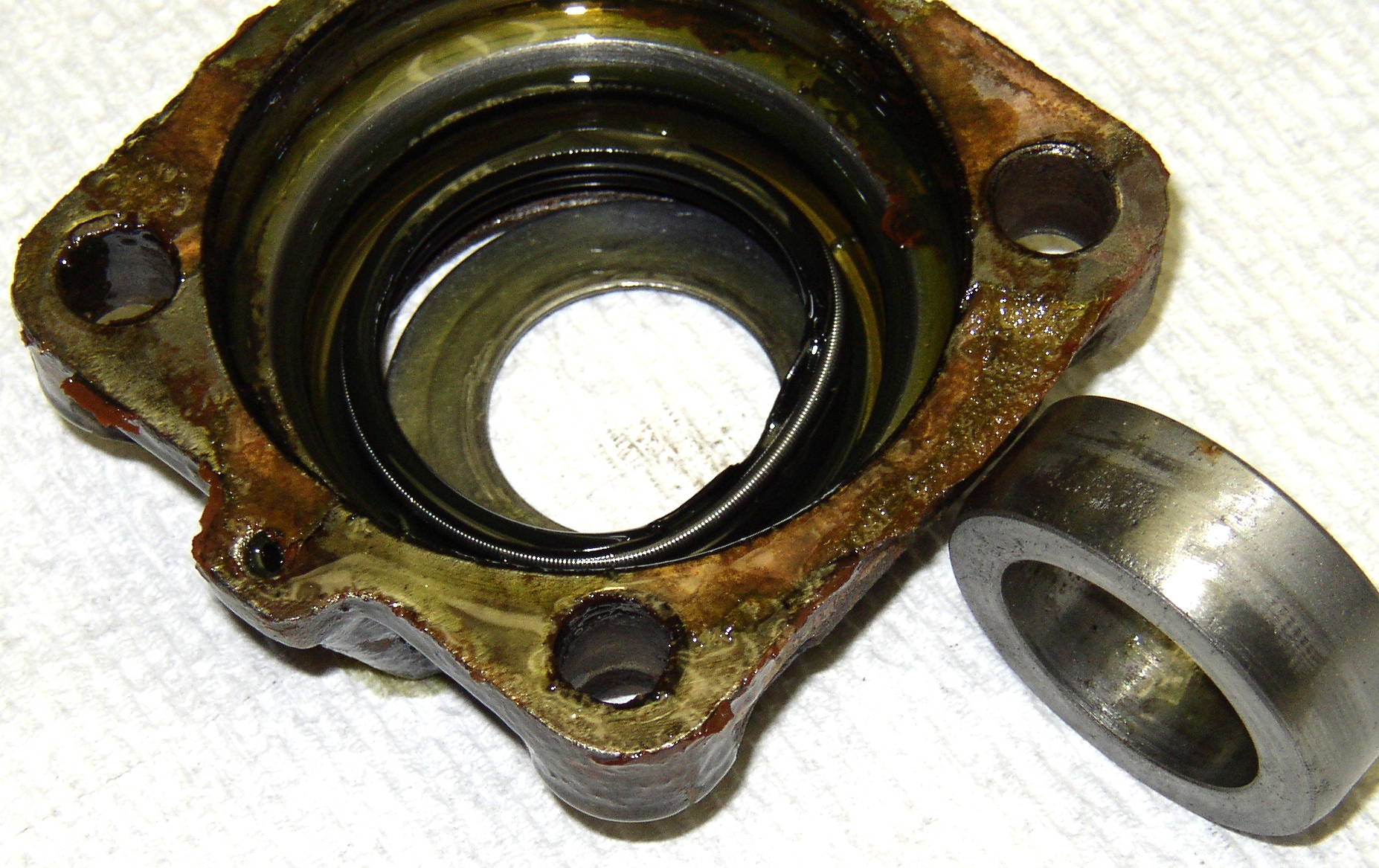

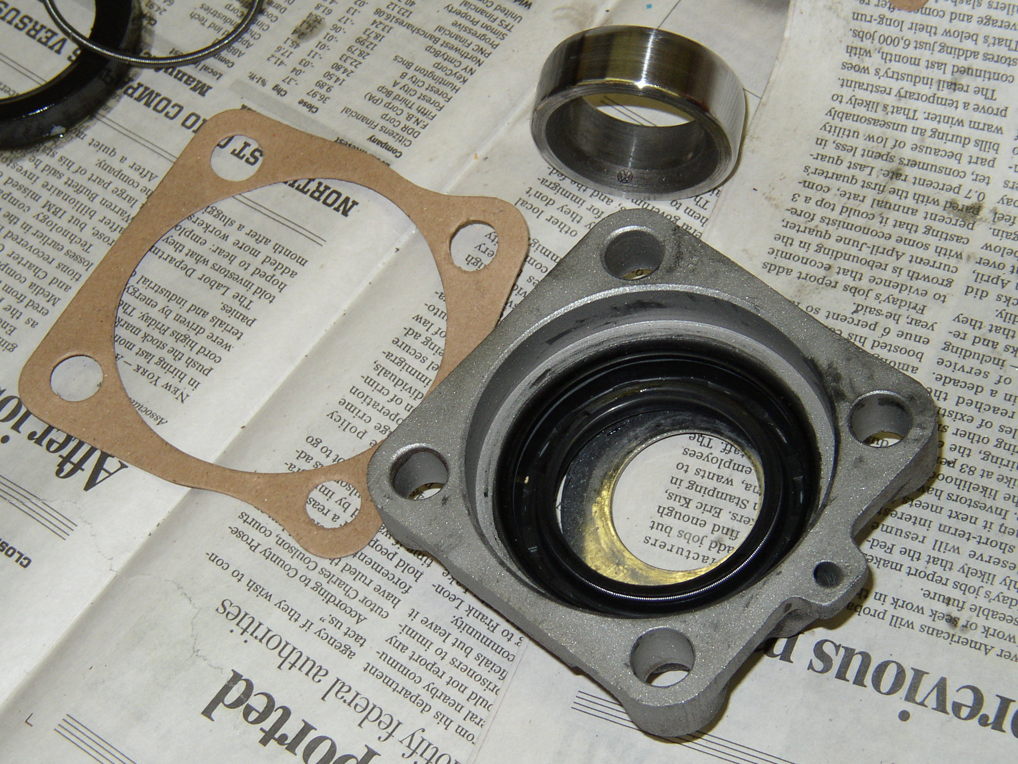

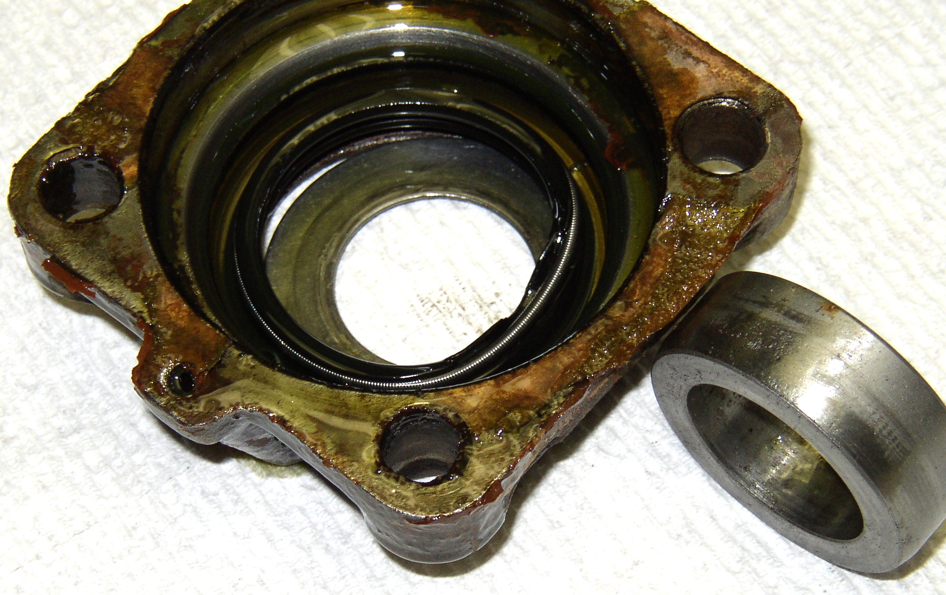

The RR axle seal was puking big time, big surprise to find the seal lip not only folded over but also cut.
We fix 'em up. I polished the seal spacer starting at 220 and up to 1000 grit. The black stuff is a smear of RTV on the seal.
