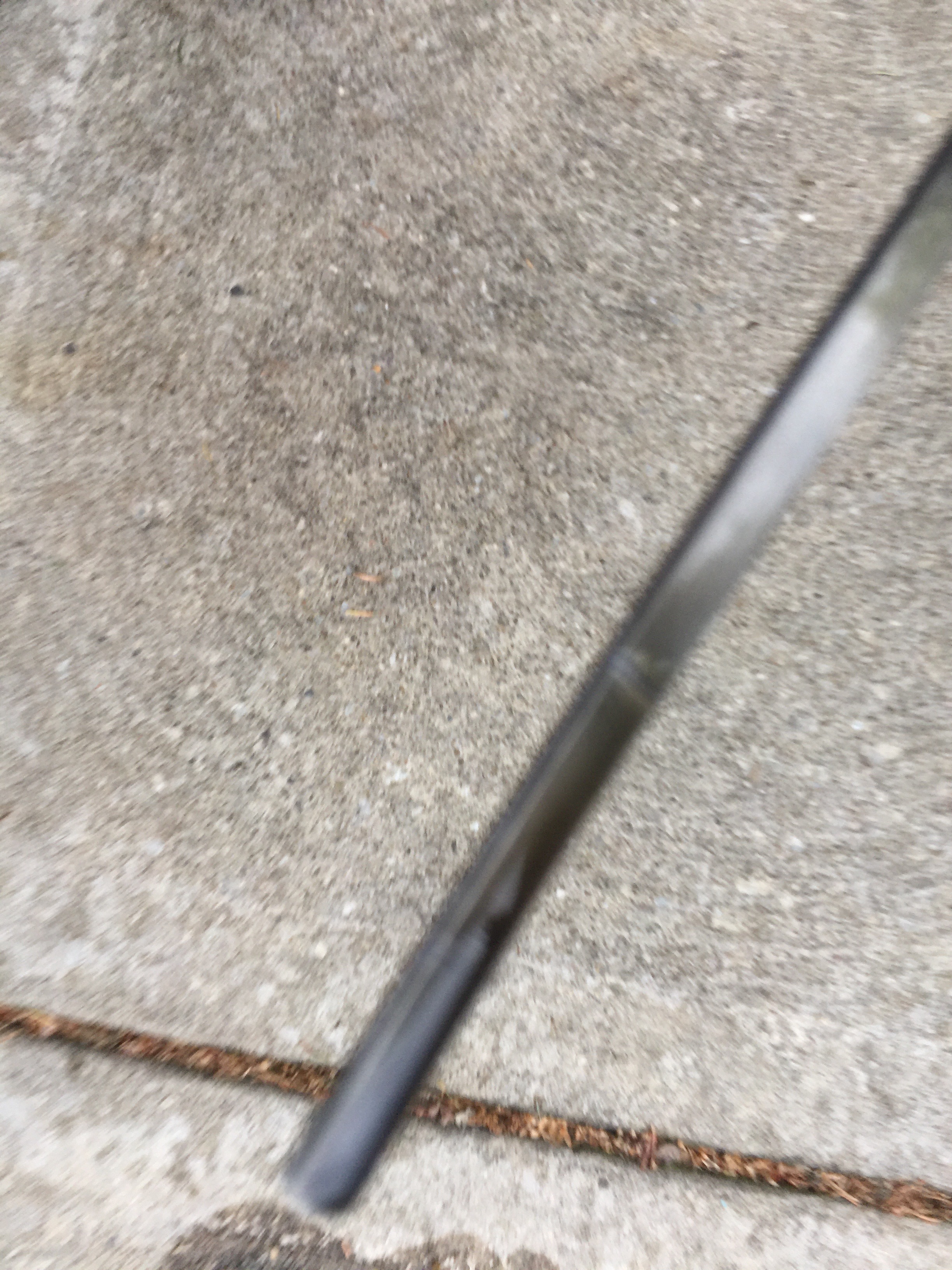

So I think I must be having oil pressure issues. :? I know it doesn't effect pressure, but I did check the oil before departure and it was dead on. I get to Basil's and it doesn't look like it has any oil??? :o Then I check again and I'm wondering if I have gas in the oil. :( It looks like there's more oil than there should be! My nose is horrible for smell, so I can't tell from the dipstick what I have going on. I start to think about too much fuel pressure and the pump forcing too much gas and some of it ending up in the crankcase. But I can't see any "shut down run off" that is common with that. (Ask me how I know!)

Here are some shots of the dipstick.

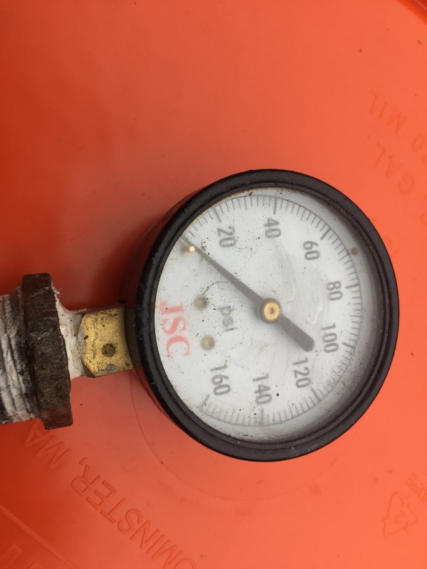

So, here are some of the gauges I'm going to play with. I don't have a vacuum port on my manifold so I guess I can forget vacuum.
I guess I can try the first one for oil. The second or third ones for fuel. I think the 4th one is for fuel injection. The fifth one is (I think) for water! :lol:
I'll report back on Sunday after I have my Green Eggs and Ham! :D

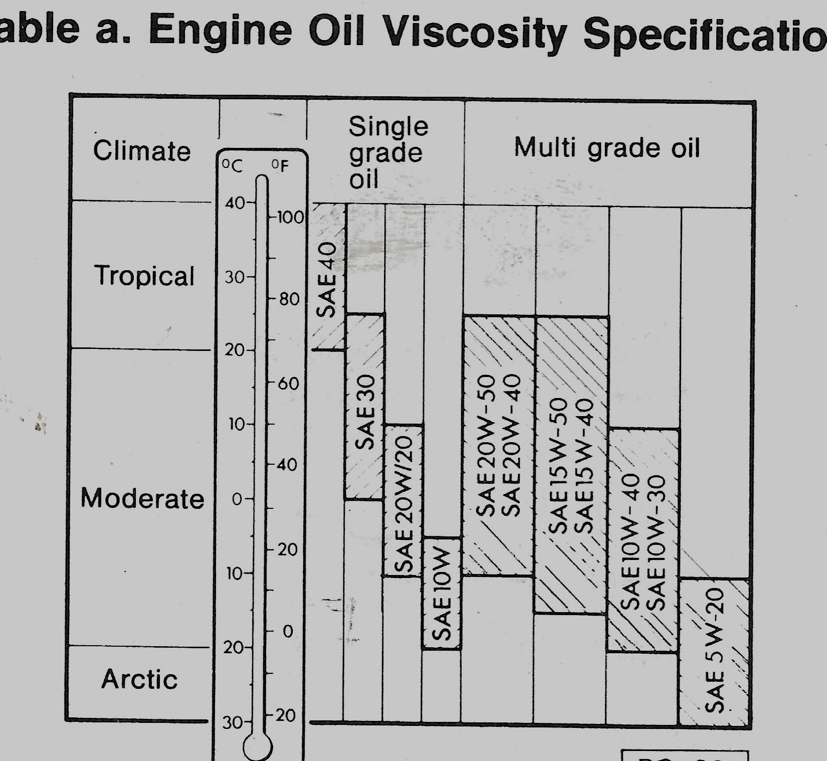

IMHO 30 wght oil is too thin. Check your Bently manual.
Re: Sean's '59 Panel

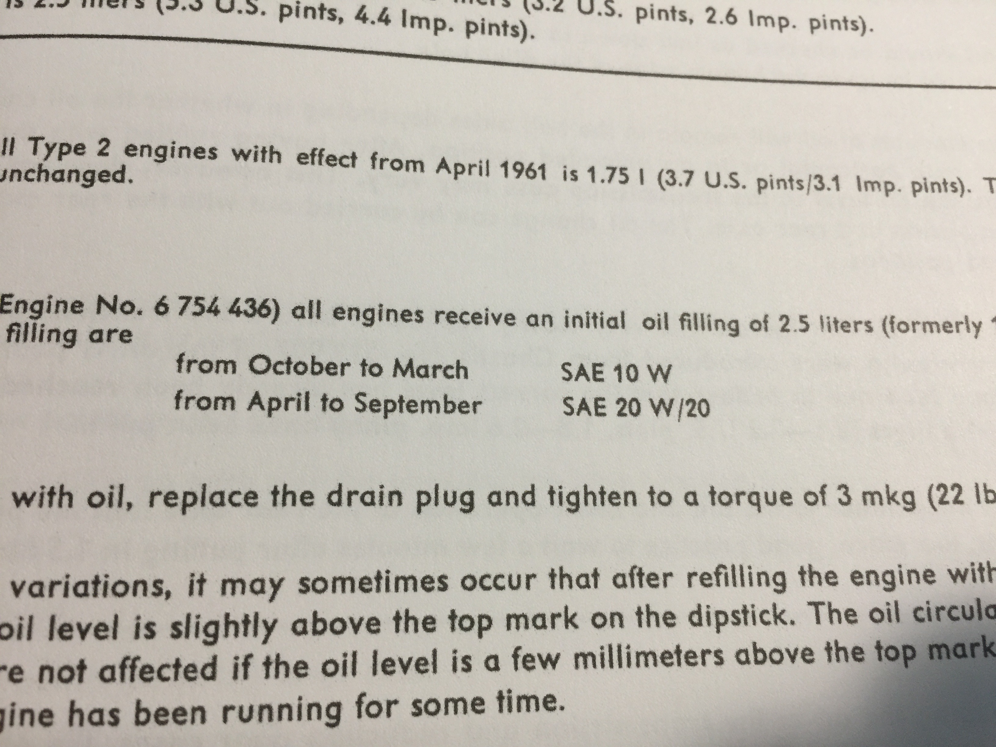

I thought 30 was consistently thicker than the ranges 10-30 or 10-40? Should I try to find straight 50W? Here's what I could find in Bentley. I've never heard of 20/20. :?
Posts: 3969
VW's recomendations changed in the 70's. I have always used 20/50 This is from 70's Bentley.
