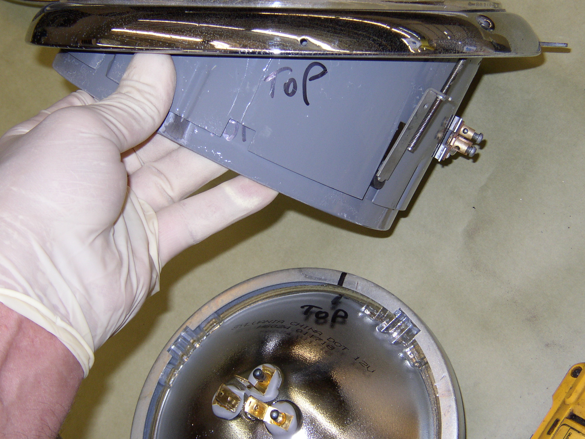

FNG assembling the headlight buckets. Pretty much all parts are dedicated left or right so make sure you keep them straight and mark them top and bottom to make it easier to assemble.

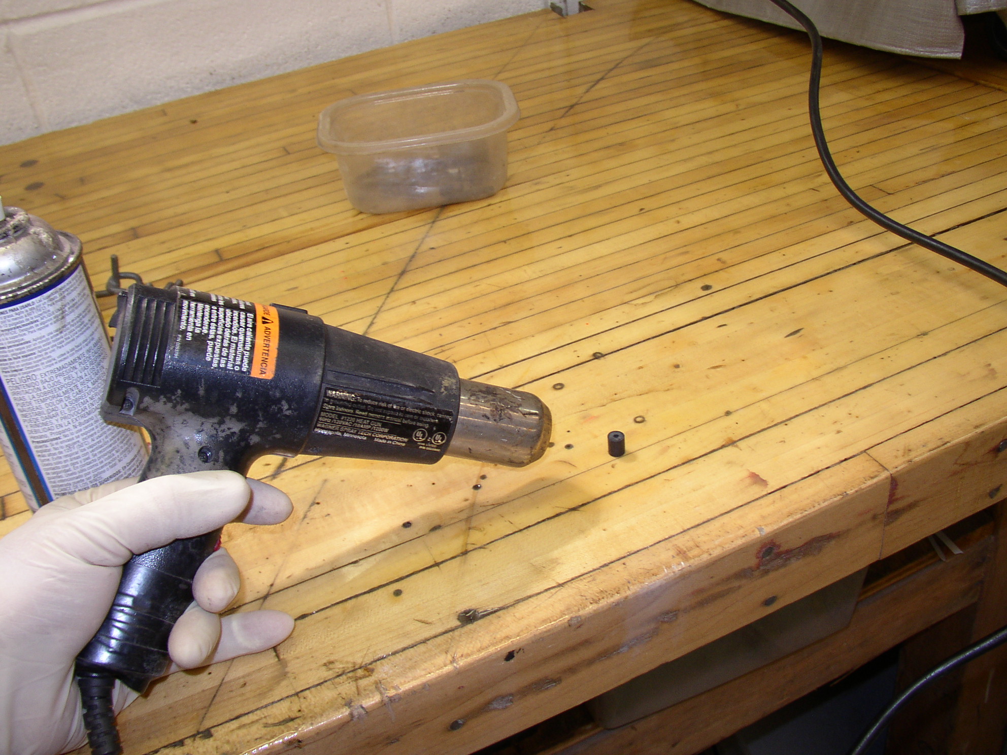

Heat any grommets to make them more pliable to install.

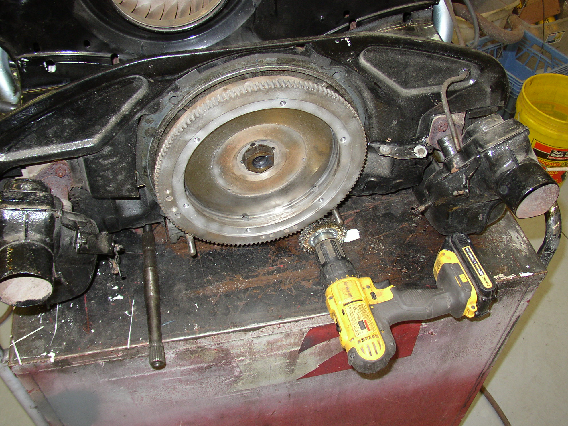

Here we're putting the bigger gen stand on, brand new 12v gen from Mick, replacing the flywheel, torqueing it. The flywheel was a used 12v so I blasted it and DA'd the friction surface with 120 grit. I checked end play before and after, it was the same.

I wire wheeled the lower engine studs so you can spin the nuts with your fingers when the motor goes in.

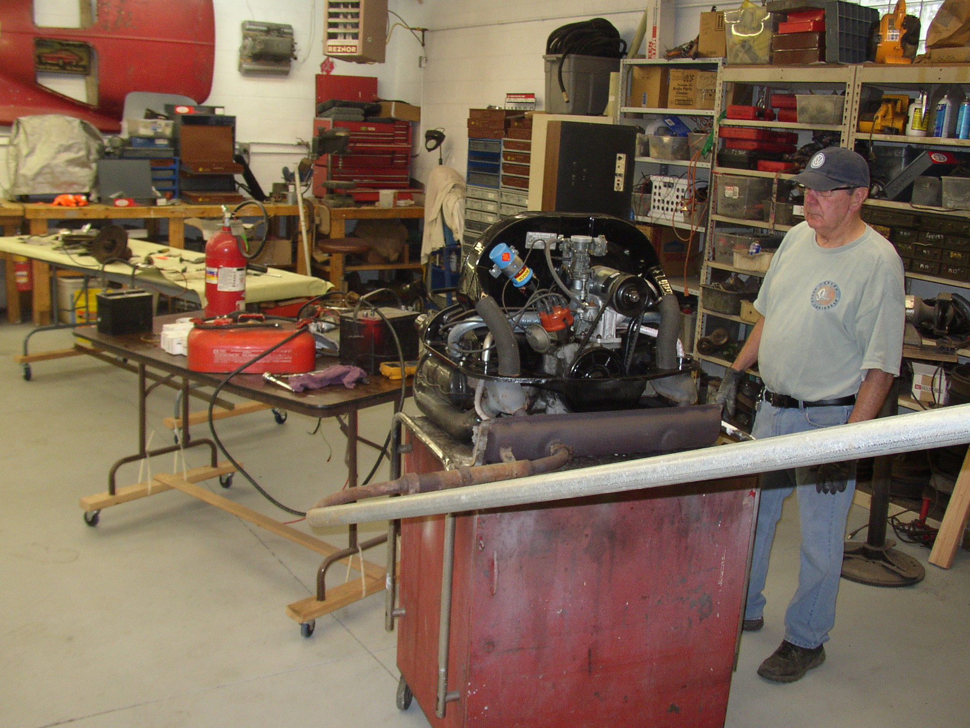

Test running the engine to make sure the gen charges, light works, fan doesn't rub, etc. Exhaust pipe goes to my exhaust fan in the wall.

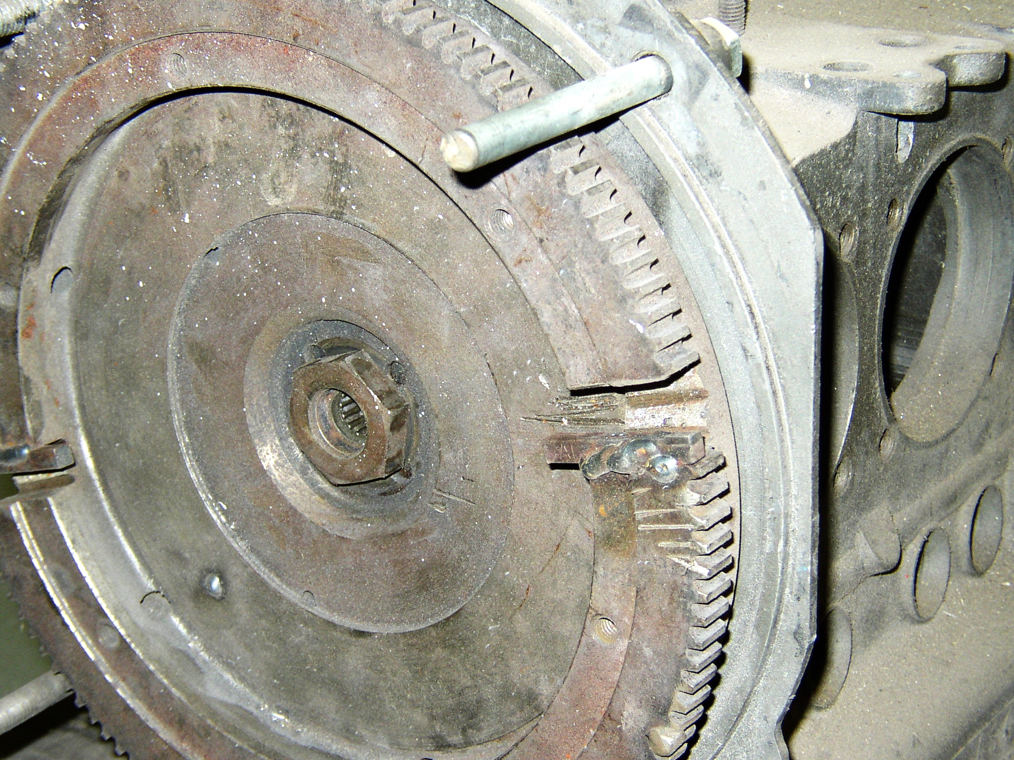

Upgrading to 12v either means you run 12v through a 6v starter or put a 12v flywheel on. Ken's 6v flywheel teeth were kind of beat up so that made the decision easier to go to a 12v flywheel which is larger by 1/8". You've seen me use this homemade "tool" before:
I welded a couple of tool bits from a brake lathe into an old flywheel.
Using a low speed 1/2" drill slowly insert it into the bellhousing. The drill does have a left side handle which doesn't show in the pictures. I told Ken his job was to watch and take me to the hospital if things went wrong. :shock:
The input is taped off to keep the chips off the seal, here it is after the cut.
Clean things up, knock in a 12v adapter bushing, a new TOB to replace the old growly one, clean the starter pad and bell flange to make good grounds, and bolt the starter in.
Hmmm, I can't remember if the trans is aluminum or magnesium, let's find out. Take a handful of shavings outside, and yes, it's magnesium. The propane tank is there for size comparison.
It worked great, when we installed the engine it turned freely without rubbing the bellhousing. :mrgreen:

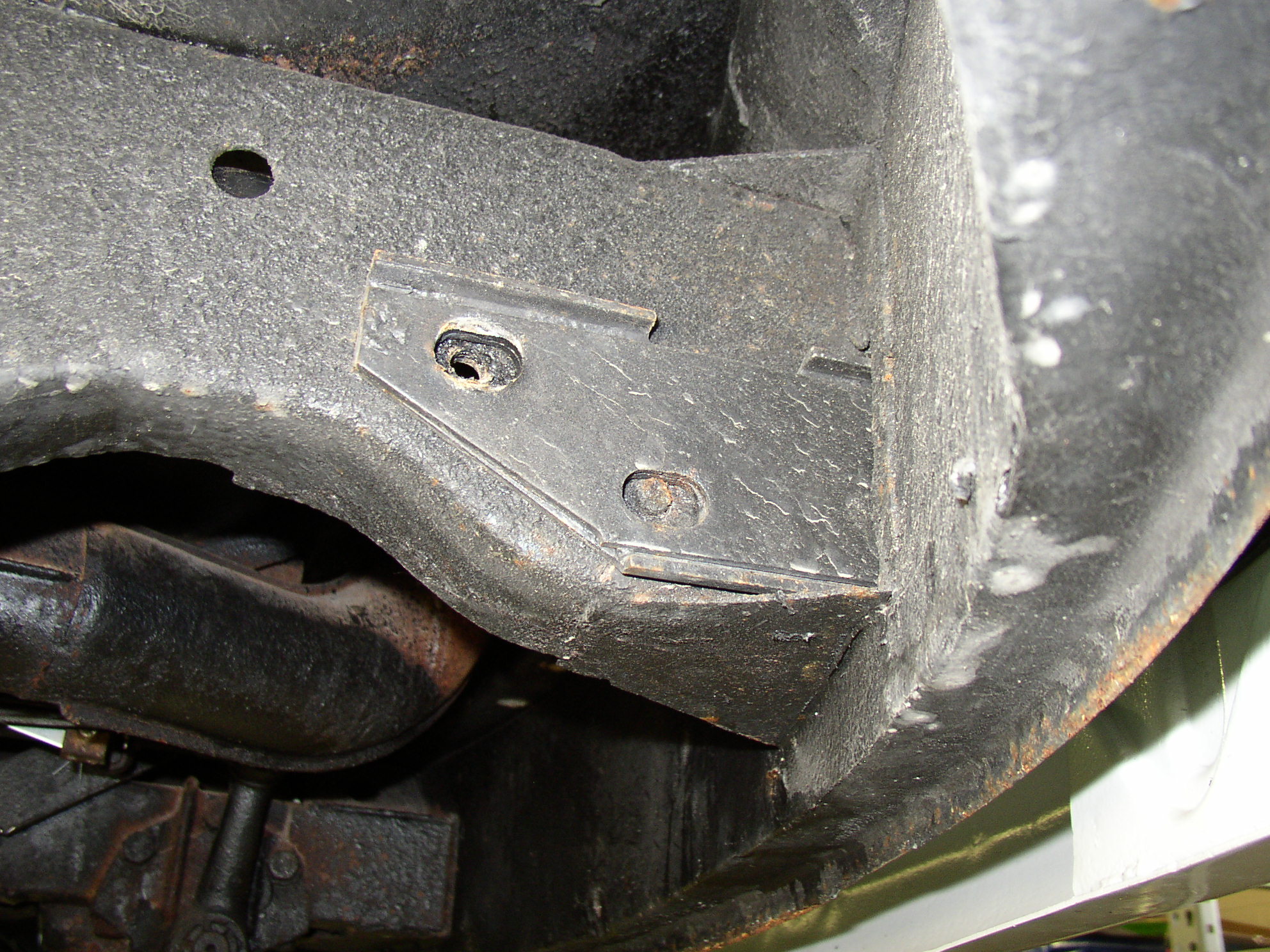

The front bumper was loose and probably rattling, let's take a look. Someone put 8mm bolts through the 10mm weld nuts on both sides and ignored the broken 10mm bolt on the right front. Brother, maybe there's enough stub to grab if I glow it.
I did get it out and chased the threads, cleaned all of the f'ing undercoating from the rail and installed the correct 10mm bolts. I hate undercoating, it does nothing on a classic car but hide bad bodywork, rust and other issues. It's a huge turnoff for me to see undercoating on the bottom of a car.

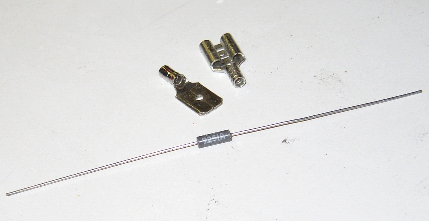

You've seen this before, the 162 ohm resistor in series with the fuel gauge power supply to cut the 12v down to 6 for the gauge.
Fold into a Z and more tubing, without it the resistor would likely break.
Installed in series with the power wire to the gauge.
Without it the gauge reads 1/2, with it it reads 1/3, just what I guessed when I read the sender with an ohmmeter.
