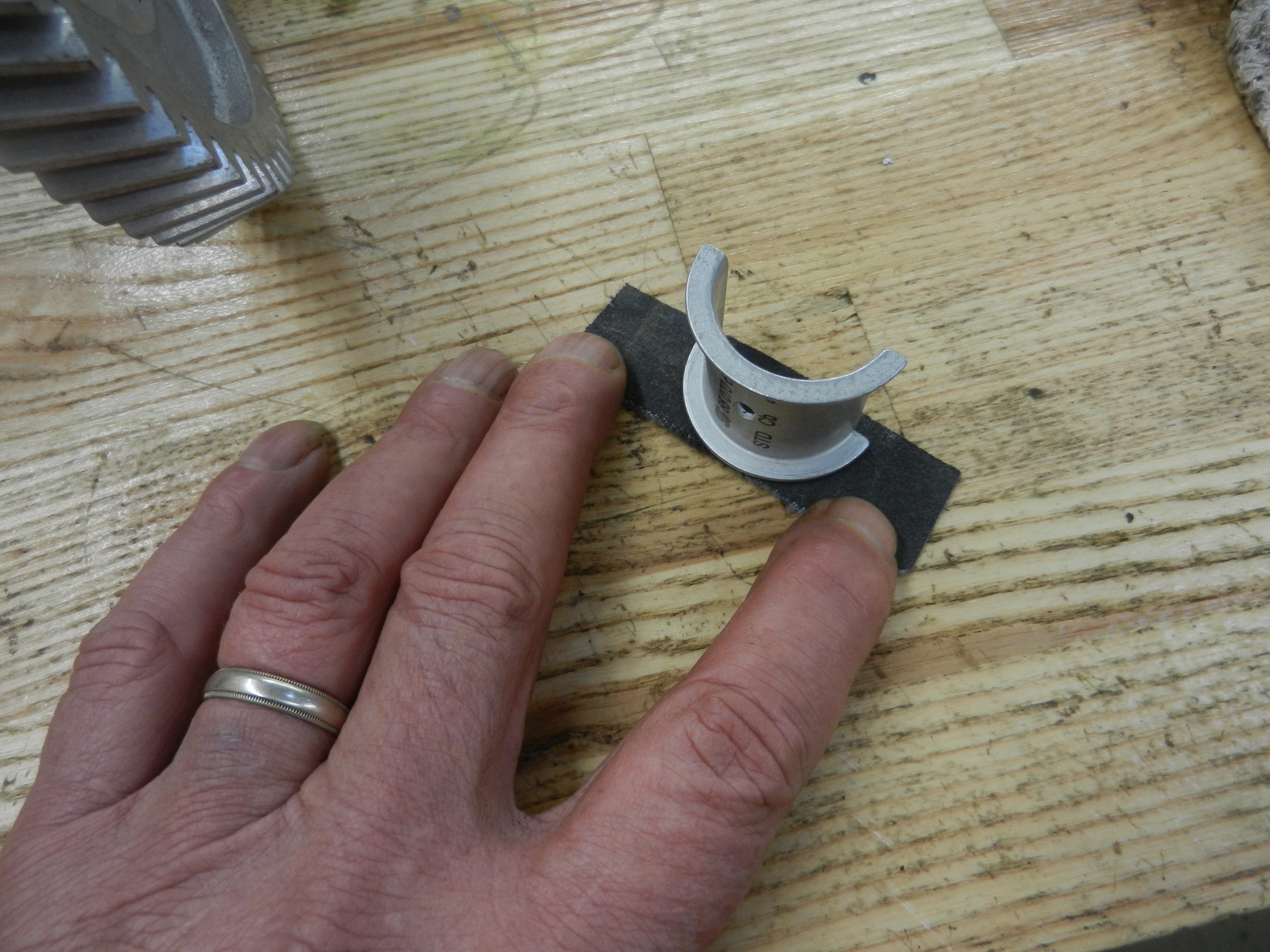

Now we are going to hang the rods for some measurements. First, wipe the bearings,rod big end and rod journal clean.
although the bearings come sealed in plastic, doesn't mean they are clean.

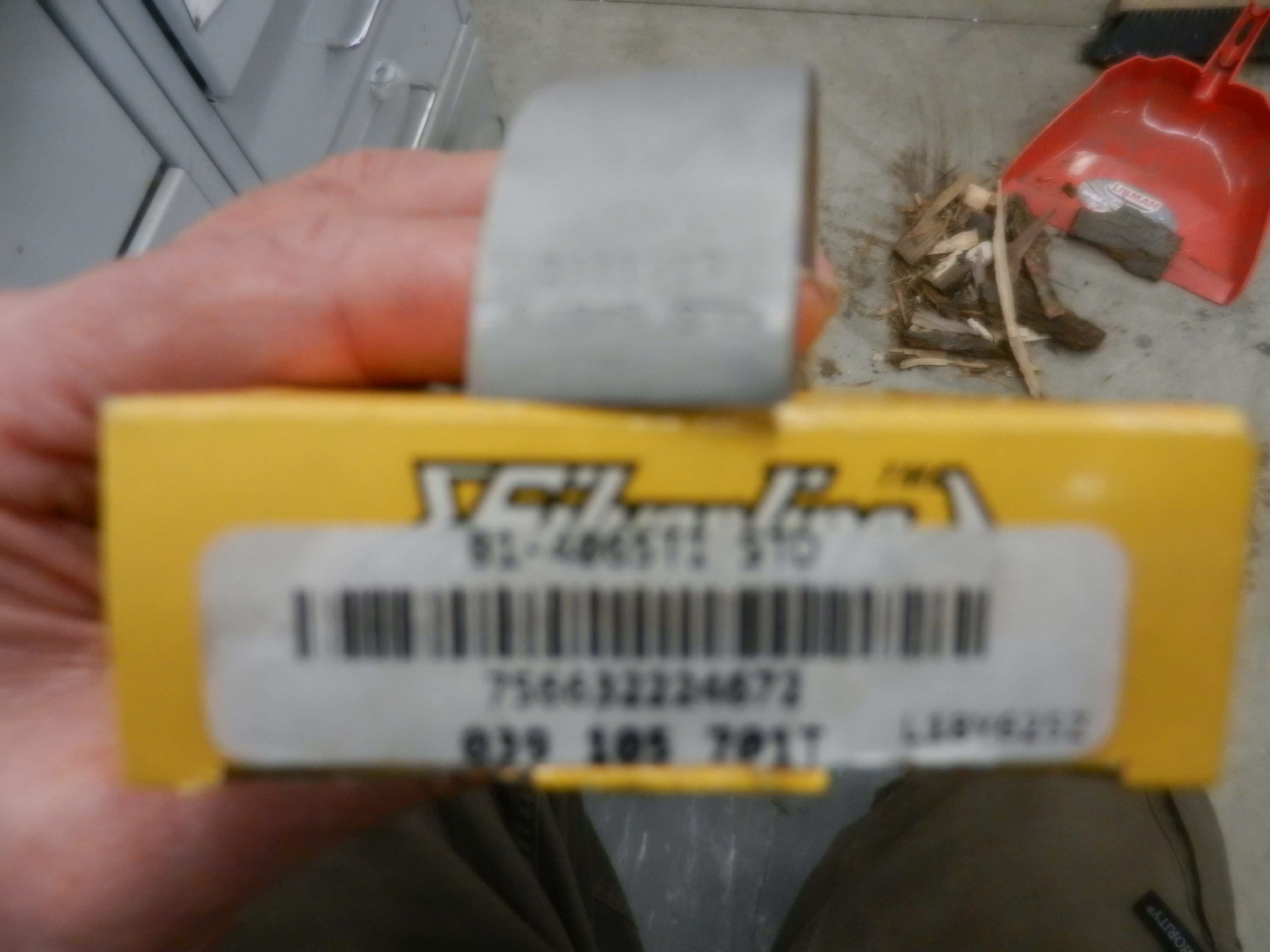

I had also purchased a new set of Silverline rod bearings. I made an assumption :oops: That there was no need to plastigage these NEW rods and bearings. So I proceeded to assemble.
We have a problem :cry:
After torquing, the rod was bound on the crank journal. SHIT
Remove the rod AGAIN. No pics here, but I mic'd the inside of the stock rod and then the AA rod. Identical :?:
So, let's check the bearing. The box and bearing were marked STD.
Well, .059
Let's compare it to the Kolbenschmidt that we used with the stock rods,which gave us .002
Guess we found the problem. Like Art used to say" just because it's NEW, doesn't mean it's good.

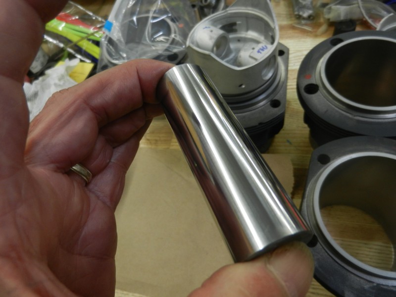

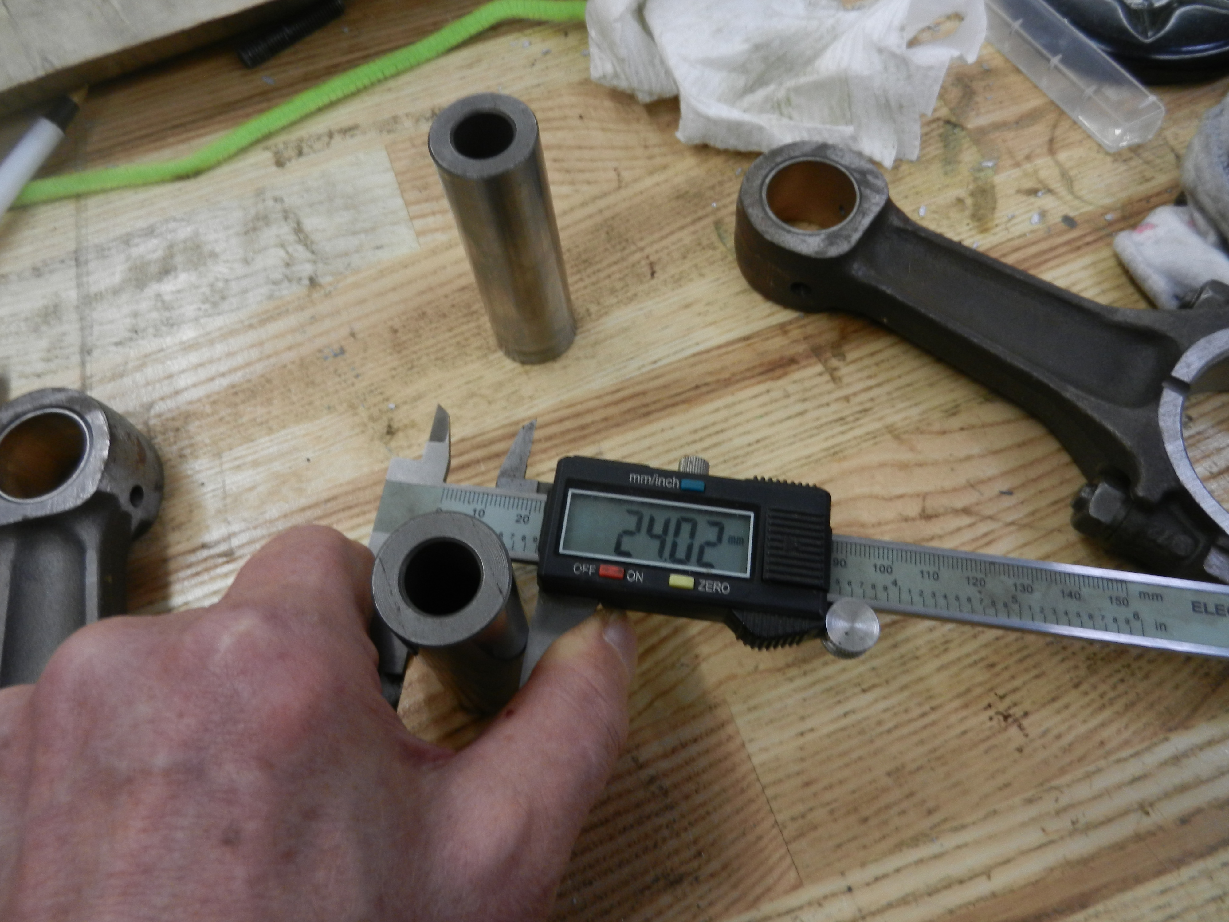

First, I double check the piston pin fit. It slides in nice and tight. These photos show measurements on stock rods. AA rods were the same. Polish the pin.
Normally you would use micrometer for these measurements but digital caliper works for visual.
Spec for the pin is 23.996 to 24.00 mm (.9445-.9448 in)
Bushing is 24.015-24.024mm (.9454-.9457in) for a clearance of .0009in
I think we're good.

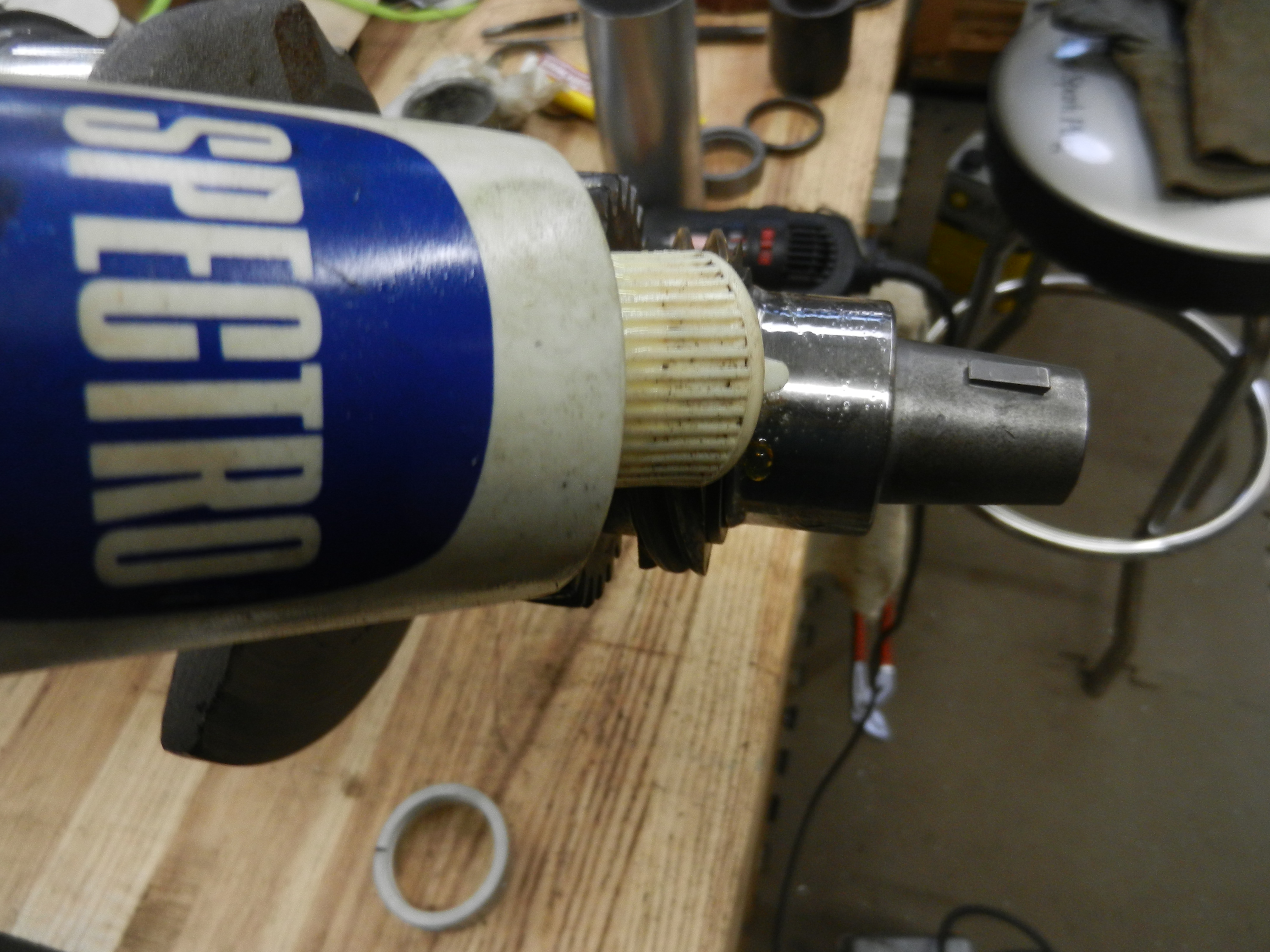

Now to hang them. as before, wipe them down good including the bearings,rod and rod journal on the crank.
Then lube them up. I have used Spectro assembly lube for years.
Squirt some oil into the rod journal and wipe a little white grease on the sides of the rod journal.This helps cushion the side of the rod and get a little oil to the bearing until we get oil pressure when we first crank the motor

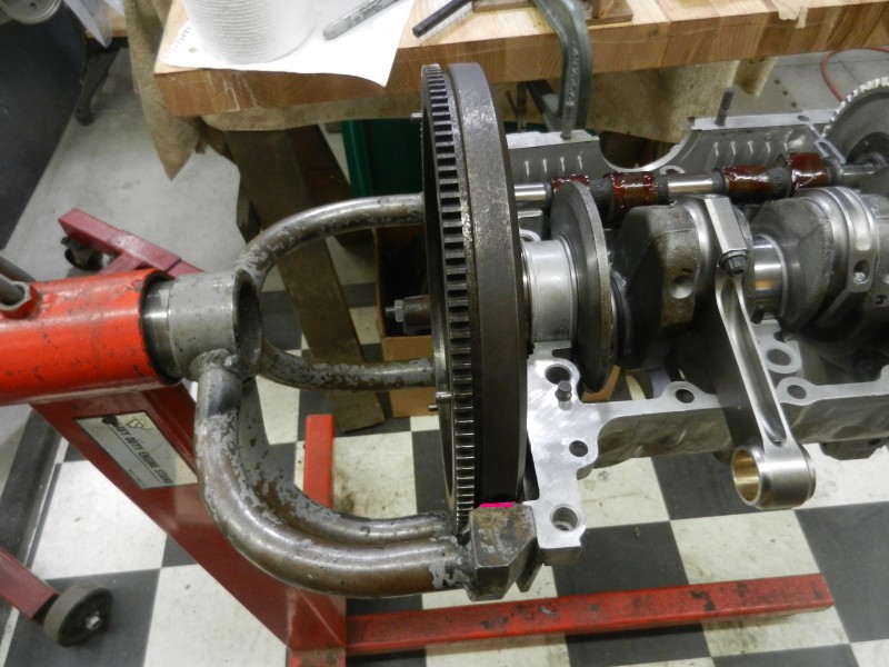

Re: Bill's T4 engine build

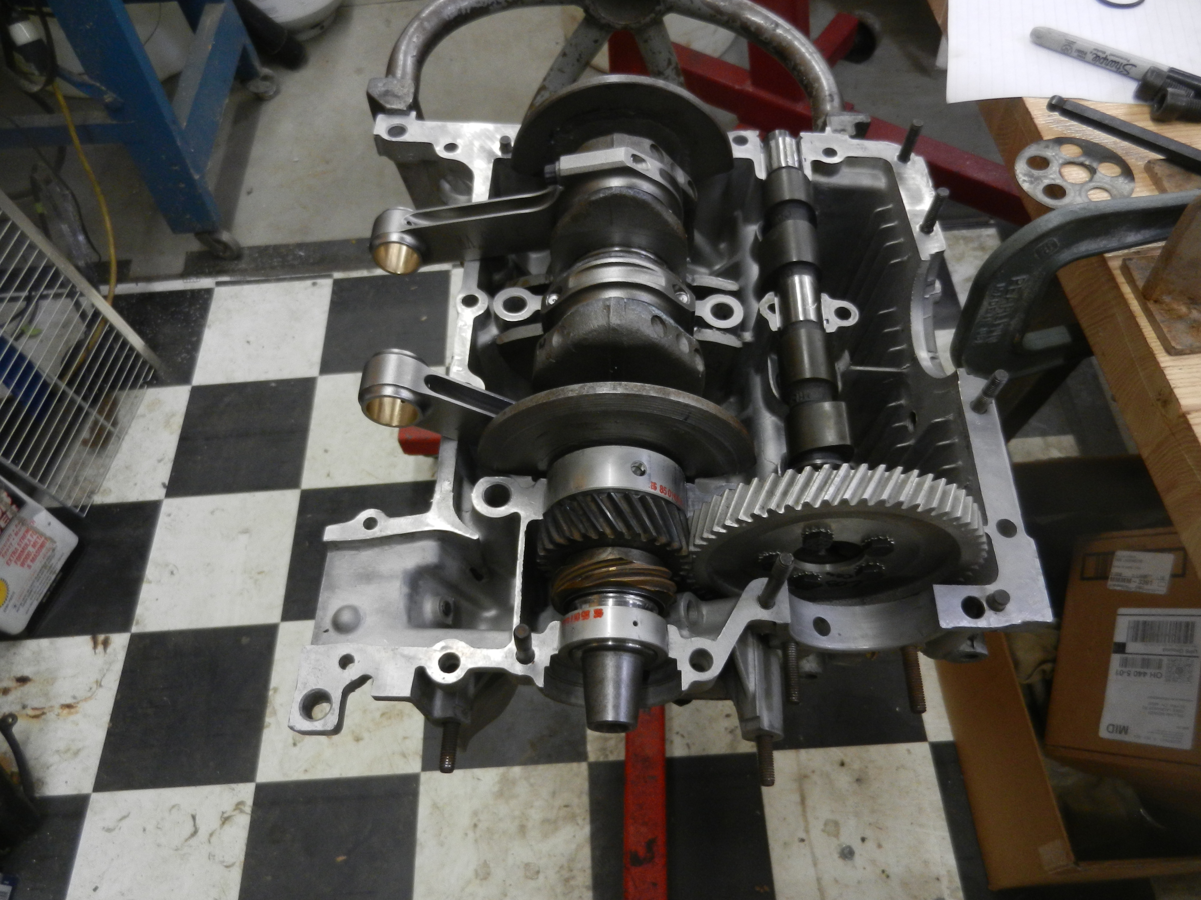

Now, we are going to set the crank assembly in the left case half.
First, install the #2 bearing halves in both case halves. wipe the bearing saddle and the bearing clean.Again. Being sure to align the dowel hole in the bearing with the dowels in the bearing saddle.
A little assembly lube on #4 and #1 crank journals, we did #3 when we installed the gears.
This is where the marks we put on #1 and #4 bearings come in.
install #1 and #4 bearings, again be certain that the dowel holes in the bearing are offset towards the flywheel end of the crank. Holding the crank assembly by the #1 and #2 rods, and trying to keep the crank parallel withe the case, slowly set the assembly in the case bearing saddles. This is where a second set of hands would be really helpful, as we are trying to get the 3 bearings aligned with the dowel holes and dowels, and every thing is moving. A 3rd person would help to take photos :lol:
OK, I missed taking a pic of just the crank assembly seated in the case. Here, the camshaft is also installed.
At this point, with or without the cam installed, we want to rotate the assemby to be sure everything rotates smoothly with no hang ups. rotating the crankshaft backwards,with the camshaft installed will also check backlash of the cam gear. Watch to see if the cam lifts out of the cam bearings or moves back and forth. If not, your good. If it does,you are going to need another cam gear. we were good here.

In the last post, we installed the crankshaft assembly and checked backlash of the cam gear. A note here. this from the Bentley manual." Camshaft gears are marked -1,0,+1or plus 2 etc.on their inner face. these numbers indicate in 1/100mm how much their pitch radius departs from the standard pitch radius denoted by 0. VW specifies 0.000-0.002 in or 0.000-0.050mm.
If you are using a reground camshaft, or re using a used camshaft,neither of which are recommended,this could be an issue. ALL replacement cam gears are bolted on as opposed to the stock riveted on gear. They are usually all marked -3 so it is rare that there is an issue with backlash.
