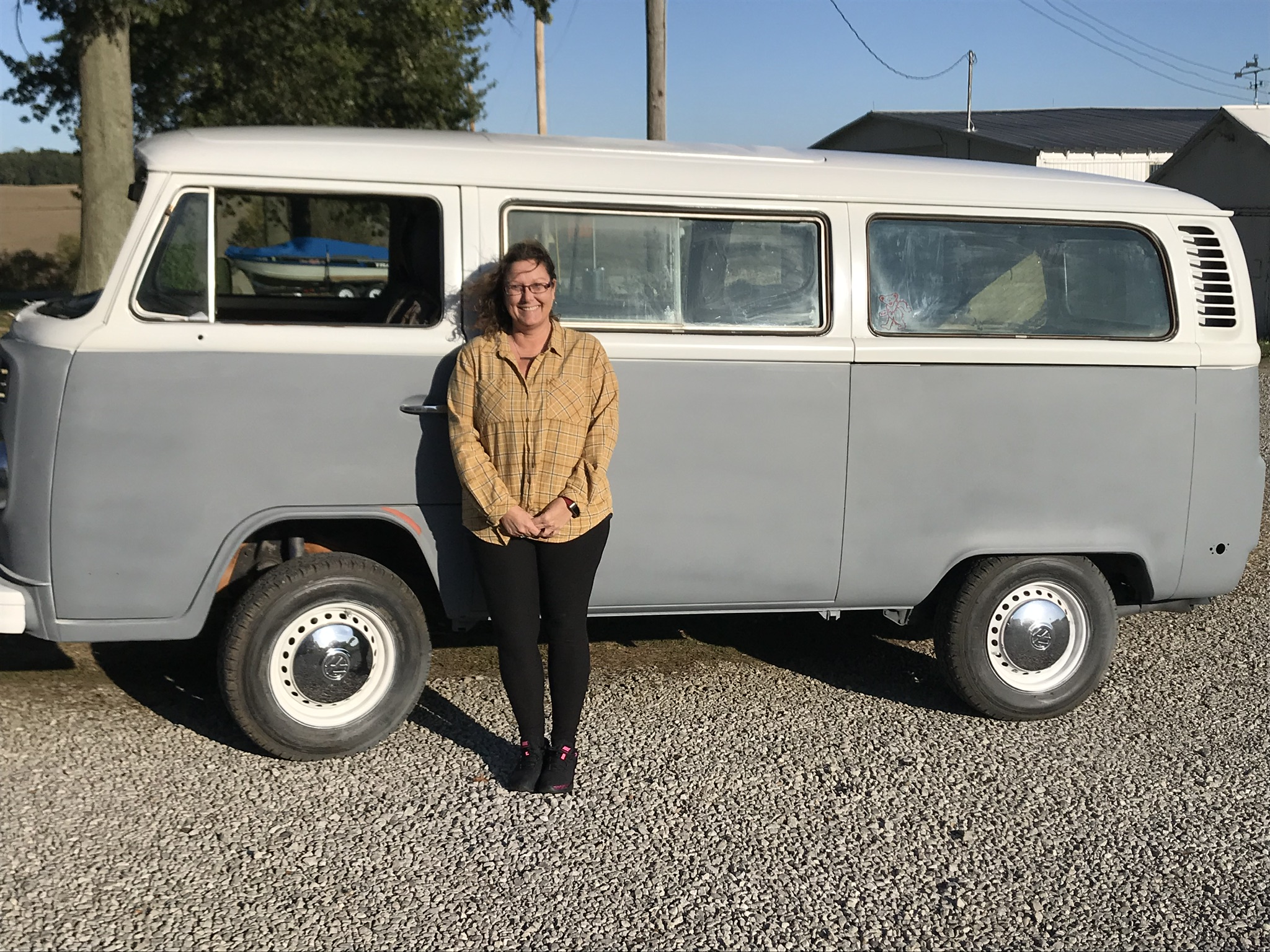

I got a 78 VW motor has been rebuilt but it bogs down between 2 and 3 gear. It is fuel injected. Any ideas??

Beautiful bus Lysa. You probably need to start with a good tune up. Quite possibly ignition timing issue. Not advancing properly.

What's the story behind its history and paint? How long have you owned it?

I got her last fall and my dad rebuild the engine and did the body work.. the inside is still really rough.
