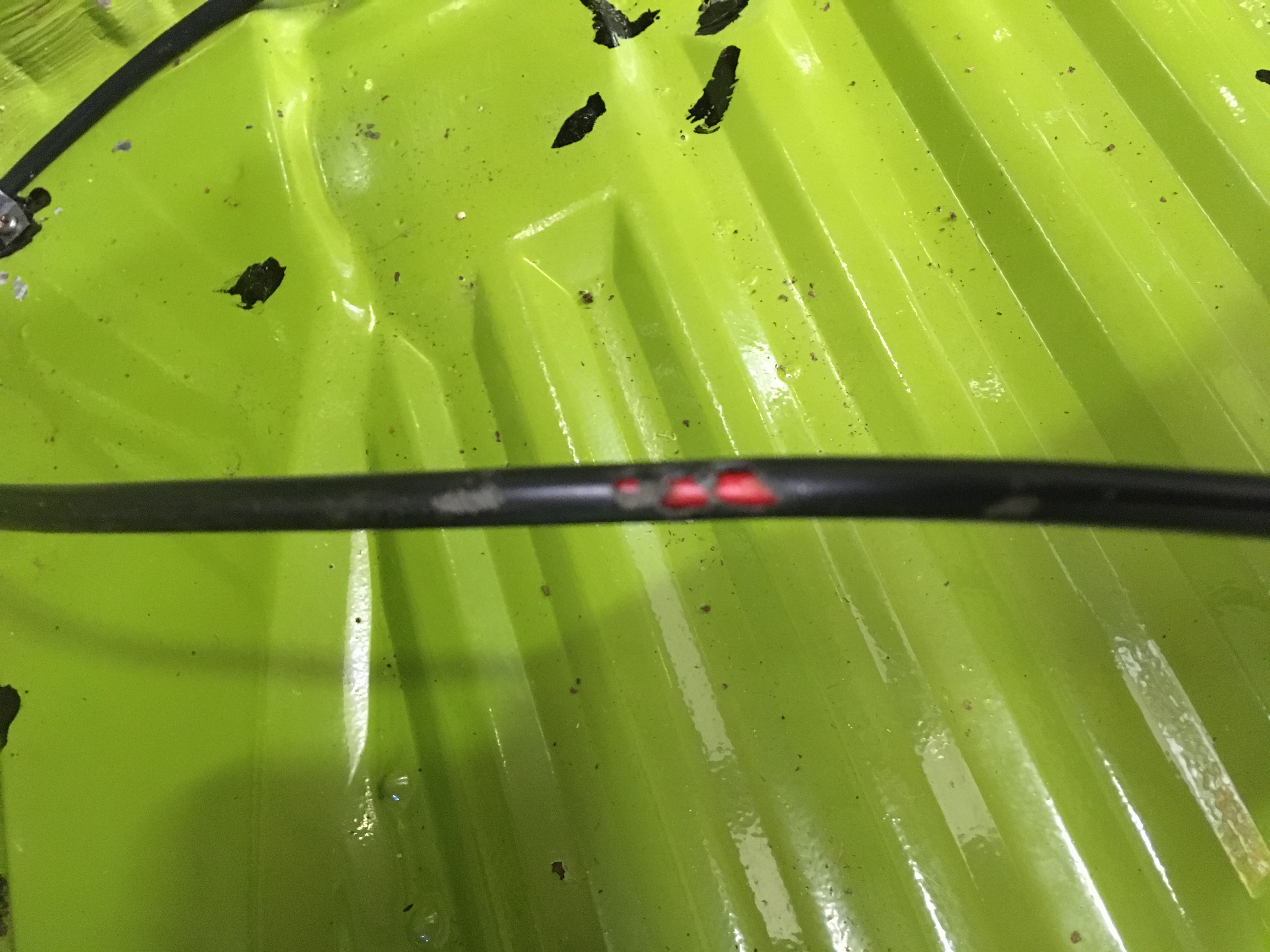

Also found what looked like something had nibbled on the protective sheath of the sink pump switch wire that runs behind then sink base. The wire itself looked okay so I just added some shrink tubing on top of the sheathing. There were a couple spots like this.

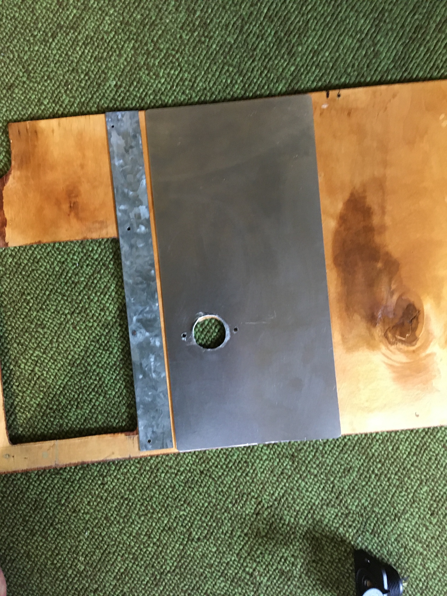

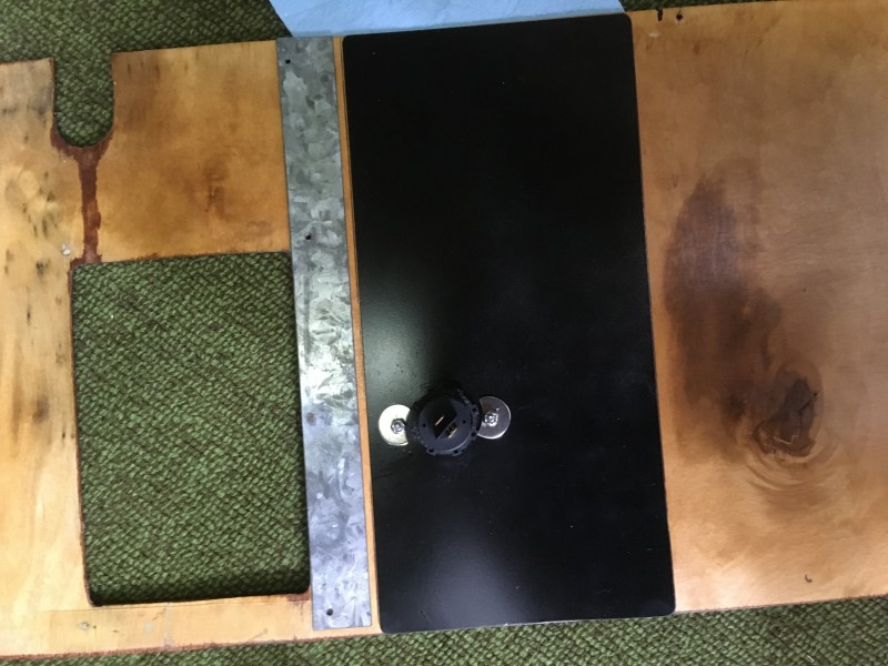

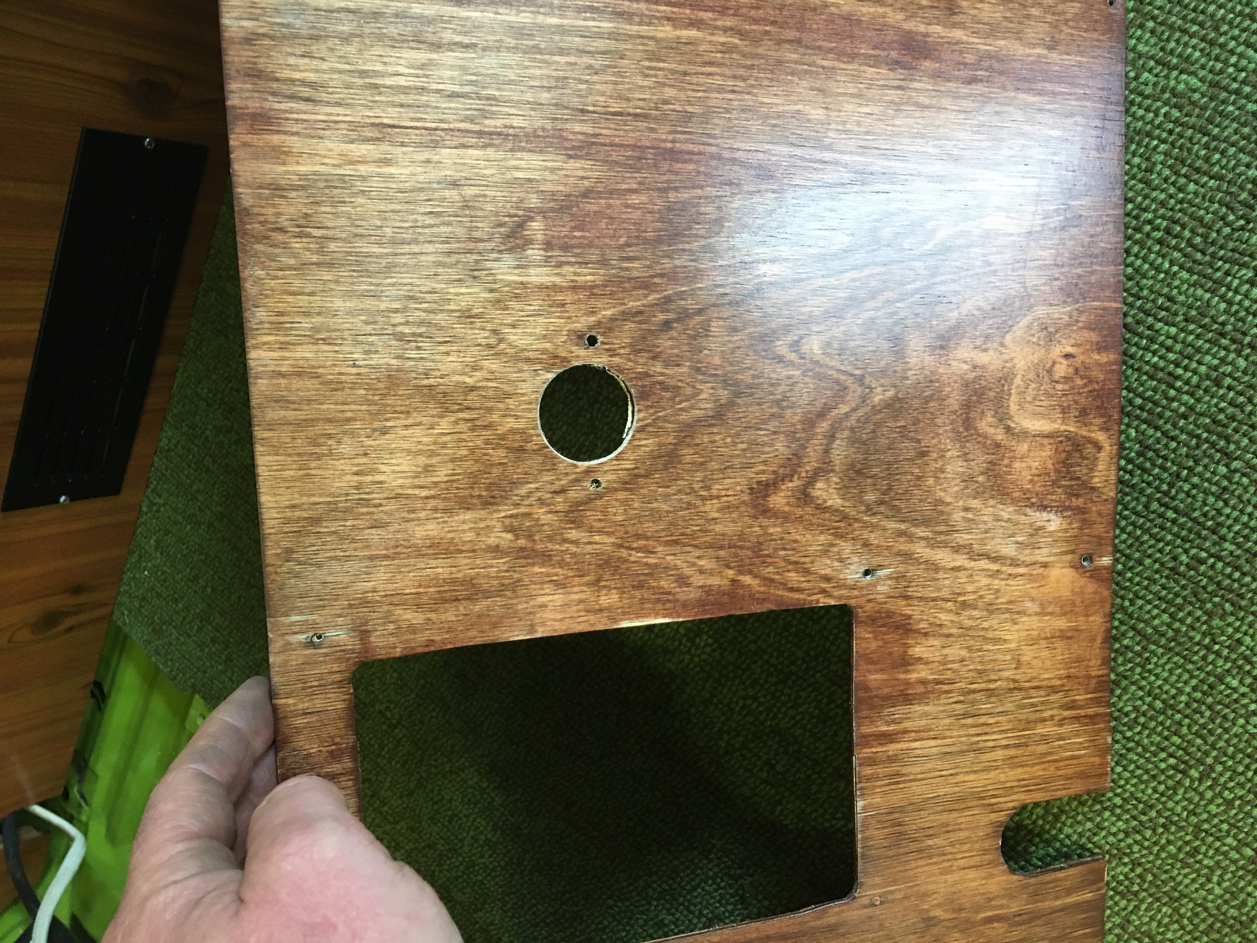

Using the face plate of the 12v receptacle as a template I drilled the holes through the wooden panel. Knowing that this would be pushed on, I decided to reinforce the back with a metal plate. The factory had done this for the power panel( galvanized strip in photo, so if it was a good idea for them.... I used a sheet of 22 gauge steel marked the holes and then drilled and dremmeled them into shape. I painted it black, glued it to the back of the wood panel with contact cement and then mounted it with stainless screws, fender washers cut to size and lock nuts. Like the factory strip it contacts at the top and bottom the two ribs running along the wall of the bus.

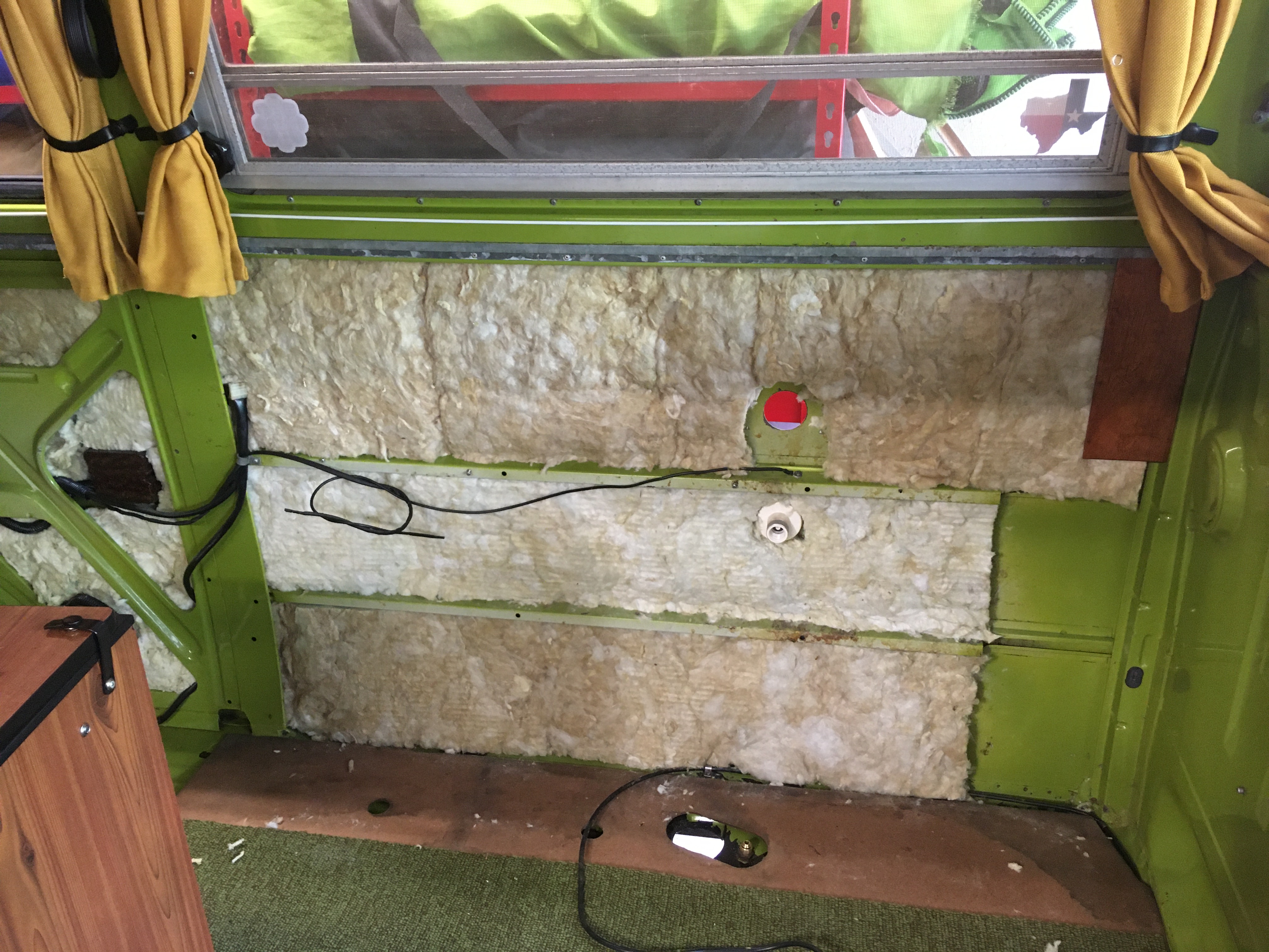

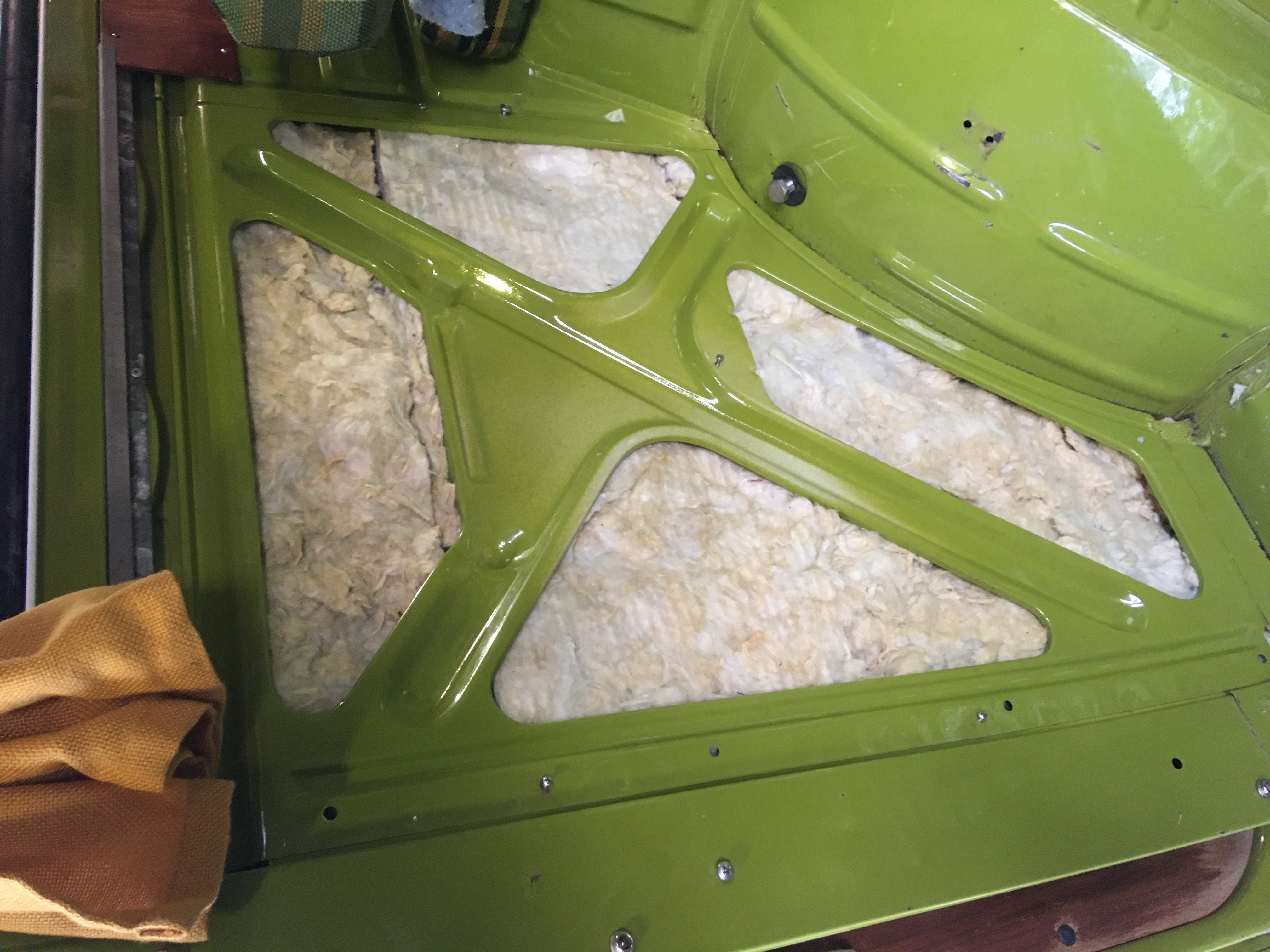

Thanks for the suggestions on insulation. Someone had mentioned mineral wool and that is what I went with. It was very similar to the original and easy to work with.
I used the old pieces as templates. It cut very easily with a utility blade. The original was about 2 inches thick and this was 3, but it was very easy to peel an inch off. When I was done I had my son, gotta love bored teenagers, haul the left overs to the attic above my garage :lol:

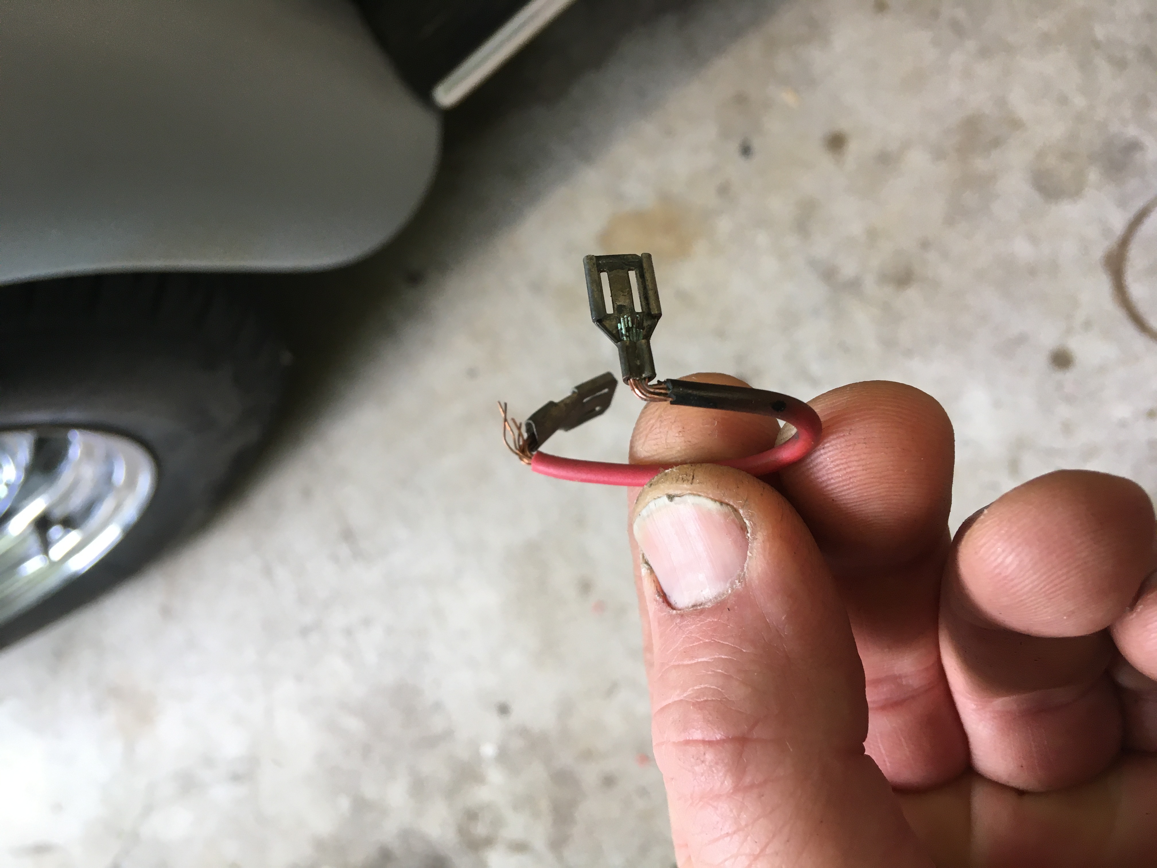

On the back of the power panel a couple of connectors were loose and one wire looked a little crusty/ burnt so I repaired it while I had it out. Also cleaned the contacts with a dremmel and a wire wheel.

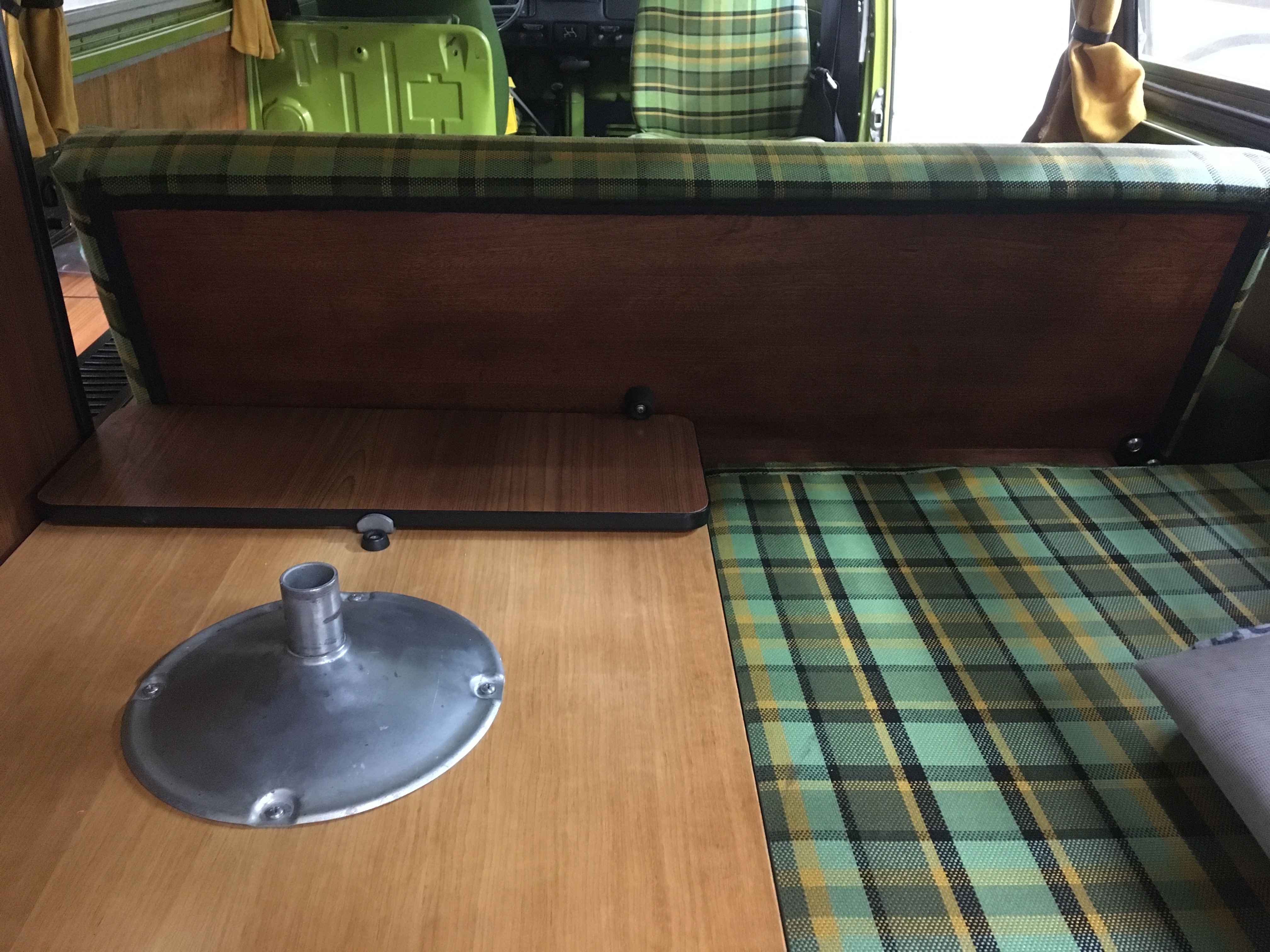

Finally got the back seat/bed in. Looks good I think. I had read on the Samba someone referencing Bill Webner advising them to use hockey grip tape for the black tape on the back of the seat. Perfect timing with sporting goods stores opened back up this weekend. Not sure if he really advised that but I tried it and it came out pretty good.
Also restained/refinished the back of the seat and repaired the seat prop while I had it out ( I did not even know it was a thing until I saw someone use it Kelleys. I had found the prop under the back seat when I bought bus, along with a lot of other stuff. Thankfully I kept it! At any rate it is handy. Used a slightly larger carriage bolt than what was originally there so it was a little stronger. Now just have the main cabinet to go....for this round of repairs.
