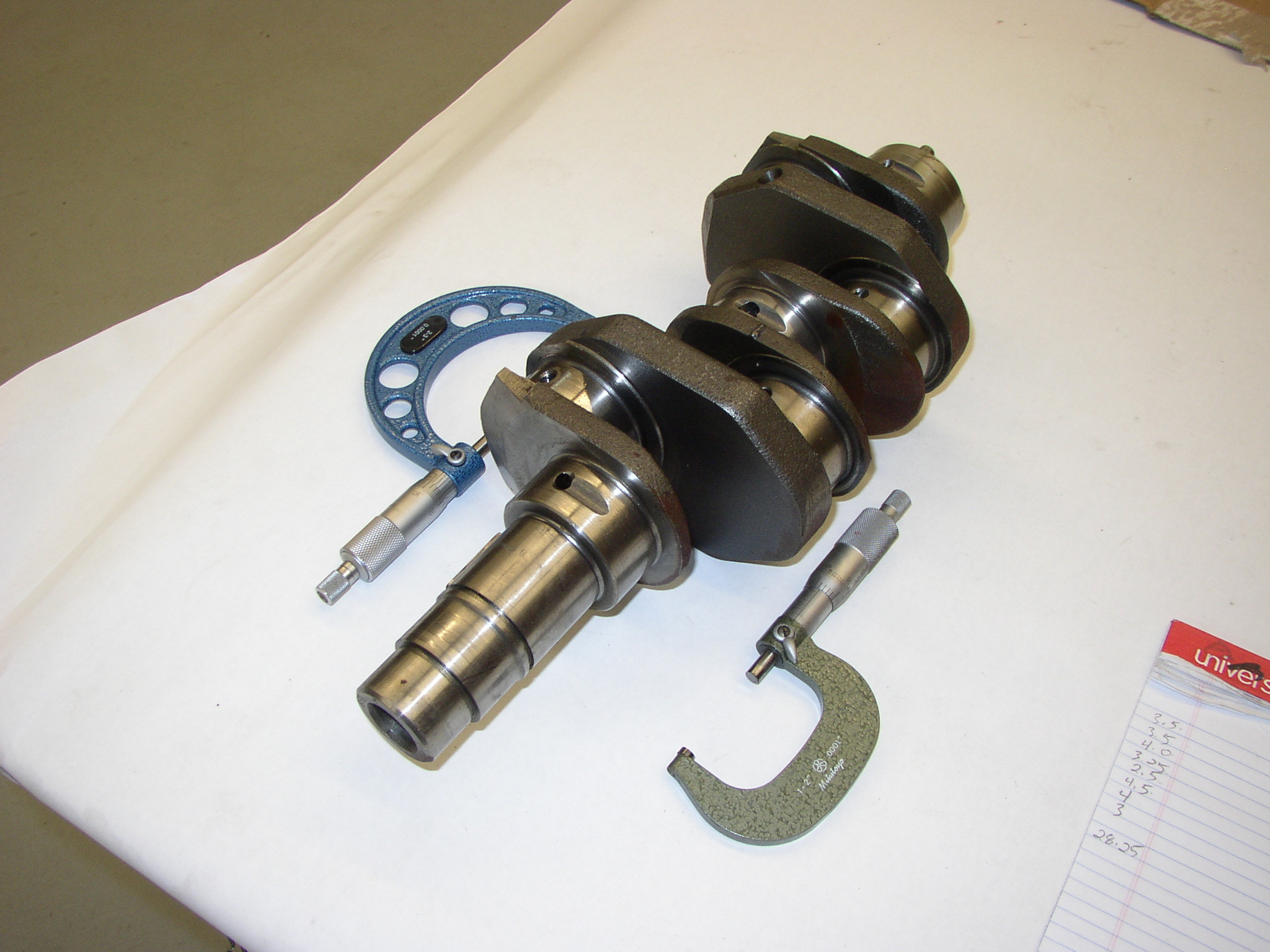

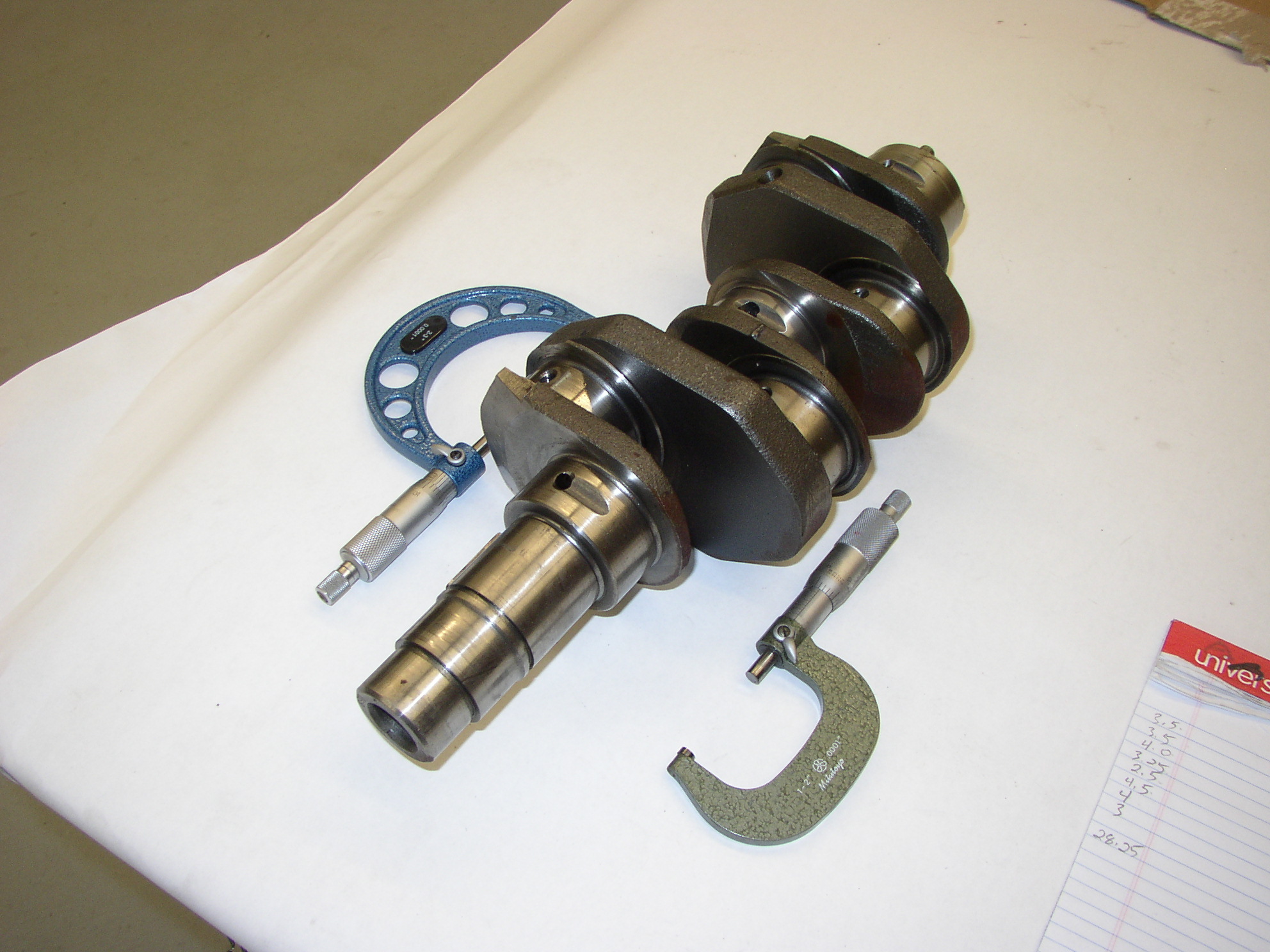

Sean provided low mileage crank/rods/pistons/jugs/heads so I'll check each of those closely before it goes together. The crank mikes out really well, #4 journal is .0005" undersize but that's not going to concern me. No out of round, also. I don't have a lathe so I used a drill to spin the crank :shock: and polish it with 1000 grit, it looks really nice. I cleaned it thoroughly with solvent and a galley brush.
The new case mikes out dead on both in size and out of round on all bores.

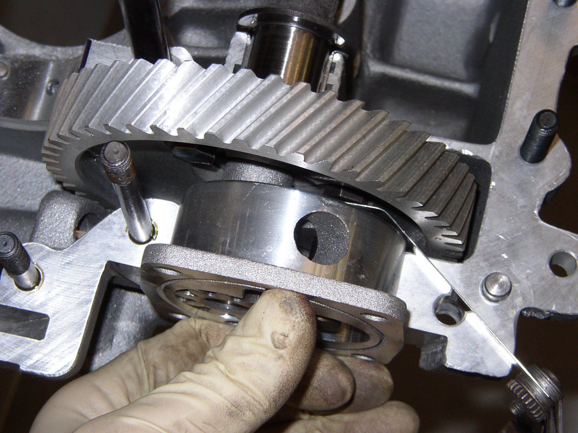

Everything went pretty smoothly for the first mockup, the crank set in, cam gear backlash was spot on, and I checked clearance to the CB Maxi Pump because usually there's a clearance problem there. In previous engines the cam bolts hit the pump body, on this one they did not but clearance was under .010". I ground the heads of the bolts slightly for clearance and torqued them with red Loctite.
This is just mockup, not final assembly, I bolt the cam and crank in to make sure everything spins freely. I only use motor oil for lube on the bearings as that's how I was taught as a kid and that's what many mfrs state. Thicker lube can actually work against you on assembly, plus if you have a snug bearing you won't feel it with a heavy lube. I'll pre-lube the engine thoroughly through the filter flange before it's started. With oil the assembly spins as free as a bird, several revolutions when I spin it. Now it will come apart, rods and lifters will go in and seal up the case flanges. Oddly in the hardware kit I got doubles of a lot of things but no cam plug or bearing dowels. I have plenty of those. :mrgreen: Earlier Brazilian cases used a straight cam plug, now they're cutting them for an OEG style plug.

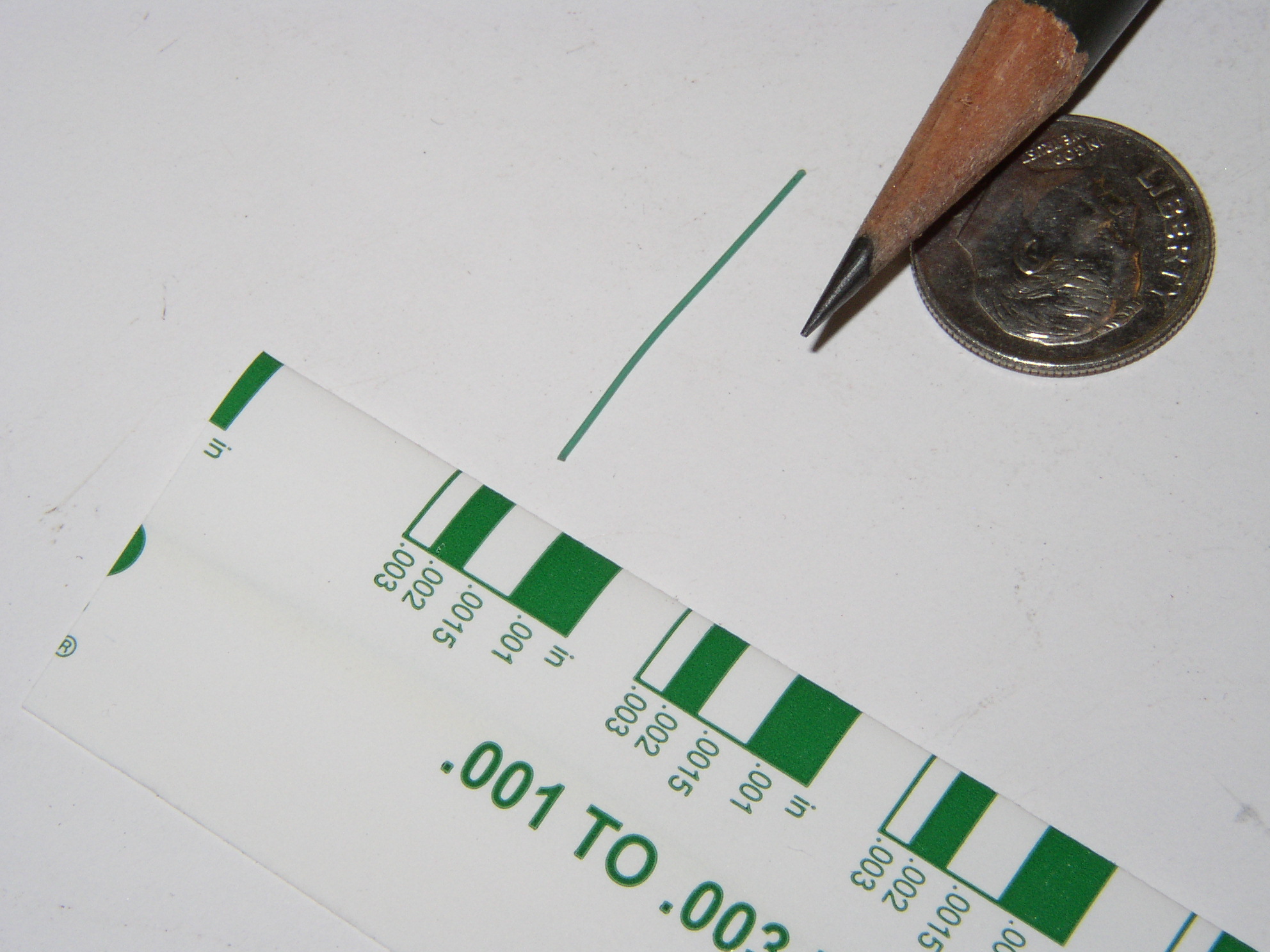

OK, the dry run went great, let's do the real deal. I miked everything and it was great but Plastigage tells the real tale. It's a thin plastic thread that's bolted in between the bearing and the crank and how much it "squishes" out tells what the clearance is. The rods were all right on target, between .0015 and .002"
Short block went together perfect and spun as free as a bird.

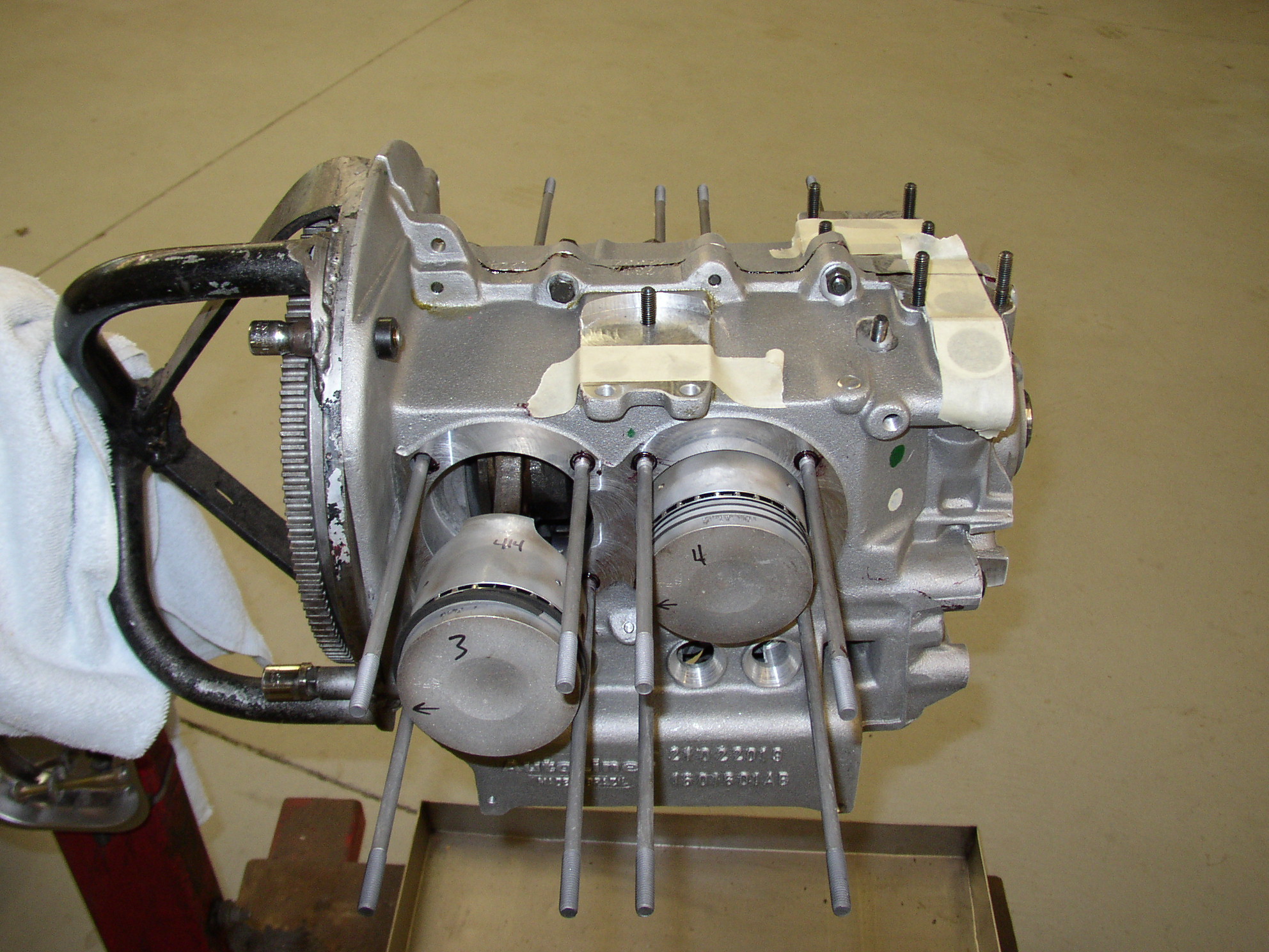

Sean's pistons were shit so I dug up a set of matching slugs that weighed less than one gram apart. Spec is 10 grams. Soda blasted and looked great.
The jugs were perfect- no measurable out of round, a quick ball hone and good to go. Wall clearance was within spec and end gap was right on at .015"

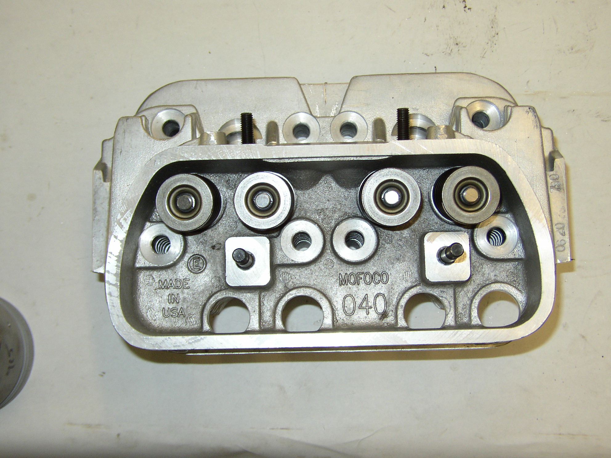

The heads came and looked good, chambers measured 53cc. It's not often you see something made in USA.
C/R came out to 7.44 which is right on target.
Together and air checked all four, and it spins free.
