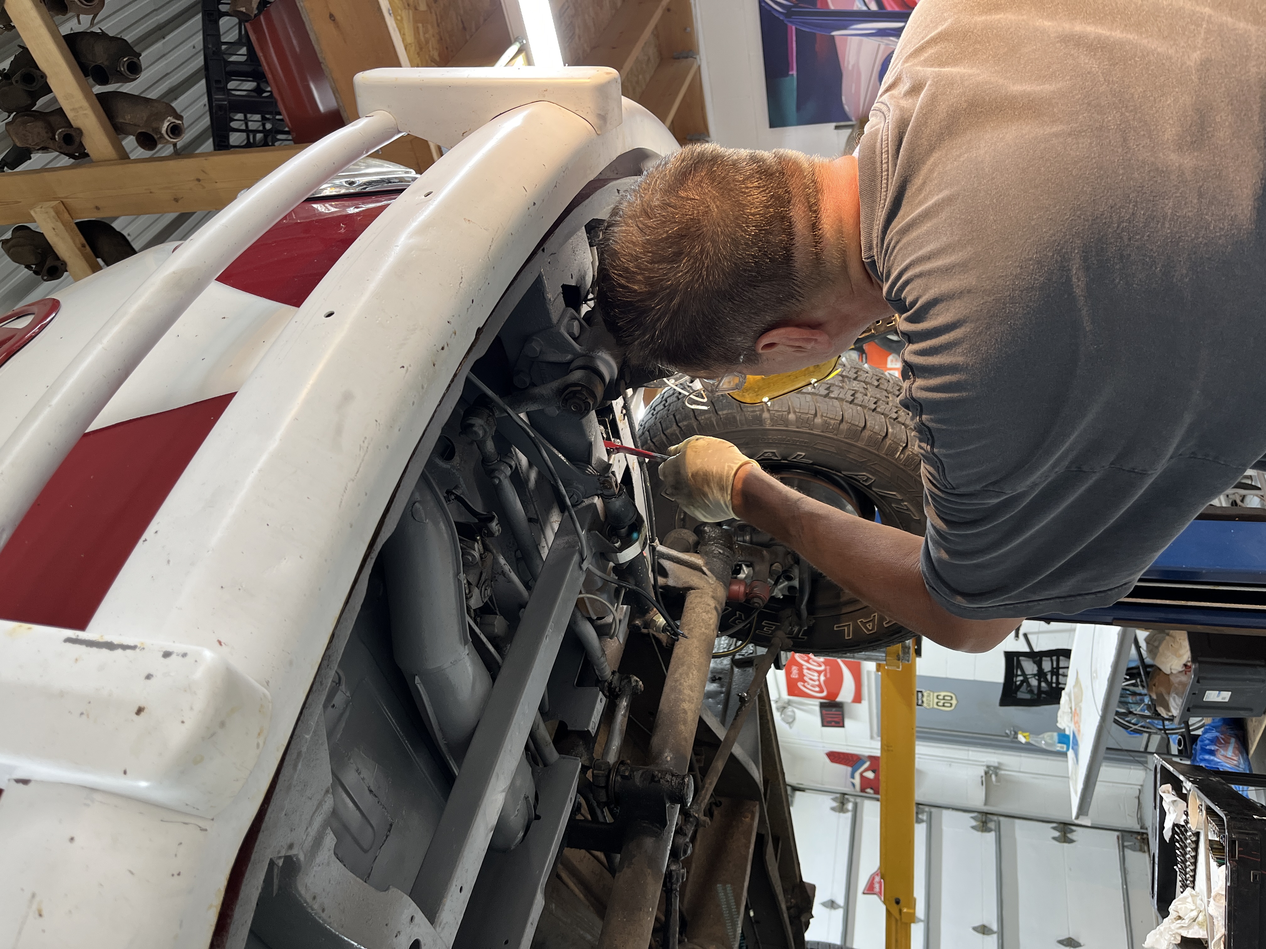

Did a little work at Bruce’s shop yesterday. We went through a few odds and ends.
The main objective was to check/ inspect the clutch cable. There was a lot of play in the legal. We ended up replacing it as well as the pin connector. We also adjusted the brake pedal, greased up the front end and did a valve adjustment.
Gotta love having a lift and air conditioning. 😁 thanks Bruce.

In addition, we changed the pushrod boot on the MC, replaced the Bowden tube, filled the leaking tranny, checked the front end and lubed miscellaneous pivots. The rear socket of the drag link has about 1-2mm play in it, so it will need replacing soon.

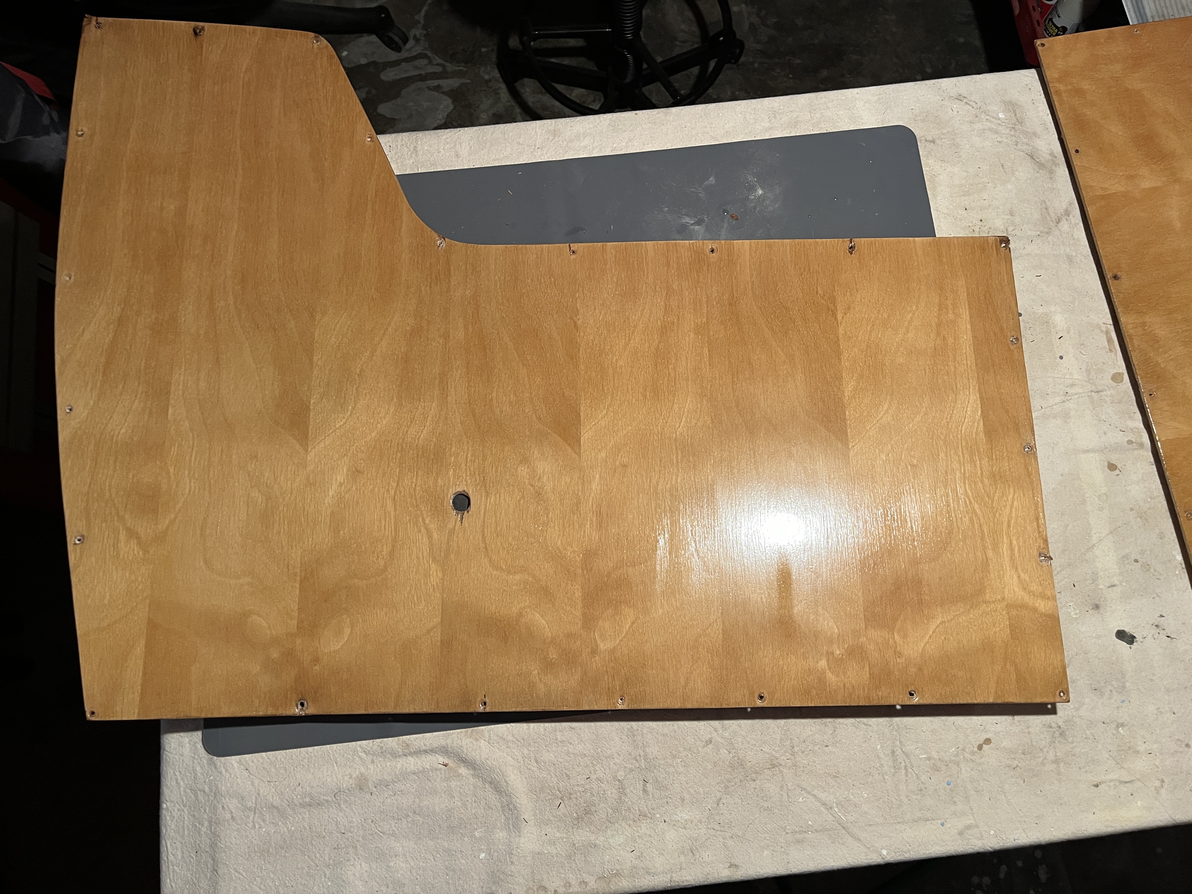

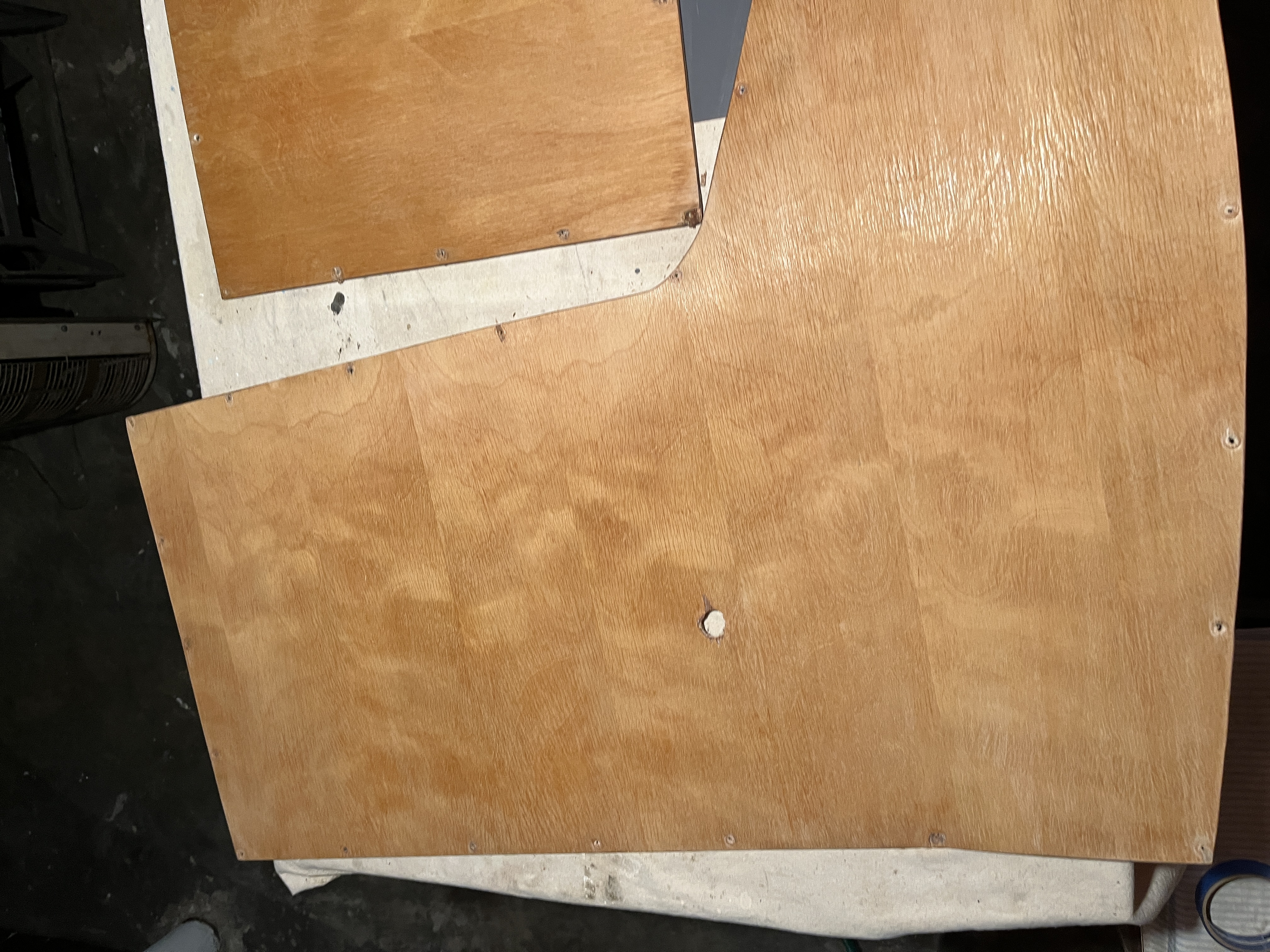

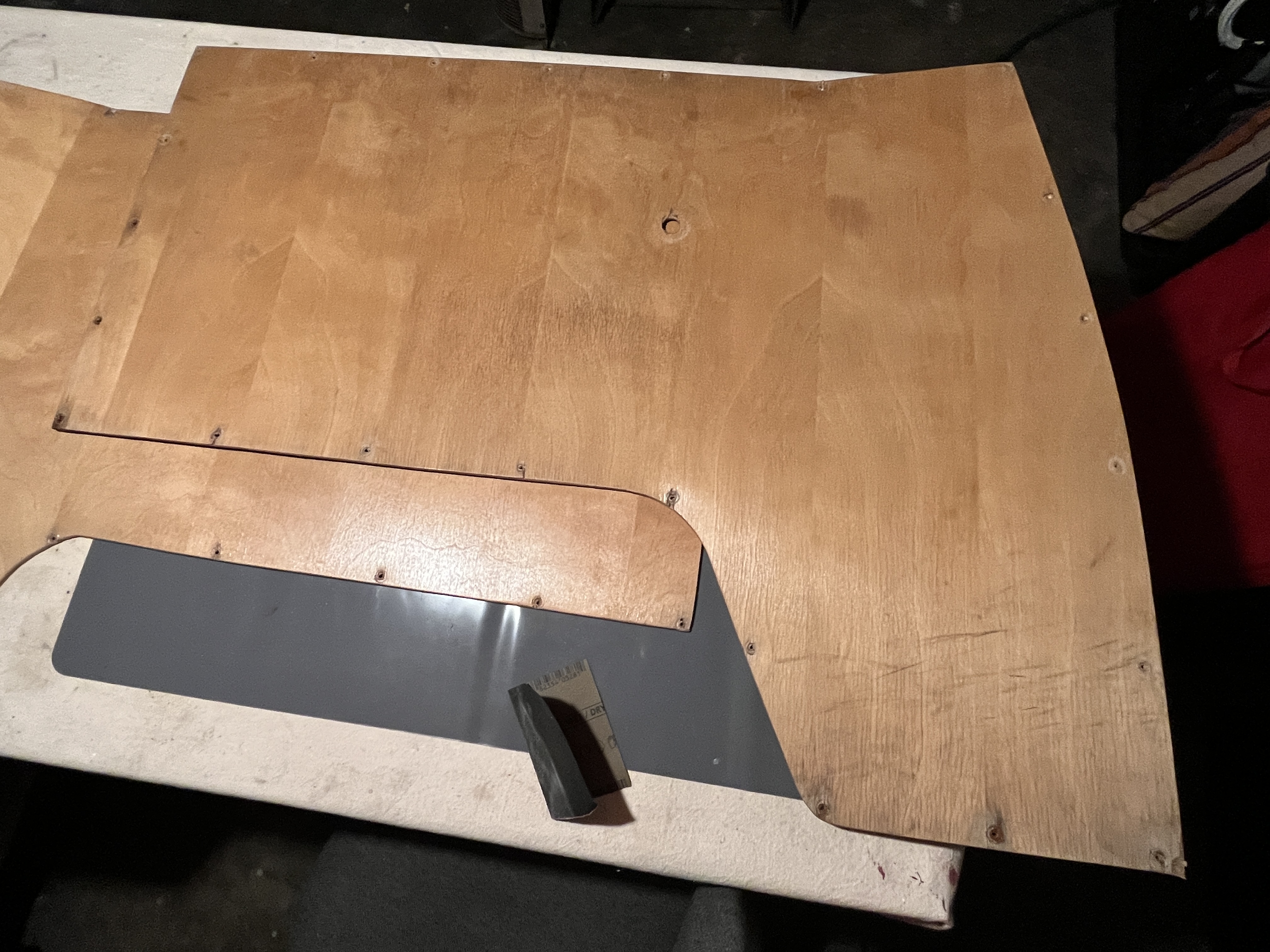

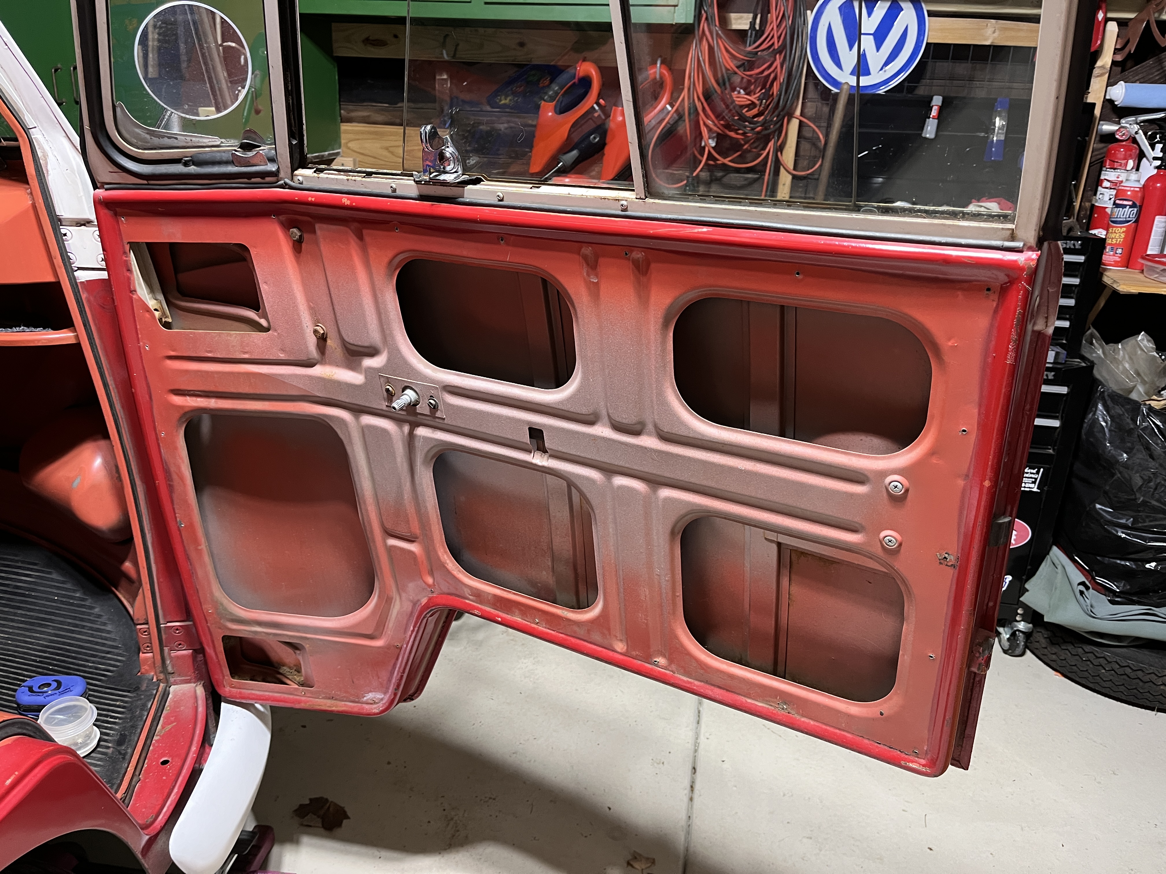

I started by taking the door panels off and removed the widow frames from the door. I have wood door panels that came with the bus. They were a little rough so I decided to clean them up and apply three coats of lacquer on them.

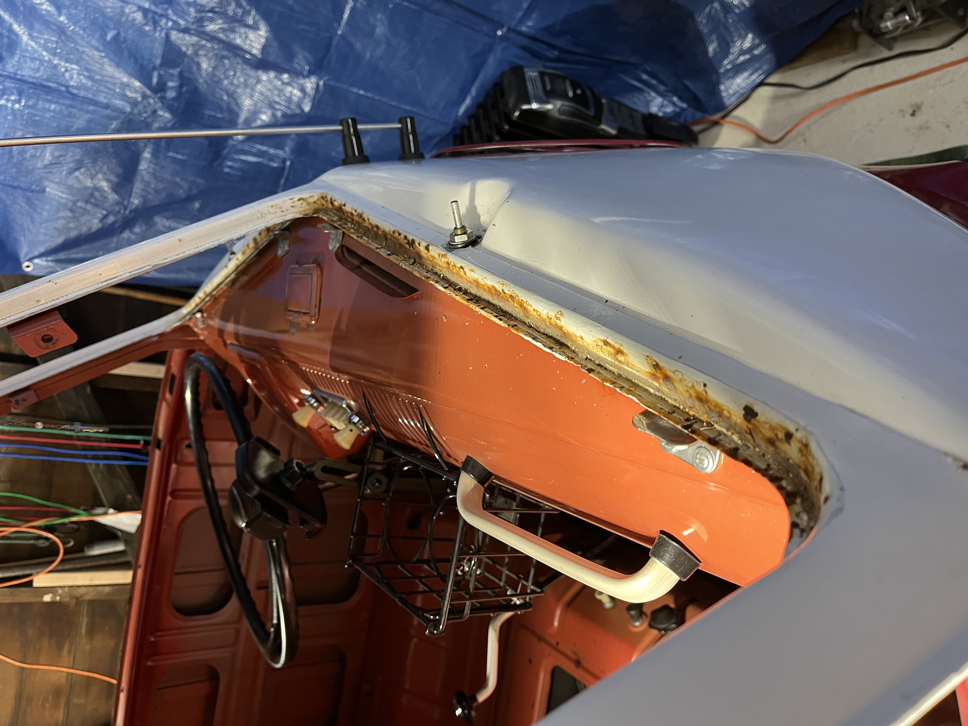

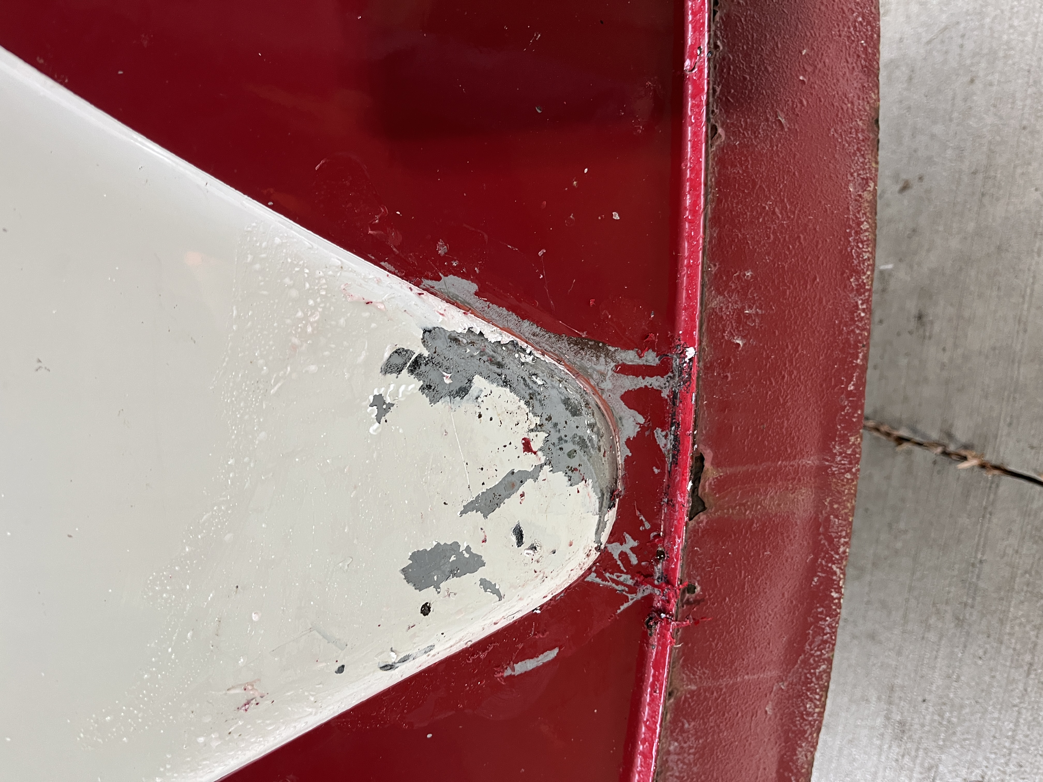

I removed the frames and stared prepping them for paint and new seals.
All in all everything looks really good. Not a lot of rust, very clean and things came apart easily. The seals were very hard and definitely in need of being replaced.
The plan is to clean them up, treat any rust and paint them. The exterior of the bus has been painted before me and the colors aren’t correct. The interior of the frame still has the original color, I am going to go back to that as best as I can.

Looking good! Those front door windows are alot of work!
Posts: 245
Nice job! Door panels look great!

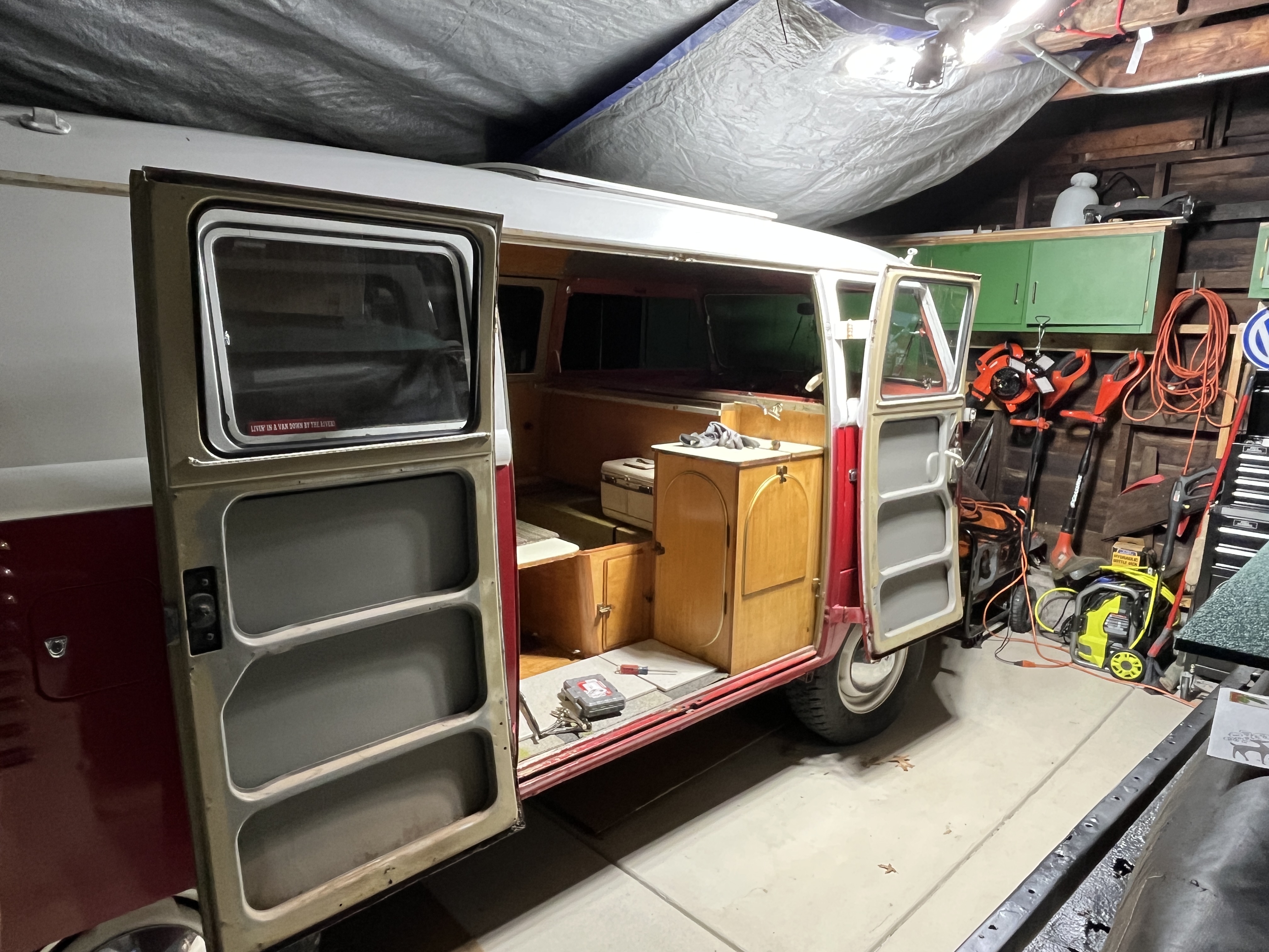

I decided to switch gears a bit in Gunther. I’ll be stripping it down and painting the exterior. I have a contact at Sherwin Williams helping me out with color and paint selection. Hoping to get some spray outs for samples to see how good we can get it.
Ib the meantime, I have been slowing taking everything off of the bus, packaging and labeling all of it. I’m not sure I’ll remember where all of this goes. Numbers, lights, cargo door panels, curtains, mirrors and wipers all removed so far.

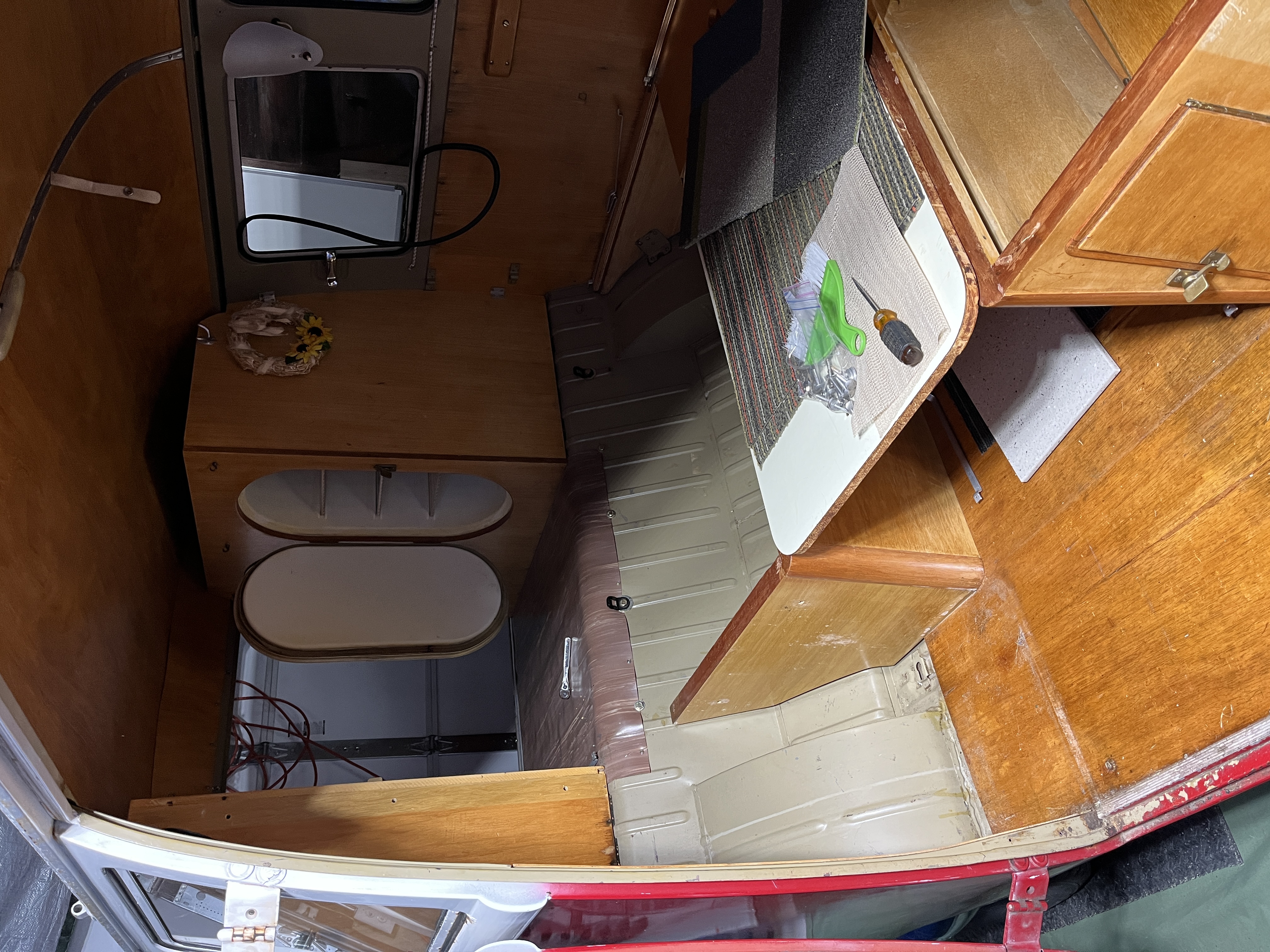

I had a helper home from college so I concentrated on some of the work that is best with two sets of hands. All of the windows are out now. We worked on the cabinets but having a hard time getting the two rear most cabinets out. I’ve had them out before, I’m just not remembering the trick. So pause in that for now.
I also did a small area of stripper to see what I will be up against. It’s looks like I “should” be able to get it down to metal. We’ll see how this goes.
Here are some photos.
