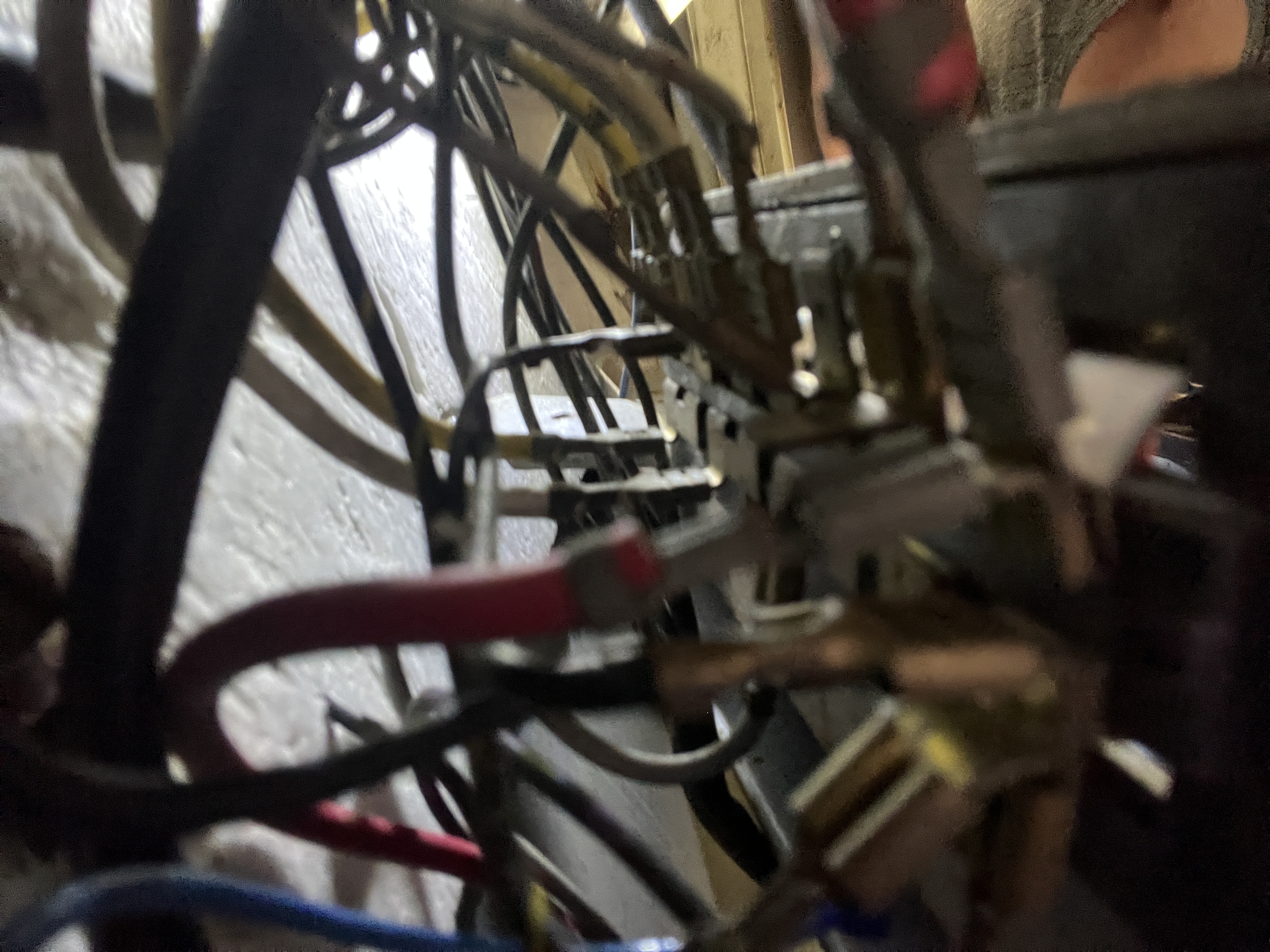

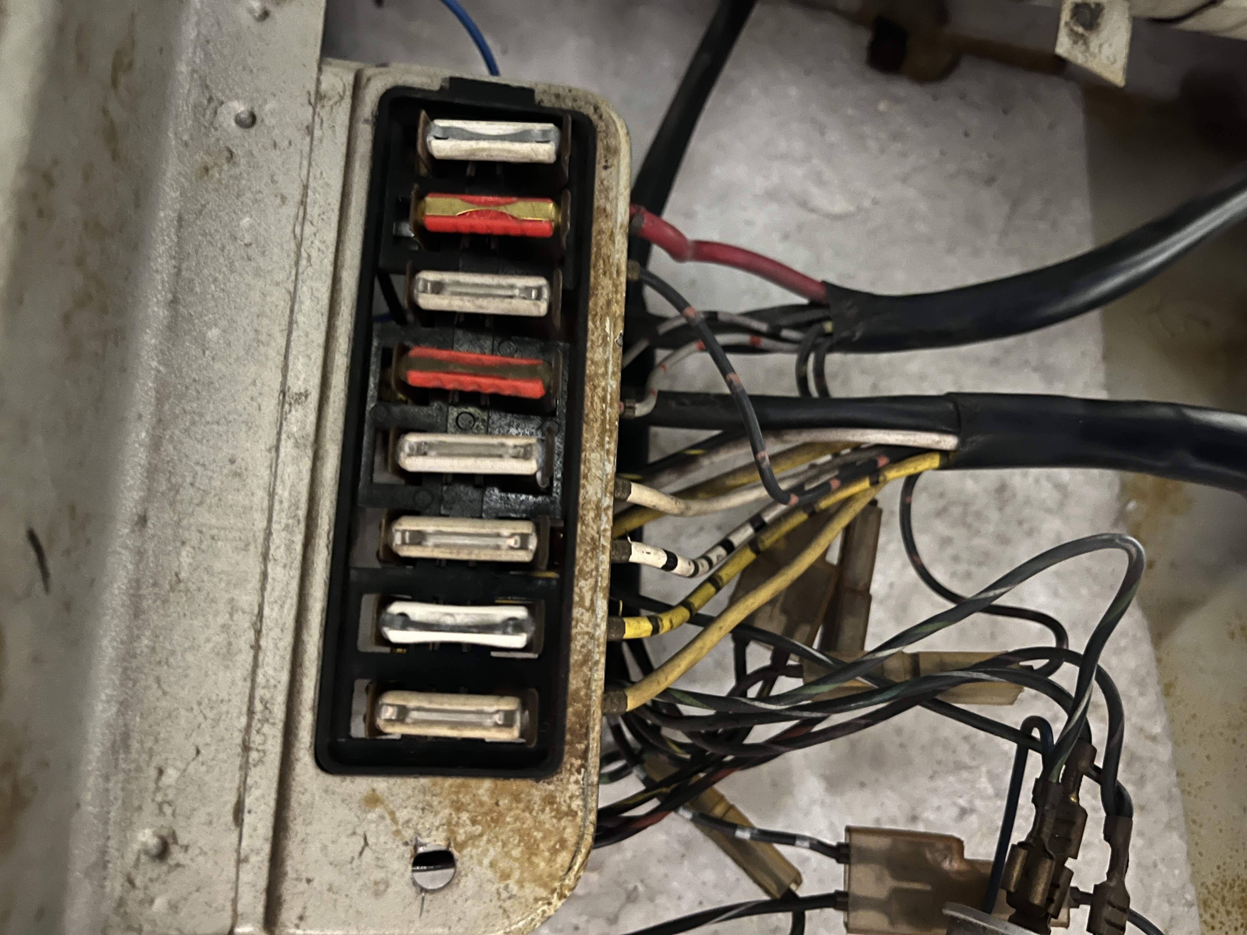

I figured I’d try to tackle some of the electrical issues on Sanford this weekend. Like Bruce said there is some funky stuff going on in here. I’m pretty green to this but even I can tell things were funky in some areas.
Here are some of the issues I wanted to try to fix.
No power to the wiper motor
No horn power
The starter won’t turn over or even click after running the engine for a while or when it’s hot.
I did some reading and it seemed like all of these issues are being fed from the fuse on the far right. My first thought was check the fuses. They all looked Ok. Although I don’t think this truck should have any of the red (16A) fuses.i checked the connections at the starter and they seems solid.
Then I thought cleaning up all of the connectors on the fuse box would be a good idea. As I’m looking at the fuse box, I started thinking maybe a new harness is needed on this bus. I am seeing a lot of spliced wires and some bare wires in the back of the truck. So now I think just start from scratch and make sure it’s done right. We installed a fuse on the main feed in Gunther, I’d like to do the same here. I’m not confident this truck is “safe” and I am worried I will miss something.
Anyone have thoughts on what you would do? I’ve been reading about wiring harness installs and I have heard others say it’s good proactive approach, just to be sure it’s clean and done right. I’m probably in over my head on this.
Needless to say Sanford is now out of commission for now.
Posts: 1776
Thanks for sending the informative articles Bruce. I read through the all. I decided to take the lunge and do a complete wiring harness and electrical overhaul on the truck including some upgrades. I ordered a harness from Wolfsburg West. I’ll dig into this project as soon as it gets delivered. Stay tuned!
