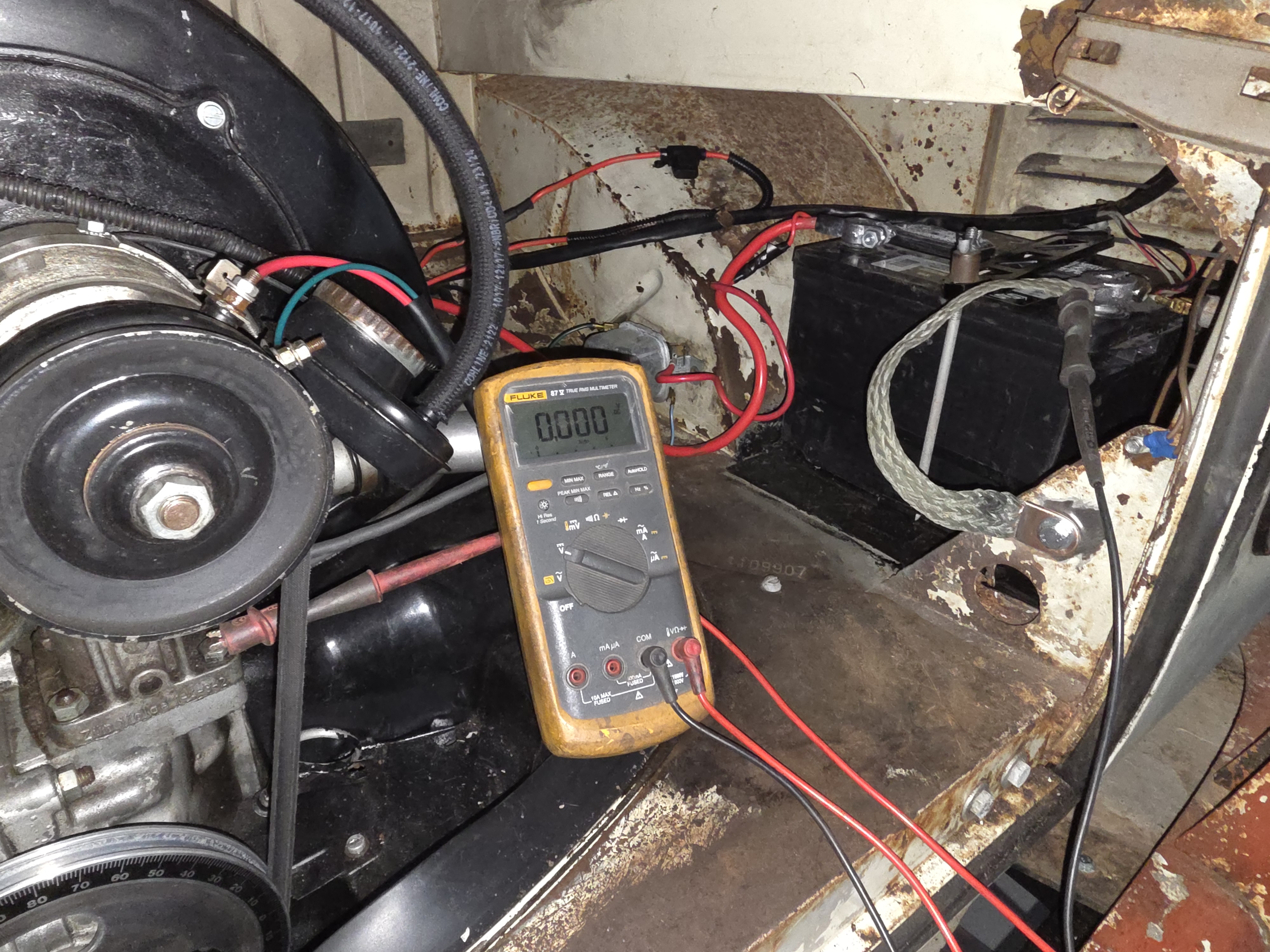

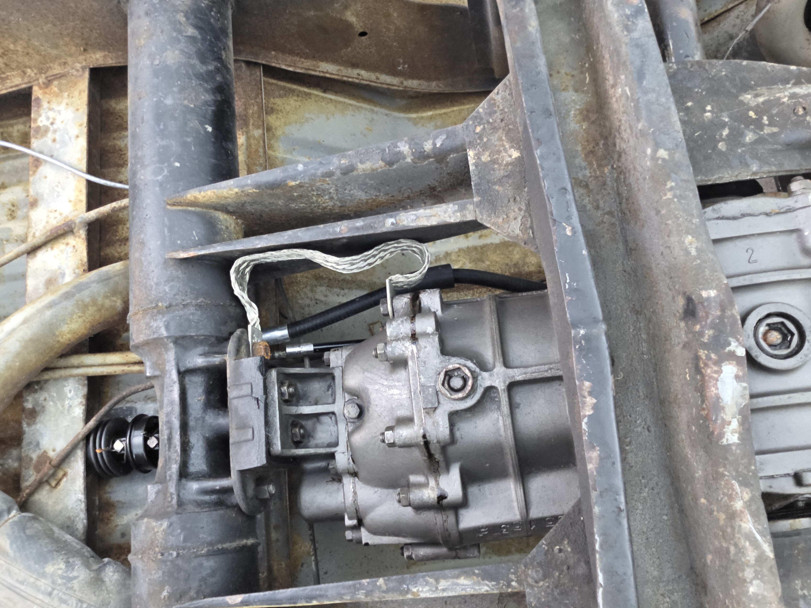

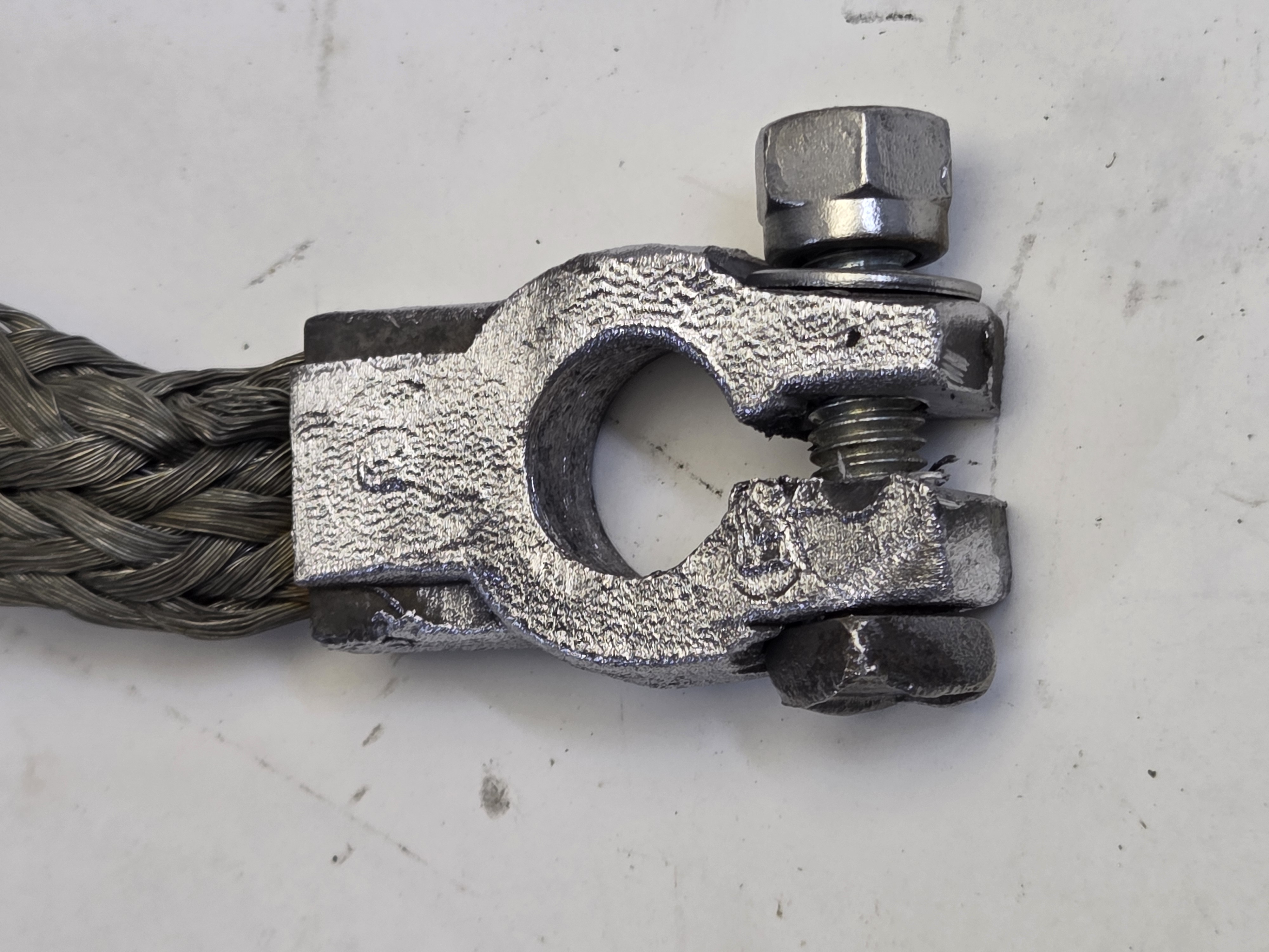

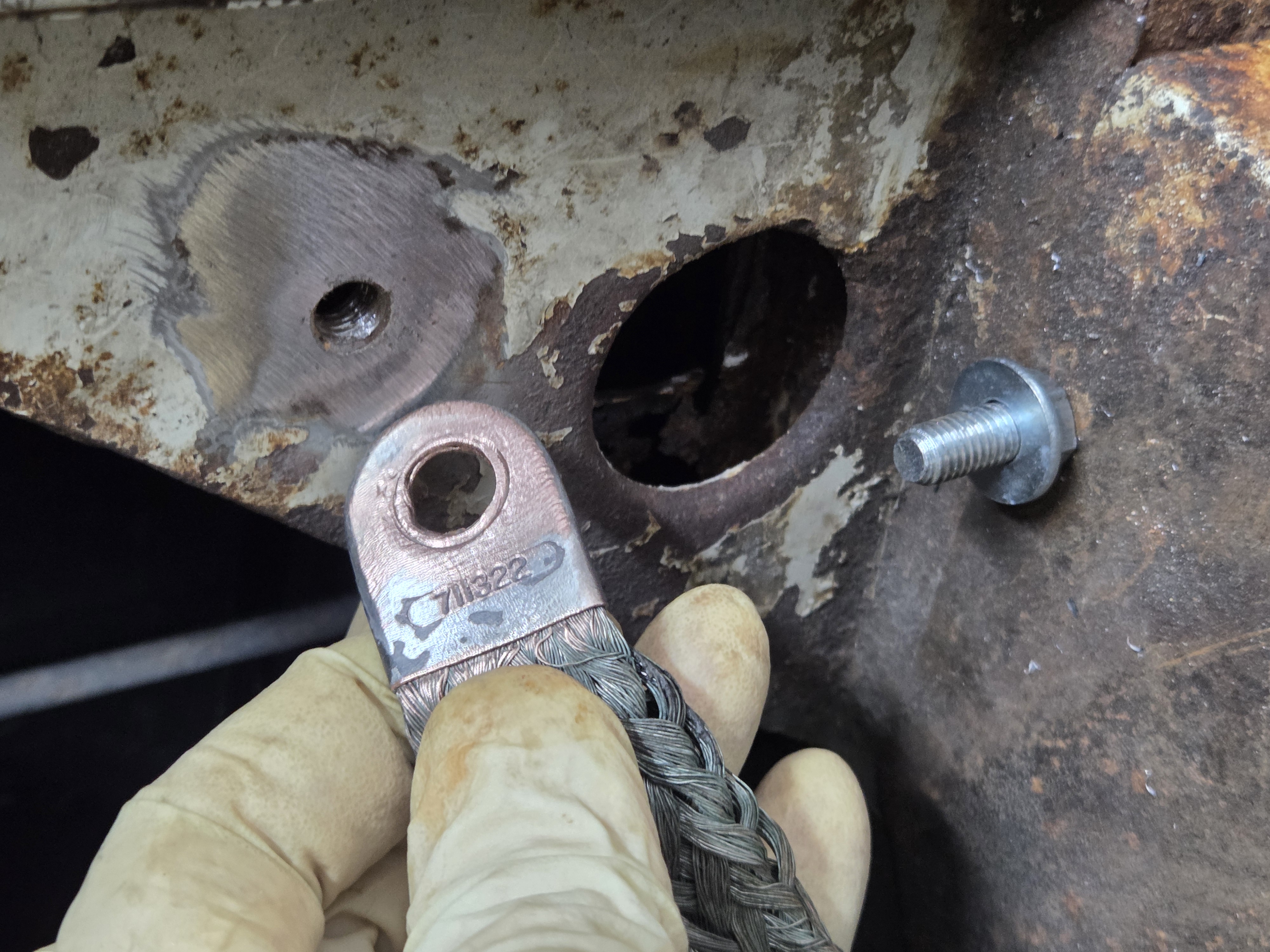

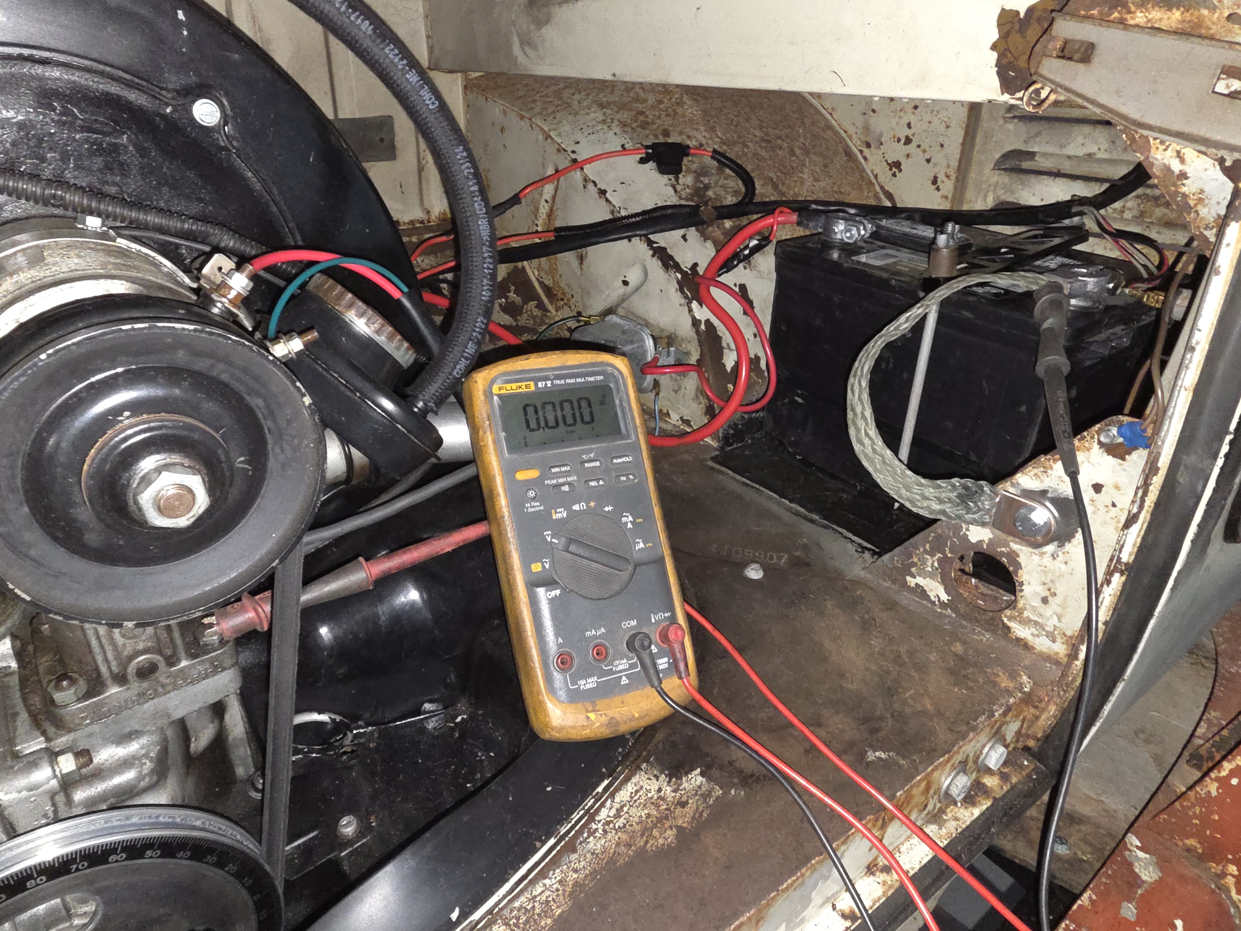

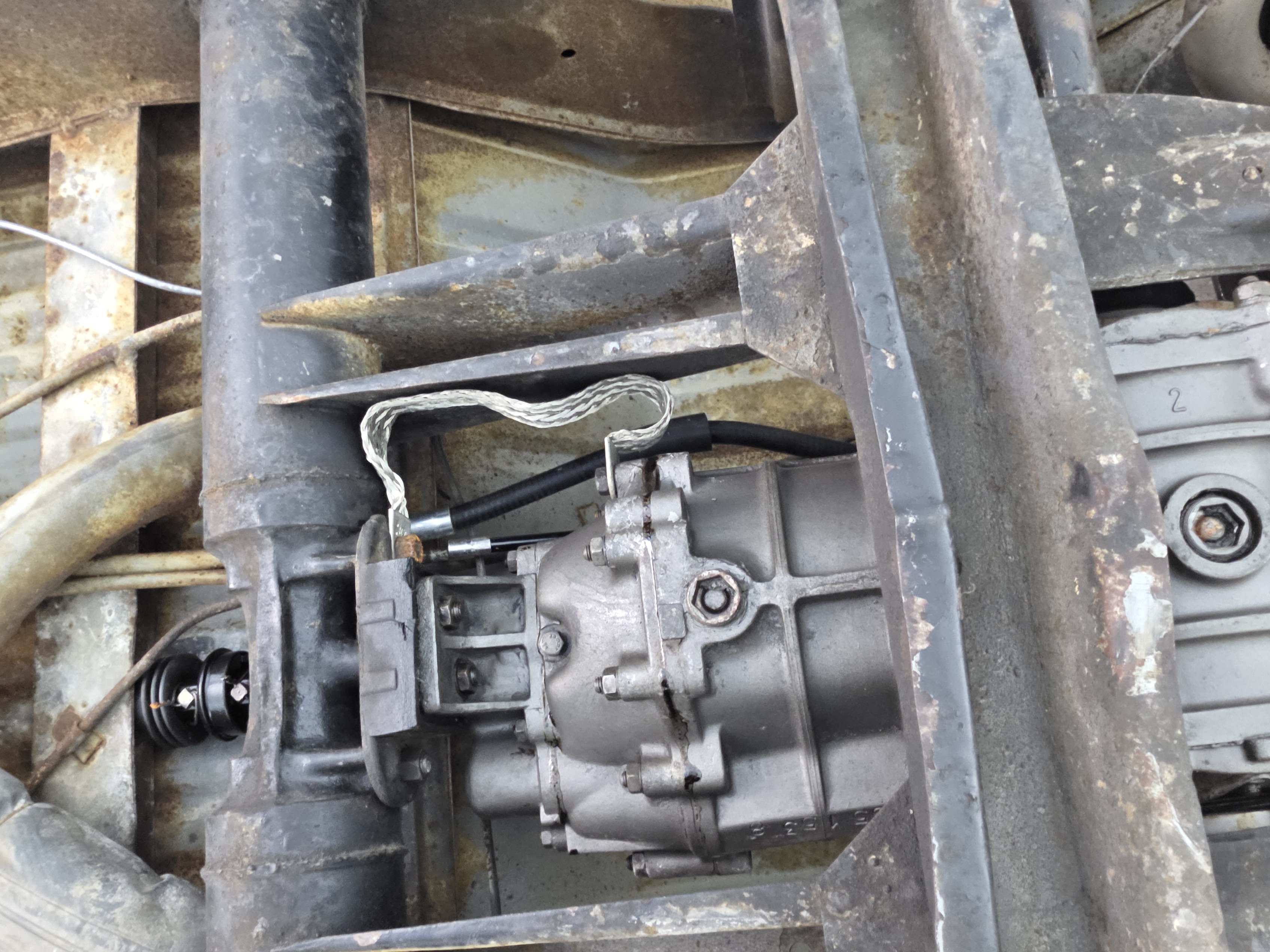

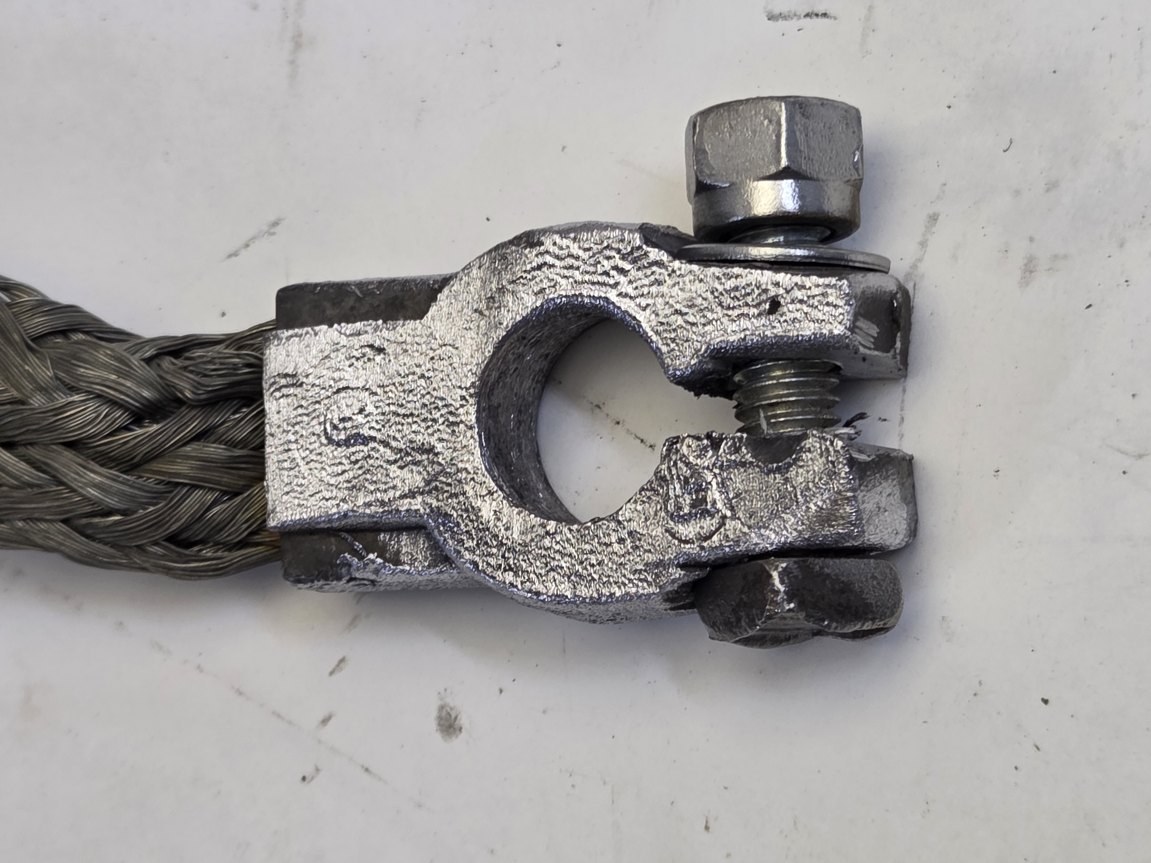

1. Install battery, redrill holddown clamp to accommodate wider battery. Remove and clean ground strap at connection to body. Remove clamp bolt- ends of clamp are touching, use cutoff wheel to remove material to make clamp function correctly. Clean bolt and redrill bolt hole in clamp. Chase threads in body with tap, install new bolt and flat washer. Check ground strap at trans, appears clean and tight. Check voltage drop while cranking between battery negative and engine case, within spec at .25v.

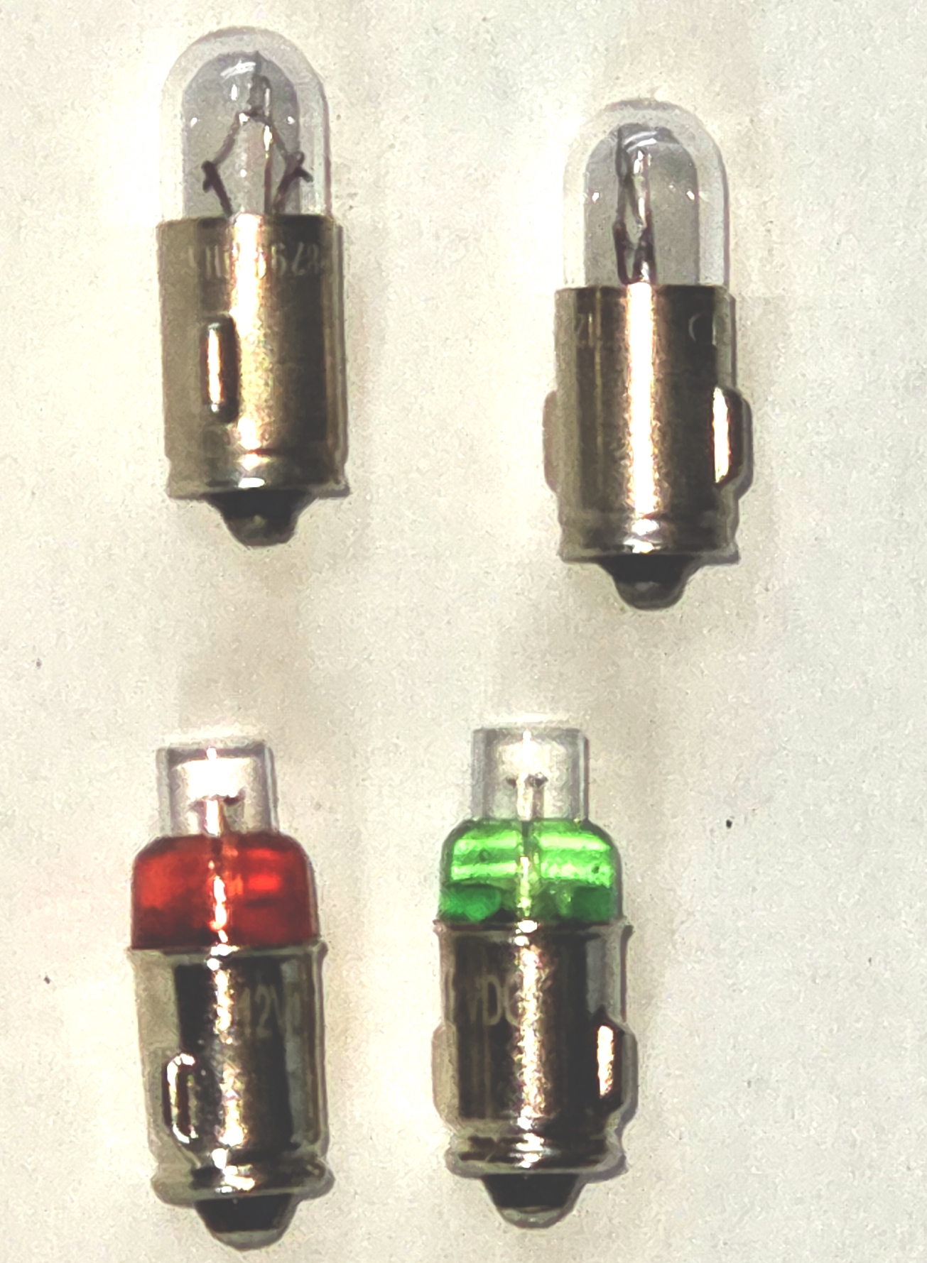

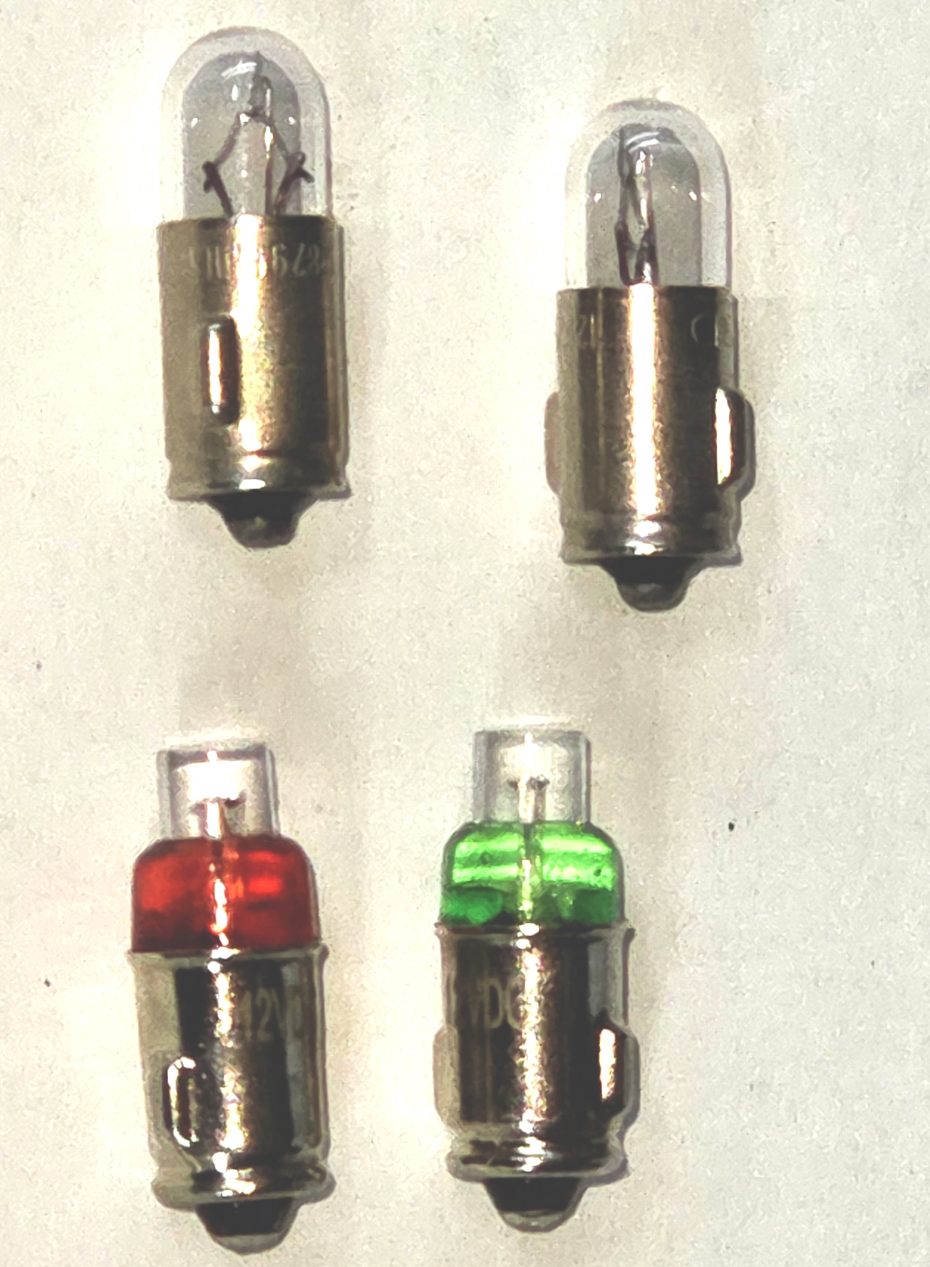

2. Indicator Light Issues- both oil light and generator light inop. Test circuits to find them complete. Remove light bulbs to find them LED normal polarity, circuit is reverse polarity and a single polarity LED bulb will not function. (VW wires this circuit reverse- bulb base is positive, bulb tip is negative) Install new regular bulbs and warning lights work correctly. Check charging voltage, 14.5vdc/2000rpm is normal.

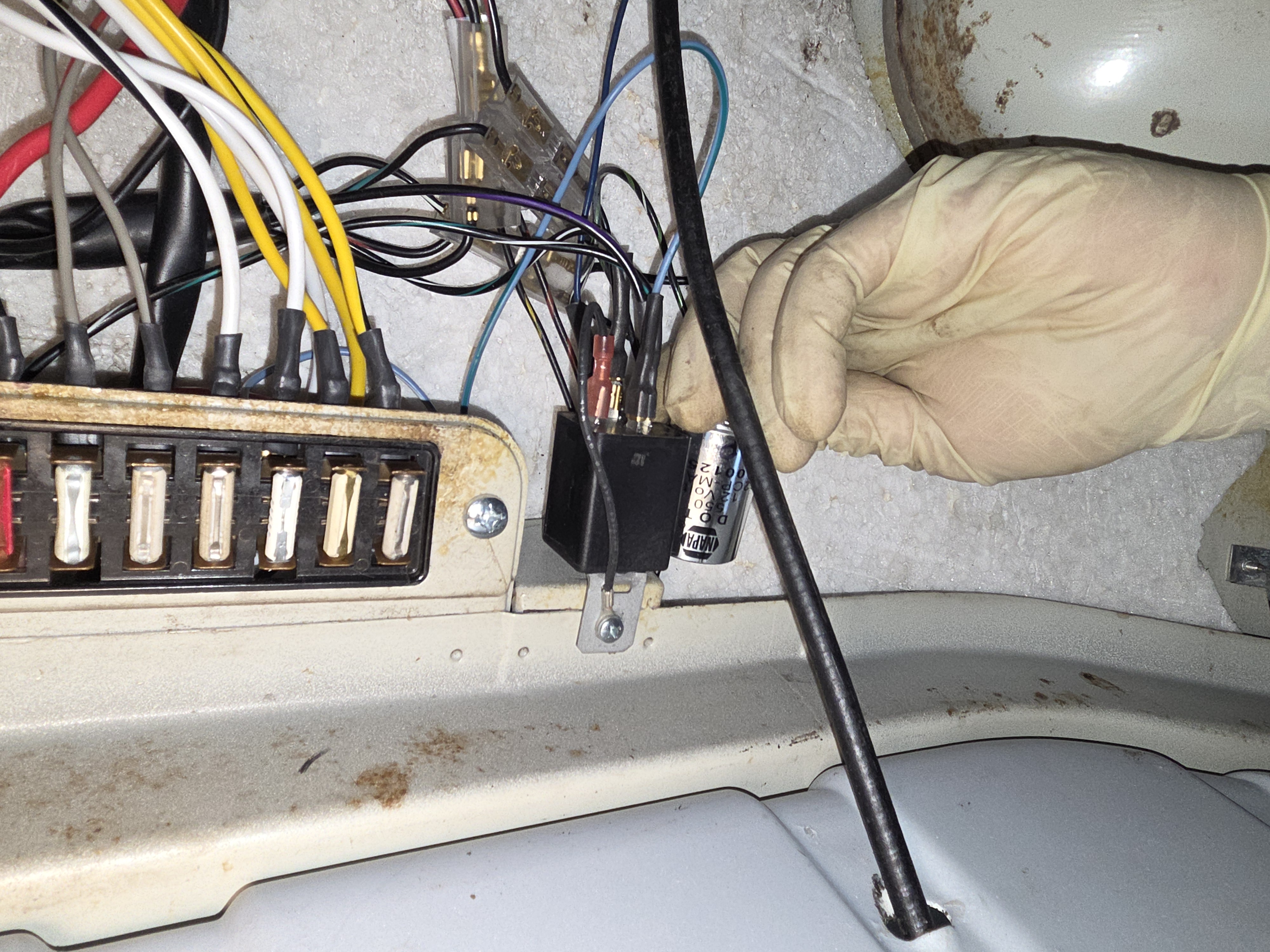

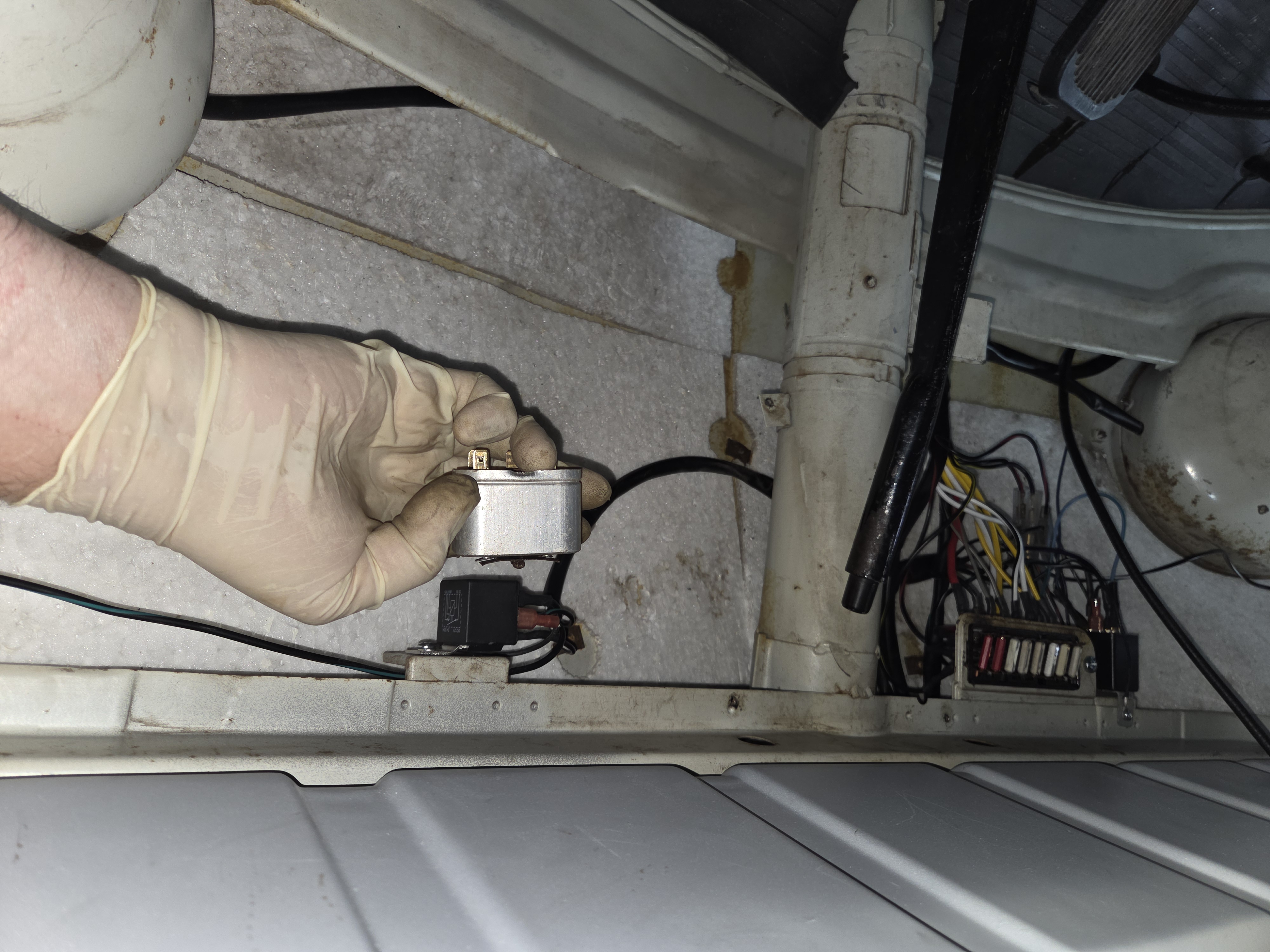

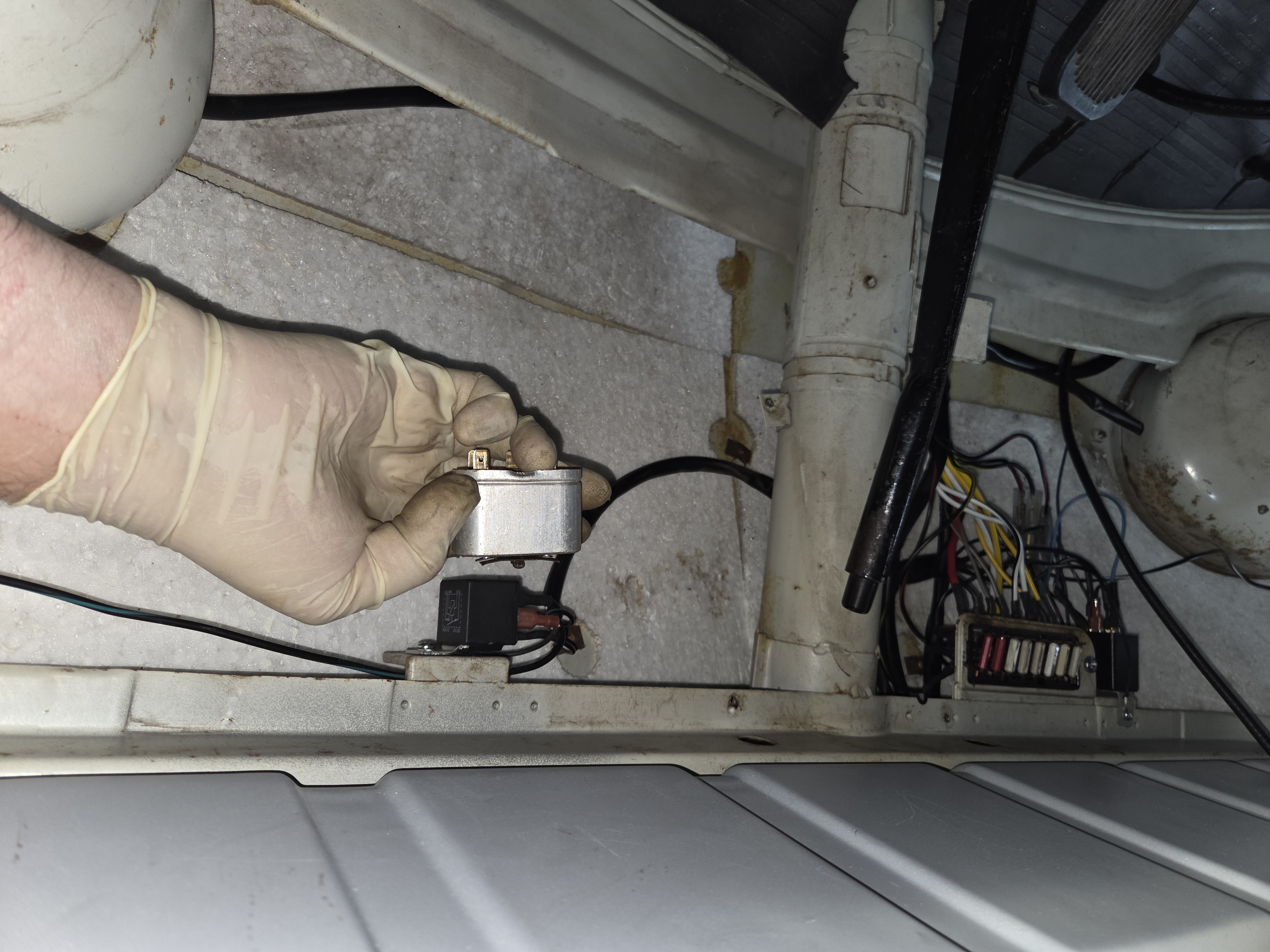

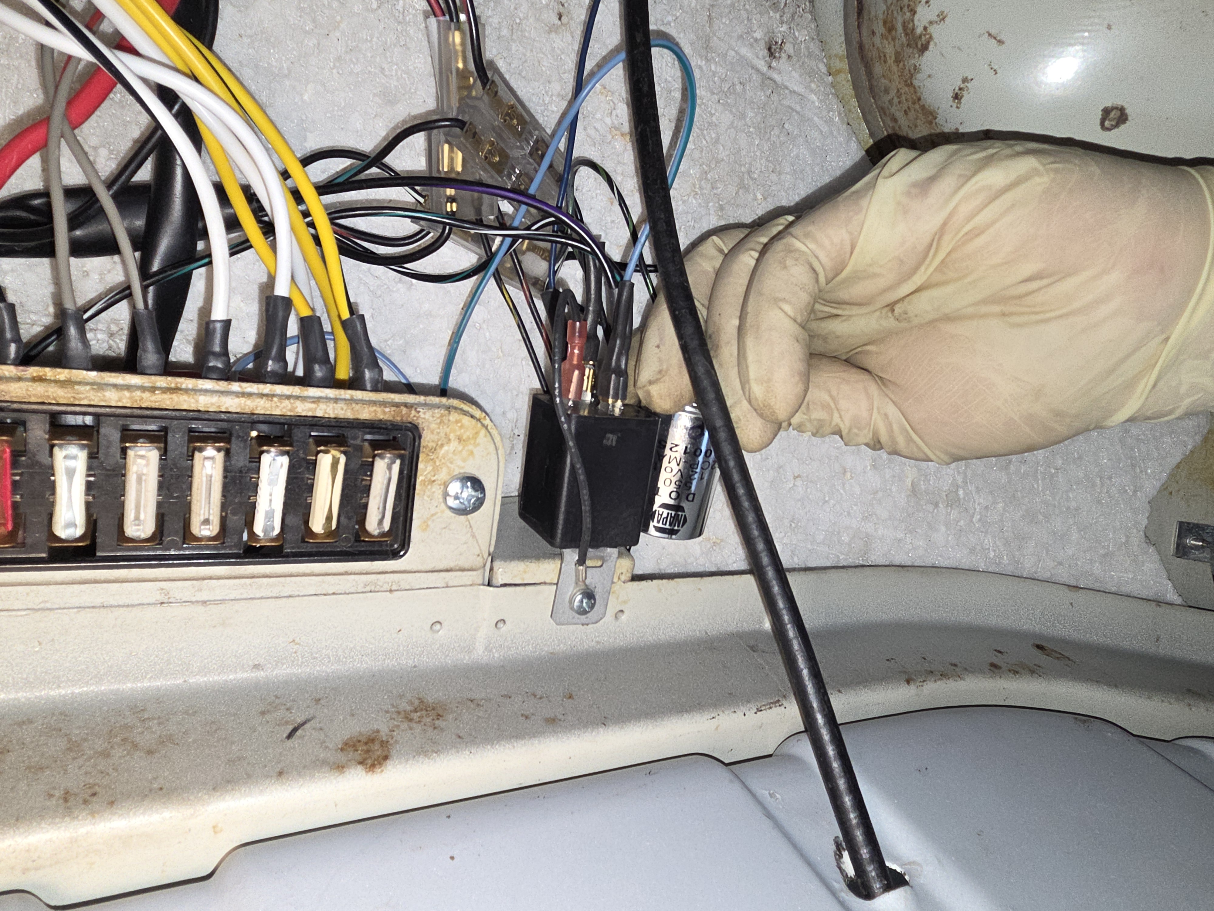

3. Turn signal indicator works with key off, but not with key on. Load test power and ground circuits in dash to 9 amps-OK. Check 4way relay to find it marked as 6V, install standard 12v Bosch 5 pin relay in its place. Test flasher unit to find it intermittent, replace with ’68-70 Beetle flasher relay and install ground wire on flasher. Indicator light on dash needs ground input rather than power input to work correctly, remove black power wire at top center of speedo and tape off. Install ground wire at this terminal to complete circuit, indicator now works correctly with both turn signals and 4ways. Install Phillips head screws on speedo head and most dash switches as they are much easier to remove and install. Mount both relays to dash. Correct power feed causing slow drain to battery.

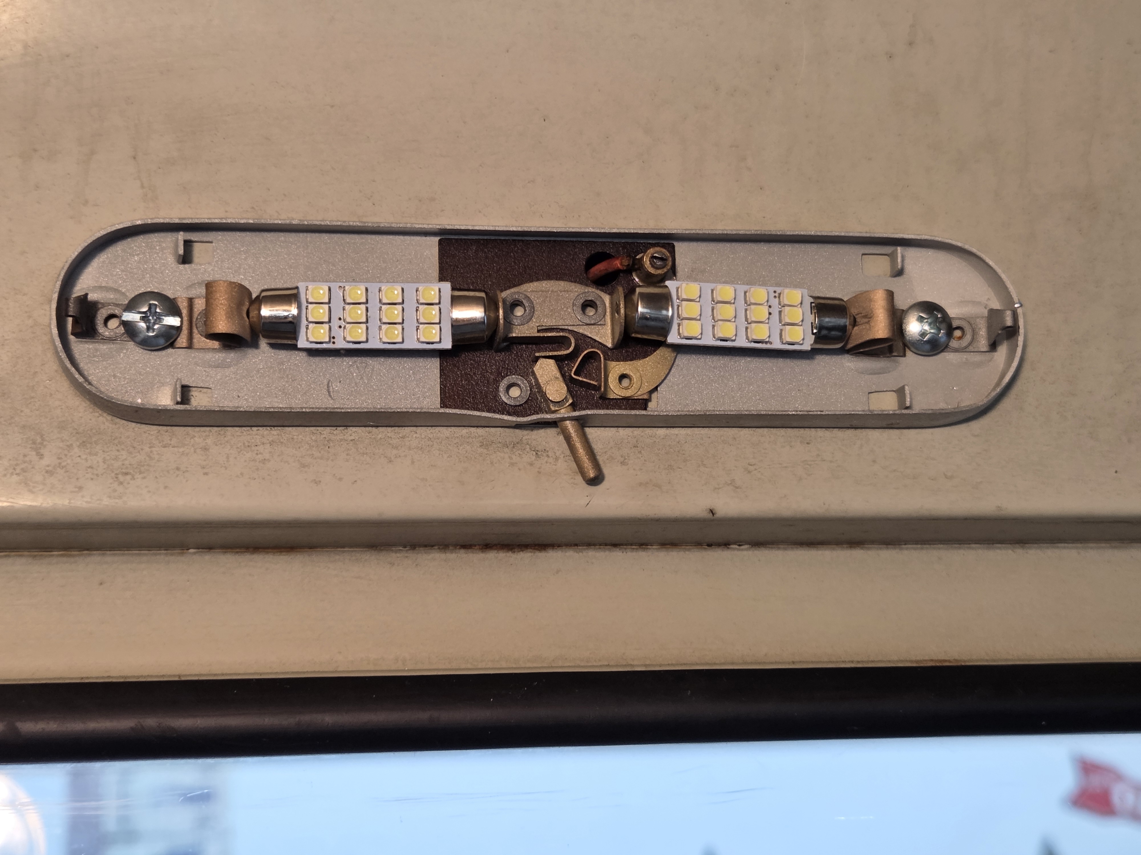

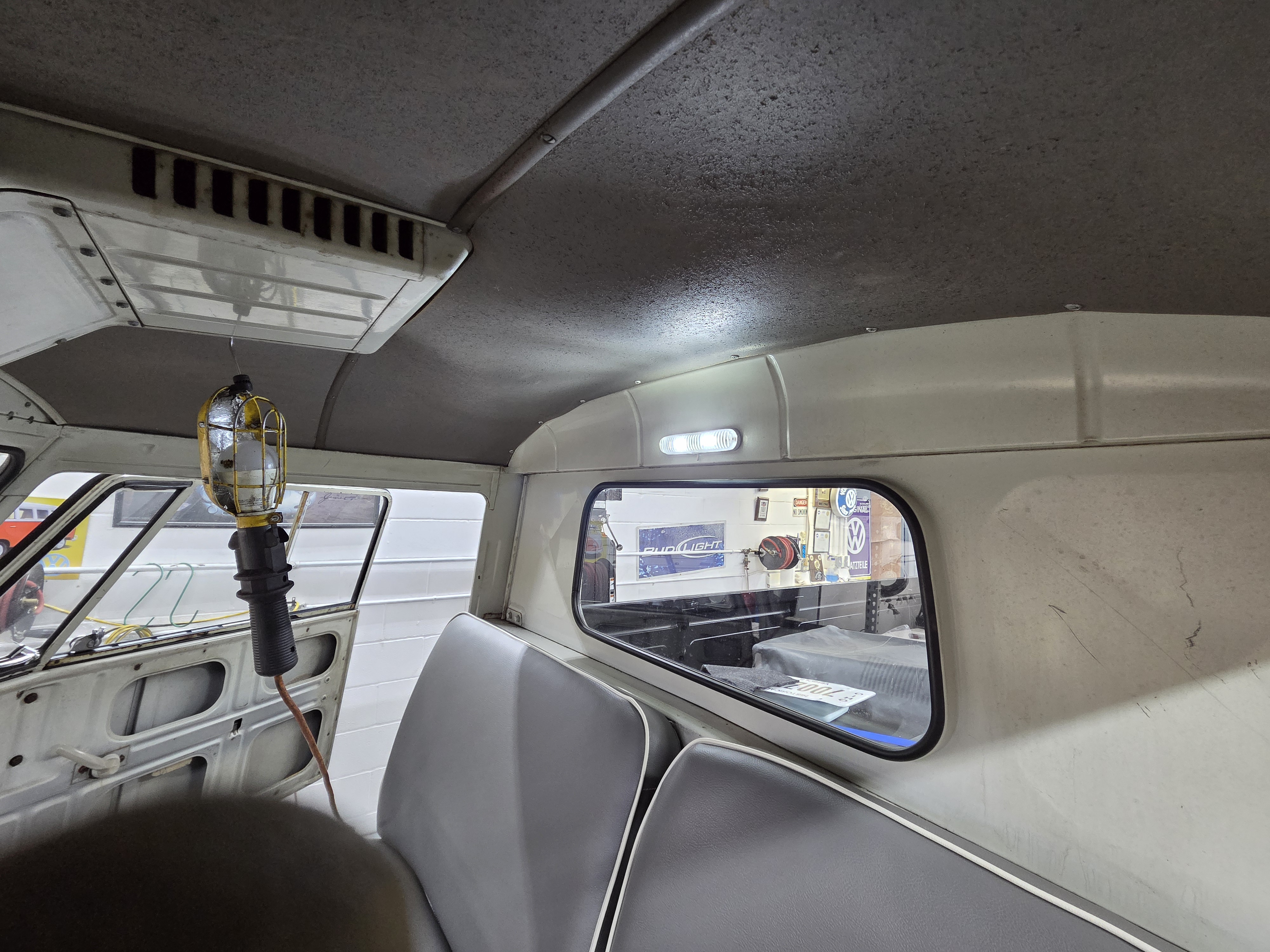

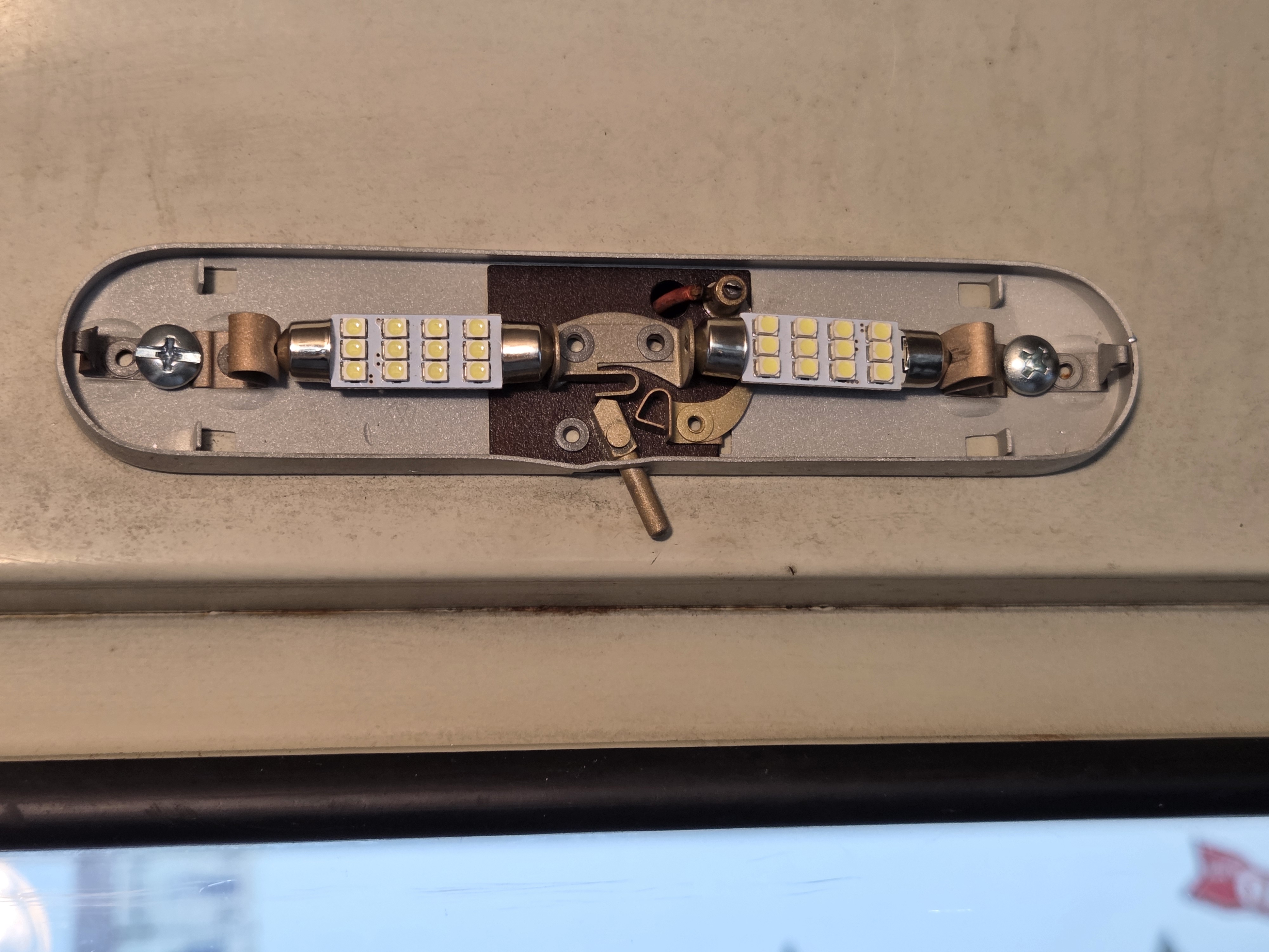

6. Dome light inop- remove dome light and bead blast housing to clean terminals, lube switch and install with new screws and LED bulbs. (bulbs are polarity sensitive and won’t work if installed backwards). Test dome light draw to be .17ADC.

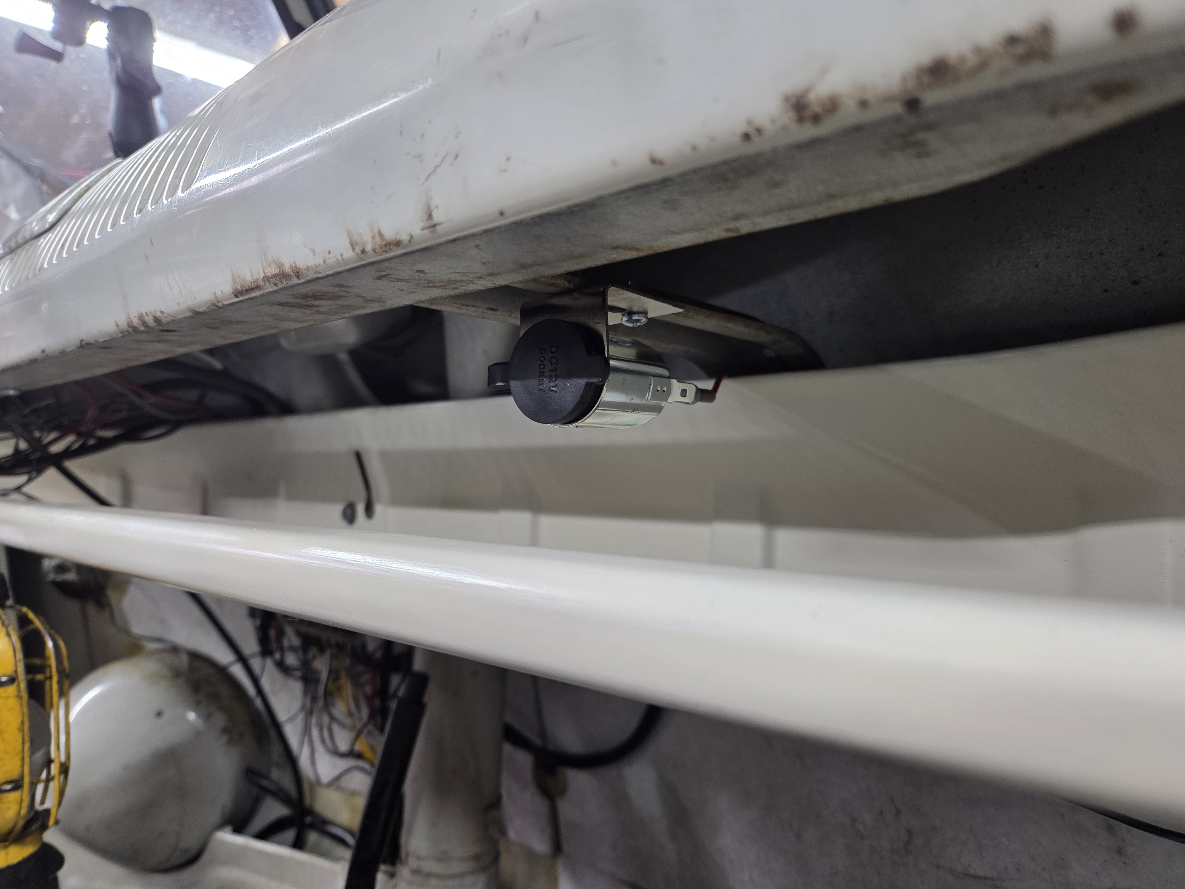

7. Install power port under dash for powering accessories powered from fuse 2.

The ground strap on the tranny was clean and tight and tested fine under load.
The 4way relay was marked 6v so I installed a standard 12v 5 pin Bosch relay in its place.
I wasn't happy with the Napa flasher which seemed to work funky so I installed a '68-70 Beetle flasher in its place which uses an external ground and has proven to be more reliable than an American can style.
This is how I did the voltage drop test on the ground side. I know it doesn't include the starter to case connection, but it does include the ground strap and 99% of the circuit. It read .25v under load which is within the spec of .5v.

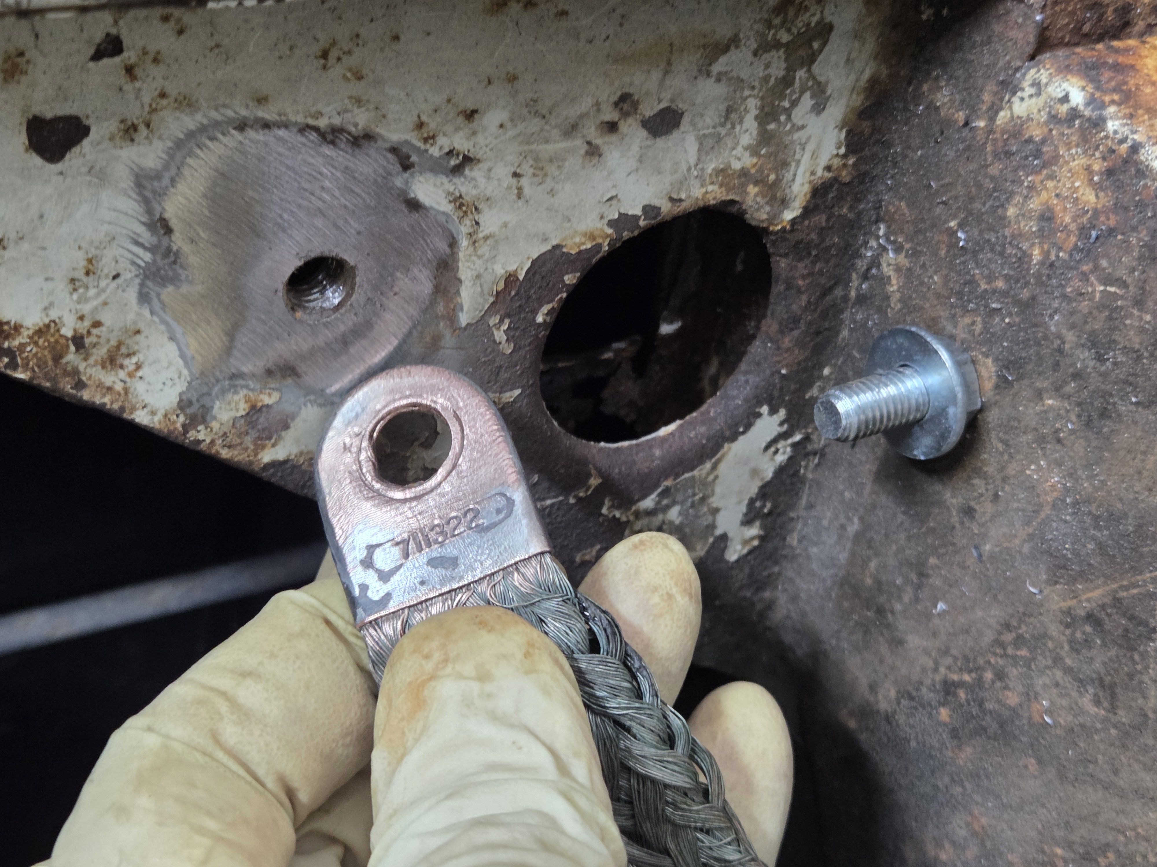

This is a common area to have a poor connection. I'm not a fan of the "star washer" setup, which is what this had, which reduces contact surface area. I cleaned the surfaces well with a cookie pad, chased the threads with a tap, and used a new bolt and flat washer. Testing with this setup has proven to me in the past to have the least voltage drop.
The ends of the clamp were touching, so I removed material with a whizzer wheel so the clamp would work correctly.
These are the bulbs Marla bought from the same source that provided her with LEDs for her camper. Unfortunately, they sent polarity sensitive bulbs that won't work in a VW warning light system which is wired in reverse polarity- the bulb socket is hot and the tip is ground. I installed regular bulbs and the dummy lights work fine.  LED stands for Light Emitting Diode, and a diode is a one-way electrical check valve. Normal bulbs don't care if the polarity is reversed but LEDs do, unless they have an internal shunt built in. Some LEDs will work in a backwards wired system if they have an internal shunt.

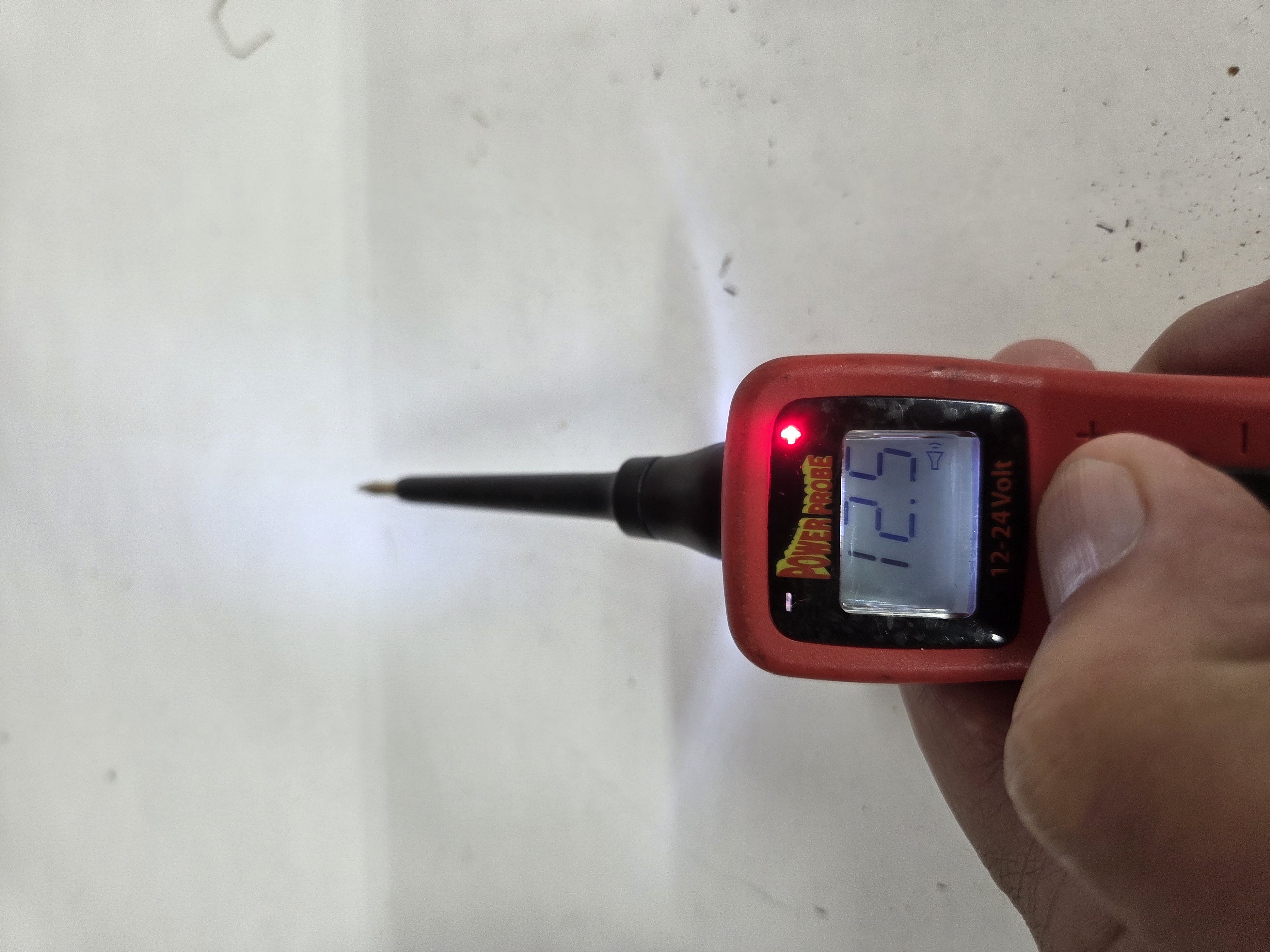

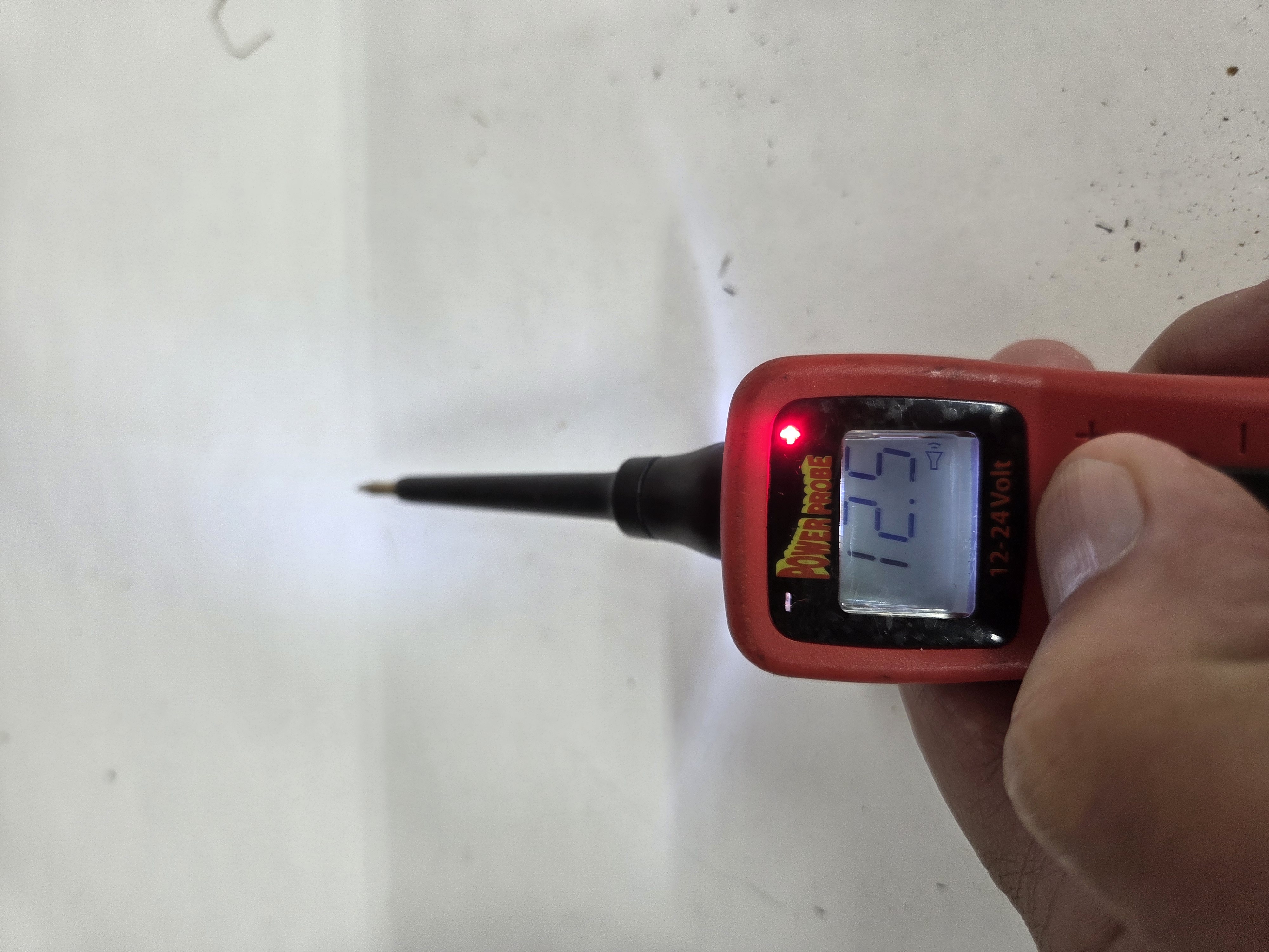

PP showing circuit voltage.

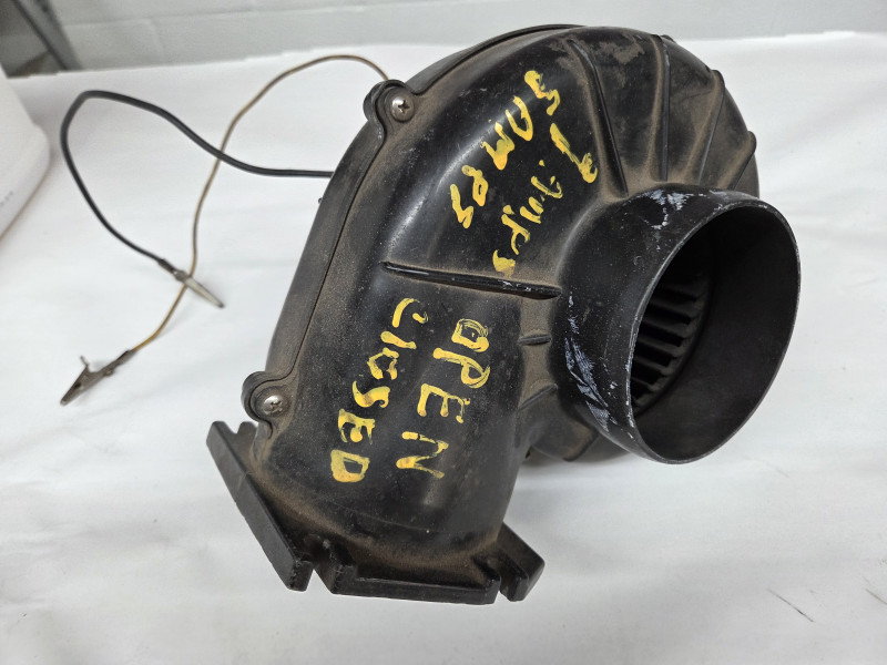

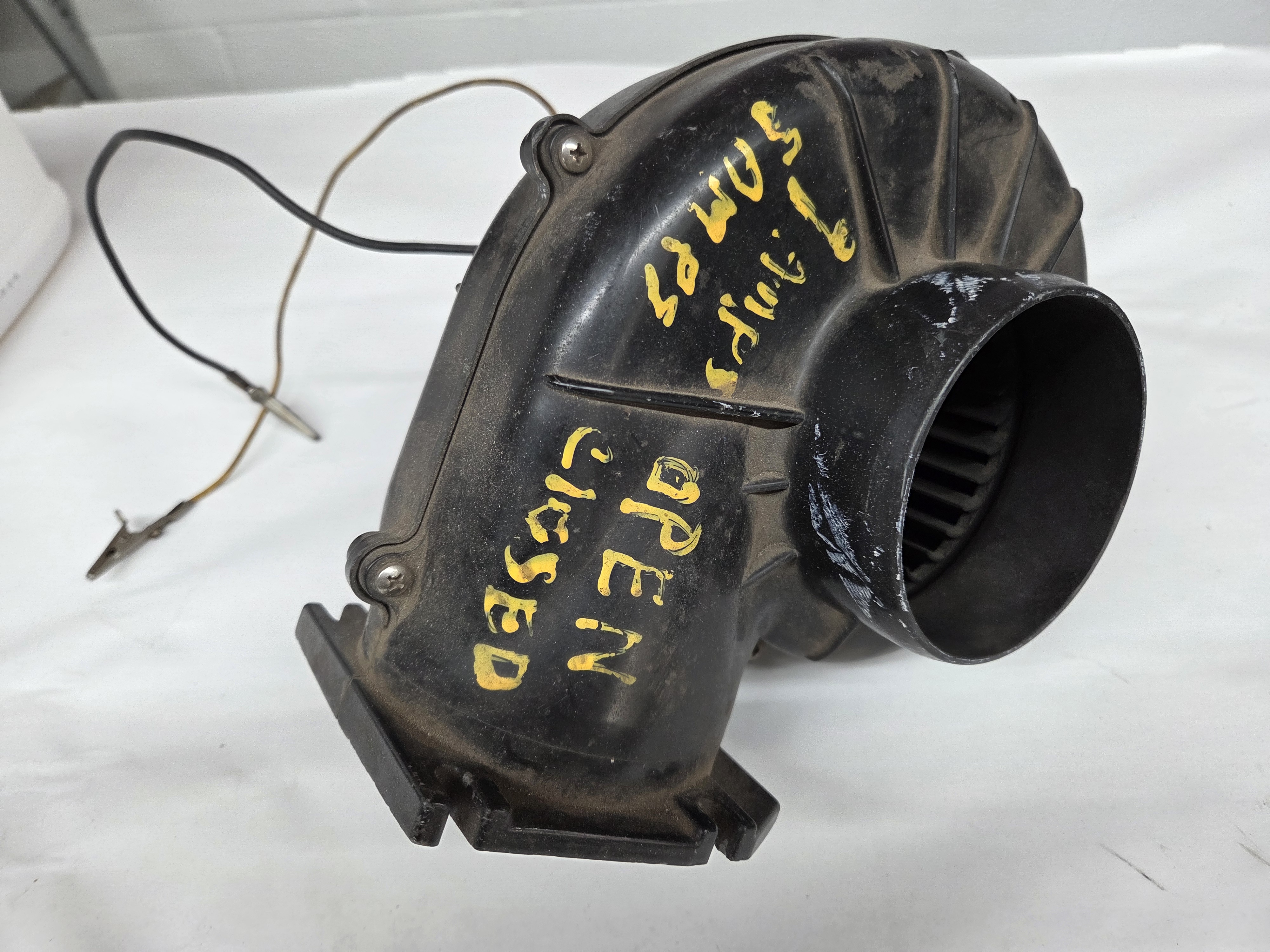

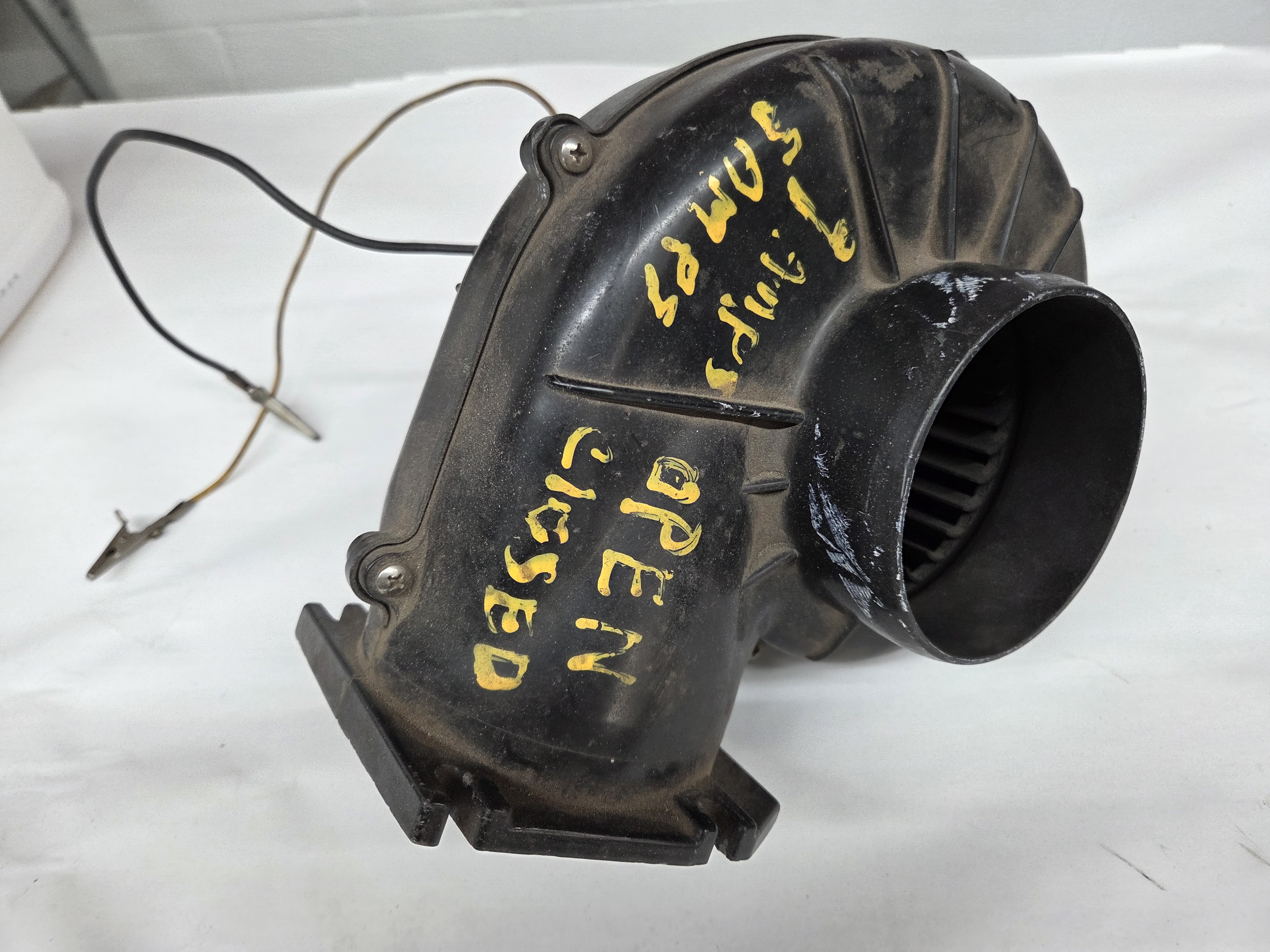

This is an old school tool I've used for many decades. It's a squirrel cage fan blower I use to test amperage capability of circuits- it draws about 9 amps when open and 5-6 amps when closed. Checking voltage is great but doesn't tell you if a circuit can support a load.  This does.

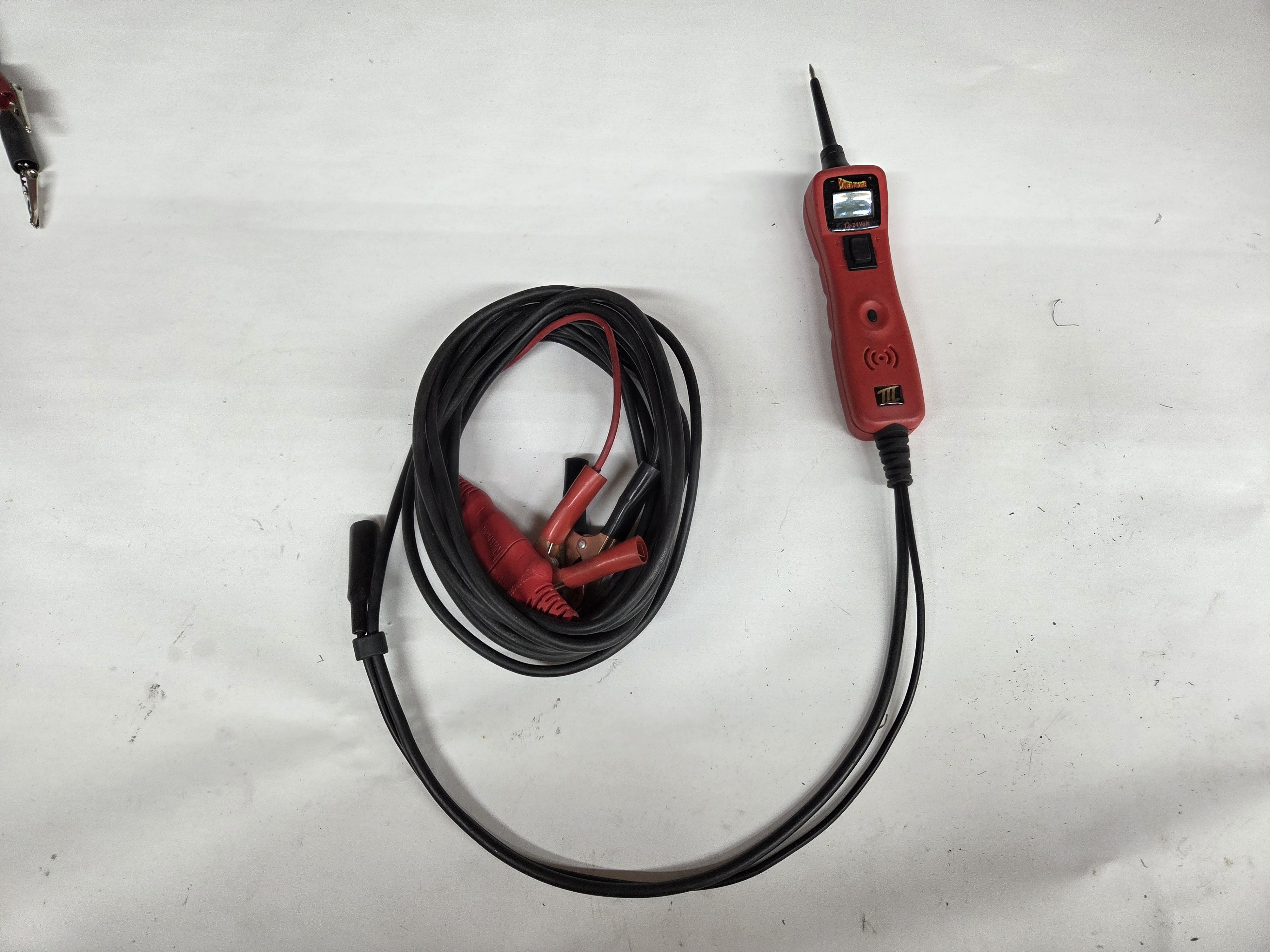

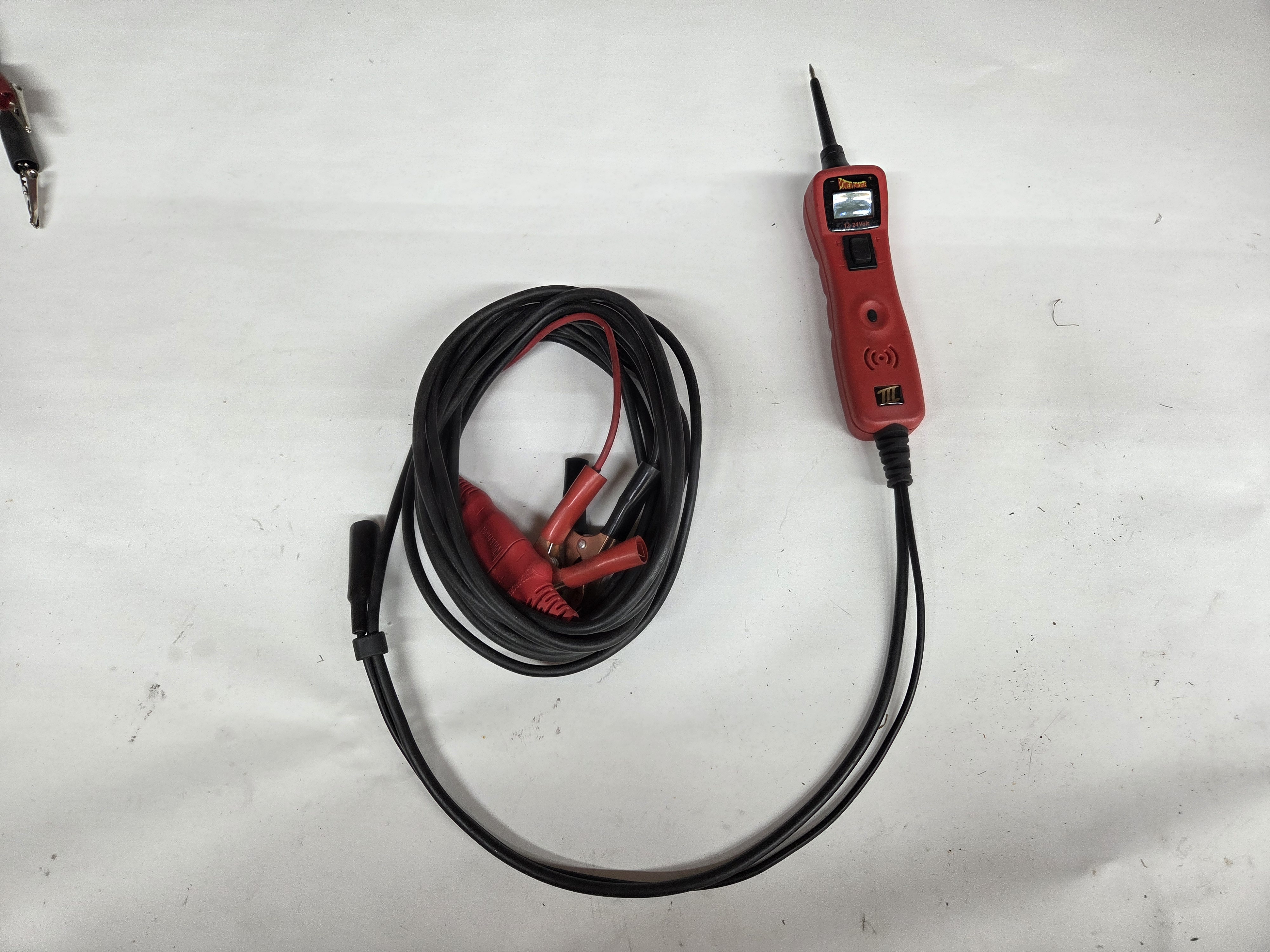

One of my favorite tools when doing electrical diagnostics, a Power Probe. It not only gives you the voltage of what you're probing, it tells you whether it's hot or ground, and also allows you to inject power or ground into a circuit. Very cool tool if you understand electricity but a WMD if you don't.

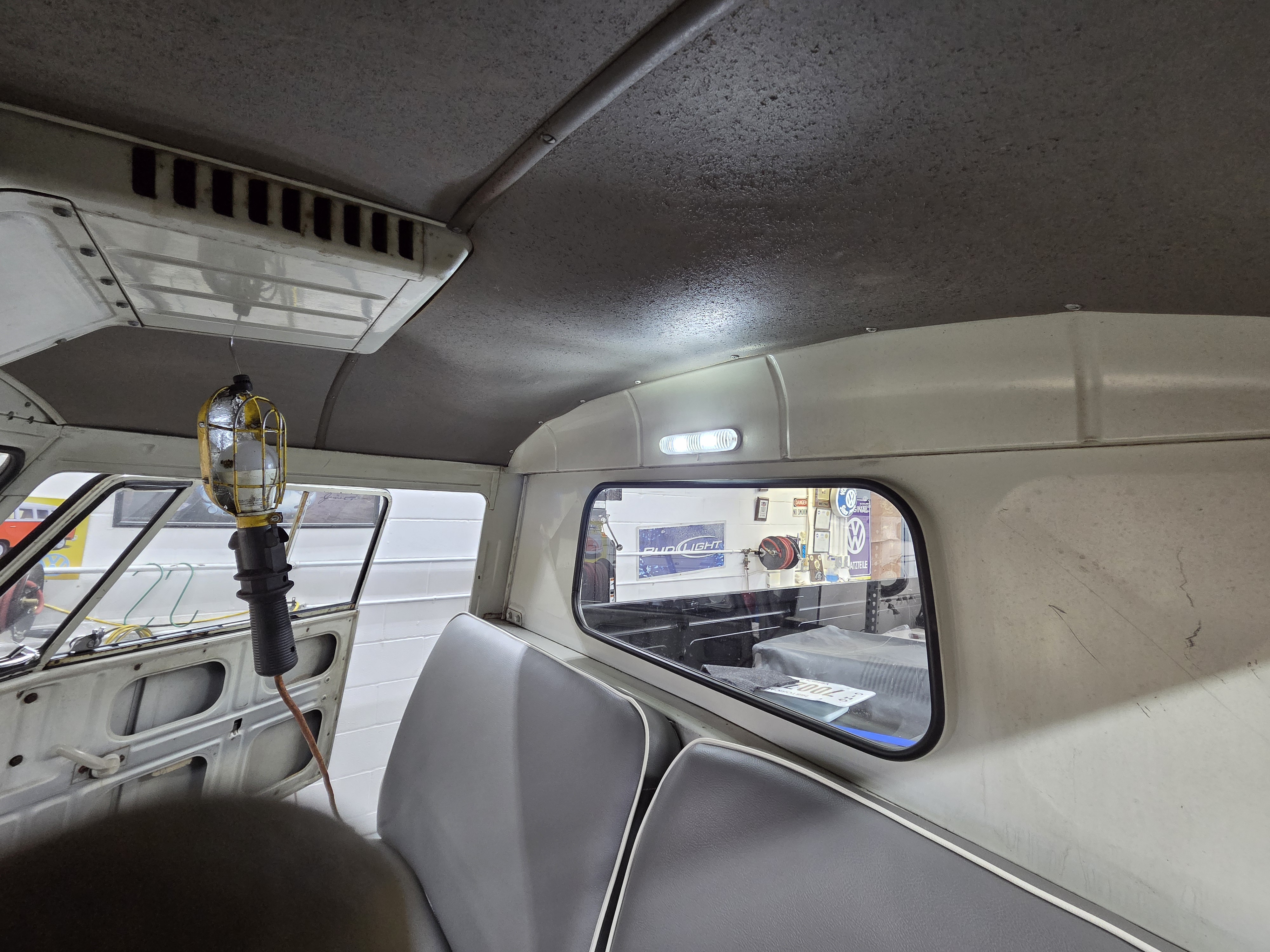

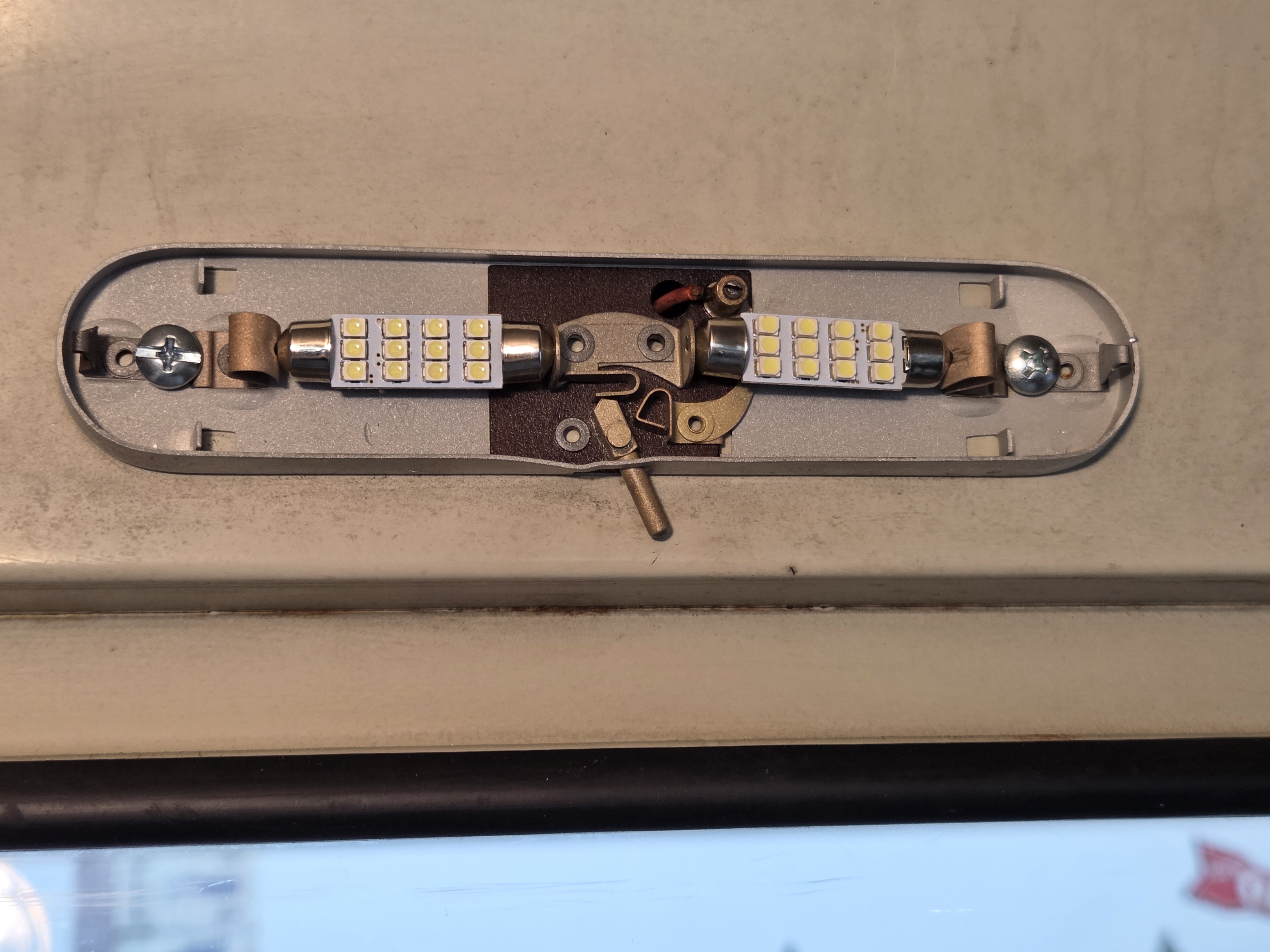

I removed and bead blasted the dome light housing, lubed the switch, installed LED bulbs and mounted it with new screws. These LEDs are also polarity sensitive, so if you reverse them they do not light. They draw .17a which is more than I thought they would. It would be fine to forget them overnight but math shows they would take over 500 hours to run the battery dead.

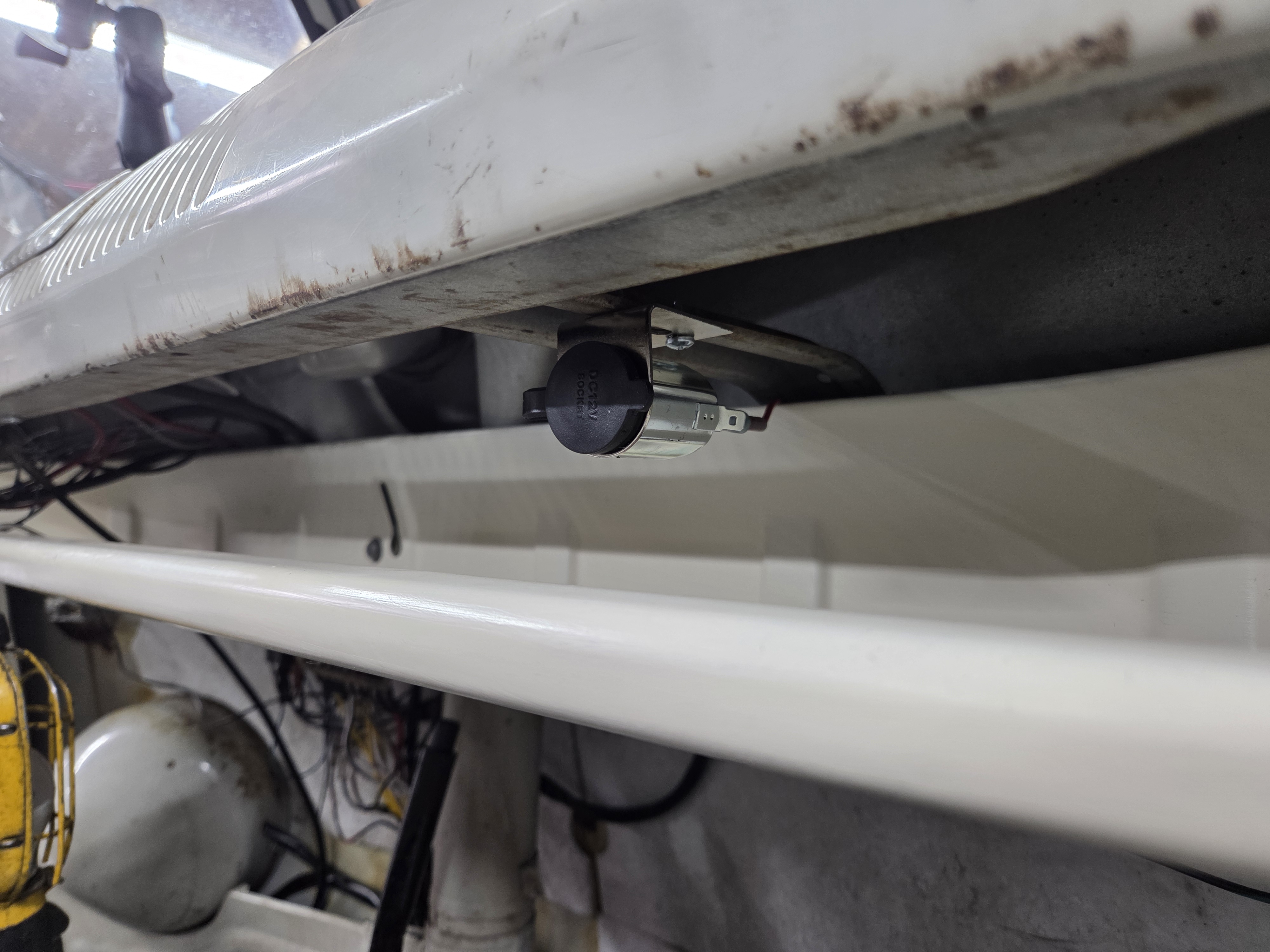

I installed a power port under the dash so she can charge her cell phone while driving, I always do this when changing a harness or doing major electrical work.
