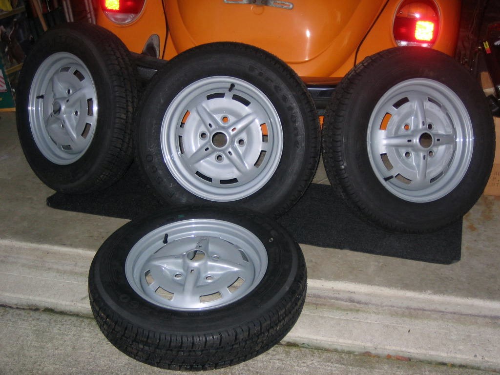

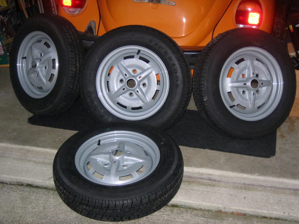

NEW FIRESTONE TIRES MOUNTED AND BALANCED READY TO GO WHEN THE CAR IS FINISHED.
