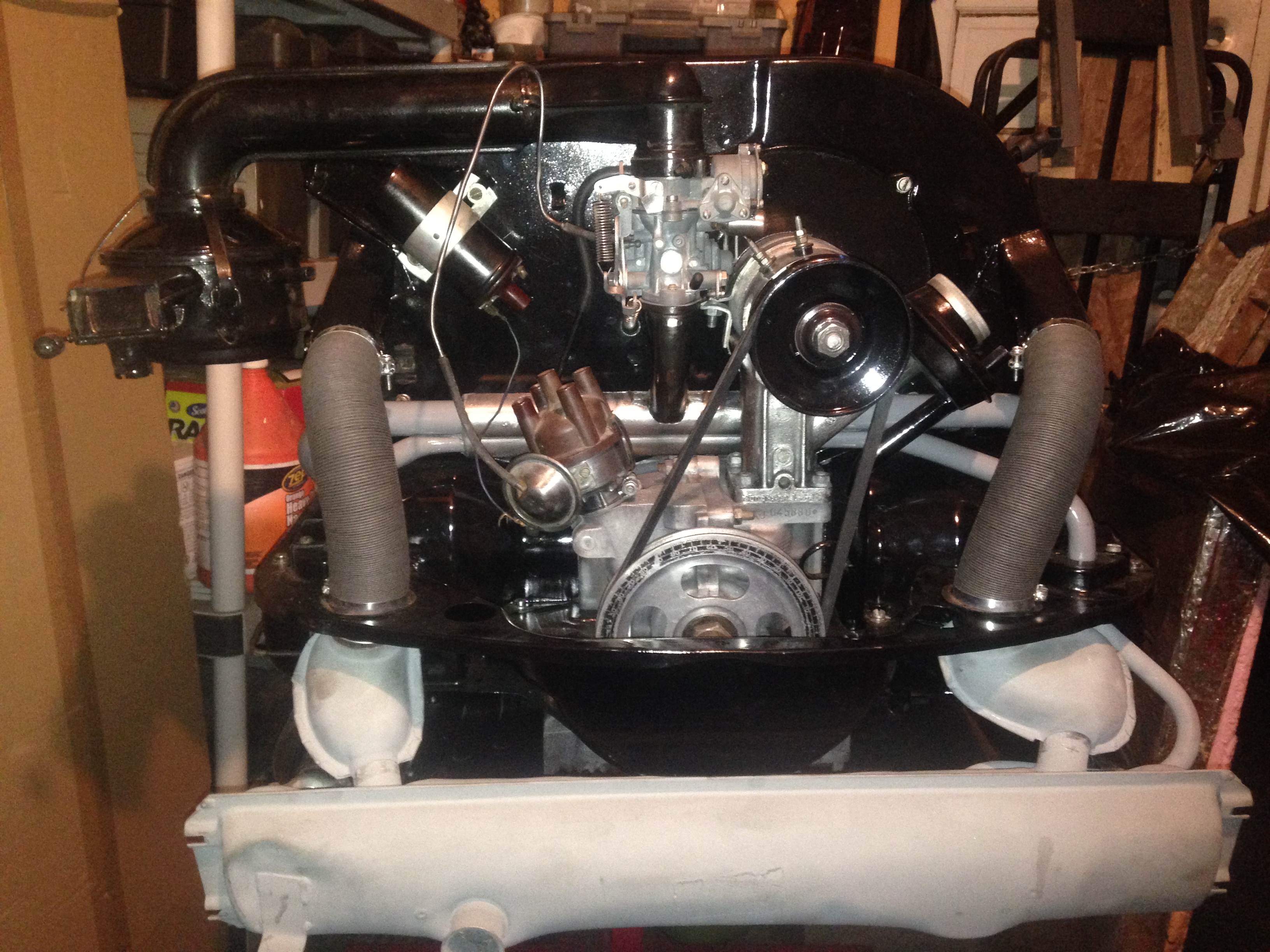

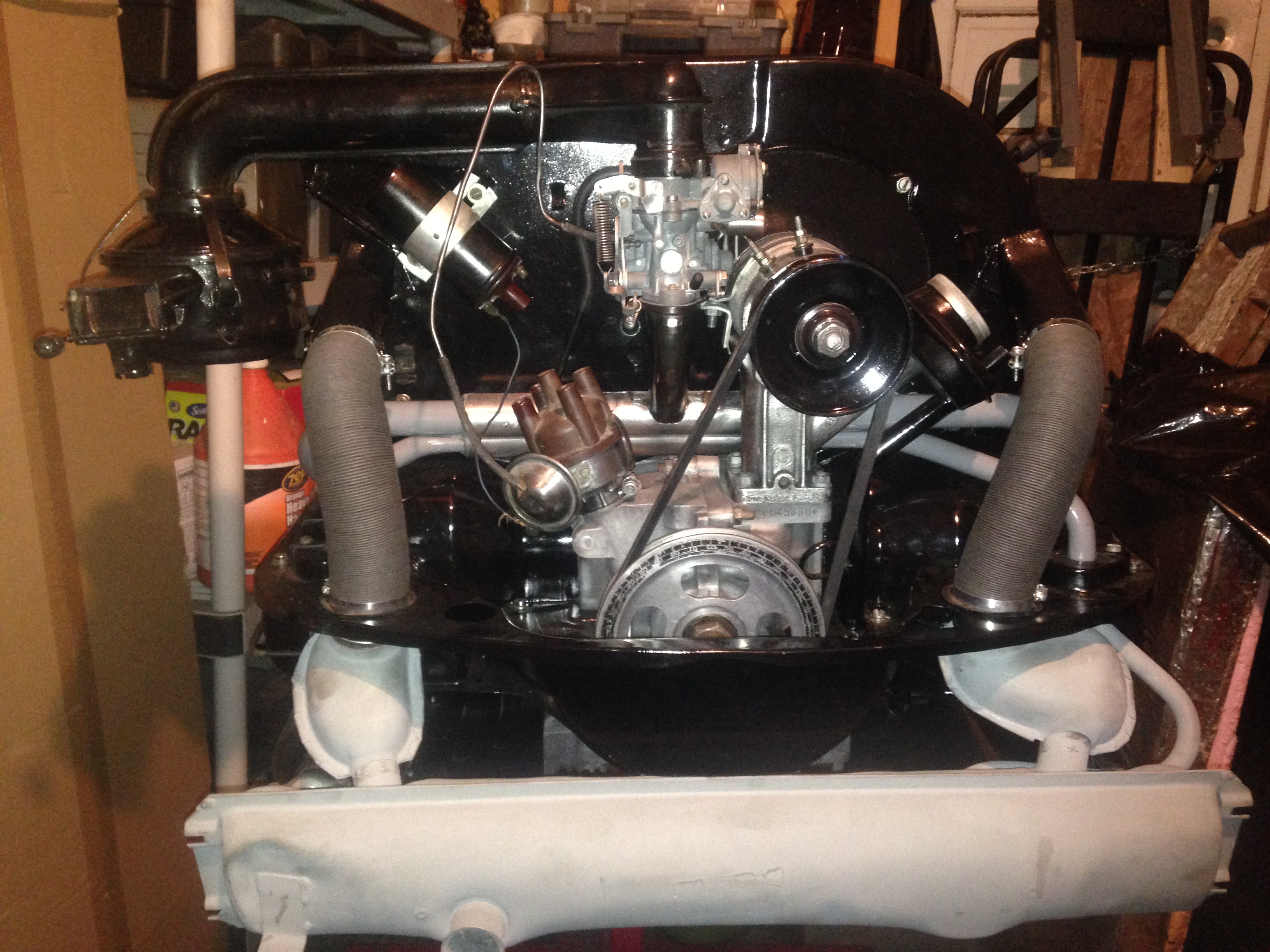

Plug wires, cap, condenser, points, rotor, and some hoses and this part is done.

Re: 1961 Microbus
Looks good!
Late FI case, so electric FP? Or gravity feed? :P
Check your TDC with a piston stop tool, the aluminum pulleys I've checked were nowhere near accurate, not even close.......
Re: 1961 Microbus
Dual Port wrote:Looks good!
Good tip.
Next arts and crafts project is a run stand. Anyone have a junk trans or bell housing?
Posts: 1390
Re: 1961 Microbus
I have trannies but none I want to cut up. Don't make a run stand, it takes up too much real estate while being stored. A chunk of bell for a run adapter is all you need, I cut this with a Sawzall:
Get a 2 gallon outboard motor fuel tank and a battery and you're in business.

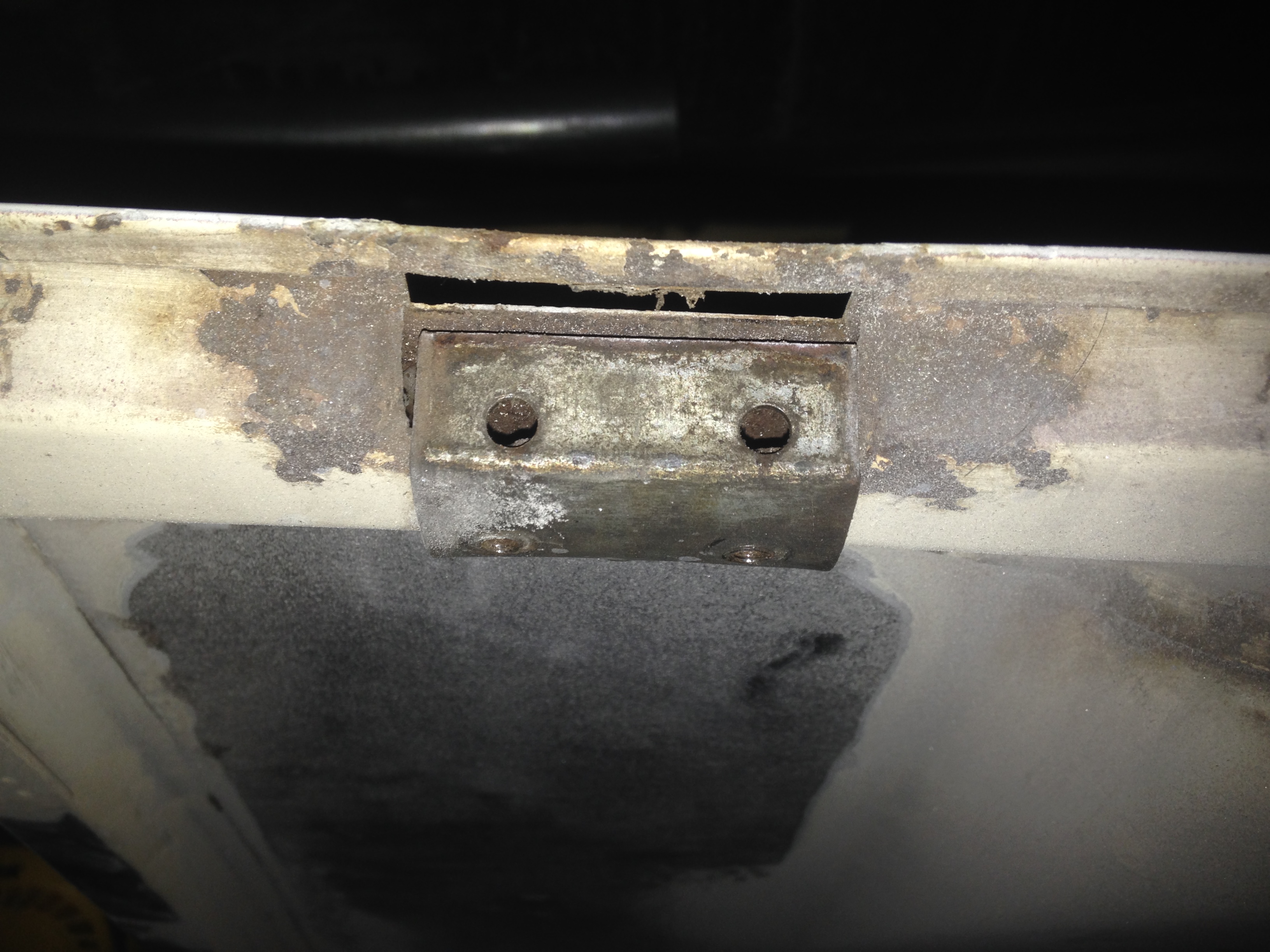

Still at it

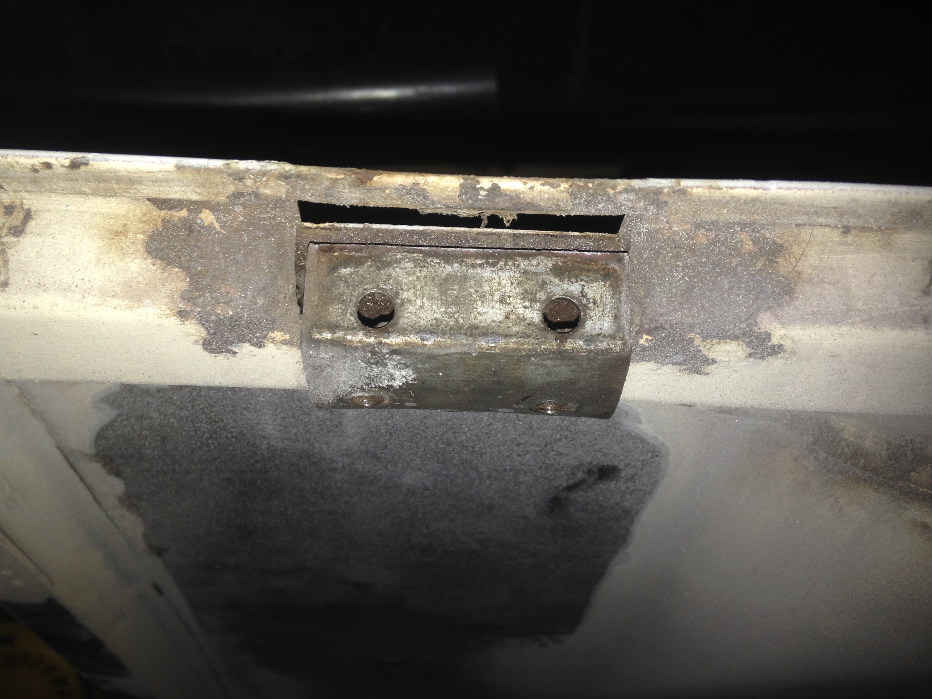

1
Started with this piece of bent metal screwed to hinge

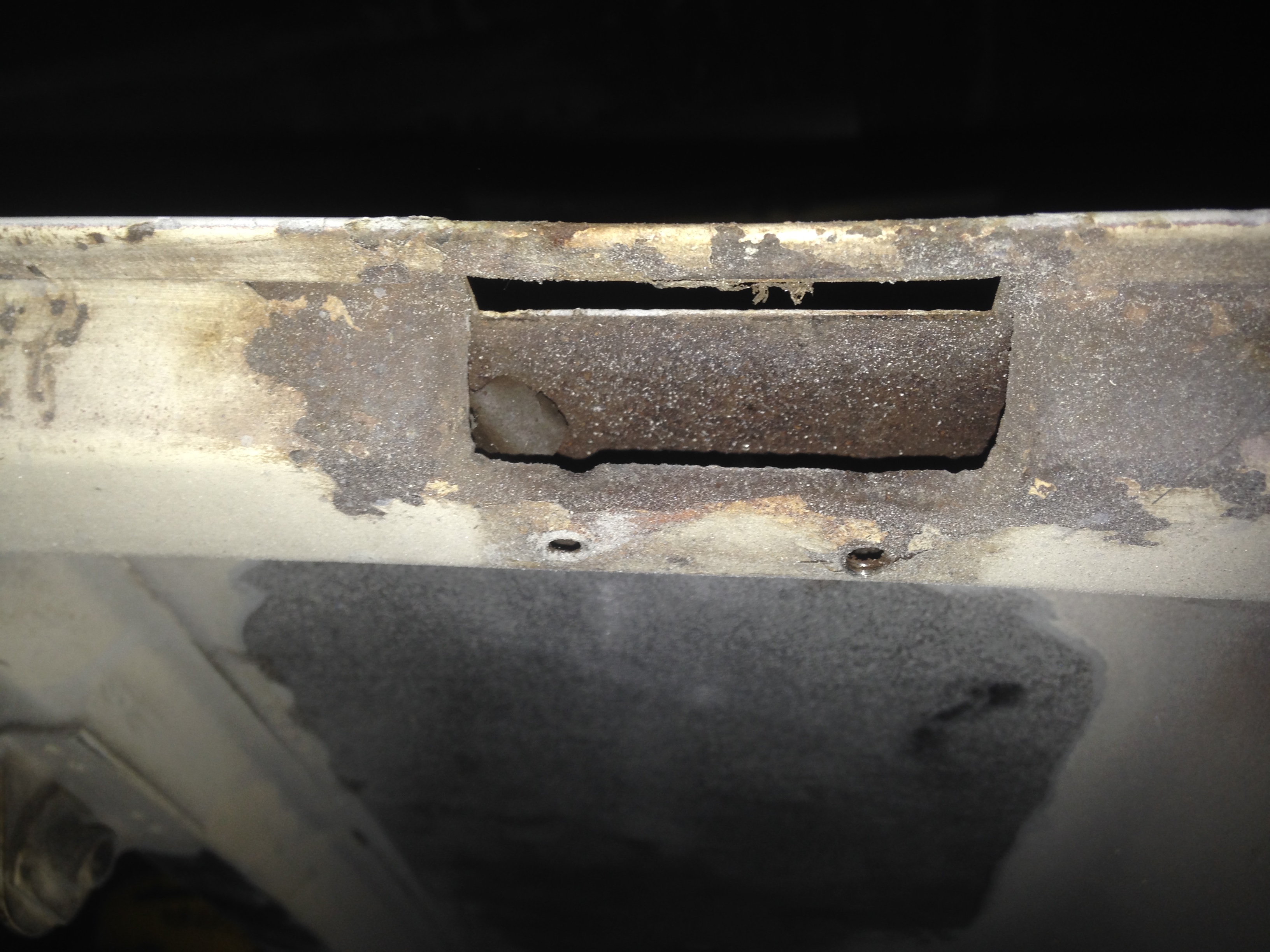

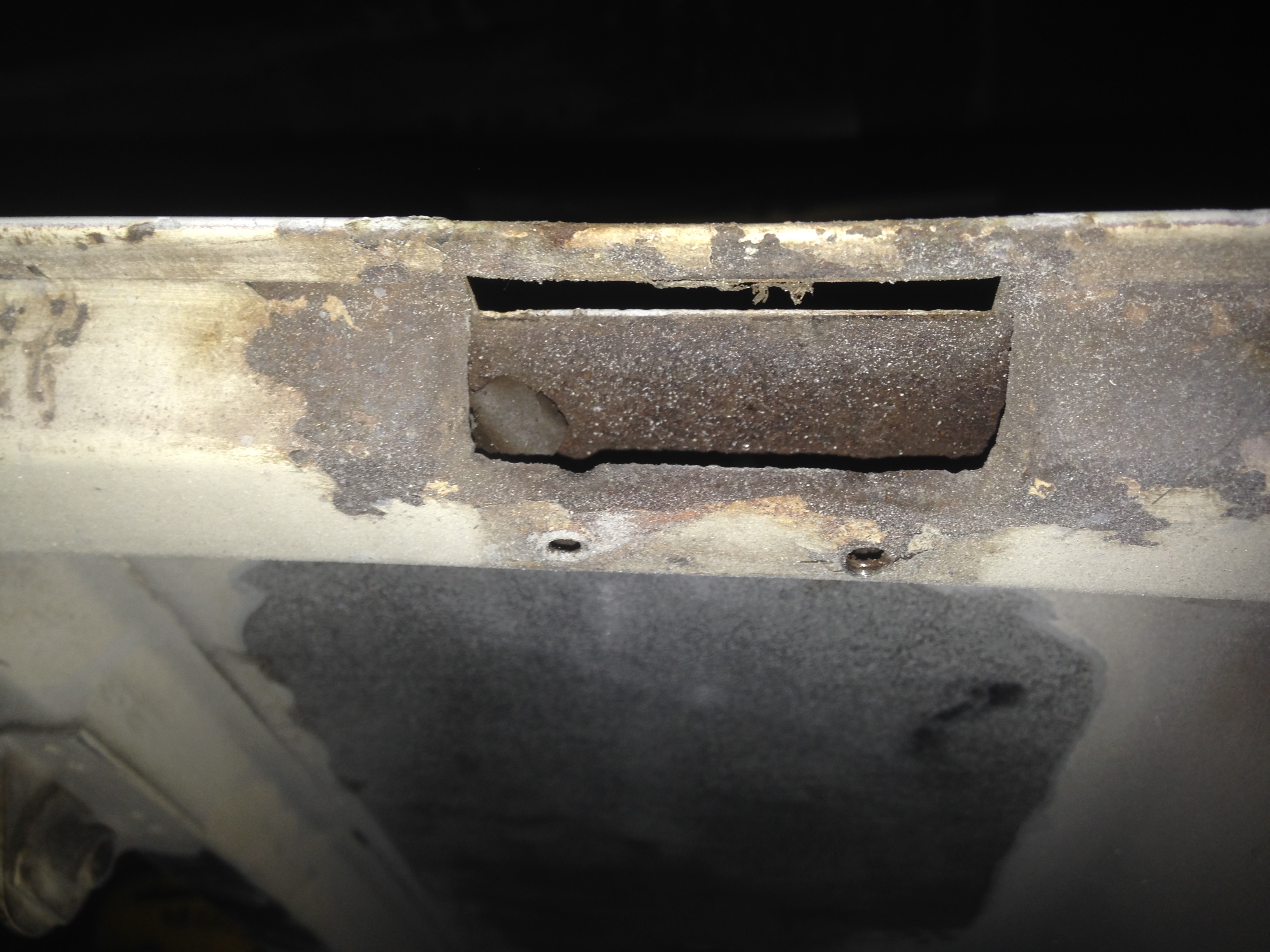

2
Missing piece of og metal

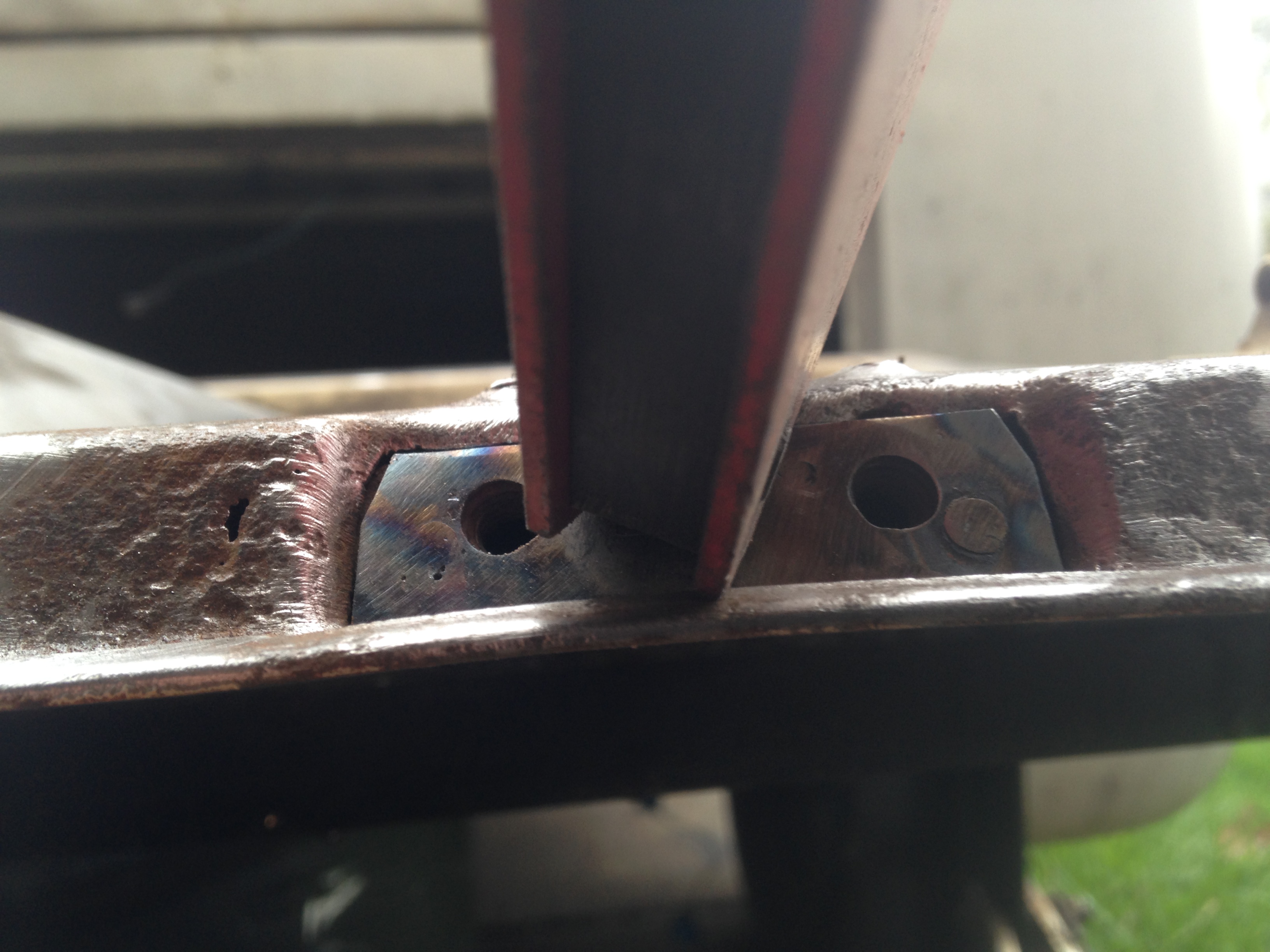

4
Welded in
Welded in

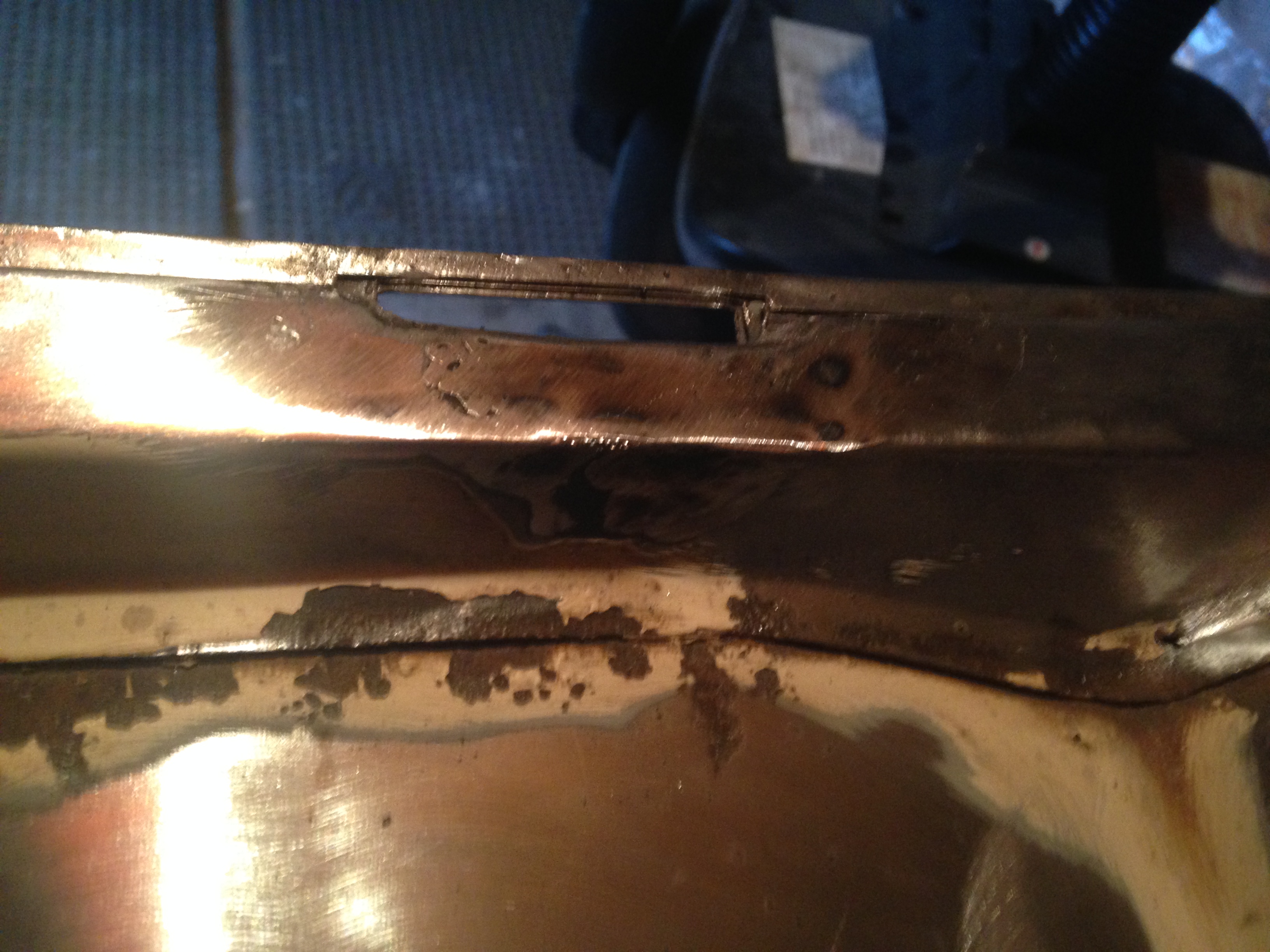

5

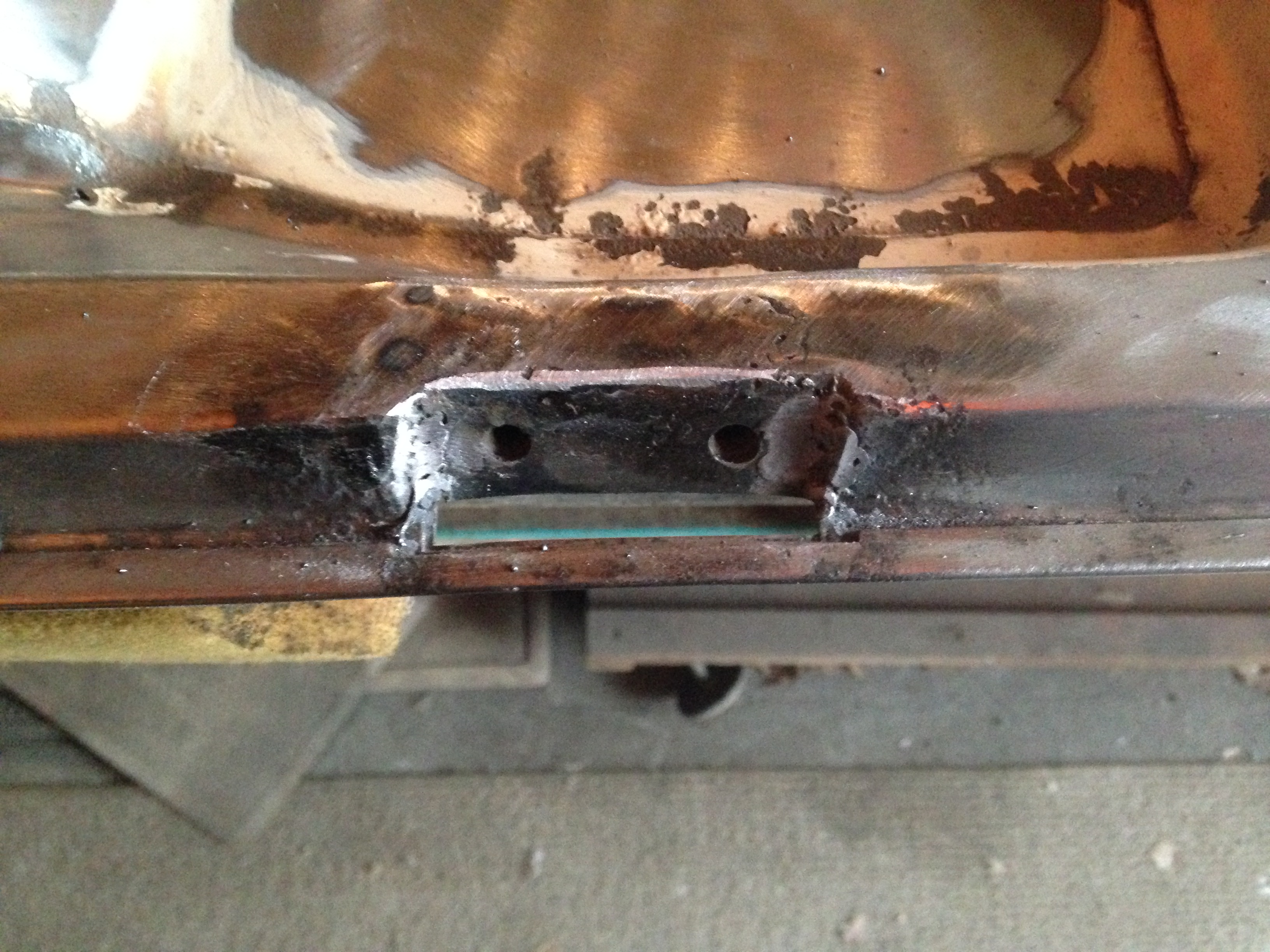

Some duraglass and it's a wrap
