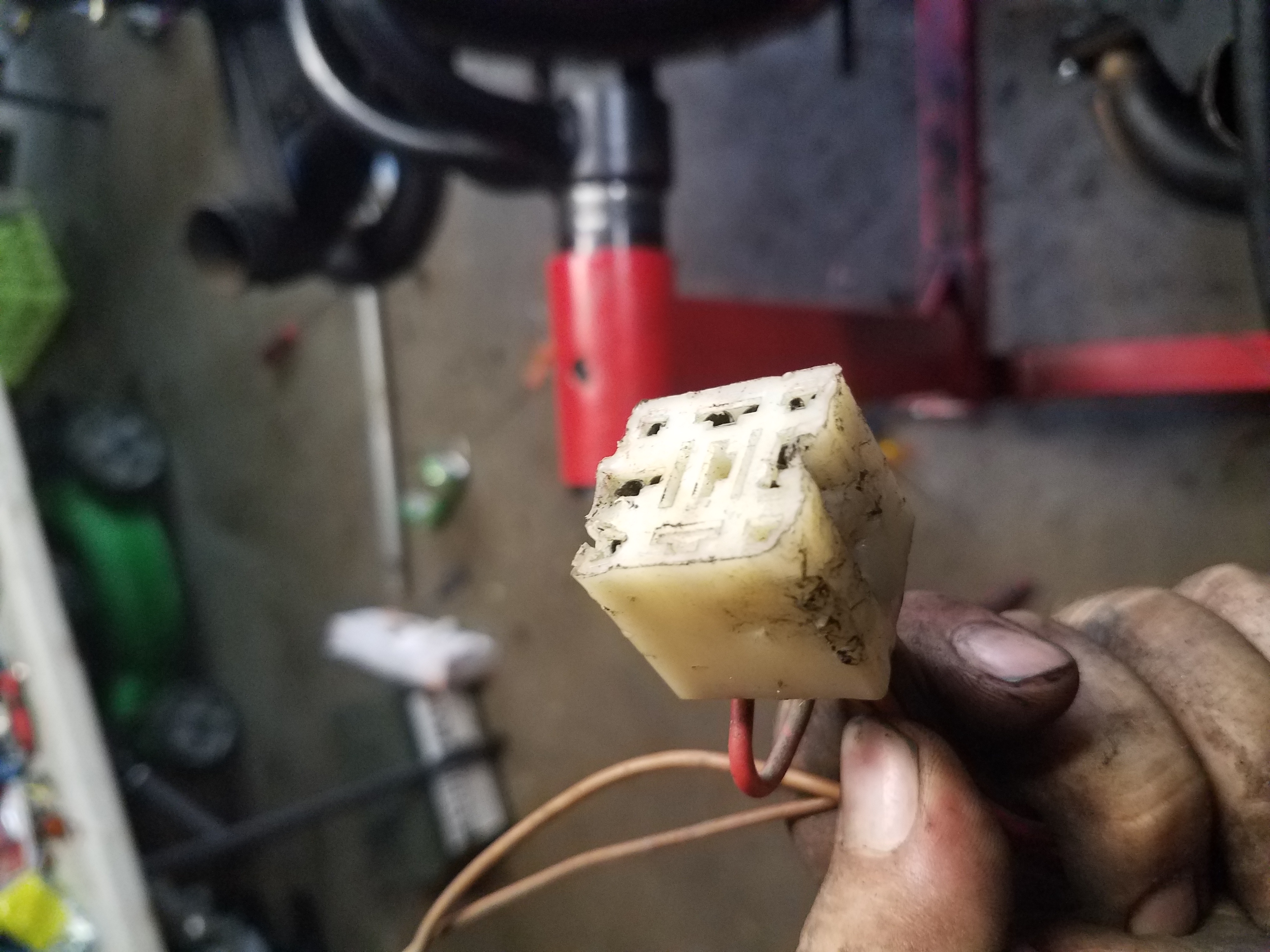

Mainly this plug. It is on the harness that connects the double relay to the starter, reverse light switches, etc.

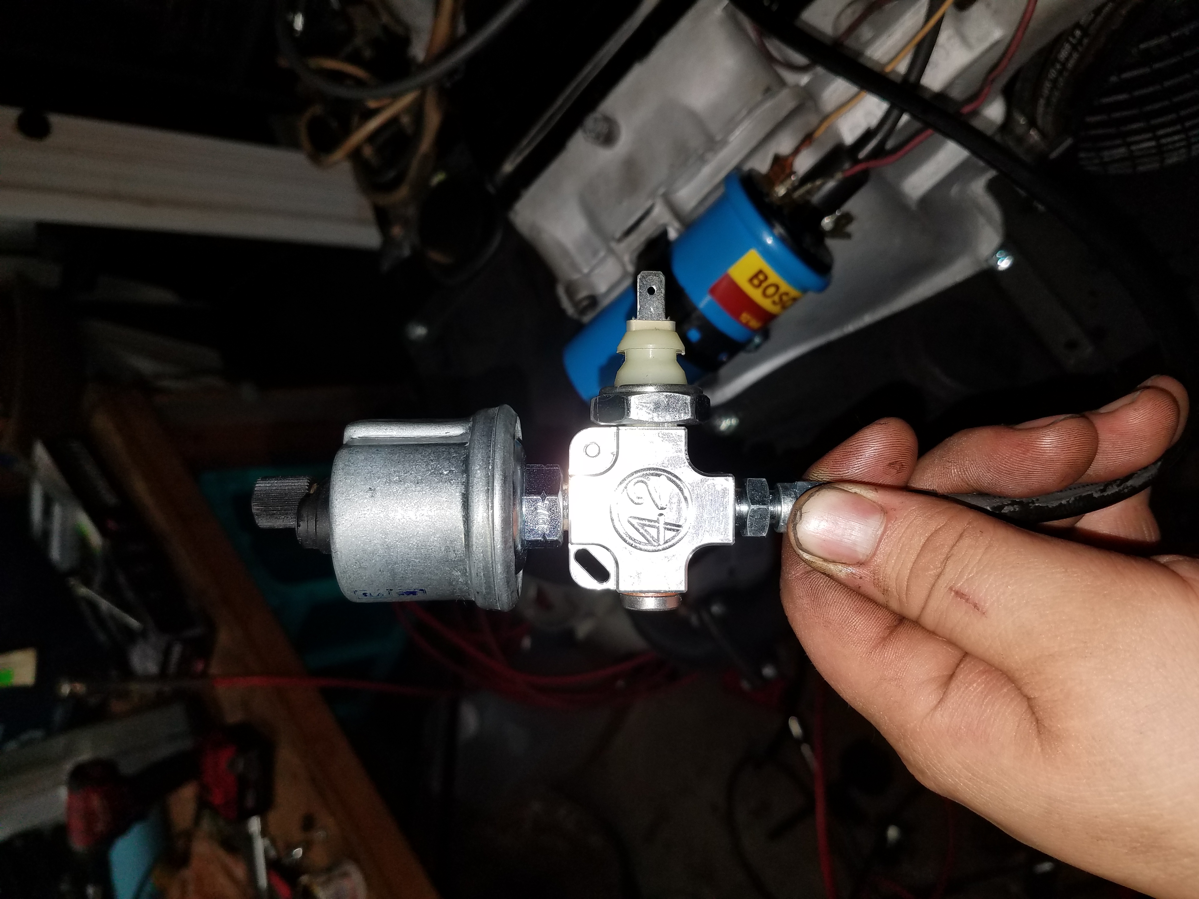

Dakota digital sender and original oil pressure switch on a tee for remote mounting on the firewall.

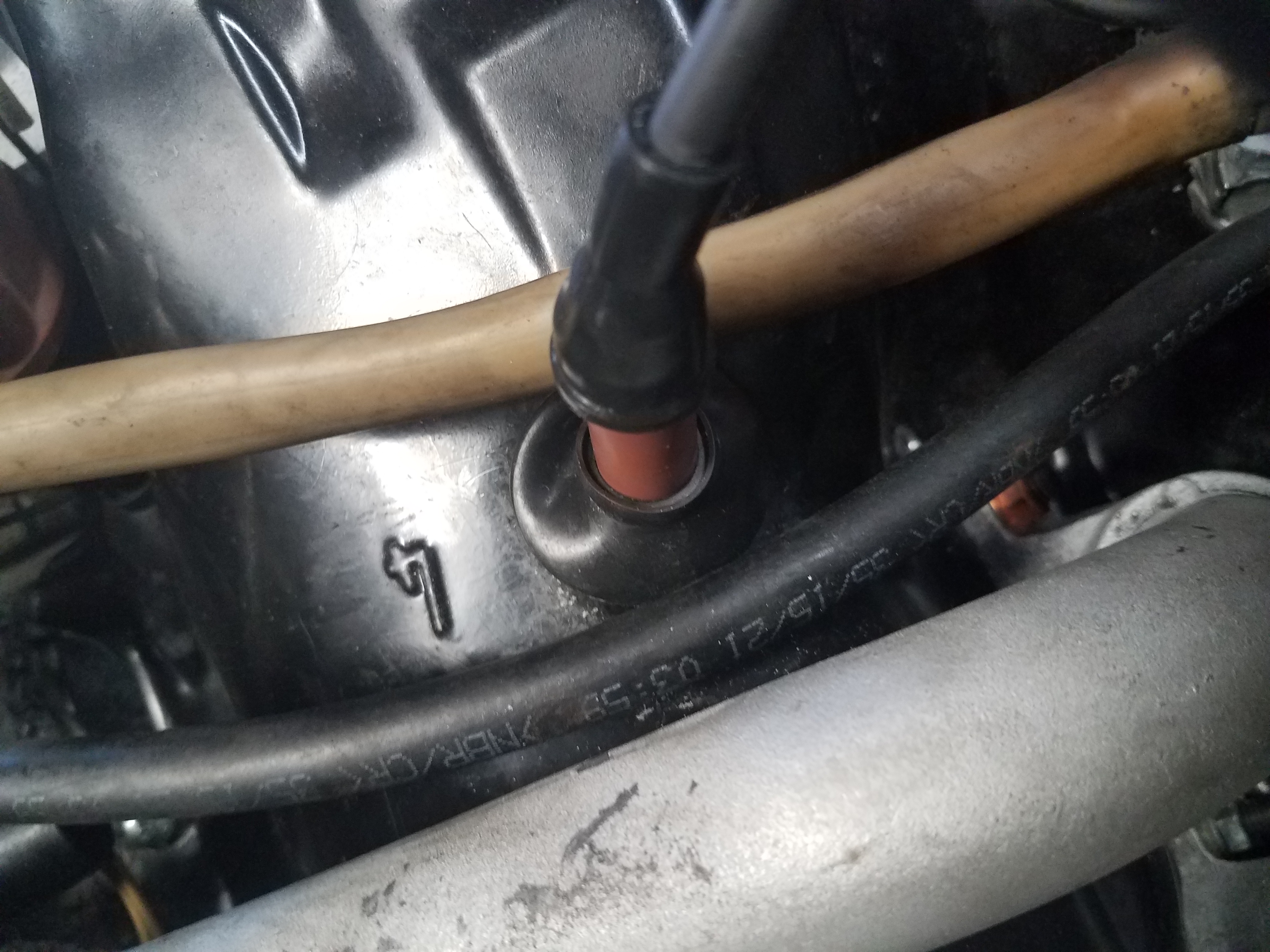

Cut the boots off my spark plugs and replaced them with these. a much better fit. also used one on the oil pressure switch. $10 for 5 of them, they are tie rod boots for a 58-84 FJ40

That relay plug has seen better days but if it still has the spades in good shape then it should be fine. If it was cracked or something then that would be a problem. Almost there!

The spades are pretty bent up
The spade connectors can be extracted. New ones installed on the wire and re inserted. Best to do them one at a time.

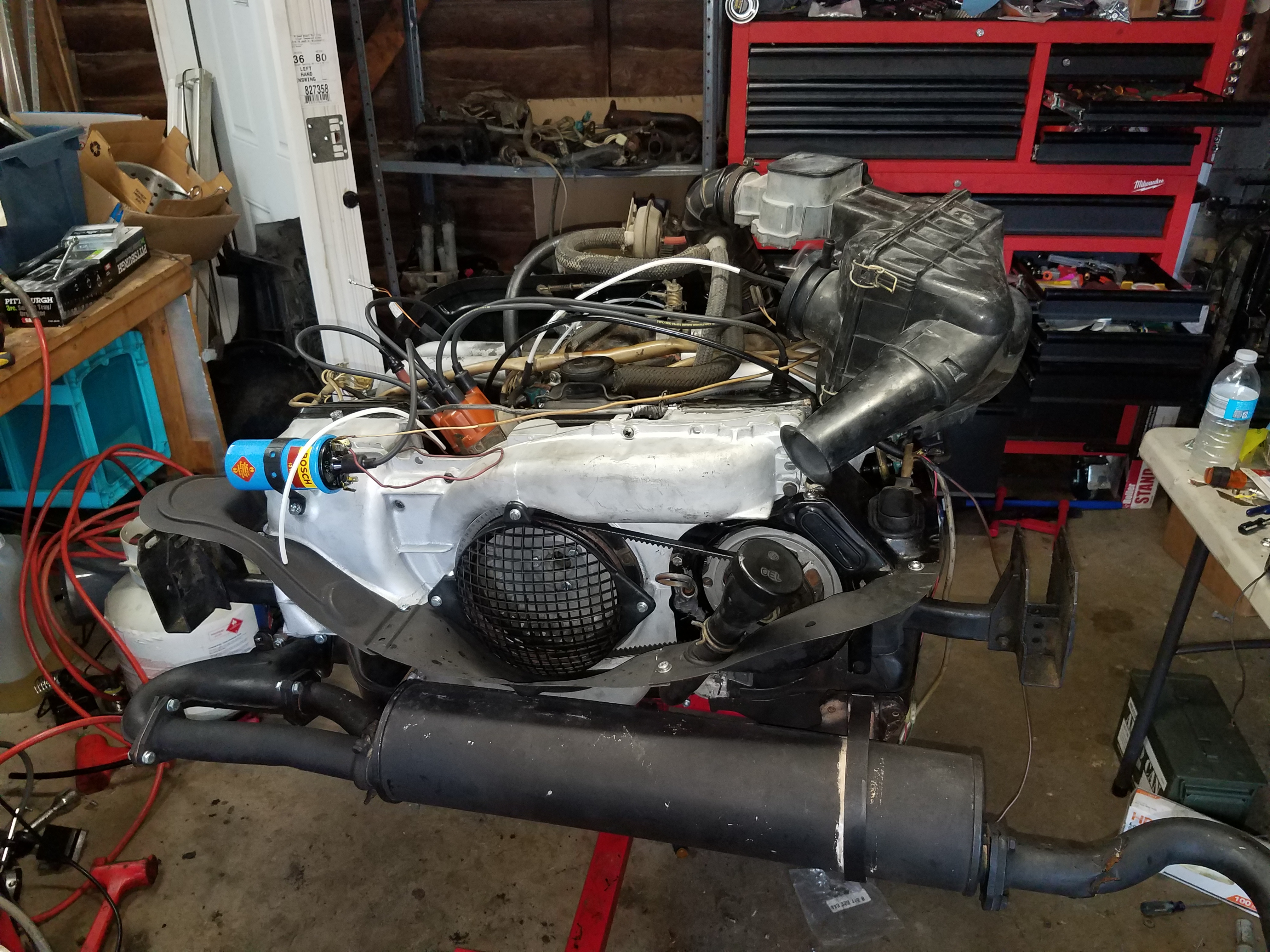

The diaphragm in the air cleaner wasn't holding a vacuum (EEC diaphragm I think its called?)
I pulled it apart and found a tear in the rubber. I put some permatex over it to seal the rubber. If it doesn't hold I guess I'll plug that vacuum line? It is my understanding that it the only downside to that may be a gas or exhaust smell.
Kooper271
Posts: 197
Post by Kooper271 »
The permatex "fix" didn't work.
When I reinstalled the distributor drive gear, I installed it the same way it came out - never loosened the clamp. Turns out whoever had it out last had it installed 180° off. So I pulled the pinion and reinstalled it correctly orientated. I also installed a Pertronix points replacement module, a new cap and a new rotor.
I removed the transaxle from the bus and cleaned the 1/2" thick coating of oil and dirt off it. It needs new bellhousing and nosecone gaskets, along with new final drive seals. The plastic ball inside the nosecone isn't in good condition either so I ordered a metal one from Weddle Industries.
Inside the nosecone, I couldn't find a 001 301 227D seal. I found a seal with the correct dimensions on Rockauto. Per ratwell, the dimensions should be 15x24x7. Hopefully that works.http://www.rockauto.com/en/moreinfo.php?pk=253301&jsn=3
I'm going to use #2 wire to replace the battery ground strap as well as the cable from the + side of the battery to the starter. Mine were in very poor condition.
New clutch and accelerator cables going in soon. The clutch cable is stretched (maybe from acting as a ground?) and I figure now is a good time to replace the accelerator cable. I have new shift rod bushings to replace the worn ones.
