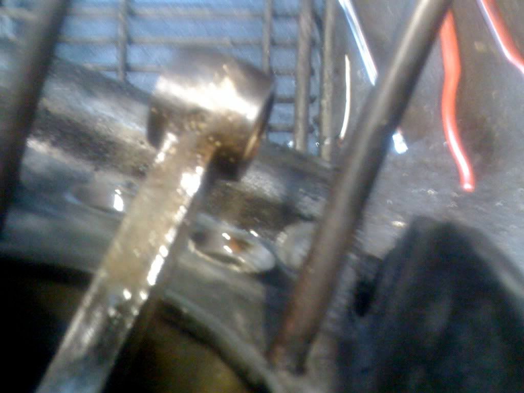

We did run into a few problems. Here's where it helps to have a knowledgeable veteran around when putting these things back together. In checking the rod bushings where the wrist pins connect the piston, Dale noticed the oil hole on the piston was blocked by the bushing. As a rookie, I would have missed this detail. Apparently the PO installed the busing wrong and blocked the hole.
Dale took care of it and fixed it. Amazing that the rod didn't seize from that oversight over the life of the motor! Crappy cell pics, but here you go.

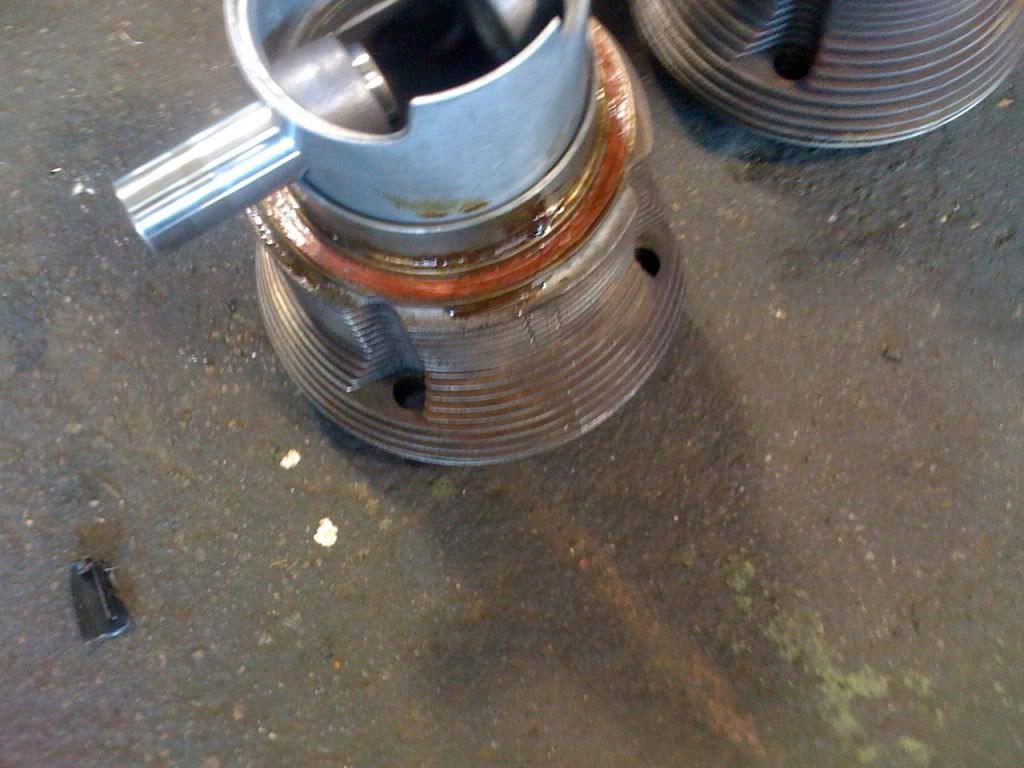

Got the paper gaskets on the juggs with aviation permatex.

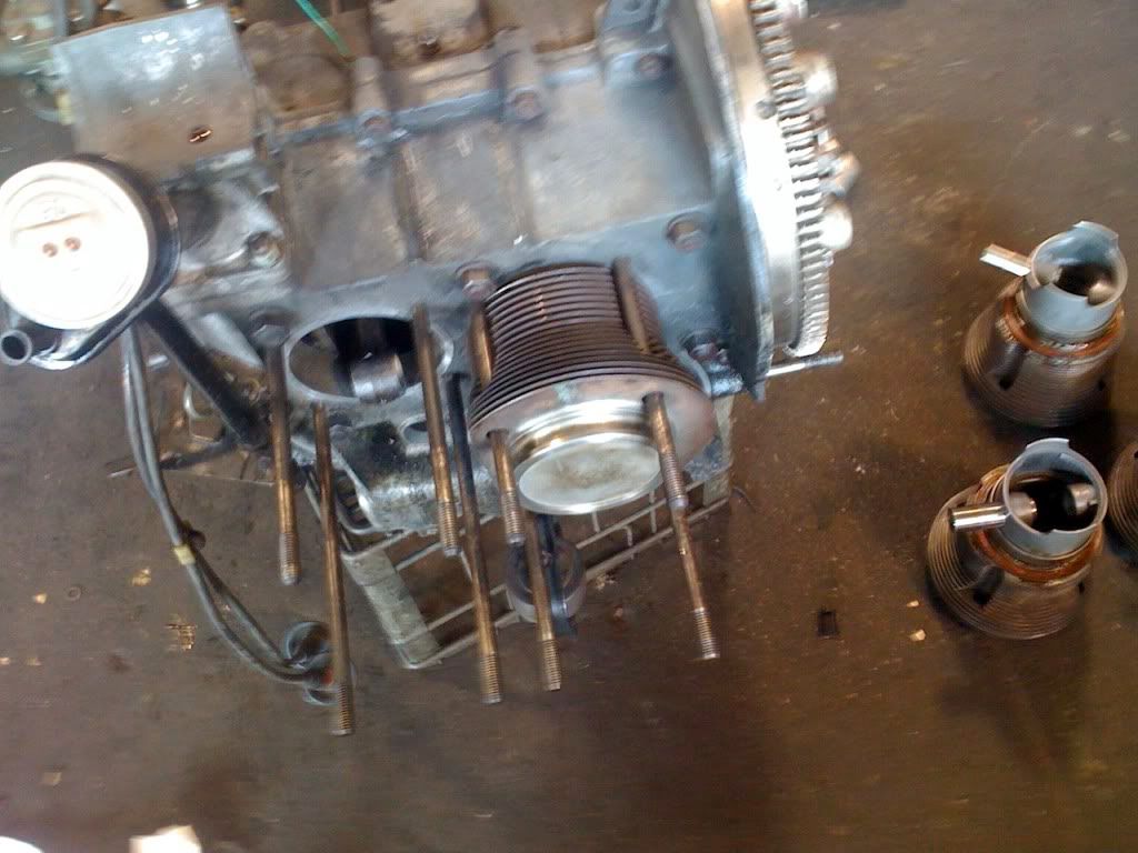

Had to mess with the studs that screwed out of the case but we got all four cylinders and pistons on...
Then we ran into our real problem. The pushrod tubes didn't fit. TOO BIG! That kind of ended the day. We were just getting ready to put the heads on and torque them down and clearly the pushrod tubes didn't fit. Too long. Oh well. That's life.
Just like with pulleys, there are pushrod tubes for 36 HP, others for 40 HP and still others for 1300-1600 motors. Such is life!
