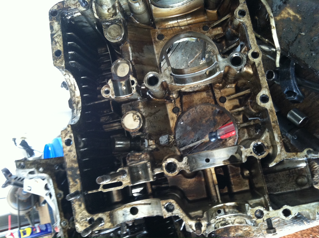

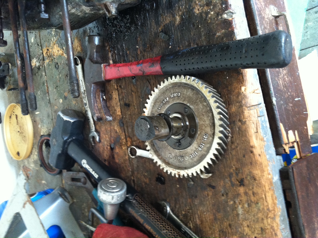

Well
It's RIP for this engine.
Cam is broken.
Lifter socket destroyed
Finger sized hole just below the lifter.
What a drag.
Moving forward what do you think the chances are of finding half a case?
Posts: 788
Re: My New Project
That looks painful.
Case halves are machined for one another. Sourcing a case half is not the best of ideas because they won't match up very well. I can ask if the 3 or so T4 cases are still around at the aircooled shop out here in Omaha that went out of business and get a price if you want.
Please don't toss the case though, I may be able to find a secondary decorative use for it when I'm east again.
Edit: I just sent you a text message. The T4 cases are $100ea and should be good. The guy taking care of the final closing can still ship and take credit cards.
