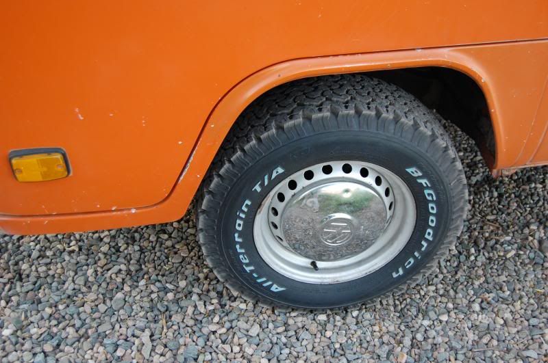

tire hunt is over.
BF Goodrich All Terrain T/A K/O 195/75/14
now I need to find lifted spindles (that aren't going to cost more than the bus...) and figure out how I am lifting the back
I don't want to take it too much higher, maybe an inch, so spindles might need to be made
would I be able to just adjust the spring plates on the torsion rod in the back to get that, or is that too much?
would adjusters in the front allow that comfortably?
