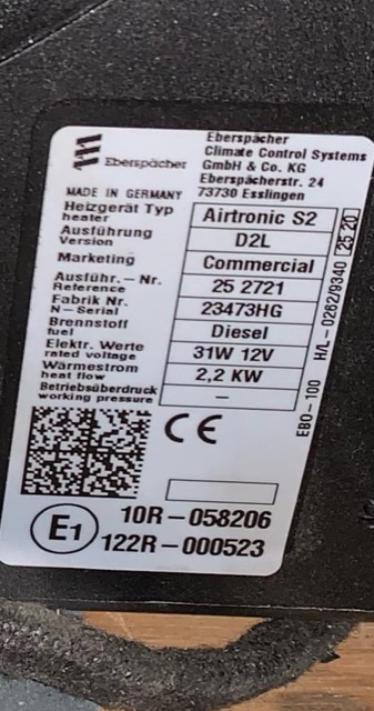

The Eberspaecher is the quietest one out of them all. Buy the smallest one you can get (Eber)
The diesel is so economical I wouldn't worry about lugging extra fuel with you just fill it up before you roll and be happy.
Are you planning on running an auxiliary battery? I run a deep cycle aux battery with a relay so the alternator keeps it charged when running. I also have my bus equipped with shore power (boat terms go figure) and a ProMax on board charger to keep both batteries charged when my bus is plugged in.
I wonder how many fools like me have a lowered bus with diesel heat?
- Attachments
- eber5.jpg (72.93 KiB) Viewed 16739 times
- eber4.jpg (61.84 KiB) Viewed 16740 times
- eber3.jpg (47 KiB) Viewed 16740 times
- eber2.jpg (65.88 KiB) Viewed 16740 times
