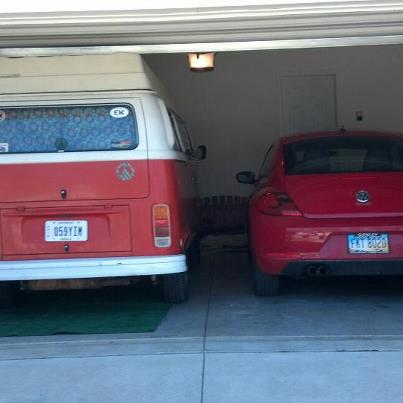

Loaded in Matt's delivery station wagon, on it's way to Lisa's bus.

AMAZING!!!! You're the best :D THANK YOU THANK YOU THANK YOU :D
And she is right where she belongs :P
