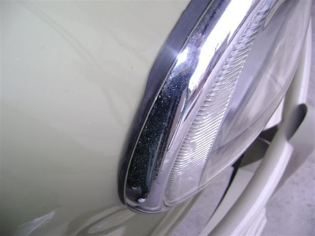

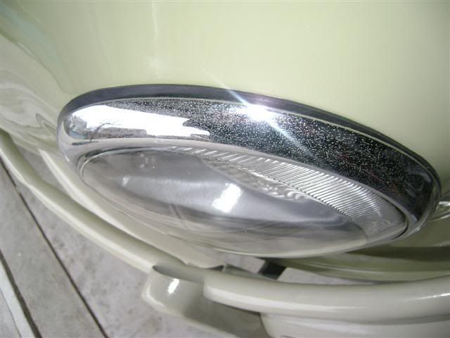

Have you installed the headlights yet? I think you have the housing to body seal in wrong. I just redid mine the other day and installed the seal with the top of the "T" facing the body. It was the only way the housings would fit.

I think you're right on the headlight body seals. It seems wrong to have the "t" on the rubber facing out, (that is, top of the "t" on the body), but I think that's what prevents what you see in the second photo below. I got away with the stem of the "t" being "inside" in the first photo showing the driver's front light, but you can see how the rubber buckles on the passanger side in the second photo. Once again Ted, you're the man! I appreciate the little 'split' lessons I'm getting. Makes it a lot easier to get this thing finished!
