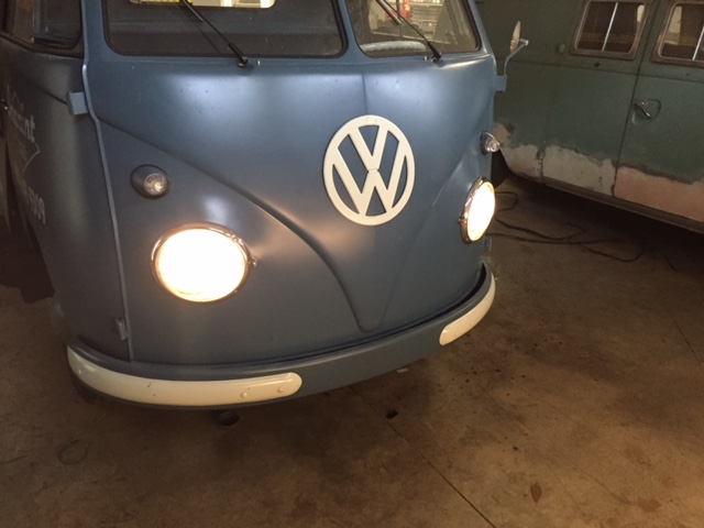

Looks Great Craig! What kind of headlights did you decide to go with?

Re: Craig's '58 SC
macaia8475 wrote:Looks Great Craig! What kind of headlights did you decide to go with?
Buy this kit and you will be happy. Add relays and it will be even better.
Re: Craig's '58 SC
I went with the H4's when it was a 6V which was a huge improvement.
Now its unreal how bright they are with the 12V and new wiring...

Re: Craig's '58 SC
I followed Teds advice with the relays on my 58'. http://www.leakoil.net/forum/viewtopic. ... +58#p12831

Read words here: http://www.danielsternlighting.com/tech ... elays.html
The most important thing on a bus is to add good grounds. Your current headlight wiring is sufficient to handle the current. I pulled power off the main feed to the fuse block to supply the relays.
