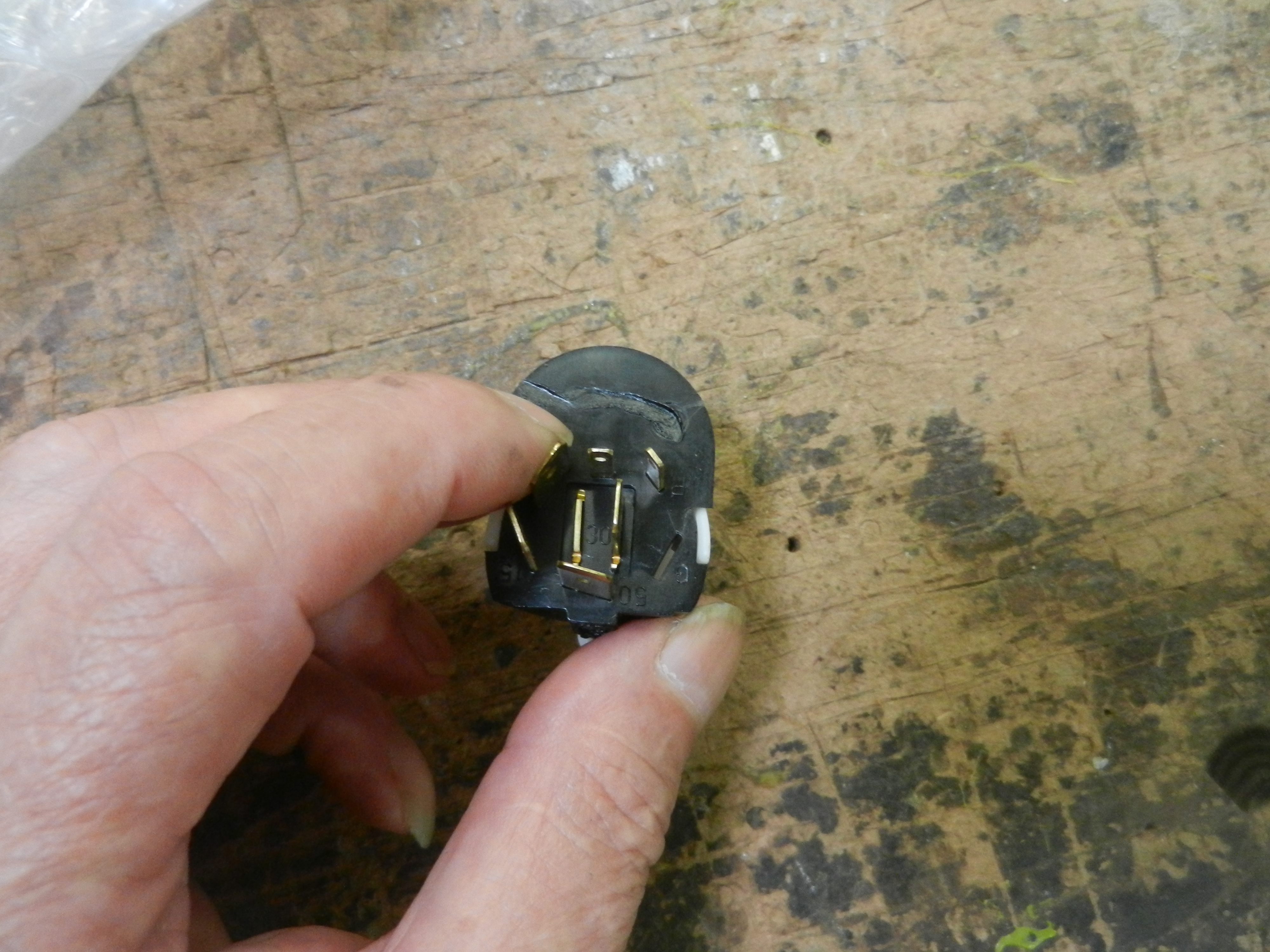

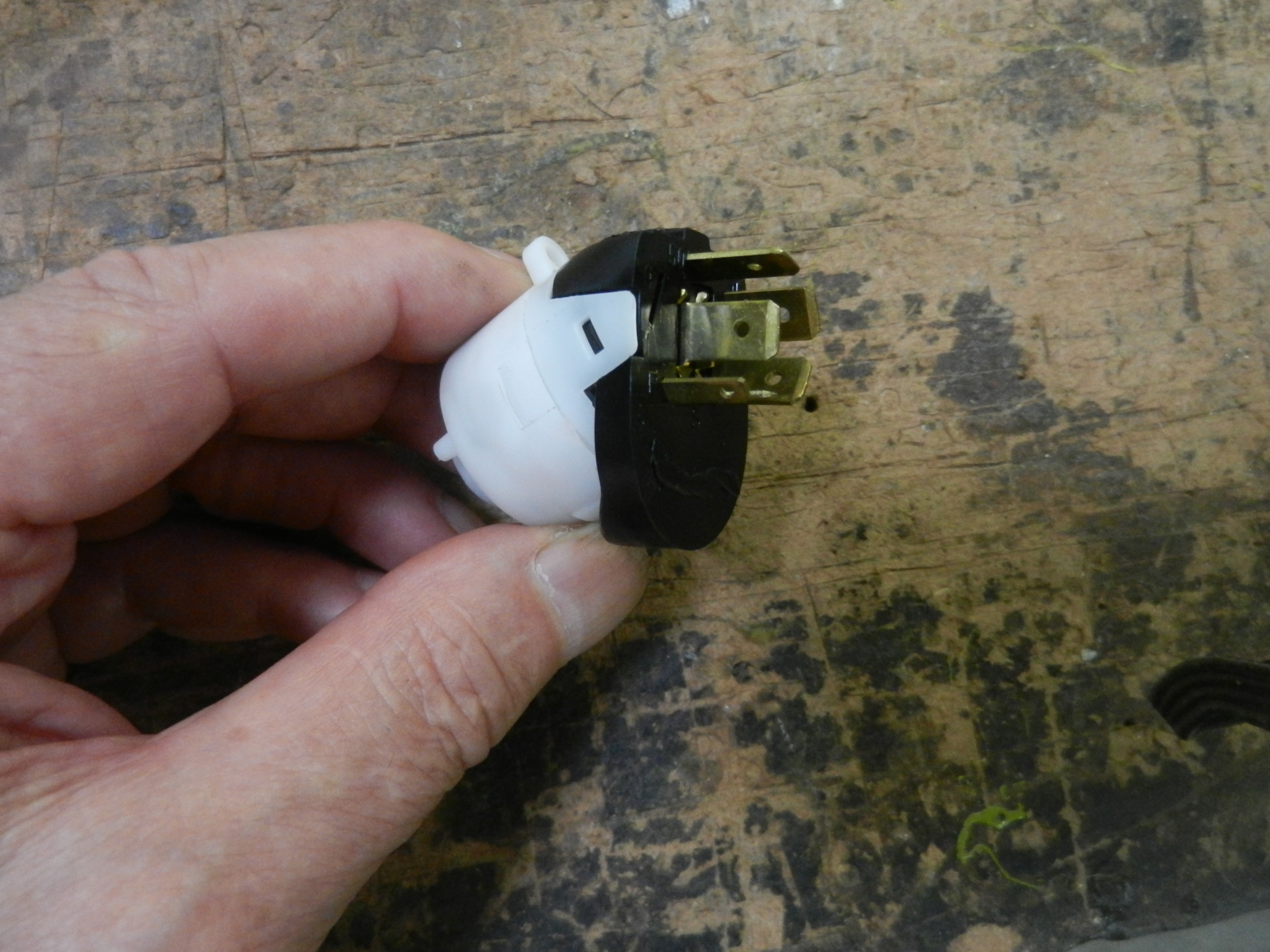

This is the Kostel ign switch. VW pt# will be ground off.
